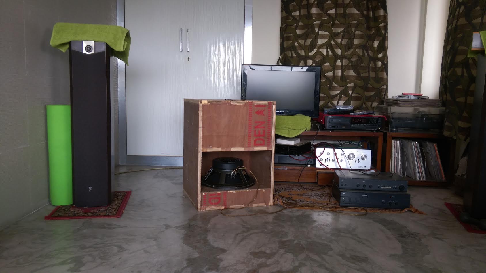

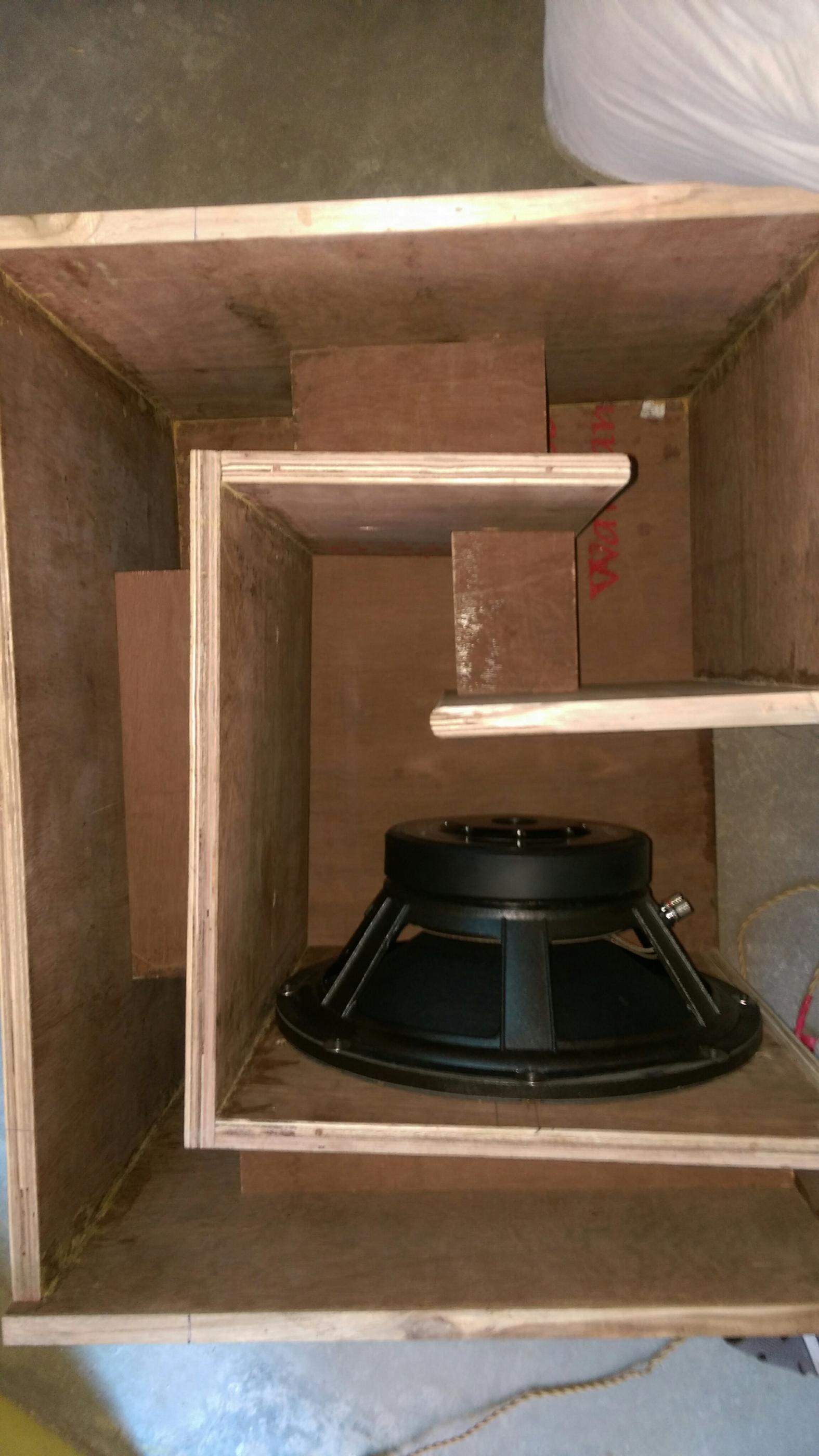

I need a suggestion about building the Tham 15. Does the inside wall of the horn path need any damping material like felt or something as in other conventional speakers or subwoofers?
I am trying to build a Tham 15 with Eminence Definimax 4015LF. Is this driver okay?
I just simmed it and it does work, but not the best. Can you get any of the other drivers that were tested? Also, damping is not necessary at all but you can and this will reduce the HF spikes out of the passband.
Thanks for the reply. I 'm going without the damping material then. Also noticed that none of the construction pics shows any damping material inside.🙂
Here is measurement of the Definimax 15".
http://www.prodance.cz/data/attachments/mereni_eminence_definimax_4015lf.pdf
While those drivers re quite good, they´re not best choice for TH. It should work though.
Thanks for the reply. I understand your point but the original driver for Tham 15 is not available in India and this Eminence was the best thing I could get.
But I would like to put it like this that -- if this works better than a velodine EQ max sub its good enough for me.
I am planning to use Yamaha P5000S as the amp.
Imadman29: it´s generally not about how good the driver is, but about matching the driver with the standing cab. It´s definitely possible to make suited box for definimax, but that is another story. anyway, hope you end up well with that one.
Well now I could safely say that Tham 15 does accommodate Eminence Definimax 4015lf in quiet a nice way and the bass it produces is deep. I don't have a power amp to match this woofer so running with a NAD 110W power amp and a Technics EQ as crossover. It is not a ideal setup - rather far from it, still the bass it produces only speaks the genius of the design.
The power amp that I have short listed is Yamaha P5000S to drive this monster.
Thank you all😀
