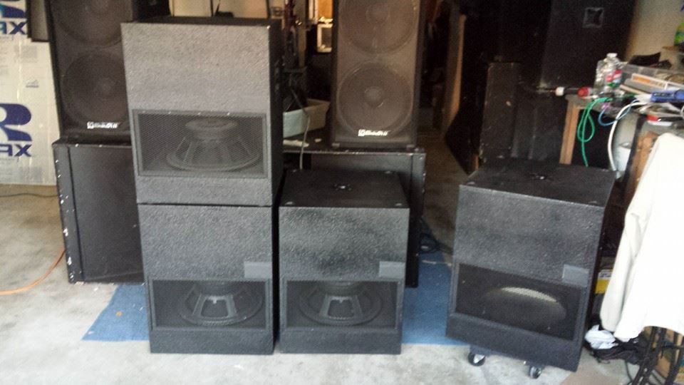

Attached a pic, one of them is unloaded in the pic still but they are all loaded up now. A nice replacement for the dual tuba's behind them and the titan 48s you cant see that are in the corner. anyone want some BFM boxes? 😀
Nice build! Personally, I think headroom is overrated but I like your strategy with the QSC. 2x xmax is what I go for but 4x is not unheard of, but I've never done it. Before I forget, you want HP set at 28HZ -24db/octave LR.

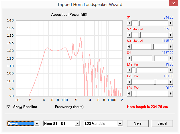

I've attached what HornResp suggests would be the displacement-limited output of the PA380 in an original THAM15. Amp voltage is 35V, which is just under 200W of power. If the PA380 is built anything like it's smaller brother, the PA310, you could probably apply a bit more power without worrying about damaging anything. Just bear in mind that the driver's 5mm Xmax is the limiting factor here. All theoretical of course. As for what the PA380 really behaves like when under power in a THAM15 box, well, there's only one way to really find that out.
The PA380 sims well IMO in many designs but as Brian pointed out, is limited by xmax. So if SPL is not the primary concern it appears to be viable. My favorite sim of it is in a KS. Very flat with a slight peak at 35Hz @ 120db. Then there is the opposite issue, under xmax but exceeding thermal limits. You can throw 2x RMS into the LAB15-4 and SPL is beyond 130db and stull under xmax (in THAM15) but how long can it sustain this?

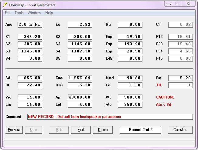

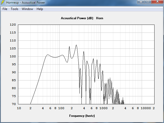

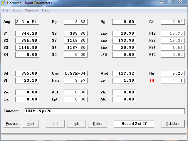

I am able to purchase a pair of B&C 15PS76 15" drivers at significant discount, enough so that this is my best choice to build my first Tapped Horn subwoofer. I have searched and found a few people have built this design (THAM 15) with this driver as a substitue. I have not seen any posted measurements for this driver in this folding so I copied the Horn Resp file from the first posting and added this drivers T/S from the parts express website. In my searches it seems that several versions of B&C 15 drivers have been used to different degrees of success. Below are my results.
Does anybody see any reason not to use this design/driver combo? It has a large bump at the lowest end of the response. I might try to modify the design slighty to smooth that out, but I would not want to stray to far from the published design as I am very new to tapped horns (and folding the designs)
I am planning on matching this subwoofer to my DIY Synergy Horns which are 60x60 3 way with 2x10 woofers. They should reach down to 70-80Hz very easily. This would allow me some overlap when crossing over between them.

I think your simulation is wrong, i have used this drivers, and this is my sims:
In practice, tone is very good, more like some 18 inch then 15 inch woofer, but very clean.
Unfortunately this is not very strong driver, don't push more than 600w, i have burned this speaker twice. About 600w is a safe limit. hp filter is safe to about 35 hz.
