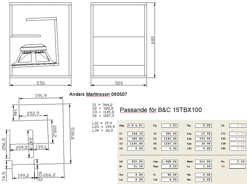

Hey i need your advice
I want to build some THAM 15 but - i want to use
B&C 15nw100
or
18sound
15nw530
15nlw9500
15lw9500
and i want to make it 70cm instead of 68cm becuase my tops are 70x50 in Front
Ialso want to bend the Grill in front like on my tops - so the same style is there.
third i want to use 4om 15er because my top with 15nd930 4ohms and 1060 on H110 iss damm loud.
I want to Stack the Subs two under one Top.
I want to use CSA with the THAM15 - is there a setup for this - like 3,4ms delay which is 1m and polarity reverse.
The 70cm thing gives me more volume on the 15 or i can tilt the 15inch more outwards.
Also i want to use only 15mm Playwood.
Thanks for your help
perhaps you can do a Mod, simulation an shoot out with my changes.
and whats the diffrence simulated between a normal BR sub with the 15inch speaker in simalar Box - or even an compound Dual vented Subwoofer Bandpass design. like nexo CD18 odr LS18

is there a AJhonr simulation file out there so i can put in my chassis and Dimensions of the Case ?
Convert S1 thru S4 to Width x Height. Add 2cm to Width. Convert back to cm2. Plug in your speaker parameters into Sd, BL, Cms, Rms, Mmd, Le, & Re in Horn Response. It's a powerful FREE tool!
Google Translate
Google Translate
Also, change Exp to Par. The THAM15 is not an exponential horn. Parallel sides and increasing height from S1 to S4 equals a parabolic horn.

is it possible to load to 15inch in a face to face configuration - the resonace chamber gets a bit bigger because the woofer needs some space.
if i use the 15ndw530 i have a 2x8ohm oder 1x4ohm Box with a bit more deep i think of 5-10hz and double the power.
And the Sub is more than 3dB louder than the only one speaker Version.
Is it possible to simulate that in Hornresp ?

Hi tthorsten,
Post #336: "...is it possible to load to 15inch in a face to face configuration..."
Take a look @ epa's thread:
http://www.diyaudio.com/forums/subwoofers/231339-double-15-th-18-sound-15-nlw9401-4r.html
