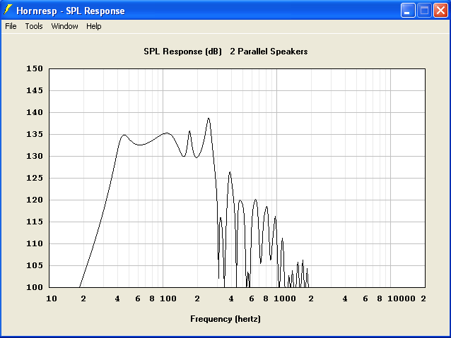

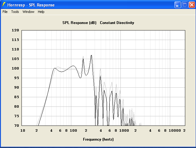

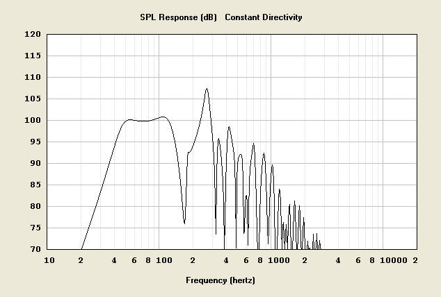

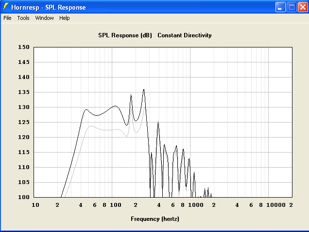

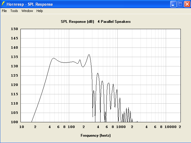

Hey there - I am trying to master Hornresp myself, so I will see if I can be of assistance to you. I actually modeled this comparison about a month ago when I first saw the Dayton PA-385S was being introduced. I have four attachments, here is what they are:
Attachment #1 - The grey trace is the PA380 @ 1 watt, the black trace is the PA385S @ 1 watt.
Attachment #2 - The grey trace is the PA380 maxed out at 200 watts. The black trace is the PA385S maxed out at 800 watts.
Attachment #3 - This is four of the PA380 drivers maxed out at 800 watts @ 2 ohms.
Attachment #4 - This is two of the PA385S drivers maxed out at 1600 watts@ 4 ohms.
I am no expert on this, but I believe these calculations should give you a pretty good idea what to expect in the two scenarios you mentioned. It looks like you would come out about the same for Max SPL either way.
I guess it really comes down to if you want to build two more cabinets and spend $150 on speakers, or not build any more cabinets and spend $400 on speakers. I would also take into consideration you amp, and if it can run safely at 2 ohms if you are going to be running four of the PA380 drivers on one amp channel. If you go with the PA385S, do you have an amp with that much power, or can you bridge you amp to achieve that much power?
