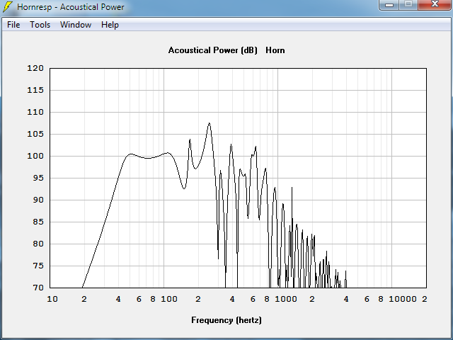

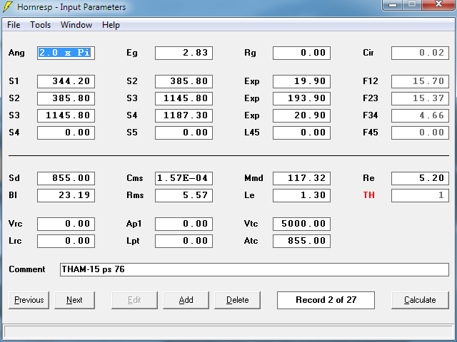

I think your simulation is wrong, i have used this drivers, and this is my sims:
Your sim is missing cone correction. Vtc=5000 and Atc=855 should be in the ballpark.
I can put that in sims, thanks for info. I practice, there is no audible peak, and woofer can go little lower than predicted.

Martinson, I am looking at the THAM18 page and I am a little confused. There are two HR sims, one is called 3 segment. The output is different. The second (3 segment) has a much better upperband response. Can you explane a little what is different?
The 4 segment simulation, the top one, on which all the resulting graphs are based is a more correct way of simulating the folding since it takes the rather steep area increase between S3 and S4 into account.
The drawback then becomes that due to the limited amounts of segments allowed in hornresp, the last expansion is not simulated correctly (between S4 to S5) where it does not see the step and regards it as an even expansion between S4 and S5, it's not a big error and I had to choose and that seemed to be the least inaccurate way of doing it.
The 3 segment simulation at the bottom should really be taken away since it shows a overly optimistic result, the reason being that it does not see the S3-S4 expansion, instead it sees the S2 to S3 as one evenly expanding segment, which is false, this also becomes apparent in the systems volume window.
I hope this clears thins up a bit, and thanks for pointing this out, I will correct the post, emphasizing that the 3 segment simulation is not the correct way to simulate this folding.

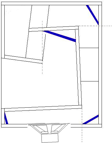

I have a question on the THAM15,
1. Doesn't the woofer location obstruct the sound waves?
2. Wouldn't the cabinet play deeper and louder buy some margin if the woofer was located as depicted in the image. Cabinet would be 200mm wider resulting in width of 880mm.
<blockquote class="imgur-embed-pub" lang="en" data-id="xN2zr3z"><a href="//imgur.com/xN2zr3z">View post on imgur.com</a></blockquote><script async src="//s.imgur.com/min/embed.js" charset="utf-8"></script>
1. Doesn't the woofer location obstruct the sound path?
2. Wouldn't the cabinet play louder if the woofer was placed out of the sound path?
Please see image:
Please see image:
