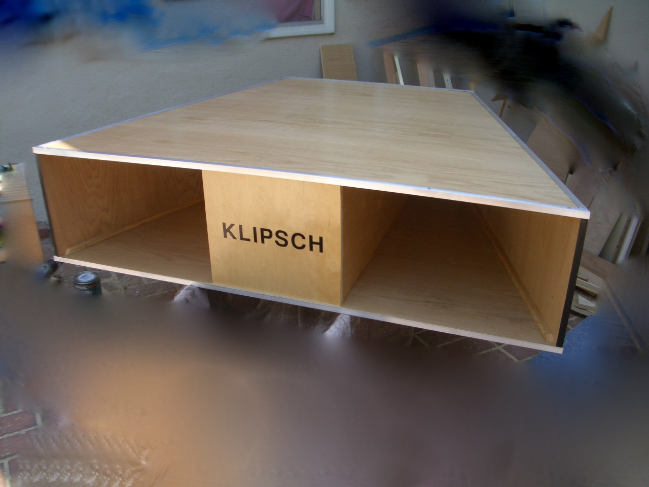

I agree on using good quality plywood I used Baltic Birch on my 4 DIY Klipsch WMW bass bin's on the horn section of the cabinet and Red Oak for the outsides.Hi Pabesco,

Thats MWM Bass Bins I need new glasses😕I agree on using good quality plywood I used Baltic Birch on my 4 DIY Klipsch WMW bass bin's on the horn section of the cabinet and Red Oak for the outsides.
Dan the inner part of the bin is Baltic Birch sorry not sure what you mean by MDO?Nice work, is that BB MDO ply? I've never seen that before...
I've never seen MDO with a BB core...
The Red Oak plywood has about 10 plysAn externally hosted image should be here but it was not working when we last tested it.
Yes not cheap it was about $120 a sheet it's twice as heavy as regular shop grade birch plywood.Lets try again...

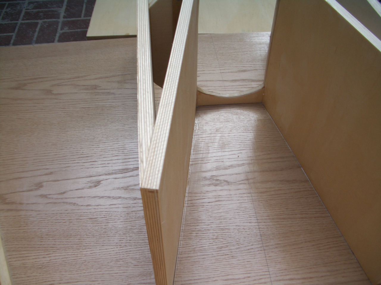

i am using the original design with the internal reflectors without cone correction as recomended.
there are four 45 degrees cutouts that go to the top of the cab and this is what i used. i will try to post the pics i took. would i be able to just copy and paste pics to this forum or would i have to do something else?

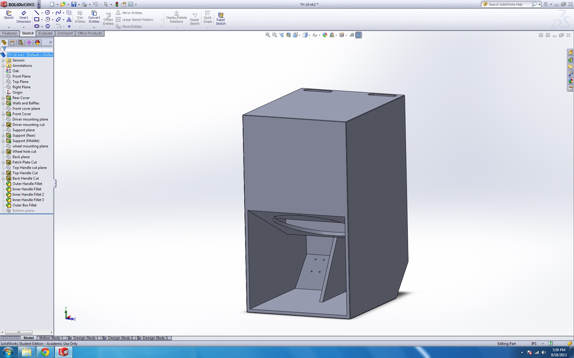

Hello everyone,
Seems like it has been a while since anyone has posted to this forum...
I am about to begin a build of 4 of these (mkII version) and as such I have drawn up the sub in CAD (SolidWorks).
Unfortunately my solidworks skills are not yet to the point that I can take my 3d model and make a cut sheet from it, as such I humbly ask for someone who is better at cad than I am's assistance in this matter.
So if you are interested in taking a decent solidworks file of the mkII sub and making a cut sheet from it please PM me and I will send you a copy of my file to play with.

The difficulty with producing a cut list is that you have made the entire cabinet as one component. It would be easier if you had modelled the speaker as an assembly. The separate panels then can be laid out in a separate assembly to see how they can be nested to suit whatever timber panel sizes you have available.
You could still achieve this with what you have by adding the TH18 model to a new assembly, and then adding individual panel parts overlaying what you have already modelled. Make the parts associative to the base model and they should update if the base model is modified. The individual parts can then be laid out to produce the cut list.

Hi Martin,
I think that I understand what you are saying, in essence I will have to model each panel of wood individually then using the original model as a guide "assemble" them in an assembly. What I don't understand is how making them associative to the original model would allow for the panel models to change when the original model is changed.
I will give that a try, it will take a little while to model each panel but in the end your right that will make it very easy to lay out flat in a cut sheet.
