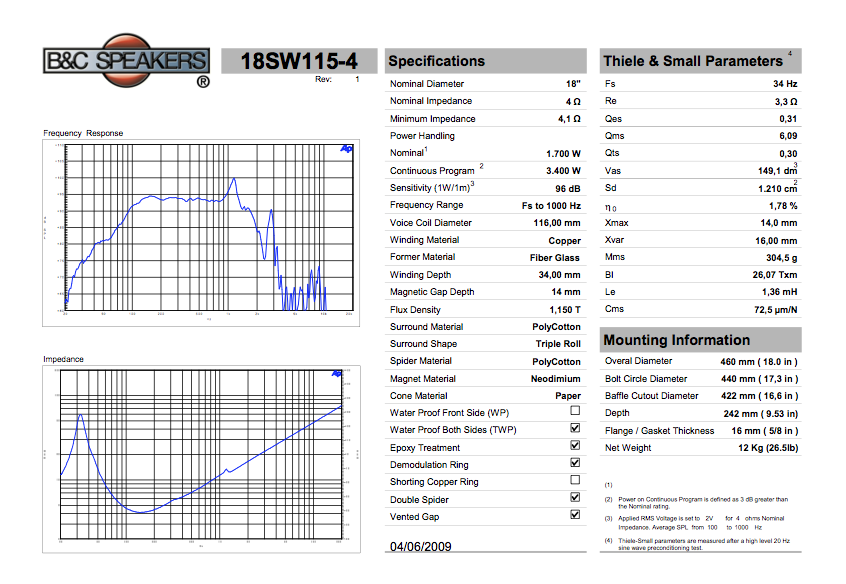

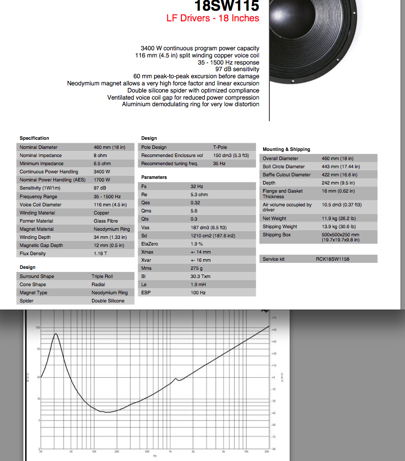

I know this has been draw and redrawn to death BUT I was bored today and drew this up after going over all the revisions and ideas. Why not another 🙄 It gave me something to do. Maybe someday I'll actually put my new/boxed 18SW115's to work if I get time to build and it drops below 100*
in the factury specs of the sw115 ,re should be 5 ohm.
You're right, its been corrected. I didn't account for the resistance of my cheap dmm
The specs I have show 5.3 ohms DCR for the 18SW115-8 and 3.3 for the 18SW114-4.You're right, its been corrected. I didn't account for the resistance of my cheap dmm
I just got the DATS out and yes they are 5.32 for the 8ohm model, changing it back again. Le measured a little higher then spec sheet as well
