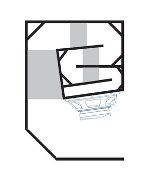

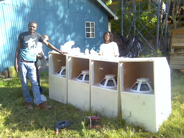

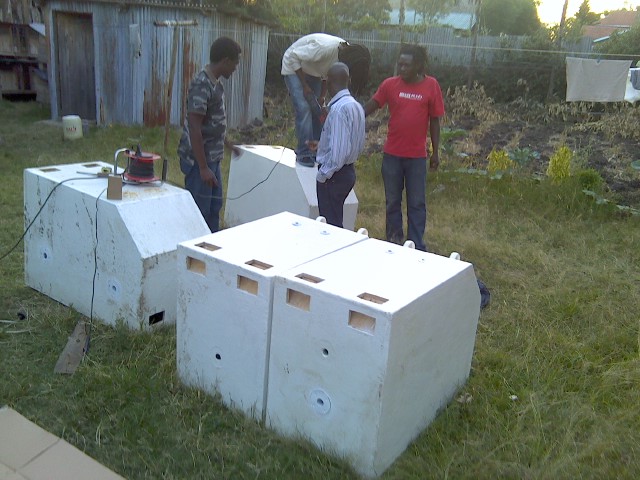

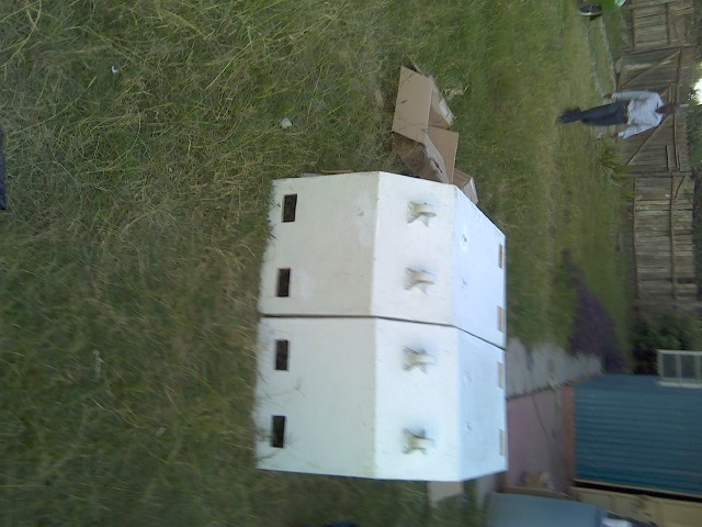

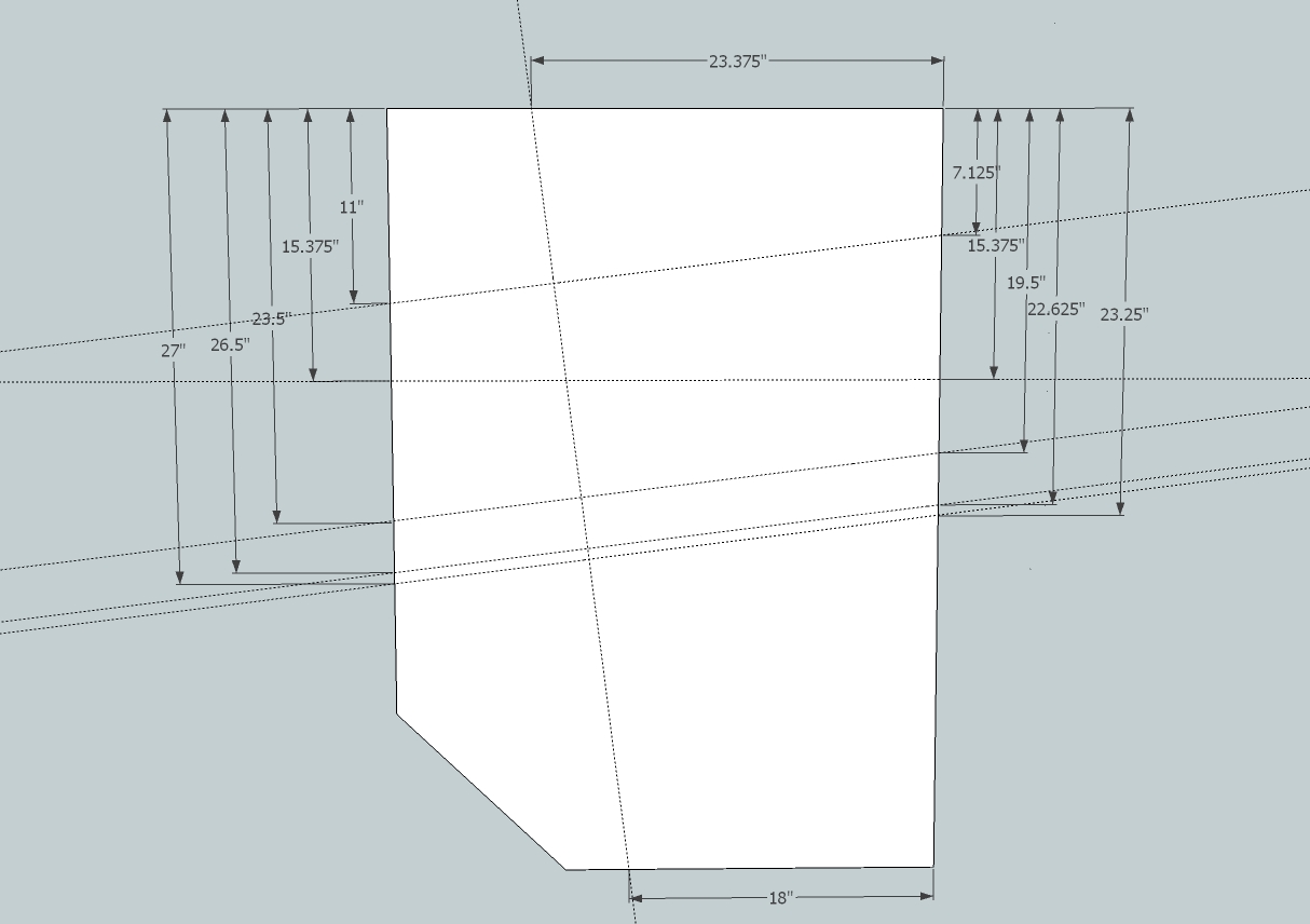

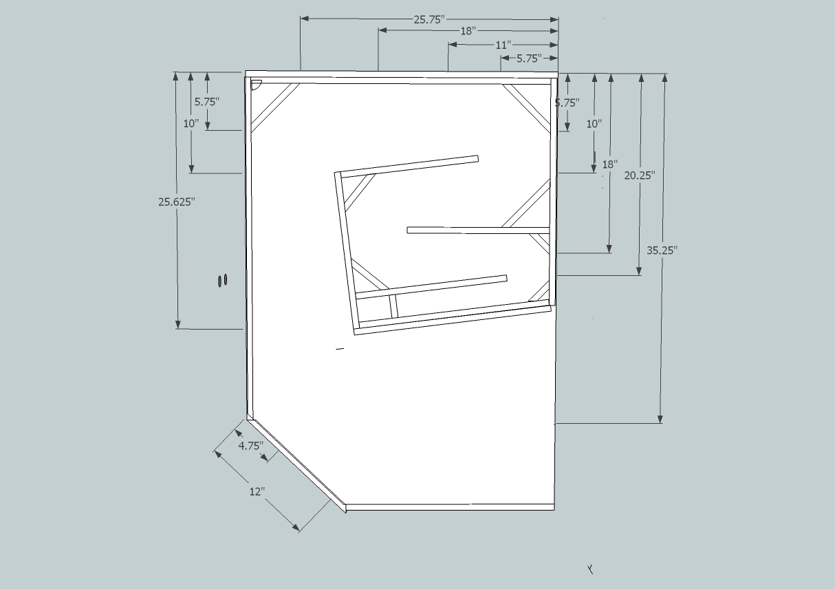

hi all i am new in this thread. just wondering whether xoc1 design is better than this design folding which reaches 35hz . i have built the below but loaded it with an 18inch driver

Nice job on those cabinets they look great I'm not sure about about your question I'm sure someone will answer it soon. Congrats those are cool 😎hi all i am new in this thread. just wondering whether xoc1 design is better than this design folding which reaches 35hz . i have built the below but loaded it with an 18inch driver
thanks jacob

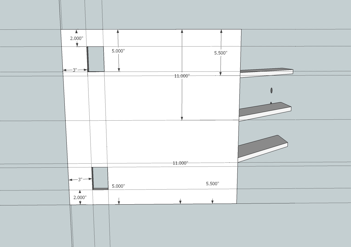

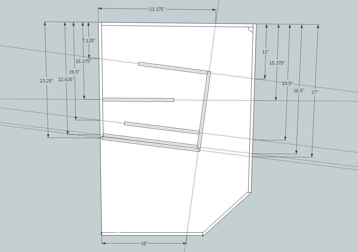

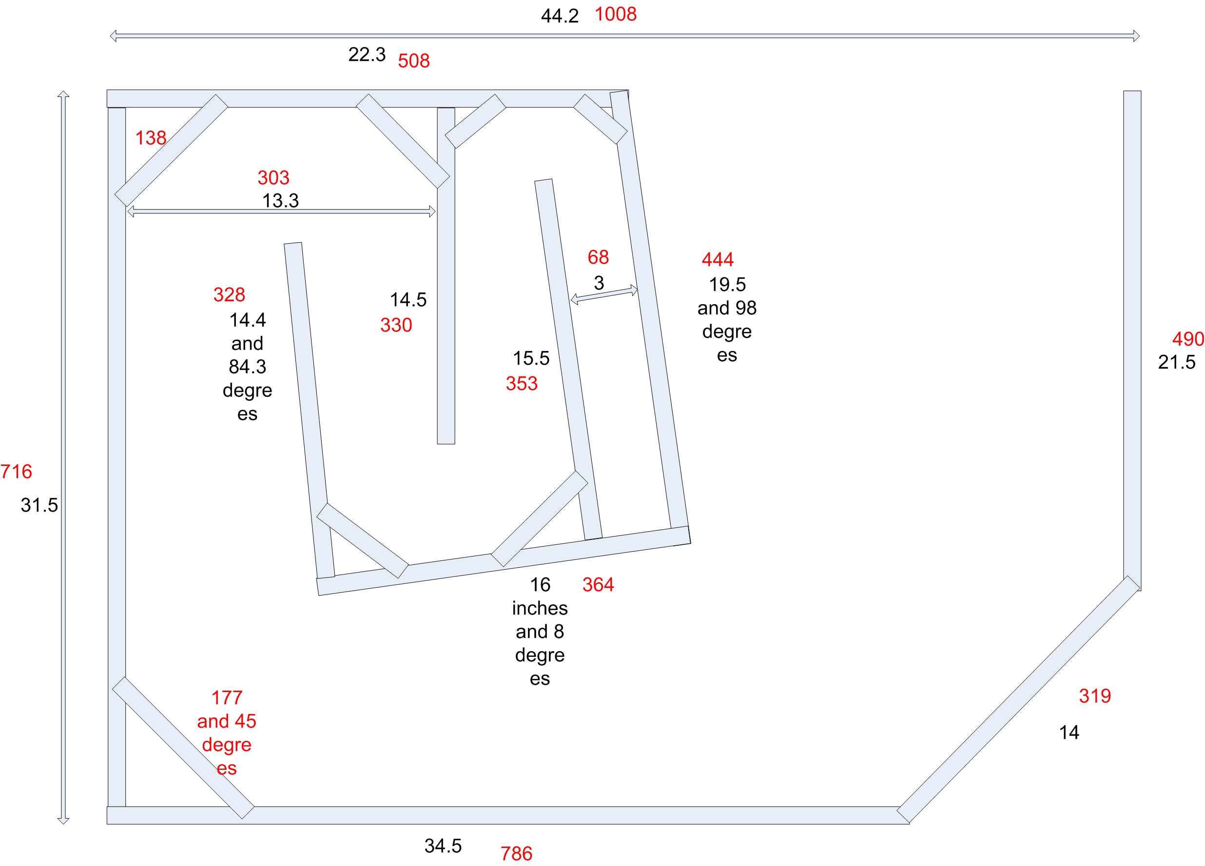

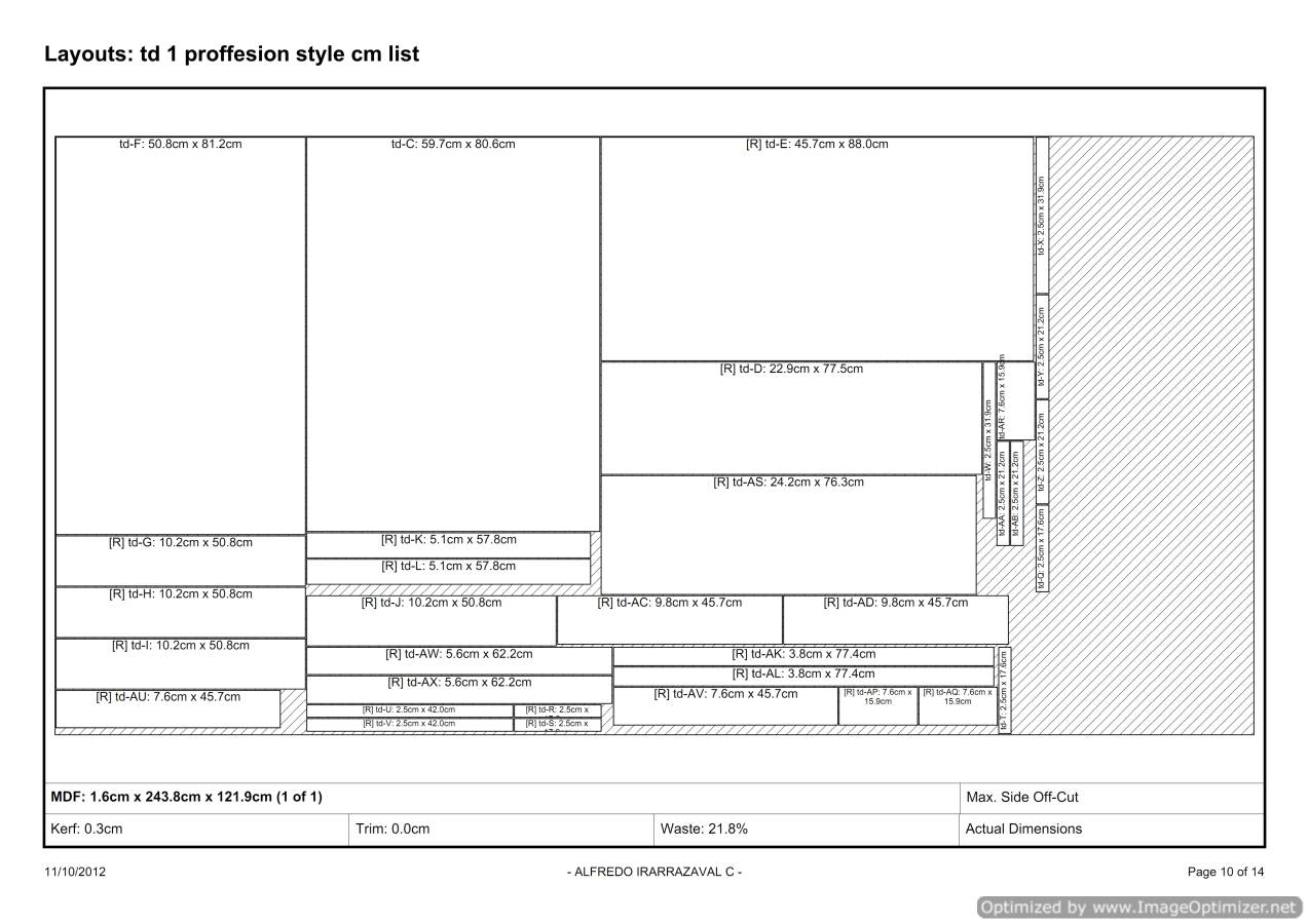

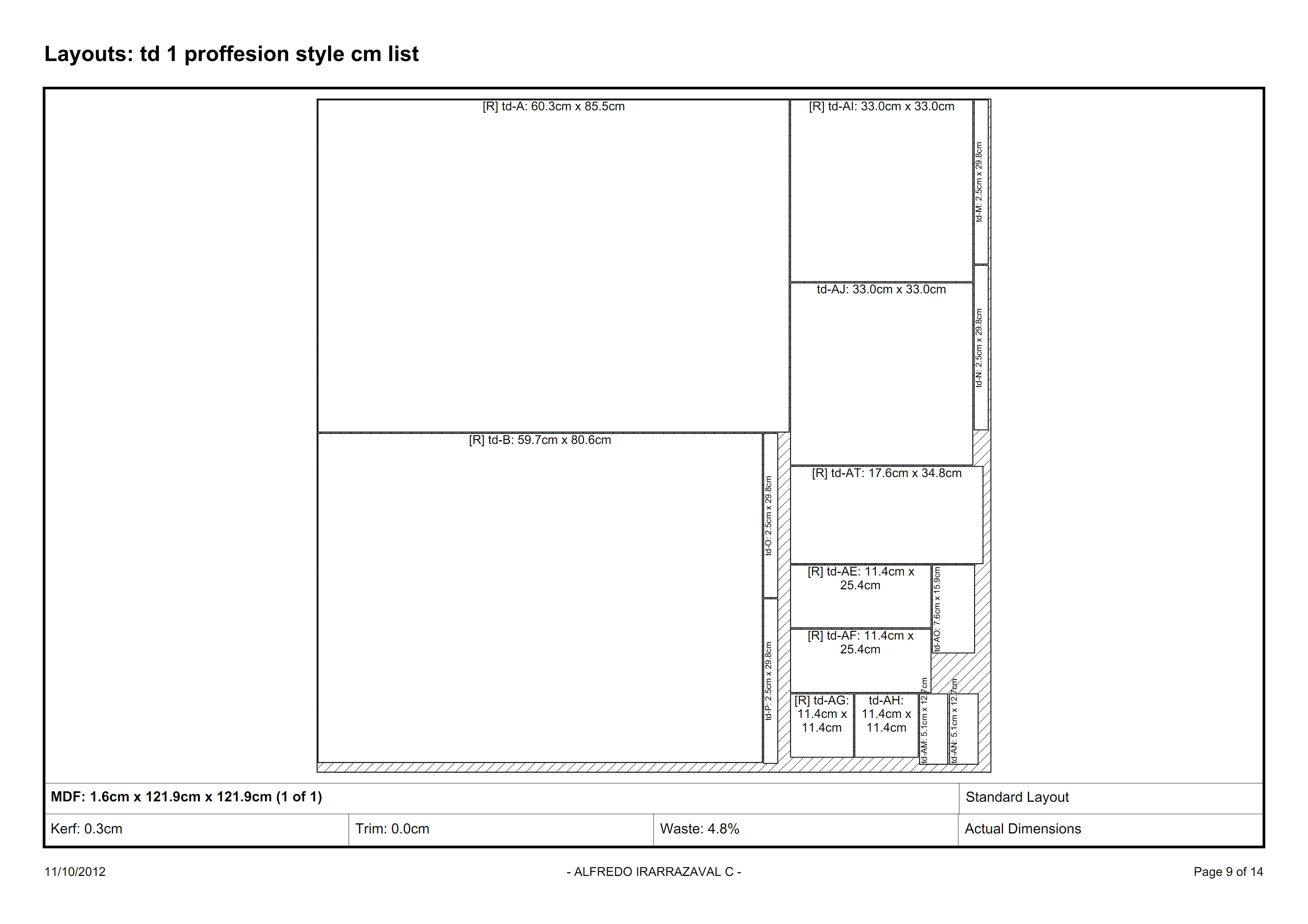

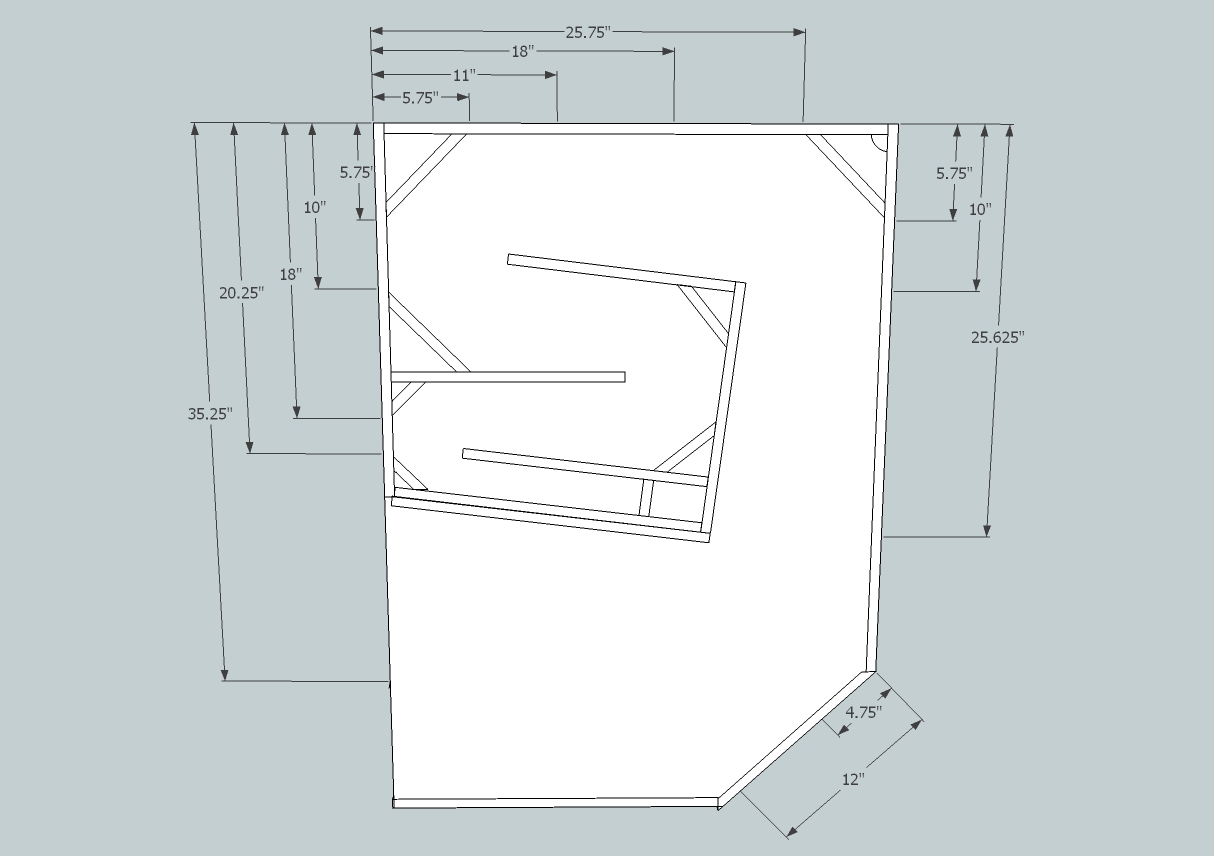

more files for the project
Hi Stewin,
Is this the cab designed by wood1y?

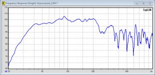

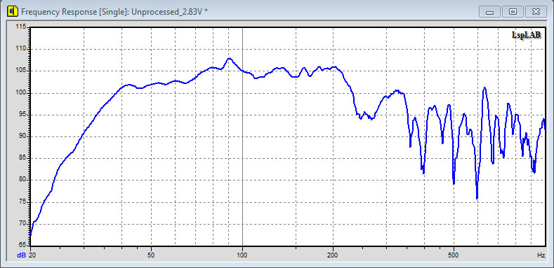

The first thing I notice from your response plot is the ~10dB difference from 40Hz to 30Hz. Whereas the difference is only ~4-5dB with the TH-18 when using the 18SW115 (of course there are other drivers that work very well - this is just for example's sake). Was any processing used (HPF) in that response plot?
hi cresendo i got the plans from http://www.diyaudio.com/forums/subwoofers/170749-15-tapped-horn-rcf.html
do you mean to say the xocs design is better, because truly i heard speaker excursion at high spl when not using in a room (that is full space out doors)

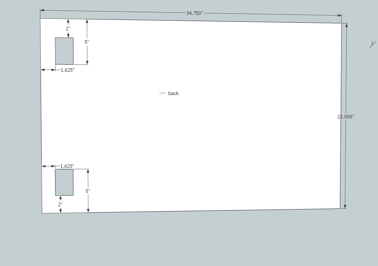

sorry guys wrong wood layout
for the wood layout i used 2planks the below 8x4sheet
Hi StewinDo you mean to say the xocs design is better, because truly i heard speaker excursion at high spl when not using in a room (that is full space out doors)

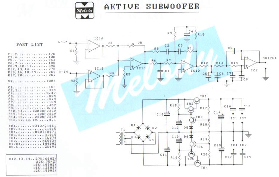

First thing to ask is if you are using a Hi-Pass filter for your tapped horns?
The high pass filter is needed for any tapped horn design!
Regards Xoc1
@ stewin
Hi, nice looking graph. The upper response, before it gets ragged, is one of the best i've seen 🙂
What driver is it ?
Xoc1 is right to ask about a HPF 😉 What type & f
What driver is it ?

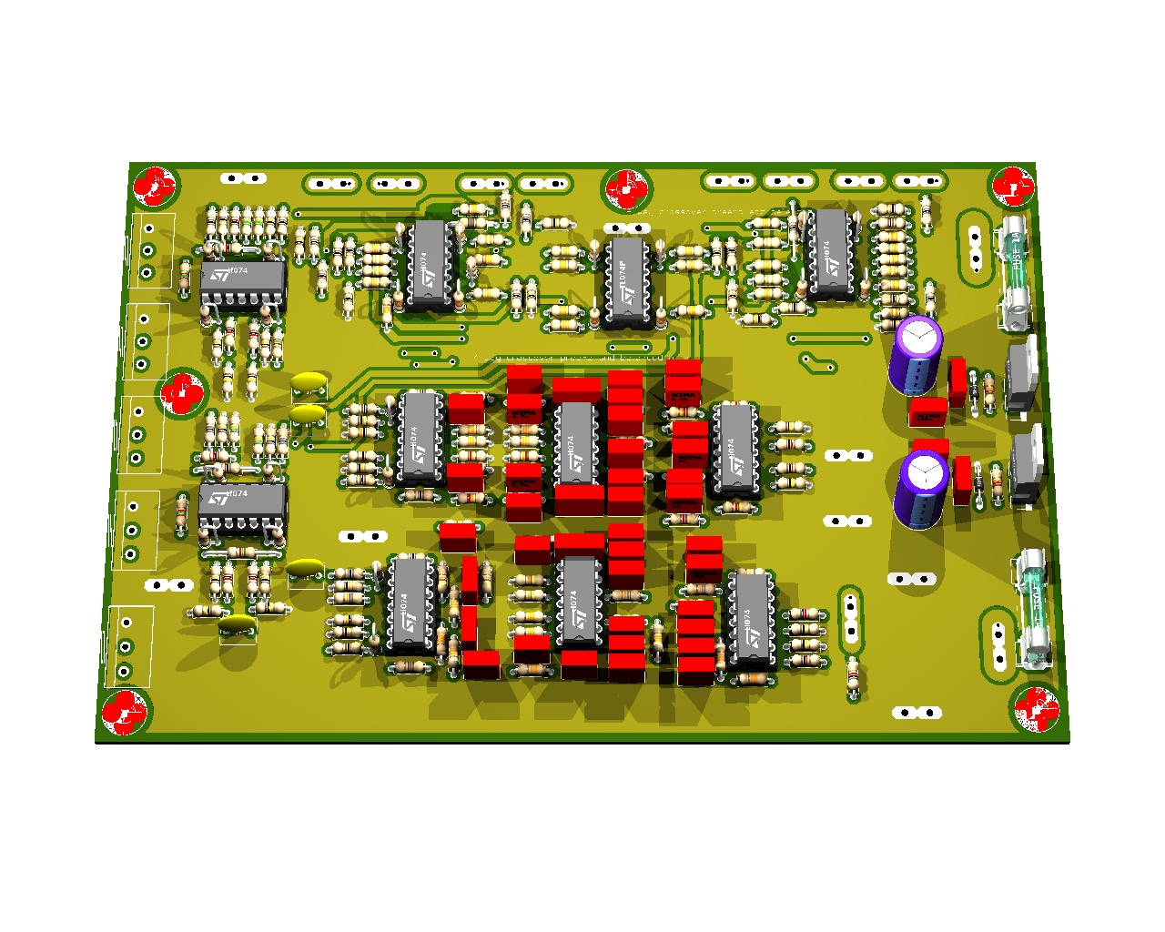

yes i am using the linkwitz riley active 24 db crossover up to 110hz or the below two schematics .
>>>one is a schematics for subs only i found on the web
>>>the other is a 24db i designed using the linkwitz 24db calculatorhttp://sound.westhost.com/project09.htm#download_esp_lr Linkwitz-Riley Electronic Crossover to fit my needs to cut the frequencies below 35hz and above24khz so as to get maxx spl out of drivers.
i always use active crossover with the subs

oops that simulation is not mine but woody's http://www.diyaudio.com/forums/subwoofers/170749-15-tapped-horn-rcf.html i use new retone nr 18 speaker it is chinesse .i did not simulate mine setup but i will once i get to know how to do it.

Stewin,
Nice work on the cabs! I am going to be building these with 18s as you did. The cut sheet you posted is for one complete cabinet?
