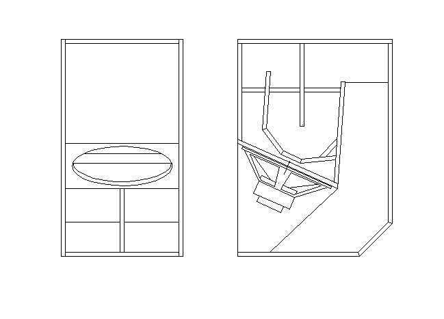

I have modeled the design found on page 1 with the B&C 15PS100 in Hornresp and although the predicted frequency response looks good to me, I was wondering if someone more experienced could double check if this driver works in this cabinet.
Reason I picked the B&C 15PS100 (4 Ohm version) is because I already have access to QSC GX7 amplifiers. They output 725 watts into 8Ohms and 1000 watts into 4Ohms per channel.
So if this driver models nicely in Hornresp, will I be safe with running it with 1000 watts?

Check the cone excursion at 1000W. Also check out the filter wizard. Once you have scared yourself with the excursion then try to find how much to subtract for thermal compression.So if this driver models nicely in Hornresp, will I be safe with running it with 1000 watts?
Some builders have run the TH18 at 1600W+ with a proper high pass filter. Most 18 drivers seem to theoretically run out of Xmax at 800 to 1000W in the TH18 so the practical rule of thumb is find the theoretical xmax power and double it!
I know that some 15" drivers have been run at 1KW in the Tham 15 but that is a lot smaller cabinet.
If you have the choice I would go with a 18" driver the power handling is far better.

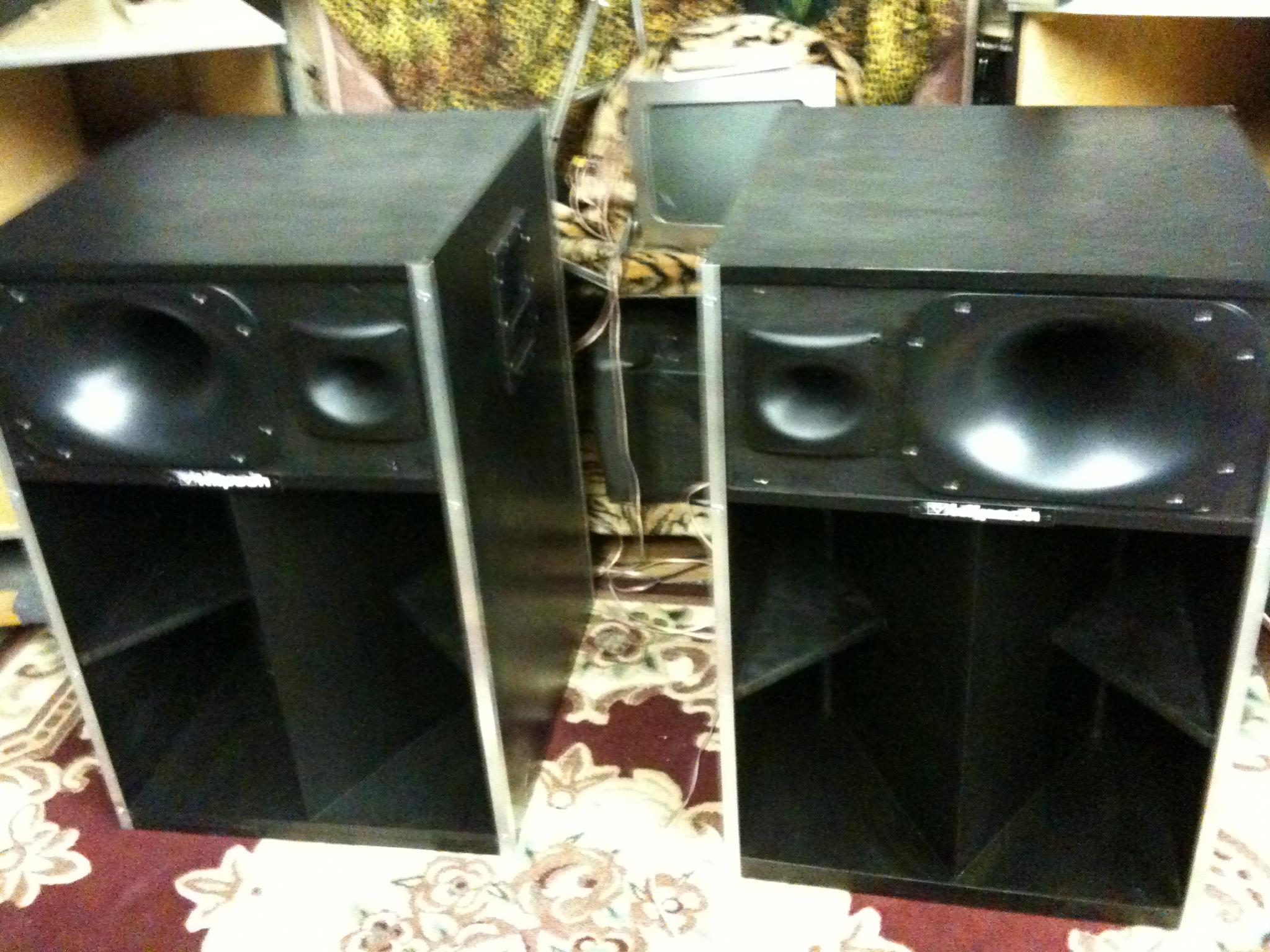

3000 watts @4 ohm. I have several tops but have been using Klipsch KP302's and Klipsch LSI , commercial version of the La scala's, I may get a pair of Danley's SH line tops I'm not sure I've spent enough over the past few months.
My LSI have been modified APT 50 tweeter and Faital LTH 142 also AL-3 networks" Klipsch KP302's and Klipsch LSI "
How do you keep the tweeters alive?

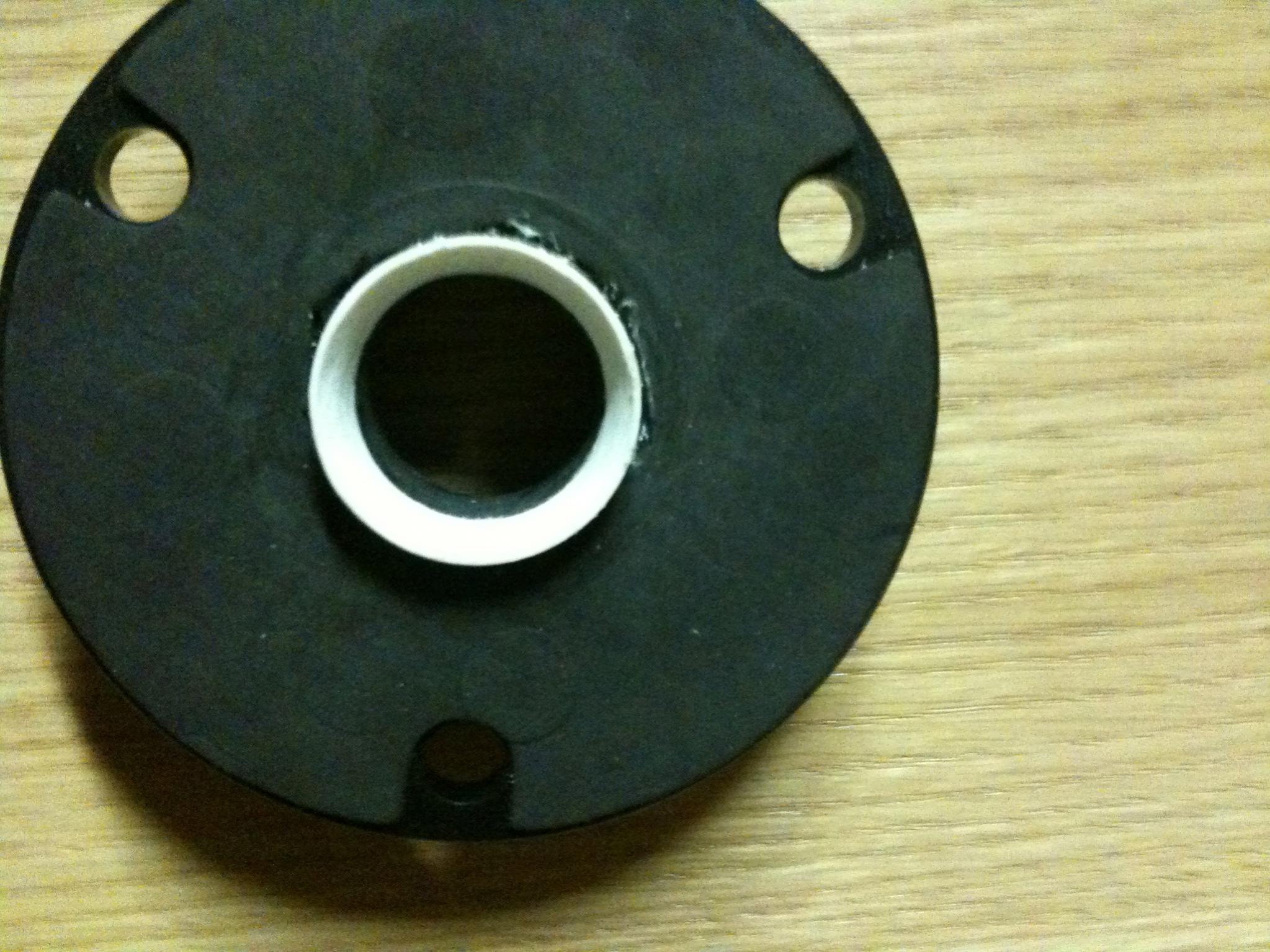

I also did your bass reflex mod to them.[/ATTACH]I fabricated a adapter so a K-55 would fit I took a Selenium ADF-25-25 adapter and took a piece of 1 1/4" PVC and glued it to the bottom of the adapter and tapered it to the horns walls it came out very nicelyView attachment 352398
