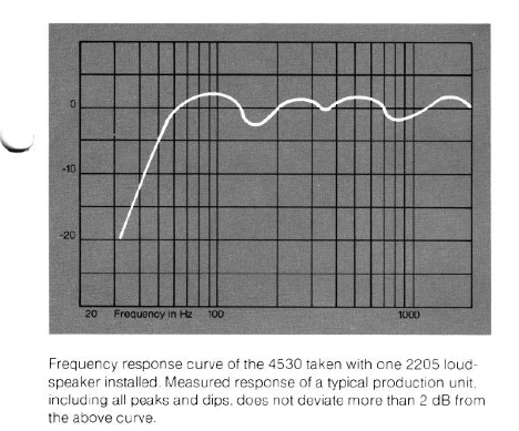

The "classic" JBL 4530 single scoop rolls off below about 55 Hz, while the TH18 rolls off below 35 Hz, a HUGE difference.I heard that scoops just don't apply anymore. Only for reggae.
Trying to get response much below 35 Hz really becomes a huge compromise both in the size of cabinet needed, and the amplification and AC power needed to support the LF.

IMO a "modern" scoop system is real strong down to at least 30Hz.The "classic" JBL 4530 single scoop rolls off below about 55 Hz, while the TH18 rolls off below 35 Hz, a HUGE difference.
