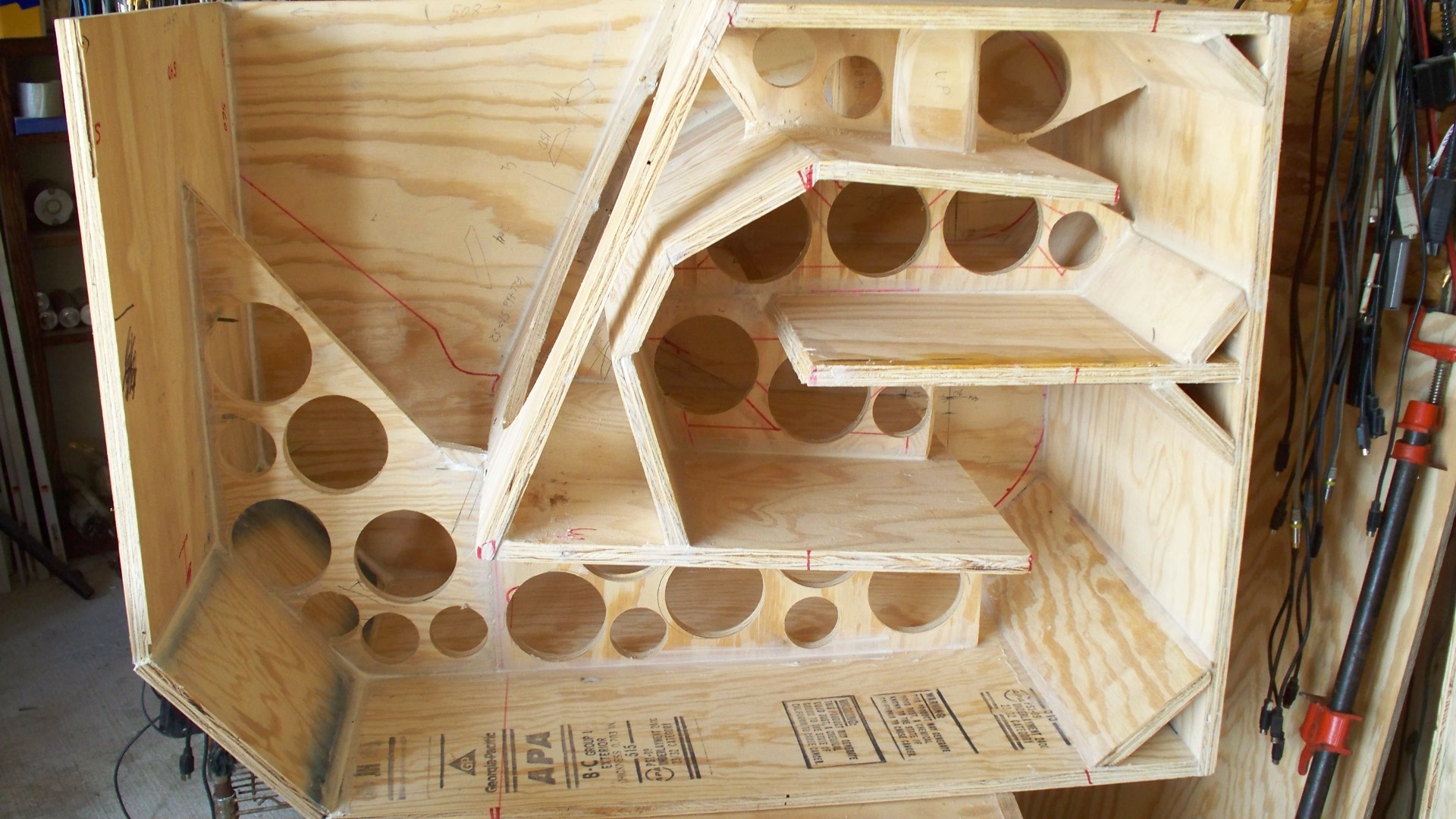

Hey All,
I fashioned myself a nice tapped horn and got to play meet the neighbors the other day:
- TH18 Reference Design
- CNC Cut
- B&C 18SW118
- QSC PL340
- Ashley Protea 3.6 DSP
For those of you who've yet to build one of these things let me say- this design produces non-trivial amounts of bass. After a quick high pass config on the DSP I started ramping up the volume. The first impression was that it takes a lot of power to get it started. But then it takes more power- and more power and gets louder and louder. In moments debris began falling off the ceiling then the shelves came loose dumping items all over the floor. I cut the volume off and my neighbor came walking around the corner wide eyed grabbing her chest and acting like she was under attack. By the end of the test session I had met more neighbors and had two friends standing on the inner front of the mount with the cabinet tilted up leaning on it so we could hold it still while running at full volume. Success!
Observations:
- I've played out doing live improve house twice; the cabinet musically sounds very smooth
- Wide eyes and chest grabbing are common responses I see from audience members
- Hand placing the parts with glue only lead to 1-2mm drift at the outer corners of the cabinet
- The casters vibrate and will need to be replaced
- Neutrik Speakon connectors will not mate unless you're mindful during parts selection
- I wired the QSC PL 340 in bridge mode but left the selector in parallel mode and blew a rectifier in the HF switching stage and lifted a few traces off the main board... Ooops...
- The B&C 18SW118 driver has insane power handling capacity
- Needs MORE BRACING
Thanks all for the great info on this thread! More builds to come ...
-lc

Well as I see it in your pic, there is no bracing on any internal panels.....
does bracing affect spl and perfomance?

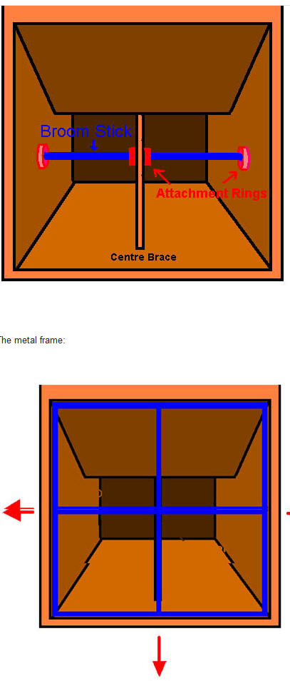

A bungee cord wrapped around them will stop the noise.- The casters vibrate and will need to be replaced.

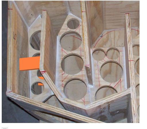

Hi Johan, that makes sense but only at low frequencies. Is that not what happens when the driver becomes unloaded below the resonant frequency and a hi-pass filter is needed to avoid excessive excursion.
I think that the maximum compression in the TH horn is reached at the point in the horn next to the edge of the driver, not the centre.
As such the Hornresp compression ratio reported is still useful information but does not specifically relate to the actual S2 point in the horn.
Flow analysis sim screenshot attached to illustrate this.
I am trying to concider what is really happening in the TH horn throat.
Regards Martin
