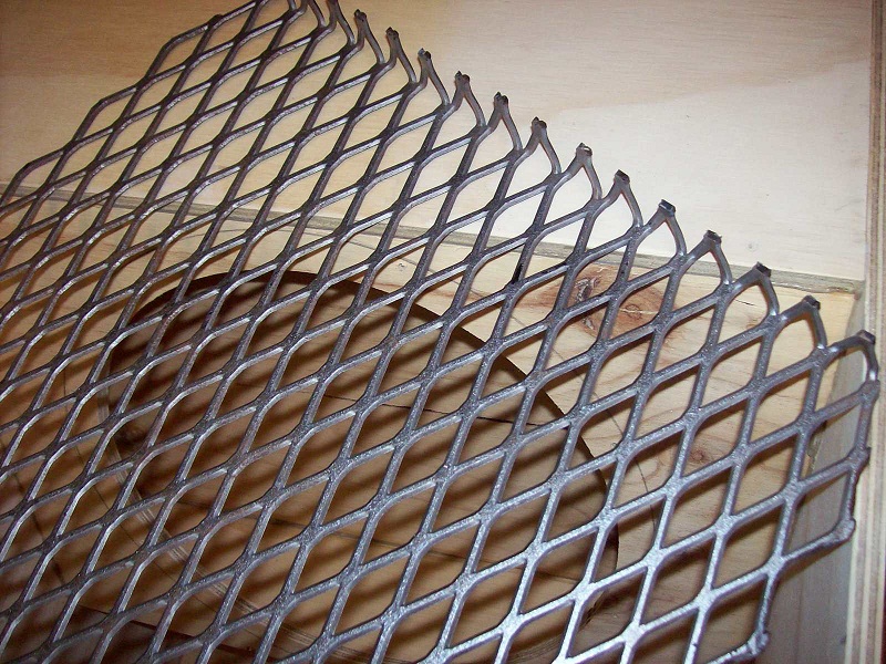

I believe it was jbell who said that grill is quite flimsy. He recommended the Dayton square grill. This is what I'm using, along with acoustically transparent foam behind it to stop the 'ringing' of the grill and for an extra layer of drink-spill protection.
Correct -- the square hole dayton is rigid, the round hole dayton grill is not.
I would use the square hole on a sub, round hole on a top.
My problem is that on a dual 12" top with the dayton 8R grill (pre-bent with 1" edge) was almost too flimsy for top duty, and took several attempts to get it to stop rattling.
The 8S square hole is much more rigid.
Now, if you want something TRULY rigid.........

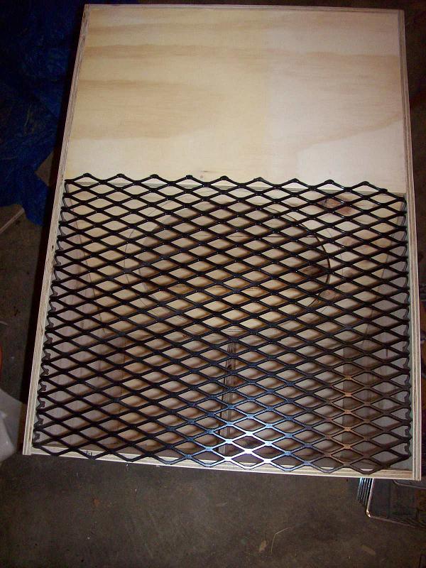

yes plasti-dip the sides for vibration reasons.
yes screw top/bottom, friction fit the sides
yes, VERY cheap/VERY sturdy grill
(btw, I cheat... I don't have/use a break... just a wood clamp, and bend one ear at a time)
No... I don't think it has to be ugly.
Flattened mesh looks reasonably good depending on size in my opinion.
Amazing what a bit of epoxy paint does.
