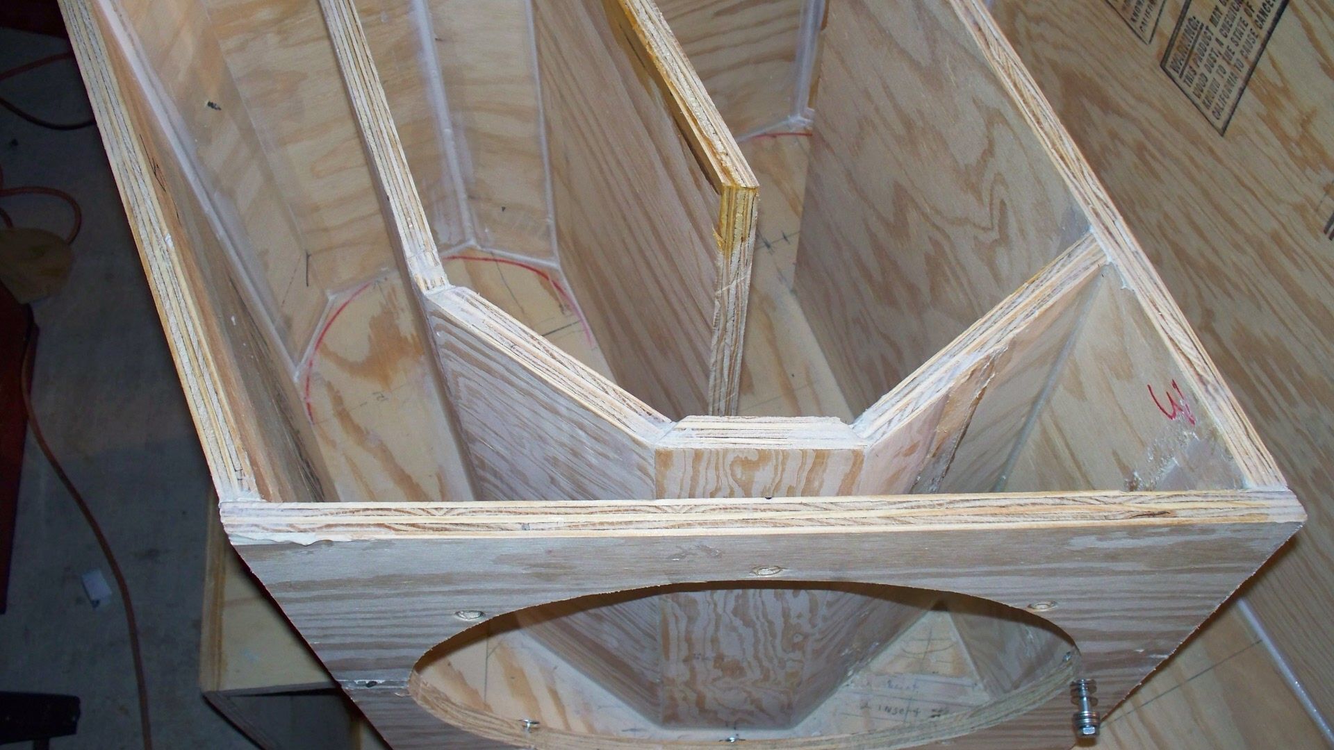

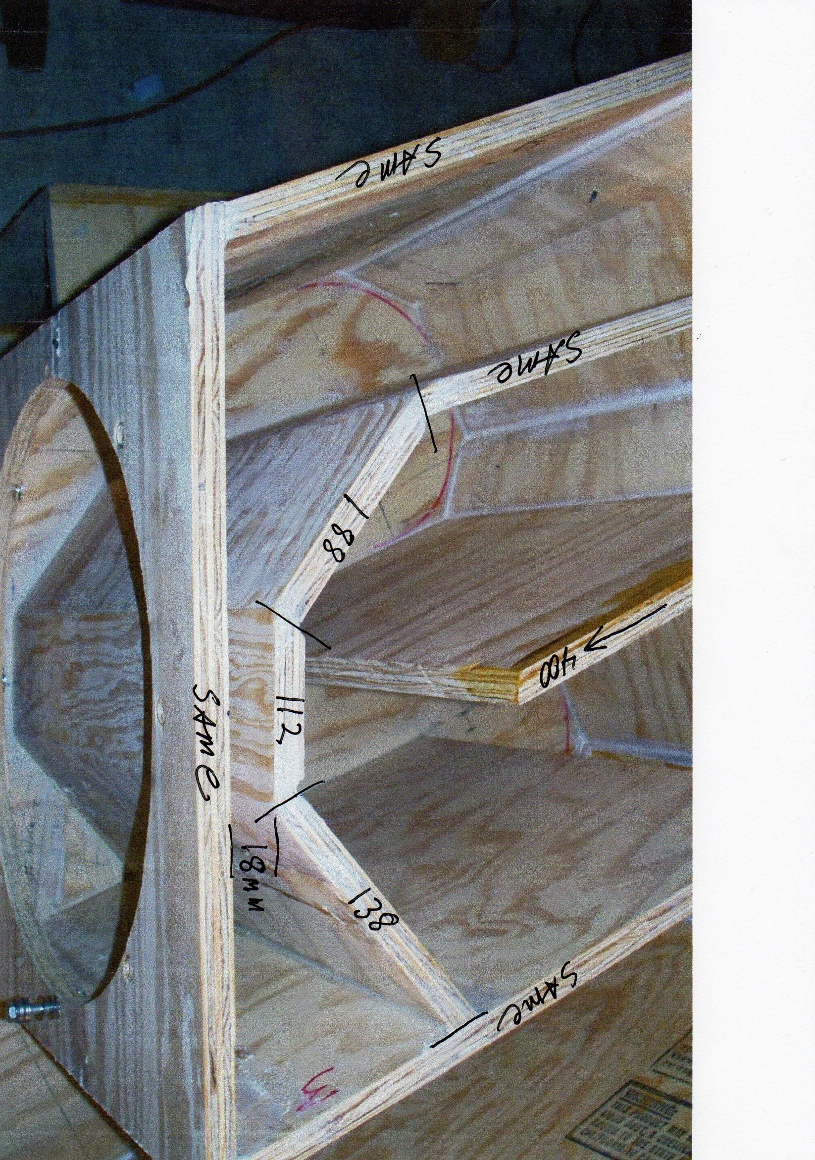

I have heard a rumor that a new design will be put up,but no you haven't missed it ,This cab I built I did with some help from everyone here's Ideas ,I am learning hornresp ,I used a protractor and made the curves,each turn gets about 10% bigger,I used 400mm lenght for the part#10 ,If someone would like to run it in hornresp I would like to see how close it is,
It got to Play music tonight but the cone is stiff ,but it sounded good ,I am new to rew but what I did run looked reasonably flat and no big bumps or dips,I was happy with it ,bass filled the room EZ,I have 2 more stiffeners and the broom stick to put in tomorrow,

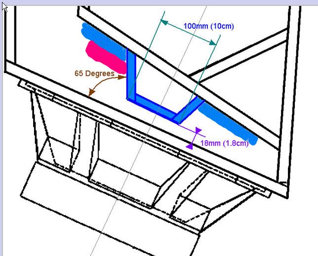

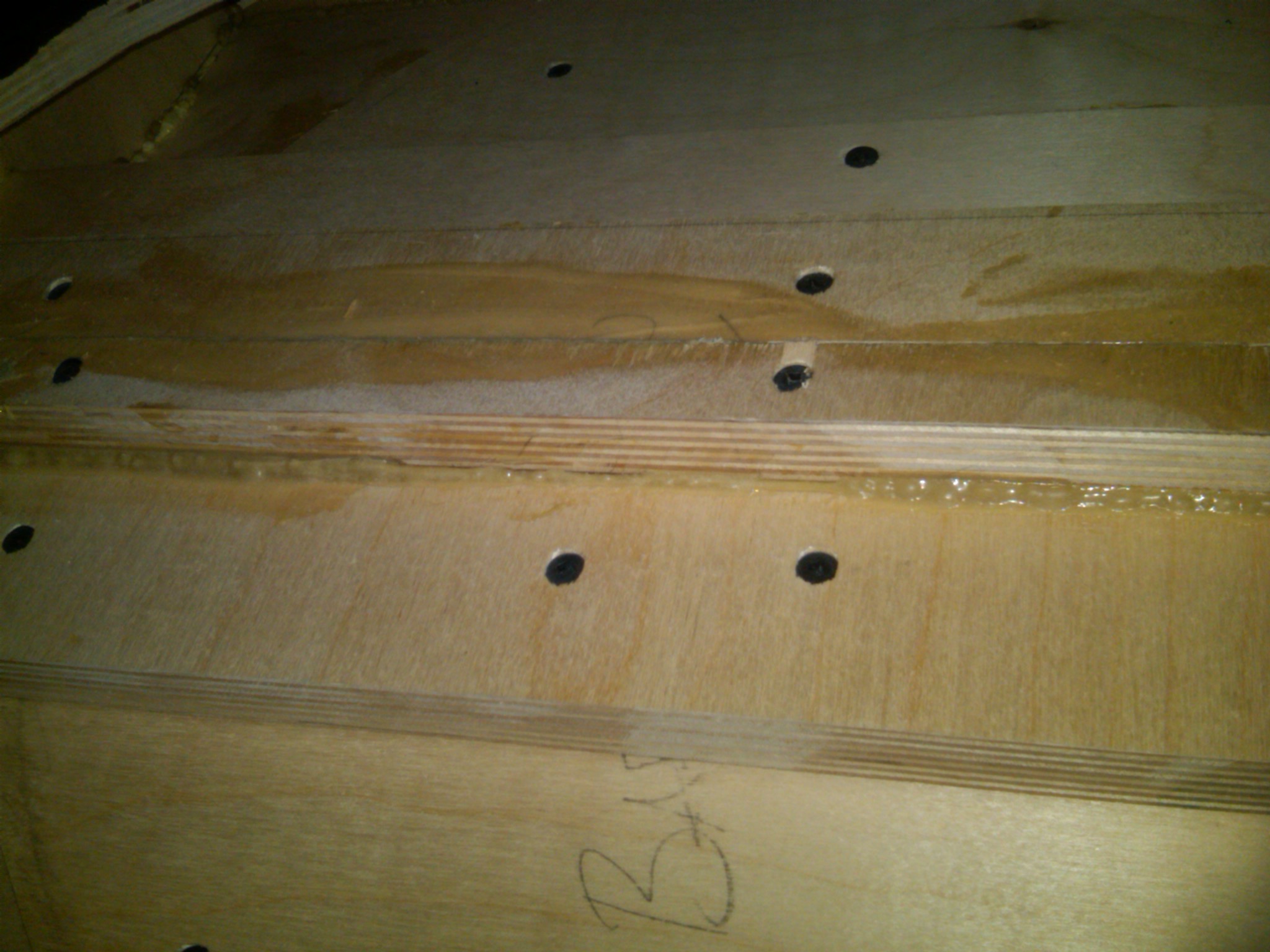

I was wondering if you would post what you did for horn correction
I took the baffle cut-out, a 3/4" piece 6.75" wide on top of it and a 3/4" piece 2.5" wide on top of that, glued & screwed to the opposing wall centered over the driver.

CRENSENDO looks like what I did too but I did cut another a smaller piece for the left side or the out side and that did the trick,I had also put 2 layers 1 was 80% of the cut out and the top layer was about 60% ,I put both layers in and I think it choked it off,Volume was low and bass wasn't there,immediate effect.lol. so took out one top piece from the small side of the throat,and it was on then sound and bass returned, I'll have to look for the pic I think I have one of it.

If anyone would like to help me out with a sim or hornresp here is what I change all the other measurements are the same,THANKS in advance,any help I can offer just ask!

I do need some help and I realize time is precious to all of us,Now I built the 1st box acording to #6 thread plans is this a mk1? I also built a second box I call it #2 it has cone correction incoporated in the folds,did this with a big protractor and followed the flow of the folds,My question is could I get you to model it and tell me where I'm at at S1 as far as I know right now both sides are equal ,I would think S1 needs to be smaller but I am not a cad or hornresp designer,I'm learning but neither are quick learning curves ,lol. I wished, but alot of varibles,so any suggestion,I am listening,I have the first box running good with the additions to the stubs with rings ,pics in the earlier threads,

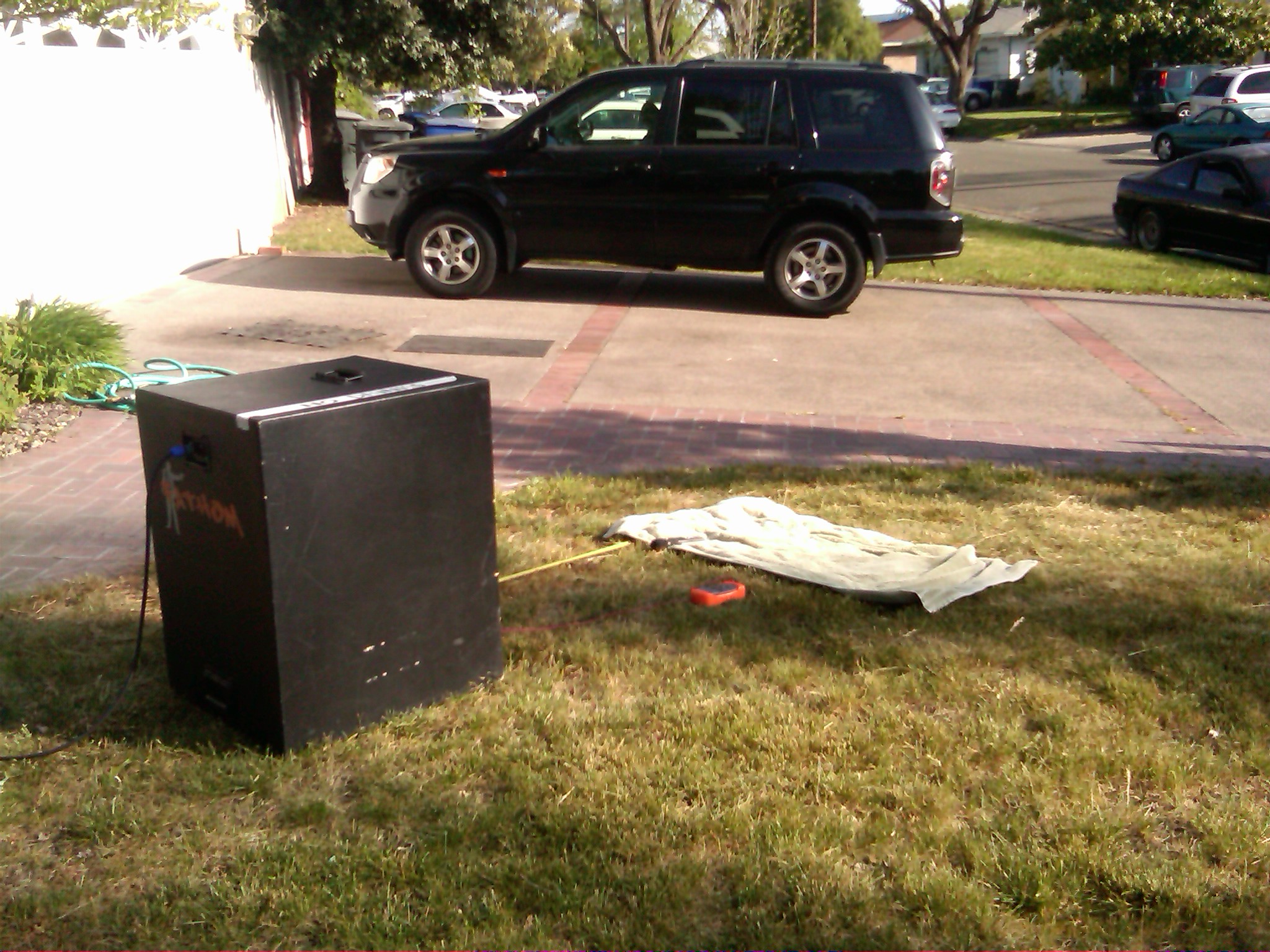

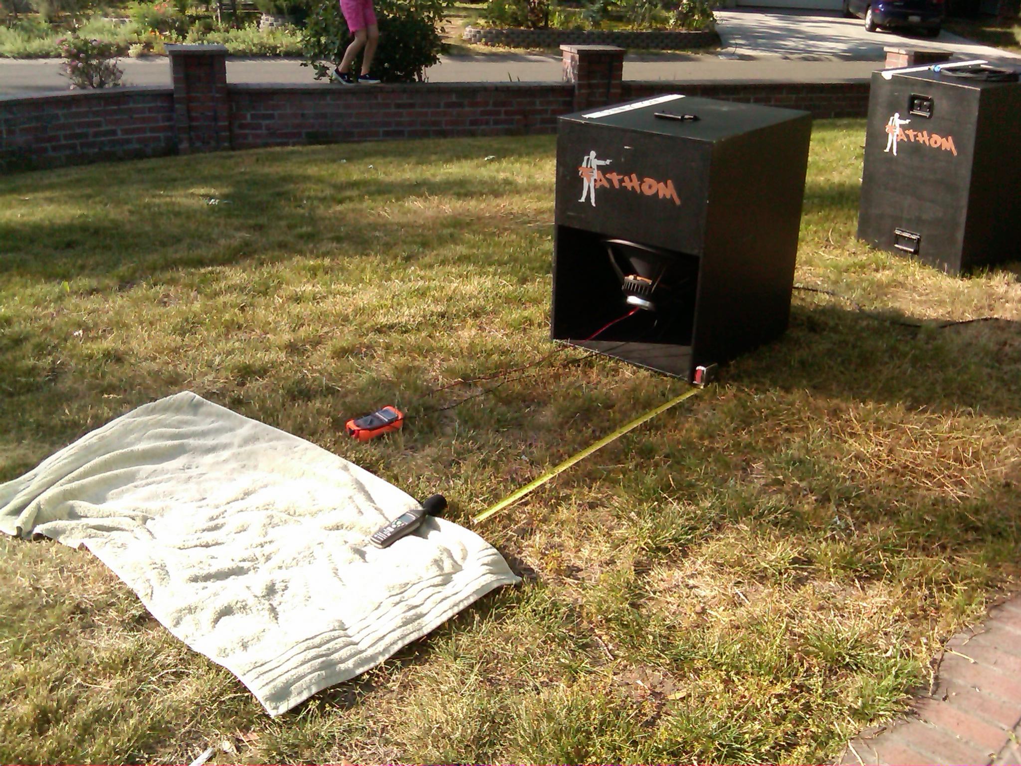

These measurements were taken as the amplifier just illuminated the limit light, which is WELL under the rated output power. My voltmeter does not climb quickly enough with 'Rec' engaged and caused it to go "Over" many times, so exact voltage values are unknown for that night of testing. I just used this info for comparison sake and hope to figure out my REW issue soon.
I only played/measured test tones without and with cone correction.
It appears the difference from 35Hz to 45Hz bettered (response dipped less) by 0.5dB with correction. As 45-50Hz did by 0.2dB and the 0.7dB dip @ 75Hz disappeared with correction as well.
So, we see response drops off a (small) bit more gradually while also 'fixing' very slight response issues with cone correction (I used roughly HALF of the 18SW100's cone volume for this test). For a few pieces of extra/spare timber? I'll take it! 🙂

Looking back at the post, you mention it was over grass. But how far away are the closest objects that can be sources of reflection? Anything bigger than a phone booth?

I've attached an image of the same testing configuration I used for SS15 measuring.
But, again, this was for comparison sake - cone correction vs without. Not highest-most-accurate-super-scientific-ness 😉 It was getting very late, dark and I wanted to finish the subs in time for a show. I was simply gauging the affect of the correction and if my cabs should have it.
