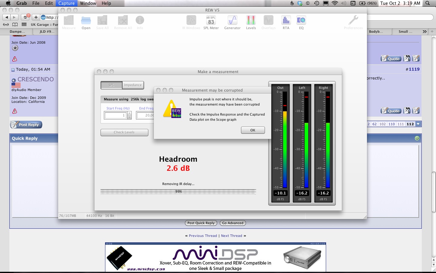

Still, when I go in to measure, I click "Check Levels" there, it pops up the "Signal too Low" warning before any audio is played. Then, audio plays for a couple seconds and stops (same happens w/measurement sweep). Maybe I should set up a loop for REW to calculate for sound card delay option.

Yeah, levels don't go up until I hear audio (mic "hears" audio, too). I get that Low Level warning before I hear audio. Maybe it IS a latency thing..

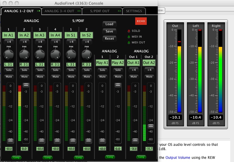

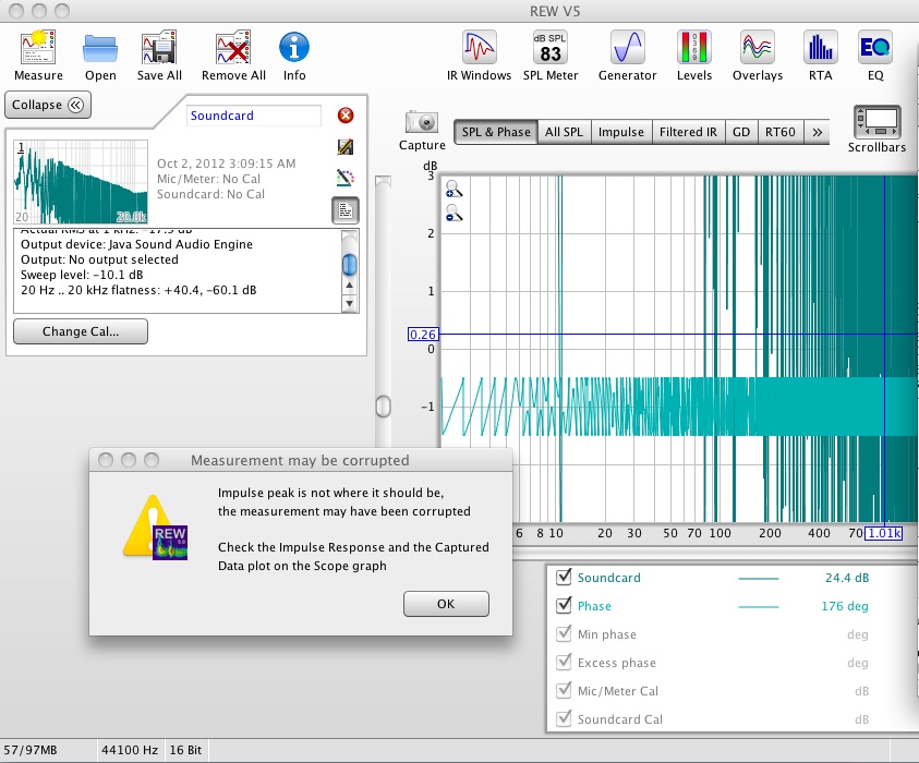

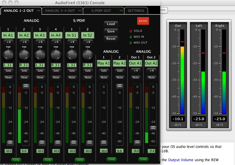

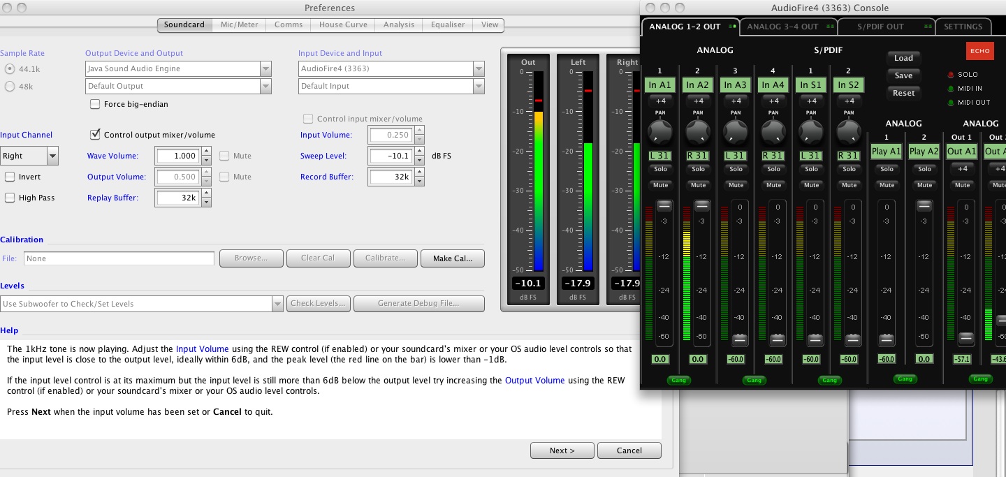

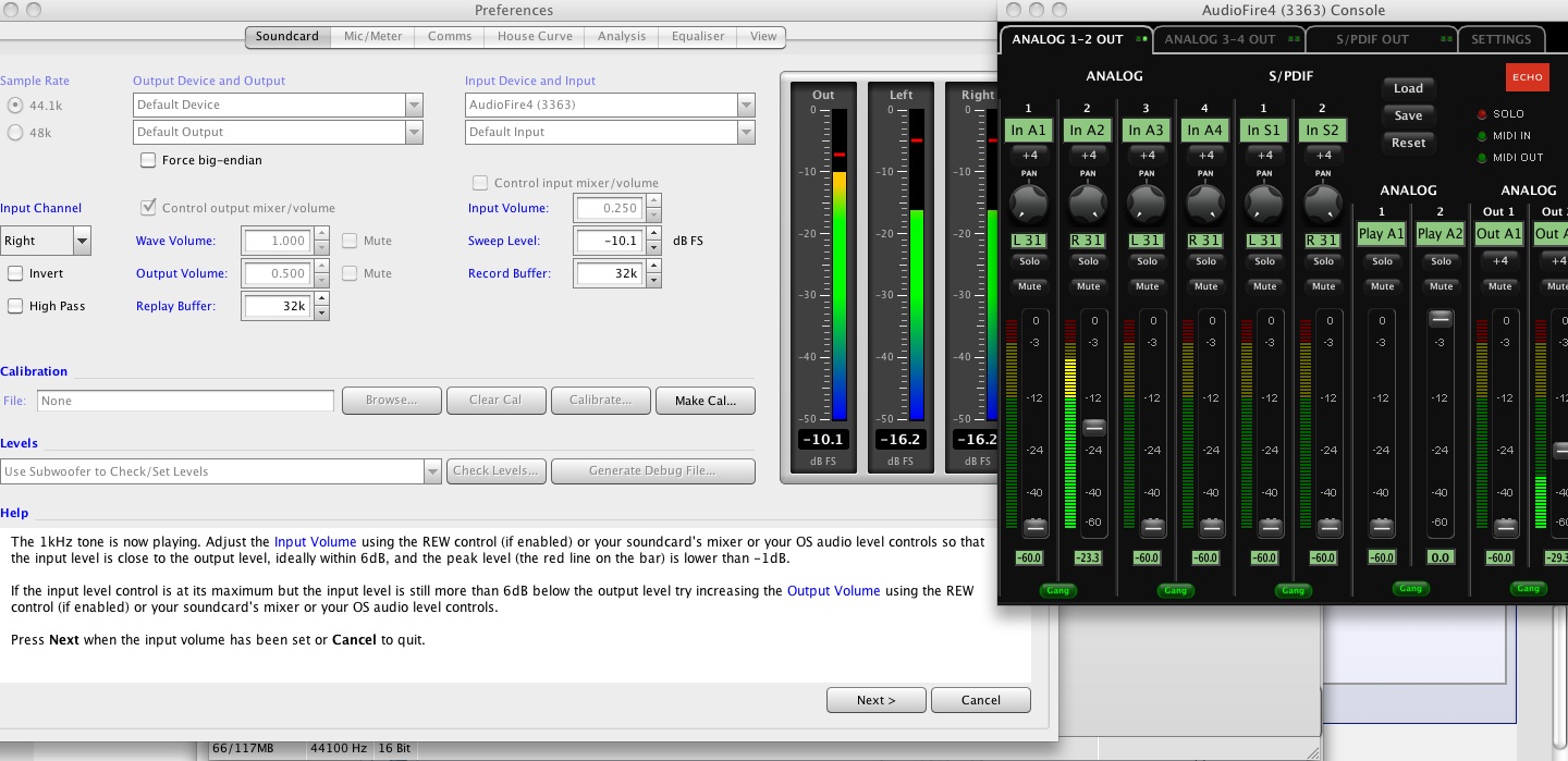

SO... REW on my Mac:
My only options under "Output Device & Output" with my AudioFire4 plugged in before start-up and System Preferences set to AudioFire4 are:
Default Device
Java Sound Engine (when selected, "Wave volume" is adjustable)
(I've tried both)
I've got "Output 2" on the rear of the interface connected to "IN 2" on the front of the interface. A 0.1dB change in the I/O of the digital console will be the difference between -14dB and complete clipping in REW, so I have to balance the faders to avoid that (lowering "In A2" on the console quite a bit and raising "Out A2" on the console gets me close). "IN 2" gain knob on the front of the interface doesn't really 'help' this balance - it just moves the dB level/position at which the dramatic level change occurs. I can't even get a good calibration reading without getting the corrupt measurement warning box.
Images of both default output and java sound output windows are below, as well as corrupt measurement warnings, 0.1dB difference comparison, fader combos and windows during calibration.
