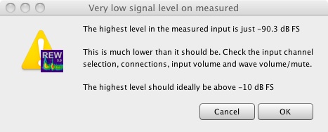

Measurement sweep setup suggestion:
- Attach multimeter to amp terminals or wire ends, speaker is not attached at this point.
- Use the REW generator to play a 60Hz sine wave and set amp output voltage, 4Ω: 2v/1m, 10v/5m, 20v/10m. Note the REW generator output level setting, and do not go higher than -12 to avoid digital clipping. Ensure there is no clipping elsewhere in the signal chain.
- Start measurement sweep dialog, set output level to the same value previously used in the generator, set frequency of sweep to 20-300Hz and select the shortest/128k sweep length and set the number of sweeps to 2.
- Click the start measuring button, if you have too much or too little input signal make corrections at the mic/input level side only.
Before I click "Start Measuring" I clicked "Check Levels" to be sure everything was still even - yet, it popped up with "Level is Low" before audio was heard through the sub
So, the measurement process stops, but the 2 sweeps continue to play.
I get this dialog box (attached) before any audio is played

When I enter the SPL Meter for calibration, it supplies a filtered pink noise signal, not sine wave choice. When I enter the Signal Generator, it doesn't show an incoming signal, just outgoing and "RMS Level dB FS" adjustment. Where do I need to be and what do I need to do to get this done properly?
Sounds like REW most likely just needs to be restarted...
Check the settings for the correct device and R/L channel selection = same as calibration.
Did you plugin a USB sound card after starting REW? = restart REW
Are the only things connected to the (USB?) sound card the line out to the amp and the mic cable = no other loop

Settings for devices were same as sound card calibration - I'll calibrate again next time I test
Firewire sound card was plugged in before starting REW
Loop was disconnected after calibration
Firewire sound card R out to Y-cable to amp rack L & R
dbx RTA-M into firewire sound card R
If REW sees good input levels from your mic when you check levels it "should" have no problem with the sweep.
Yes.Phantom power on?
Before the measurement attempt, I went into Preferences > Levels > Check Levels. I then set the L & R levels with the gain on the sound card to get it to ~18dB FS, like suggested in the dialog box. Maybe I'm doing something wrong here.
You should only have to adjust the input gain for the channel the mic is on, it's the one that matters...
Sorry, it should've read, "I then set the R level (mic input) with the gain on the sound card"
Actually it seems odd that you could or would see input on the unconnected channel, the gain for the unconnected channel could be turned down IMO. Is the mono button or monitor button switched on?
I missed this...When I enter the SPL Meter for calibration, it supplies a filtered pink noise signal, not sine wave choice. When I enter the Signal Generator, it doesn't show an incoming signal, just outgoing and "RMS Level dB FS" adjustment. Where do I need to be and what do I need to do to get this done properly?
you open the generator and start the 60Hz sine before you start to cal the meter.
