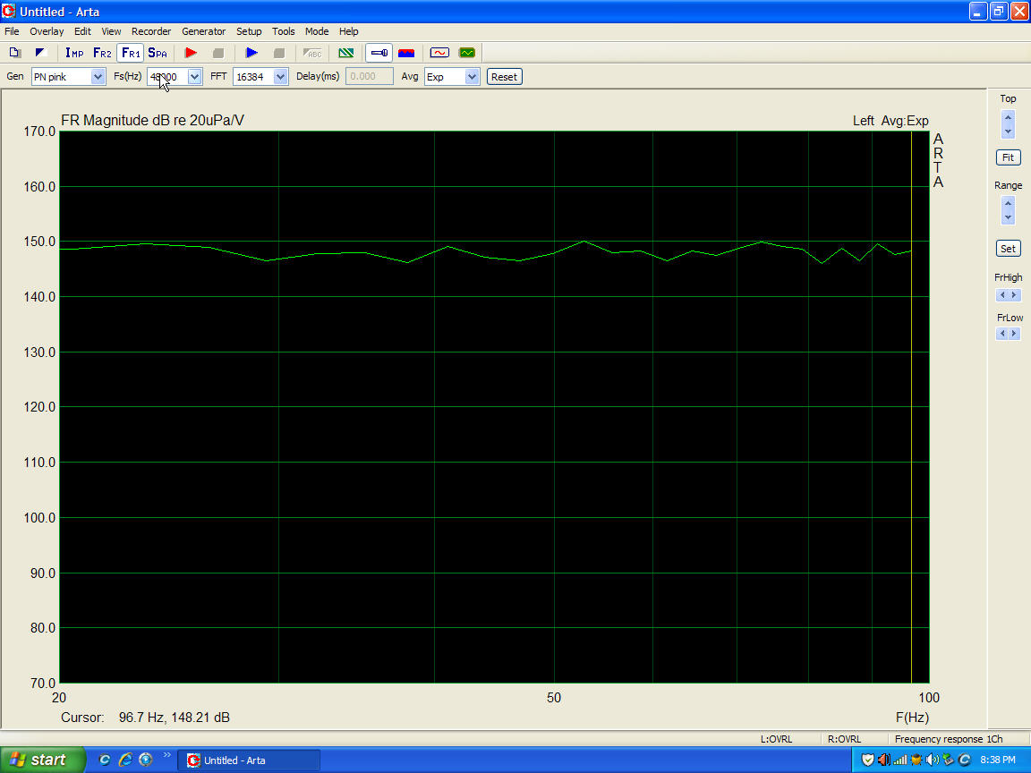

TH-18 Flat to 35hz! (Xoc1's design)

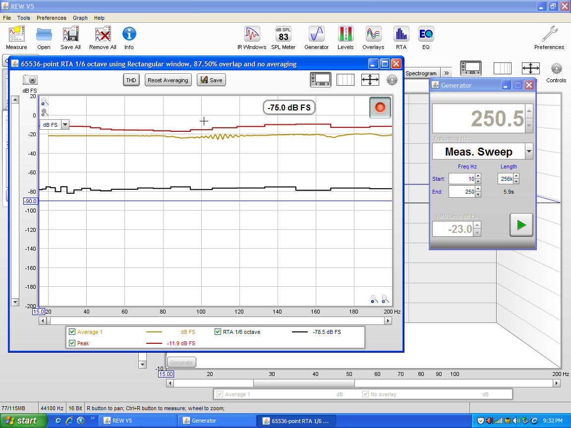

hi all,😀
Is this a better responce ?
Thanks,
NS🙂

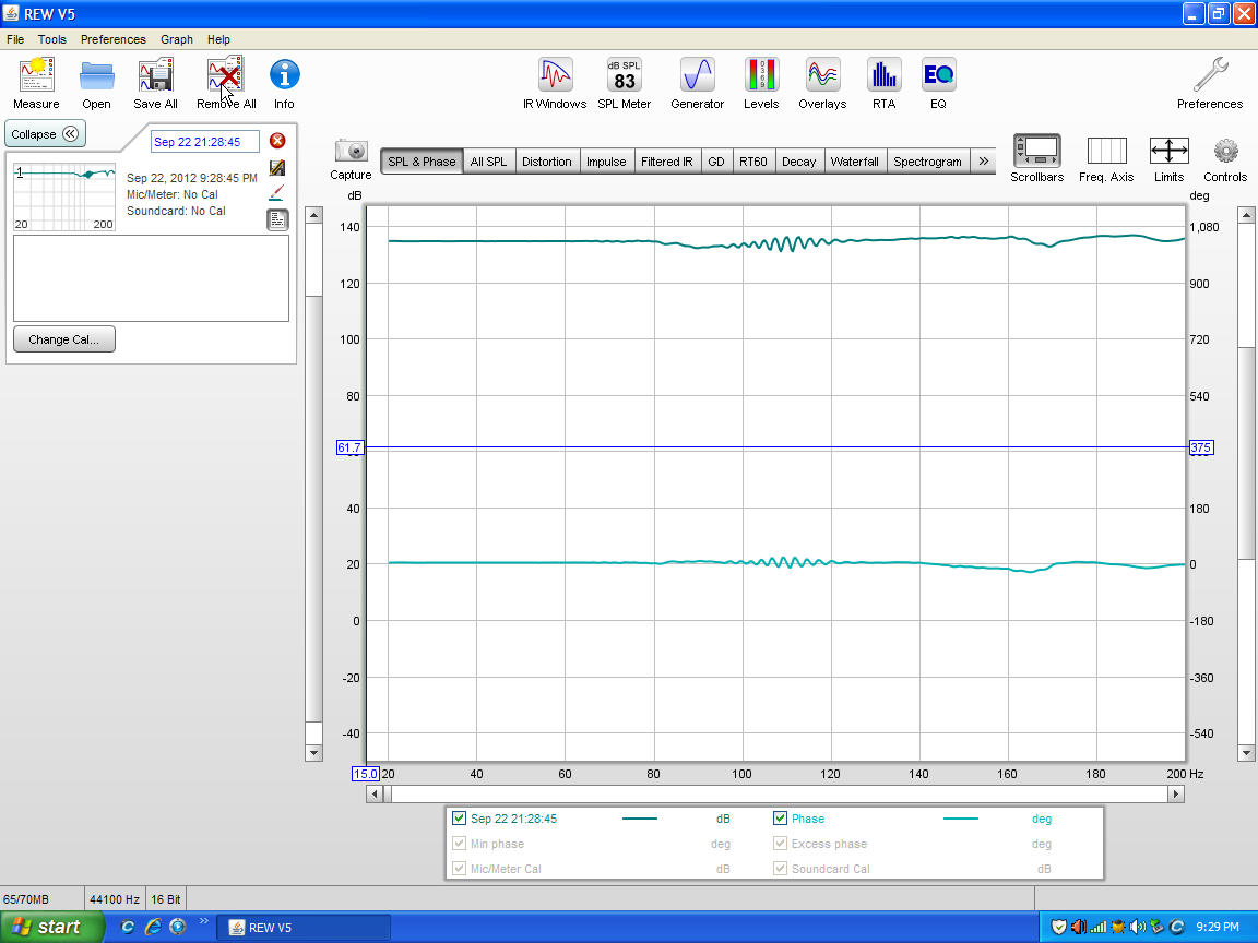

I noticed voltage fluctuation (+/- 0.5v) during two different frequency sweeps I have. Is this normal? Has anyone measured voltage at the amplifier during an REW or Smaart freq sweep? Does voltage fluctuate (+/- 0.5v)?
The sweep is a sweep and if you are using a multimeter to measure the sweep you are subject to it's averaging accuracy, thus using a sweep to set a level is not recommended due to the variable nature of the signal/meter combination. If you are not measuring at a large level of power these sweeps should not cause the amp output to sag. At high output levels you could monitor the DC supply rails in the amp to see if they sag much. But generally speaking if the amp 2kw+ amp is sagging at 100w or something like that just find a dumpster for it and get a real amp. 😱
Measurement sweep setup suggestion:
  • Attach multimeter to amp terminals or wire ends, speaker is not attached at this point.
  • Use the REW generator to play a 60Hz sine wave and set amp output voltage, 4Ω: 2v/1m, 10v/5m, 20v/10m. Note the REW generator output level setting, and do not go higher than -12 to avoid digital clipping. Ensure there is no clipping elsewhere in the signal chain.
  • Start measurement sweep dialog, set output level to the same value previously used in the generator, set frequency of sweep to 20-300Hz and select the shortest/128k sweep length and set the number of sweeps to 2.
  • Click the start measuring button, if you have too much or too little input signal make corrections at the mic/input level side only.
  • Look at impulse response and adjust IR windows to 25ms left and 150ms right, then click Apply Windows
  • Now look at FR and phase.
Note:
If you use a C-weight SPL meter to calibrate your setup with the 60Hz sine wave the actual level is ~.9dB higher than indicated due to the roll off of the C-weight filter.
If one is to be able to make valid comparisons to other anechoic measurements it is important to measure outdoors well away from large reflective surfaces and use appropriate time windowing on the measurements to produce an accurate response.

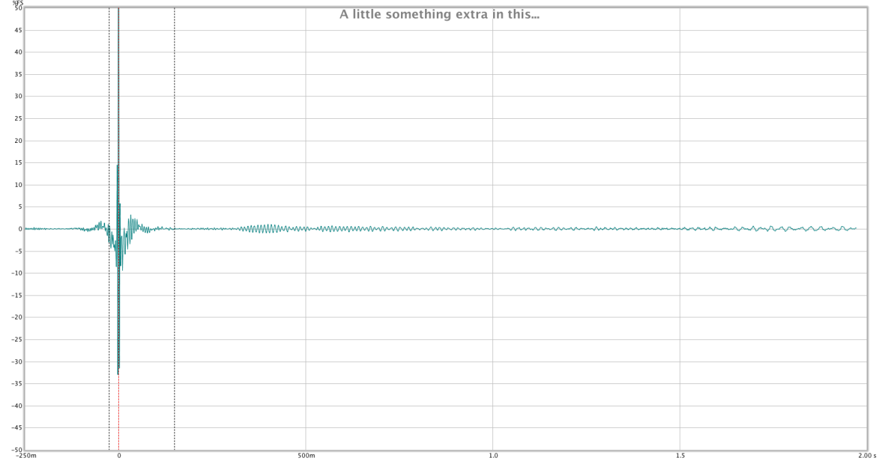

I dunno it looks funky with the squiggle in there, can you e-mail the REW file?
Hi NS,
I was not paying attention, I see the input level is low @ -75dB. Your mike missing it's phantom power?
The source of the squiggle is something late in the impulse response and a little noise possibly.
Was using a multimeter to measure very low voltage (>2v). I was under the assumption the sweep swept thru frequencies at the same level - that's what raised this question. I wasn't using the frequency sweep to set level.
Gernerally I think unless you have a "high end" HP or Agilent meter and a perfectly flat output on your sound card you should expect the meter to waver on a sweep.
If you look at the loopback calibration for your setup you can see how much correction was applied to flatten the response. Obviously this is a correction of the cumulative deviation of both the input and output, but the early rolloff of a sound card would be a good reason to see the meter waver during a sweep, but not at a fixed frequency.
Don't sweat the meter, the calfile covers anything in the the loop at the time it's made... Leaving the mic, amp, speaker, and envrionment. You can cal with the amp in the loop if you take care with the voltage, but the amps noise floor may intrude. Probably better to just check the amps FR with your setup, remember to turn off the HPF 😉 You might want to lookup the curve for your mic though :grumpy:

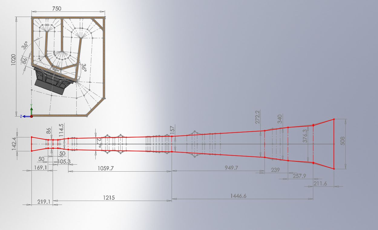

I'm really curious as to where fudging S2 via an inflated cone correction became a good idea? The 18SW115 is really not going to make it to 60mm p-p without dammage, in fact it is hard to drive to 40mm p-p, and that's with HUGE amounts of power.
Hi Dan
S2 compression ratio is currently about 3:1 but this includes the cone correction volume. I'm still unsure about if to stick with this value or reduce the compression ratio. If I can I might reset the geometry for a bigger S2 value but leave enough space for users to be able to fit a double packing piece if needed, to reduce S2 for those users who have the most robust drivers.
What would you think is an optimum S2 compression ratio for budget and top end drivers?
Please note that nothing is completely set yet and I am still tweaking the design. I felt that it was time to post the work in progress and get some collaborative input.
Regards
Martin

Hi All

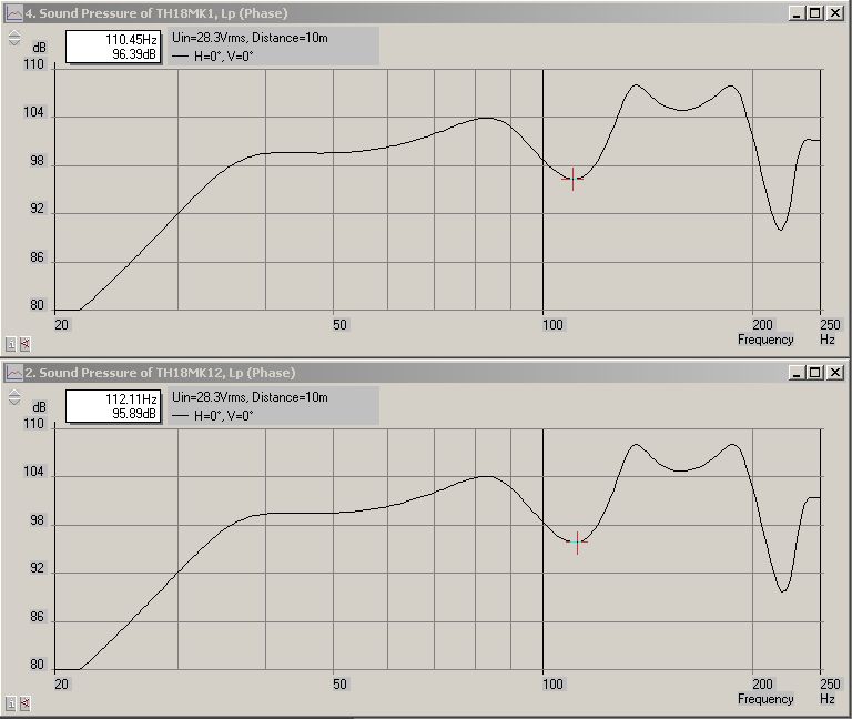

Re hash of TH18 mk1 layout (TH18 mk1_2)
Compression reduced to approx 2.5 :1 . Remembering this includes the cone correction volume so still fairly radical for a DIY TH!
This has increased the dip at 110 hz slightly, but not too much impact on the overall response in Akabak - Yes that is 104 dB@ 82 hz at 1 watt into 8R, in theory at least.🙂
As usual please scrutinise closely for any errrors!

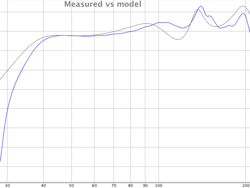

I would not sweat the dip, I think it'll work out just fine in real life:
