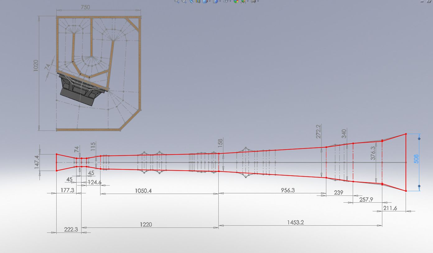

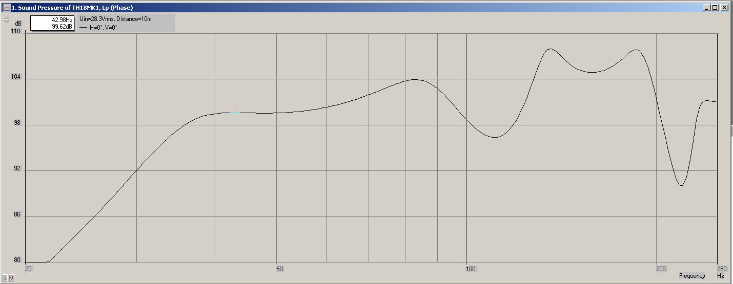

Is this any good?

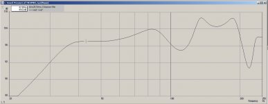

Maybe I need to sleep. I'm a bit concerned about the 110Hz dip to 96db
BTW this is still with the Precision devices PD1850.
Hopefully I haven't made any errors. Its close to the Hornresp response.
This version is slightly bigger by an inch front to back -
Think that's enough for today
Graph attached and text file for the akabak users to play with.
Regards
Martin (Xoc1)

Does Hornresp show a more exaggerated dip? Just asking since HR exaggerates peaks & dips and I didn't know if akabak did the same.
(I've been crossing over at ~88Hz - so, no issue for me)
The driver I'm using (18SW100) results in a higher f3, unfortunately. Not sure if a few inches here or there would get a little bit of that extension back without sacrificing output.

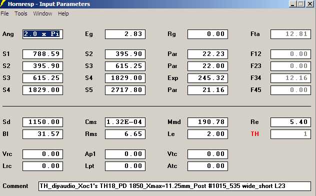

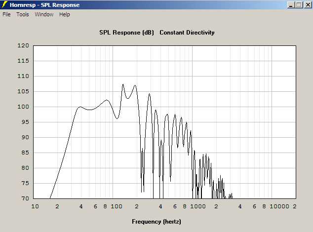

Hi Martin,I'm a bit concerned about the 110Hz dip to 96db
Try to trade the energy of the 82Hz bumb for the 110Hz dip by using their quarter wavelength to determine their position within the horn. My rough guess is that the vertical board (that is connected with the top-panel) needs to be tilted over (clockwise) and make it parallel to the board on its left.
Lol, that was a huge calculation mistake 😱 so forget my earlier panel suggestion... (some progs need dots where we use comma's in Holland)
Anyway, did a Hornresp model based on a total volume 375,88 Litres of your Sketch. So S4 has become smaller to compensate for the correct total volume. Their seems to be a big difference between Akabak and HornResp in the outcome at the First System Resonance.
Small update, corrected the system volume to 362,3 because of the two corners and driver plus changed the expansion to expo.

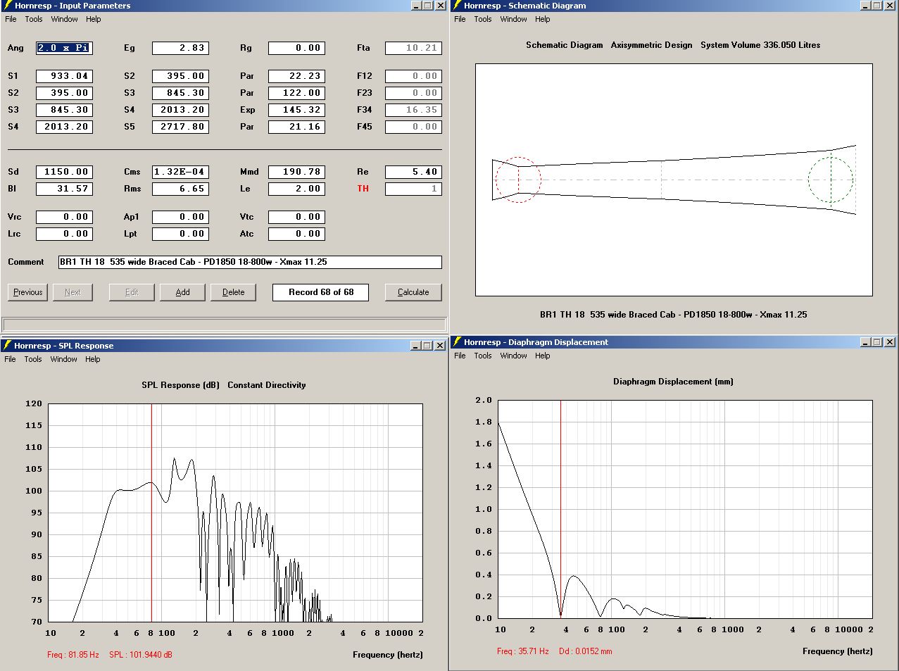

Hi All
Hornresp is so useful but there are always compromises that need to be made for the sim model.
Attached is one of my alternative HR sims
Volume of the unfolded horn layout is 345.7 litres not allowing for the bracing.
Volume of sim is 336 so not unrealistic - I do feel uneasy about sims that exaggerate the internal volume of a speaker cab.🙄
Where it gets complicated is having to run 2 sims to try to understand what is happening with the various sections of the horn.😕
Regards
Martin

Hi Martin,
Another great piece of work, Posts 1010/1015
I noticed that the S1 duct height dimension 147.4mm x 535 mm internal width result in 788.59 cm^2, the Hornresp Input says 933.04 cm^2 (in the Hornresp simulation this doesn't much matter, but only one should be correct).
I think you are on the right path with using AkAbak for this one, Hornresp just doesn't seem to get us there. I tried a short L23 together with an arbitrarily choosen S4 (to get to your layout volume of 345.7 L). Looks very much like what Djim came up with?
