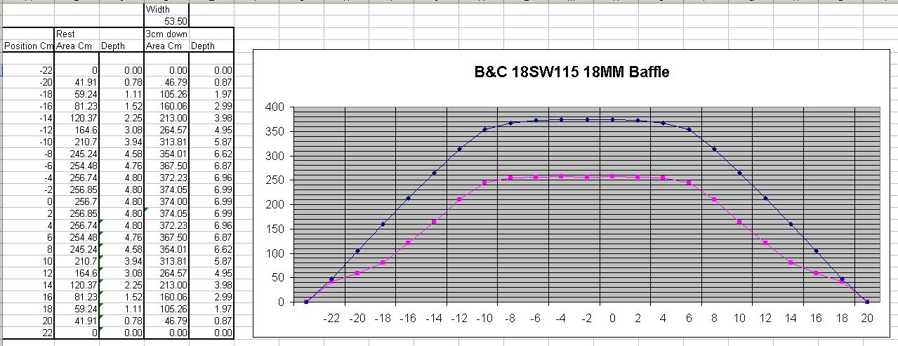

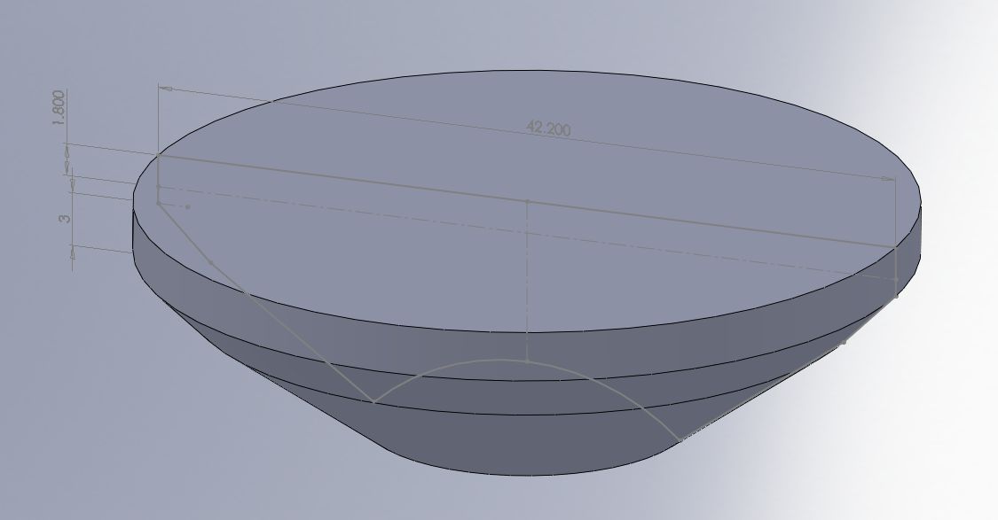

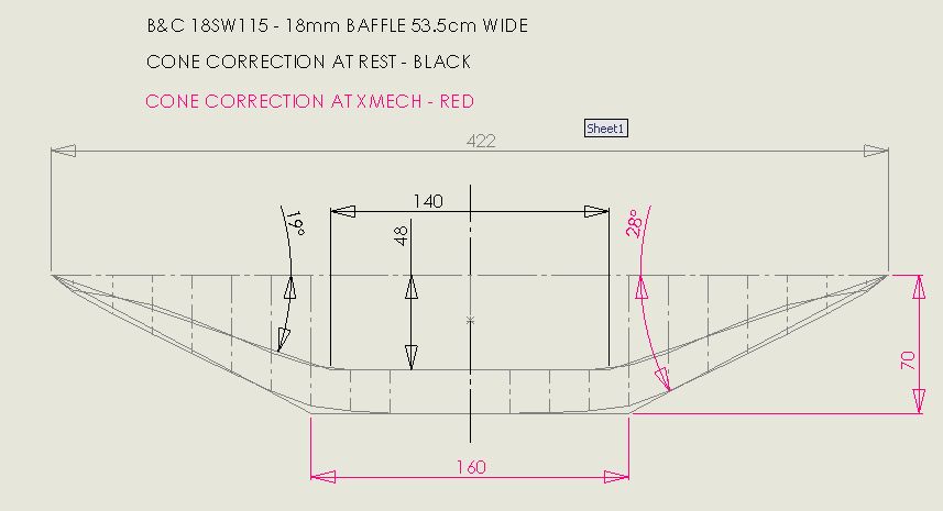

Hi Martin,
I will try to explain. The cone correction makes it function like the sim, which increase the output at the lowest part of the bandpass.
What makes the driver loosing control over the excursion is the 'travelling' of the high pressure zone as result of the excursion (= changing cone volume) in relation to a 'not moving' cab. To keep the control over the excursion, the "Stub" (or "V" in your case) needs to have the highest compression factor, even when the cone moves away from the stub.
Hi Djim

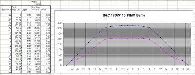

I have repeated the cross sectional area measuring process.
I used the same dimensions as before.
B&C 18SW115 cone mounted on 18mm baffle 53.5cm wide. but added 30mm offset as Xmech.
Areas were measured at 2cm cross section slices - areas added to the spreadsheet and a cone correction curve drawn out to suit the TH18 design.
The result is that when the cone is at 30mm Xmech down, the slope of the cone correction curve is approx 28 degrees.
So I assume that if the slope of the cone correction ramp is bigger than this angle then the high pressure zone will not 'travel' as you described.
Screen grabs of cone model, spreadsheet, and averaged cone correction slope attached.
Regards
Martin (Xoc1)

Hi Martin,
That’s some great modelling again, Martin. I agree with your reasoning about the angle of the cone correction ramp, that it needs to be higher as the 28 degree angle of the cone correction curve. What does surprise me is to see how the centre is expanding in a larger amount compared to the sides. Not sure that is best interpreted into a practical fold, any ideas about that?
Hi DjimHi Martin,
I don't see the different shape being a problem.
The difference from the centre to the sides changes as the volume we are accounting for is round and the cone correction is linear. The 3 lines I have simplified it to are just an approximation to enable the opposing shape to be built in timber.
If you look at this screen grab you can see that the lower cone correction line representing xmech having a wider flat face actually still represents a fairly linear path to the opposing timber built cone corrected throat.
An imaginary line drawn thru the imaginary corners seems to line up quite nicely!
Regards
Martin (Xoc1)
Hi Martin,
Indeed those imaginary corner lines seem to line up very well, thanks for the visualisation.
