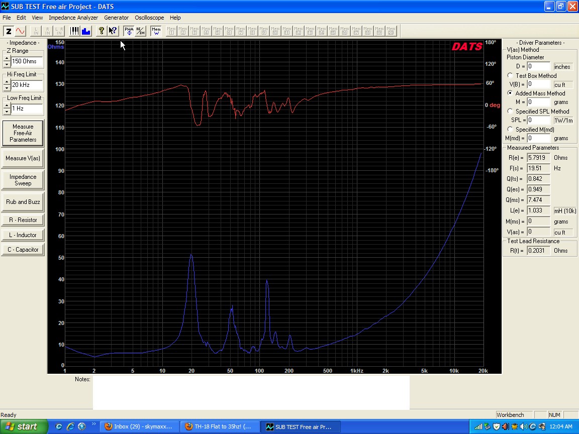

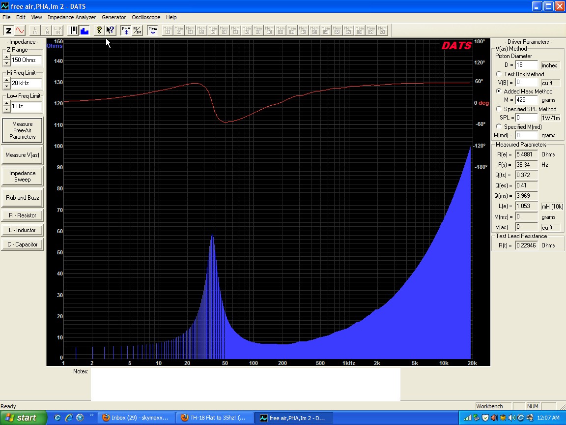

I will go look for that ,I am not a speaker tester new ground so to speaker ,One speaker is built and working,lol. I did run a Z and a free air in DATS,I did download ARTA and have been digesting it's contents,I'll find REW and check back,It is playing and sounding good still a little cone stiff but getting better sounding each time I play it.
I f you would like to tutor me along, I need the help ,mostly understanding the results I get ,the graphs and plots I am not familiar with!

yes got it done ,sorry,

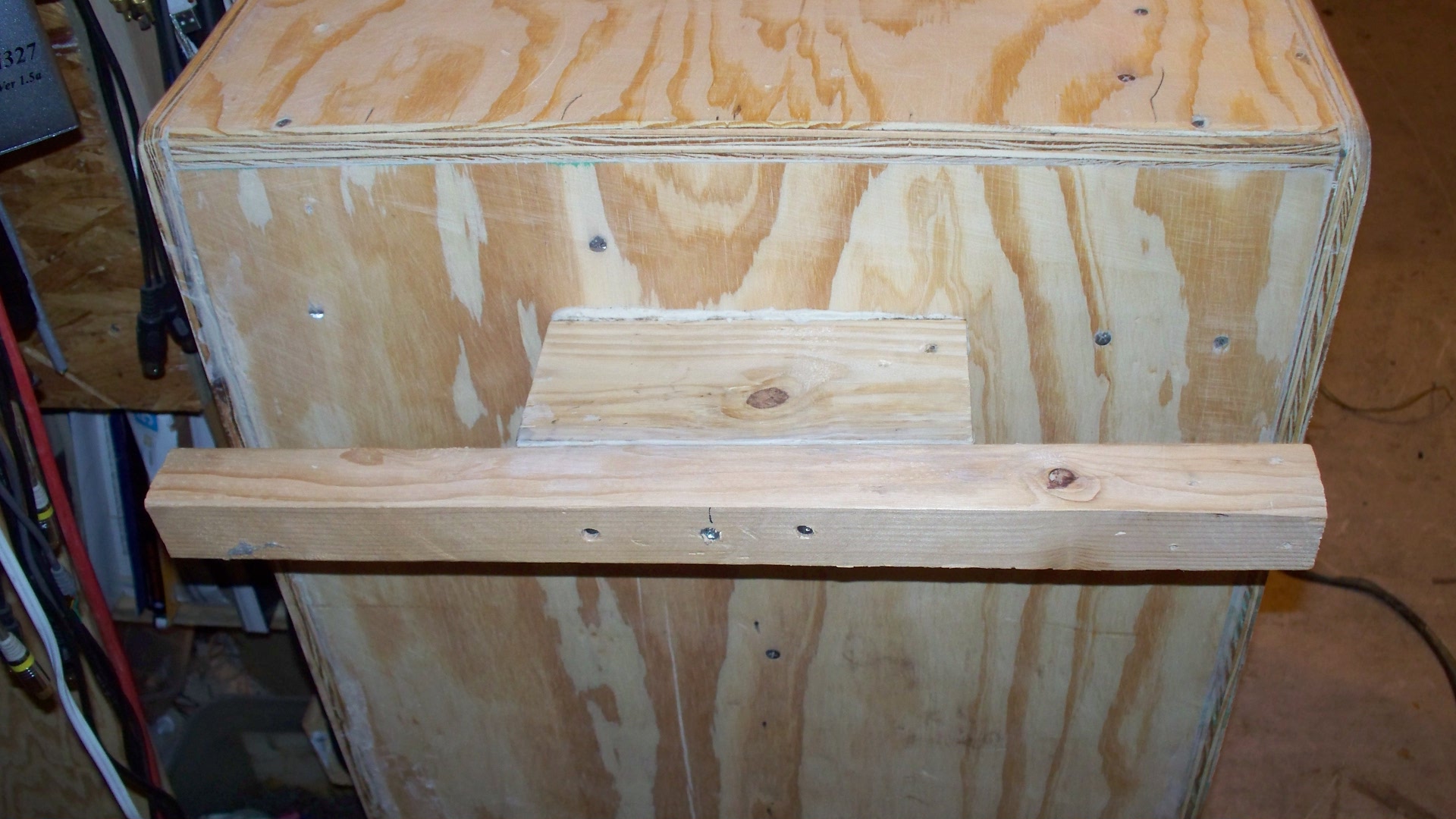

I made some more pics I have to put in one more stiffener and put the side on,

I see you put insulation in the back top corner where a lot of us cut holes for handles. Do you plan on putting your handles on the exterior? Or flush/cut-out somewhere else?
The next thing is some WHEELS this is getting heavy and will be more than I can lift when the speaker goes in,lol thinking about doubling the bottom panel ot at least some large pieces for the casters to mount on,
Time to build the voltage probe for ARTA,,,,,,
NS
You could put some casters on the back bottom diagonal panel - they'll also act as tilt-back prevention there. Total height of the casters will have to be smaller than 4" (IIRC) if you want them centered back there. I have exact dims somewhere...and what casters I went with somewhere else...
