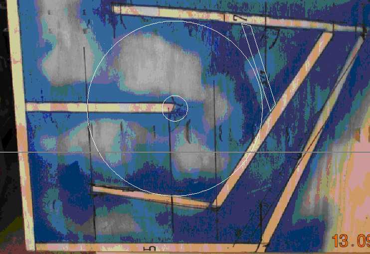

This is for 'regular' drivers. For drivers with extreme Xvar and Xlim and high Bl, the "V" shape needs to be lowered even further... If you would do that for 'regular' drivers they will run into their dynamic compression too soon. So my suggestion is to make two drawings for each type of driver or go for an in between solution with an attachable piece on top of the "V" for the strongest drivers...
Follow up for post#917
In order to compensate for the changing cone volume as result of excursion (towards S4) you increase the compression factor at S2 by lowering the "stub" or "V".
In order to compensate for the increasing 'overall' compression when the cone moves into the other direction, you need to decrease the compression by making the base of the "stub" or "V" smaller.
(see my ealier post on 'ideal' models)
So just wondering... What are you basing all of this on? Is it from a computer simulation or just an educated guess? Not trying to argue im just curious.
For drivers with relatively low xmax, like the 18ps76 (8mm?) Does one have to worry about changing volume with excursion as much? The cross sectional area will only change ny about 10% with full excursion, which seems to be an acceptable tolerance.

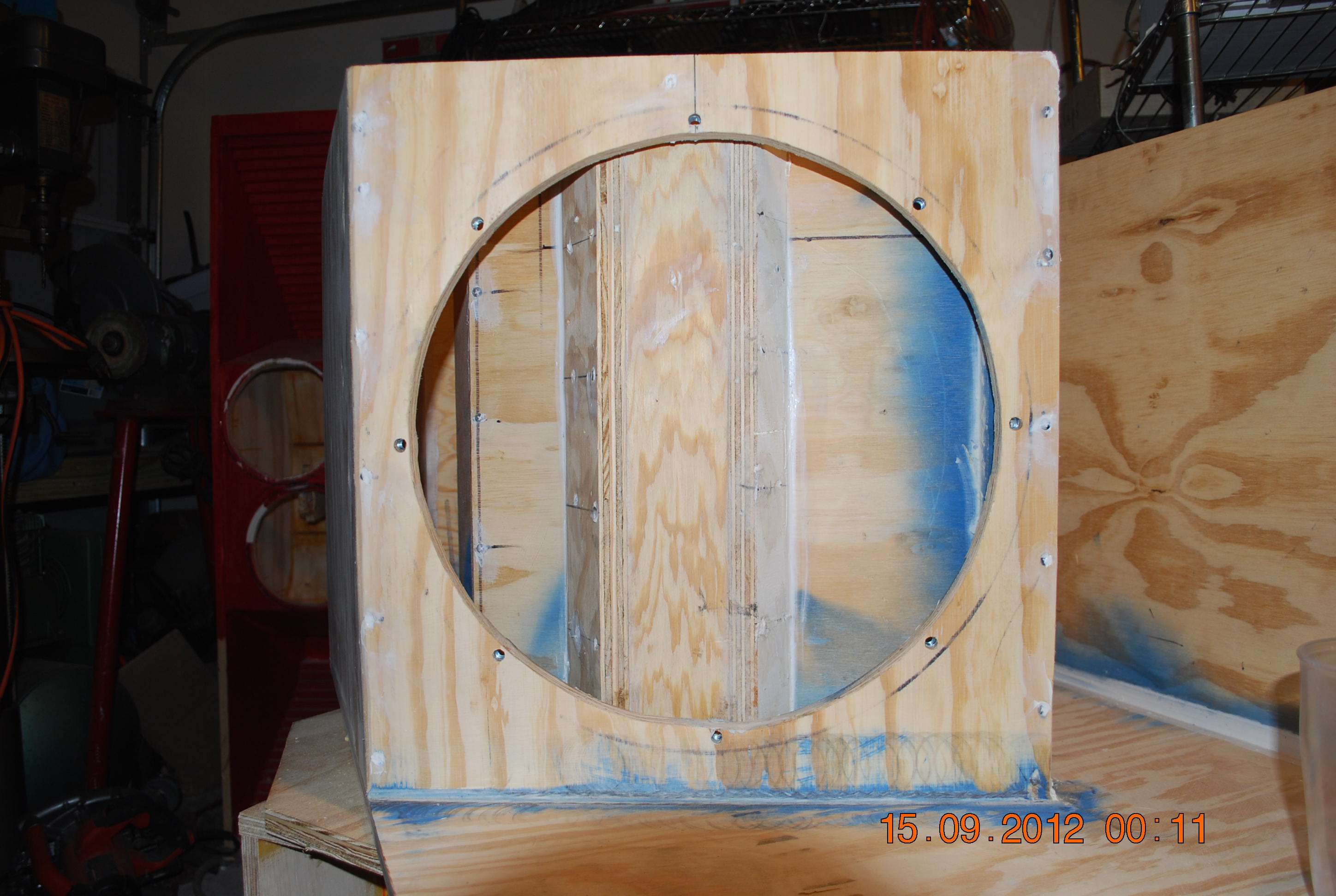

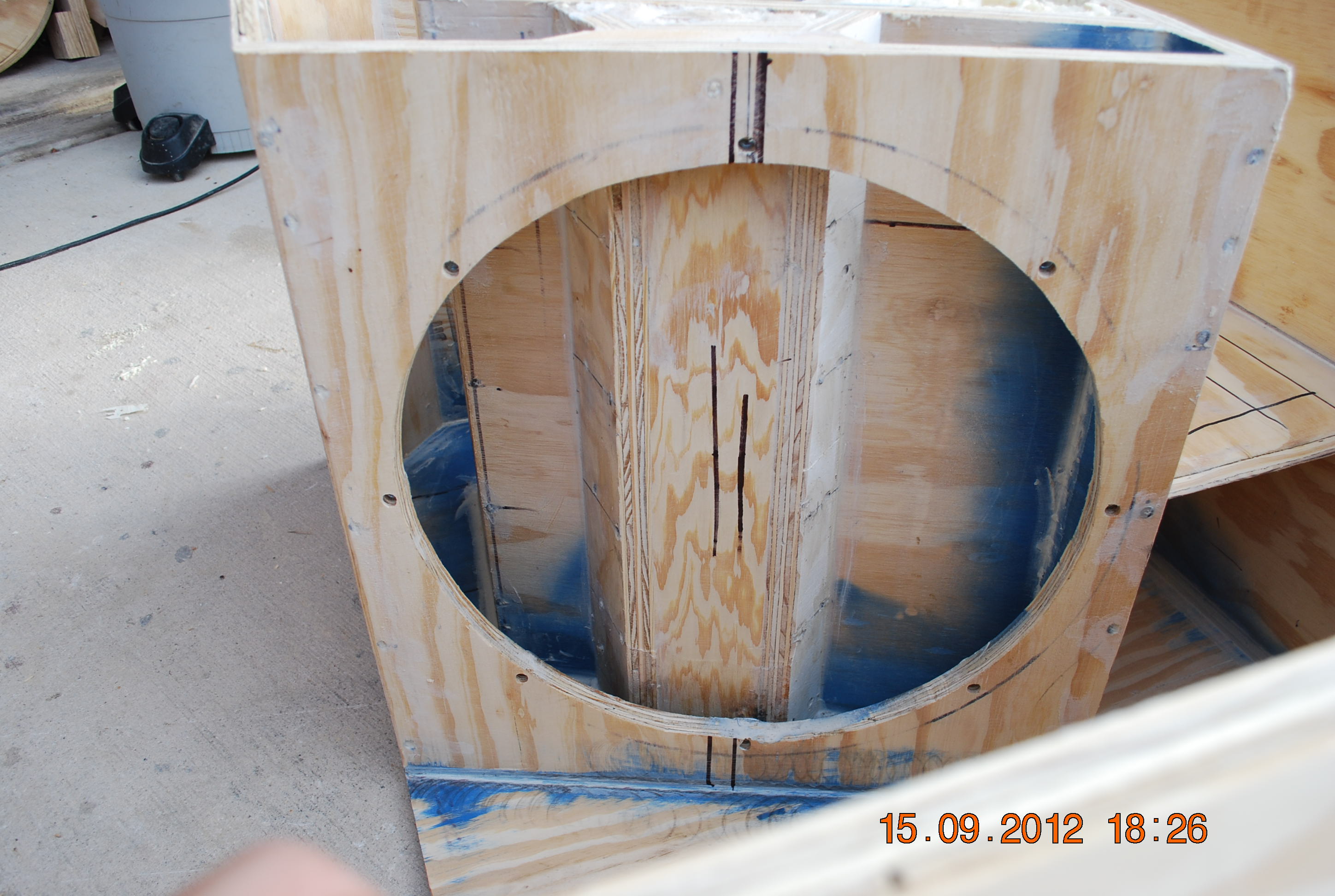

I added my cone correction to his original plan. Mount the baffle cut-out on the panel the driver faces, centered with the driver (use a right angle or T-square to find the center on the opposing panel). Then, measure & calculate how much volume the 18PZB100 has. I screwed and glued strips of wood on top of the baffle cut-out (also centered) to make up my preferred cone volume amount (try somewhere between half the cone's volume and up - I went with half and had nice results). I'll be able to take a picture of what mine looks like pretty soon.

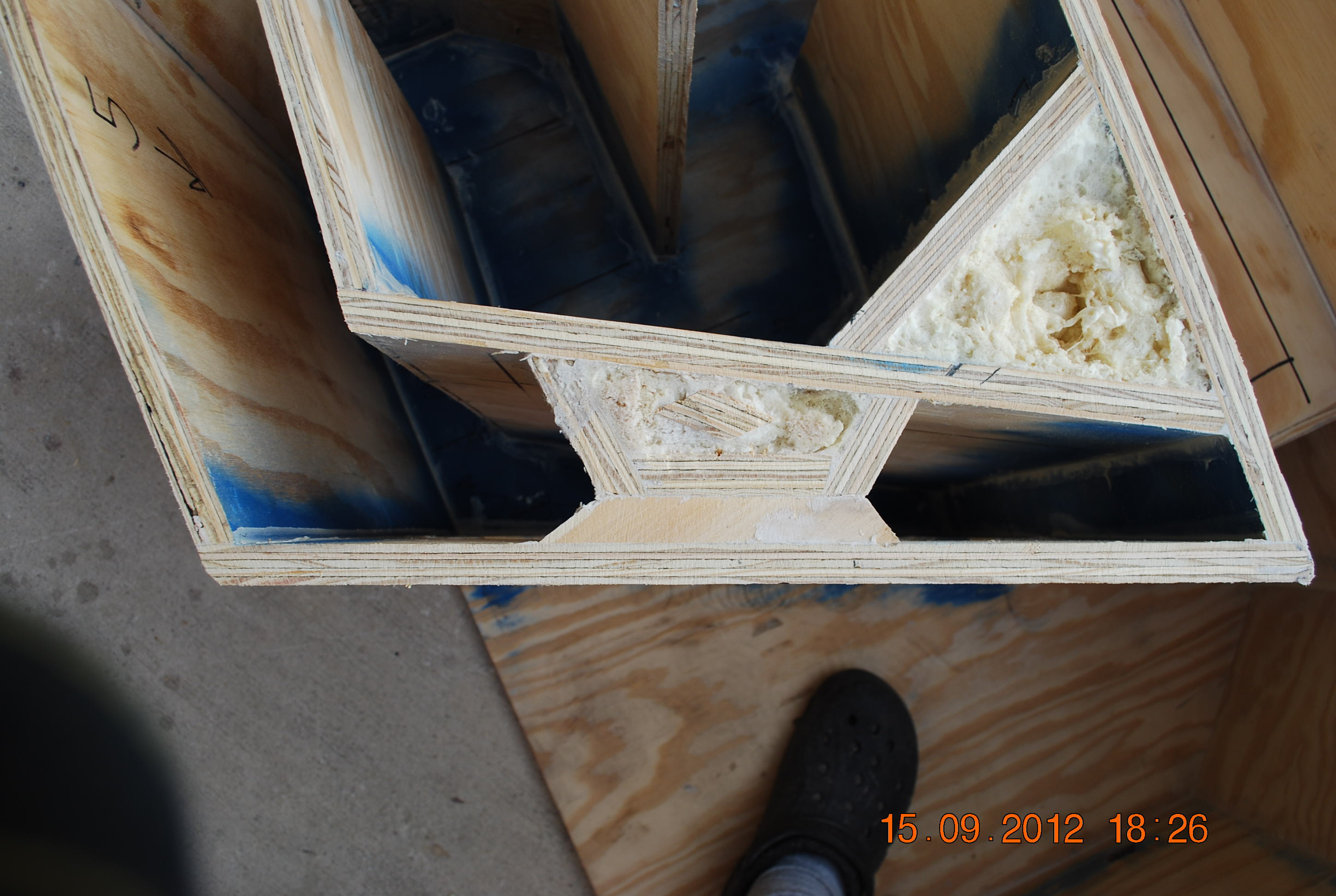

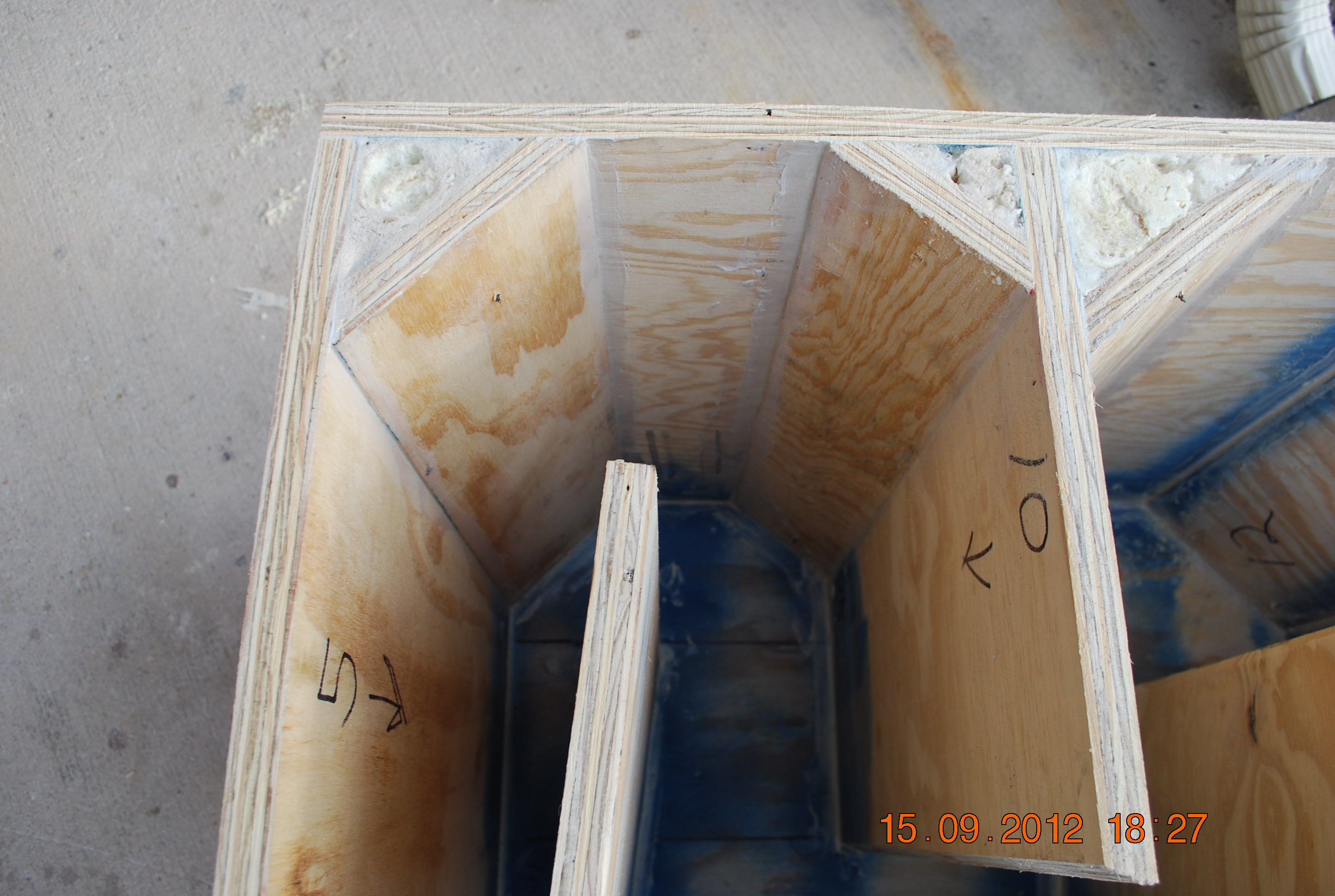

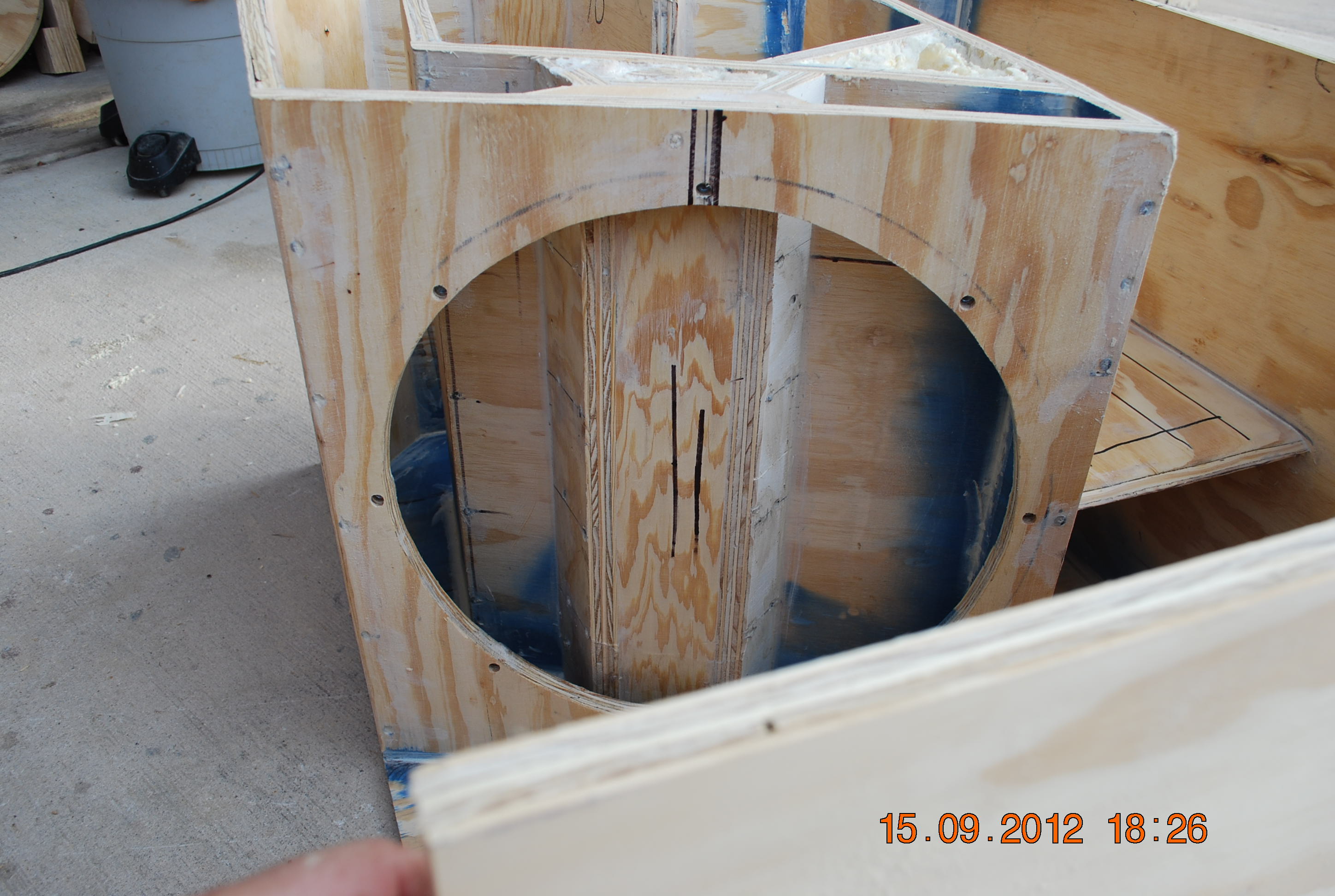

here's some more Pics
Hi,😀

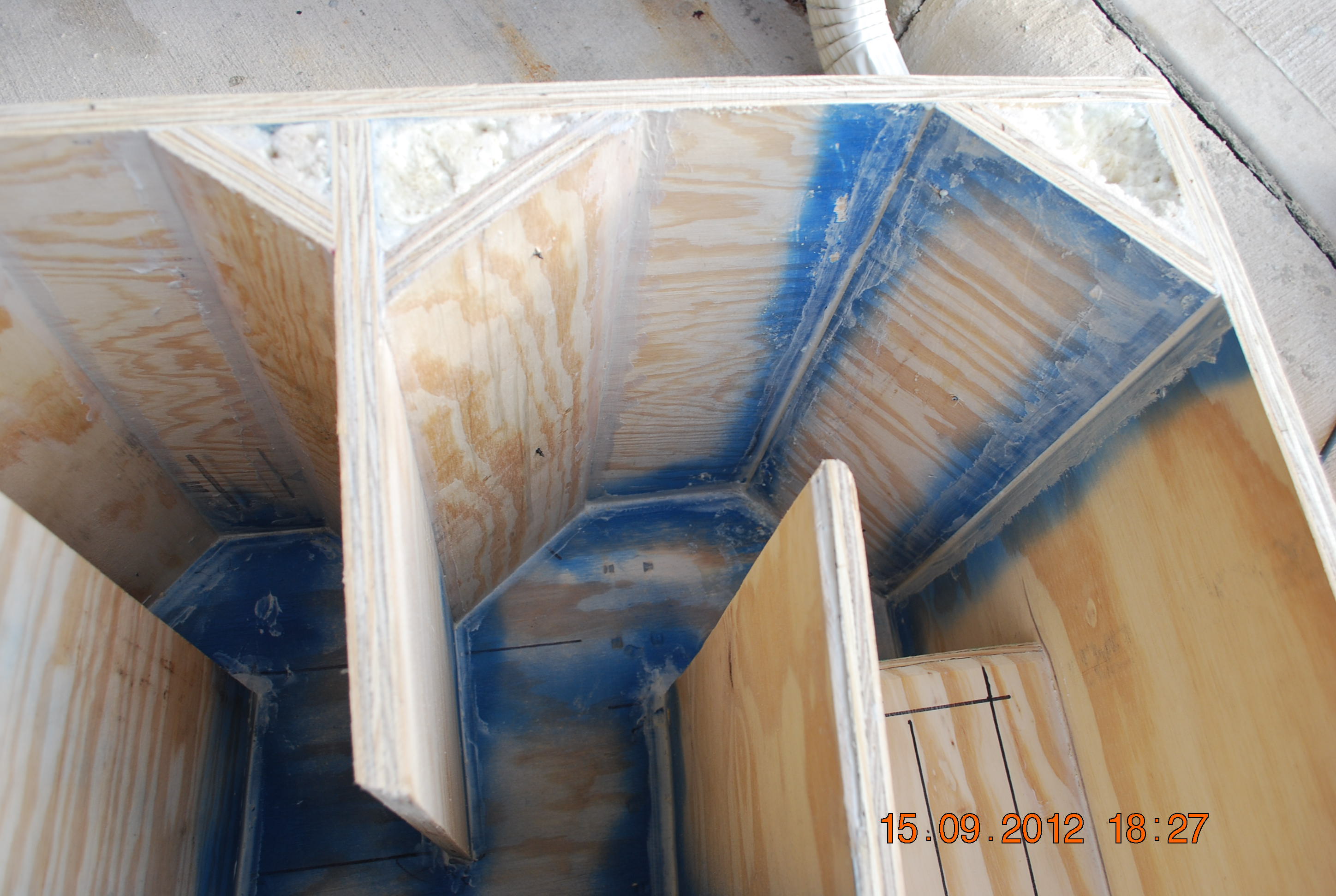

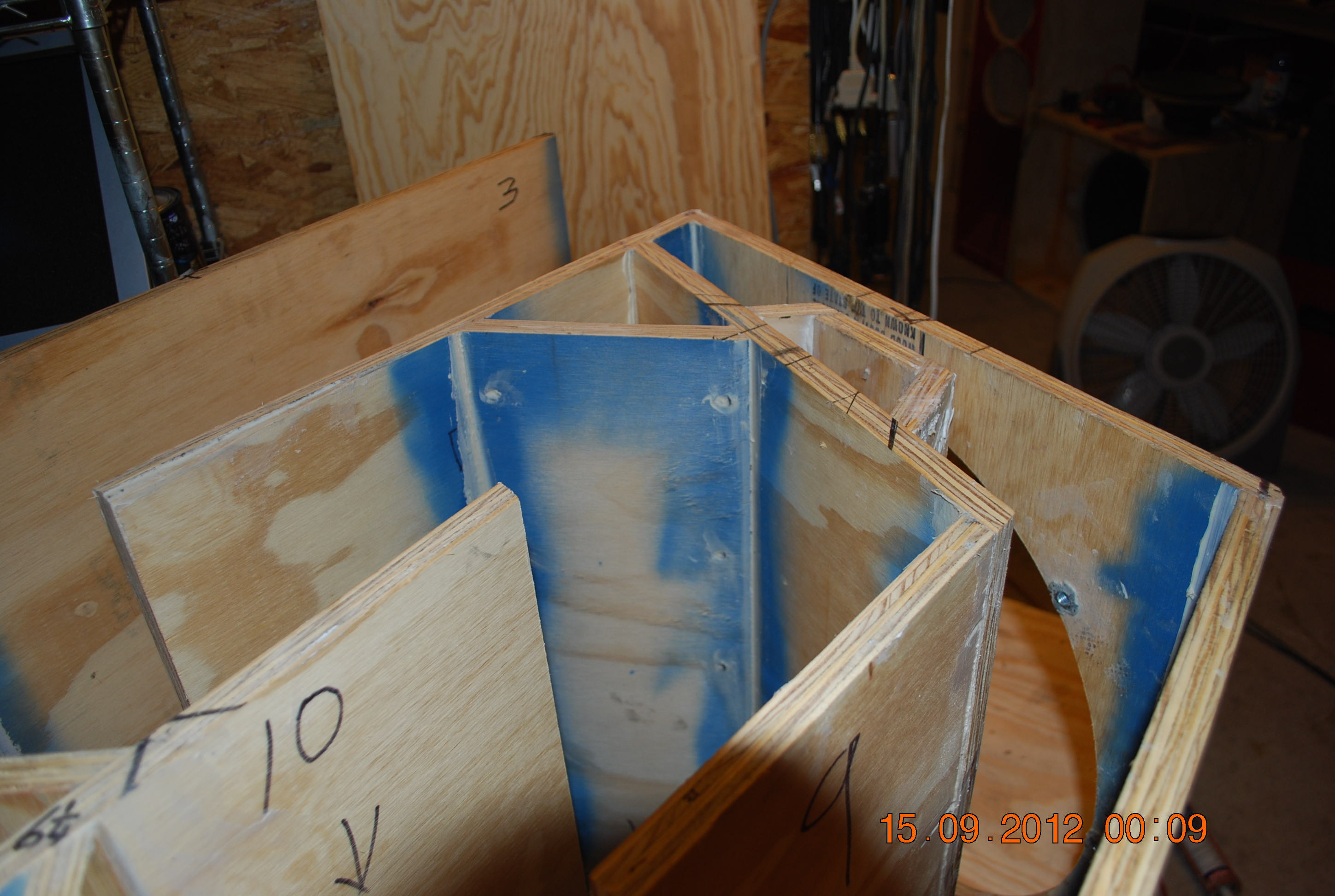

I added some reflectors and the cone corrector spec by Djim and Martin,It was a pain cutting these angles but I drew them full scale and marked the wood and sawed them out ,took some time but Testing will tell,lol.All is glued and screwed ,I'll finish tomorrow,and give it a day to dry,Then it gets the juice,lol.

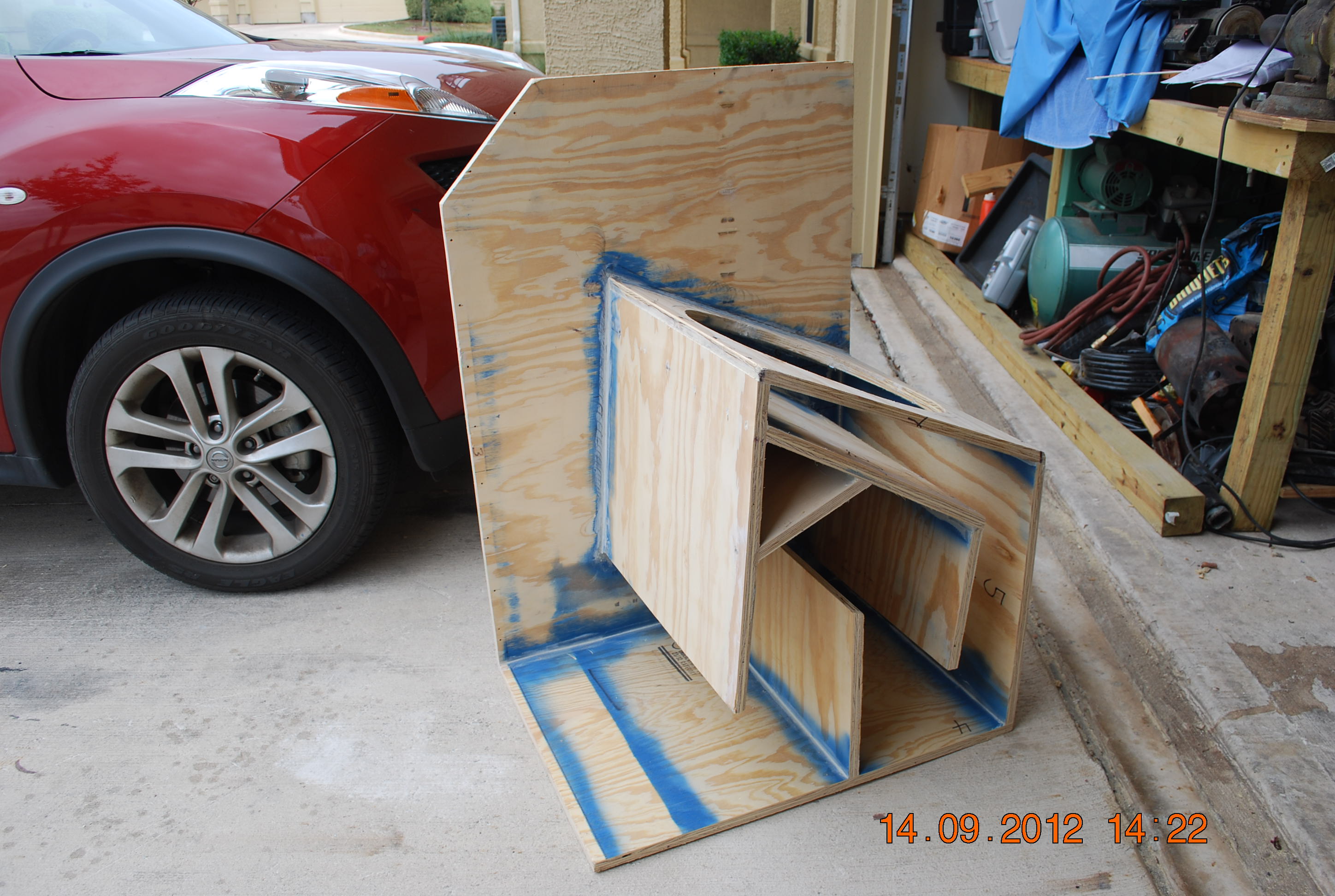

I like the JUKE it ain't good on gas but it will fly,I dumped a lot of them hot machines off the line ,and made them eat weeds,lol. I like the CV transmission in it ,Honda made one too ,Push the gas and hold on,lol.

I didn't see that reflector left in the corner,LOL. I wonder if it would benefit using 2 more on the other side of that camber?I guess volume is the key?

Just as an aside, take a look at the intermal dimensions/locations of dividers. They just look off in the pictures (I know forshortening and all that). You want to make sure that the overall flow of the horn is opening up without restrictions.

I'll take a look but I did check them and they were close some not perfect but with in a 1/4" .

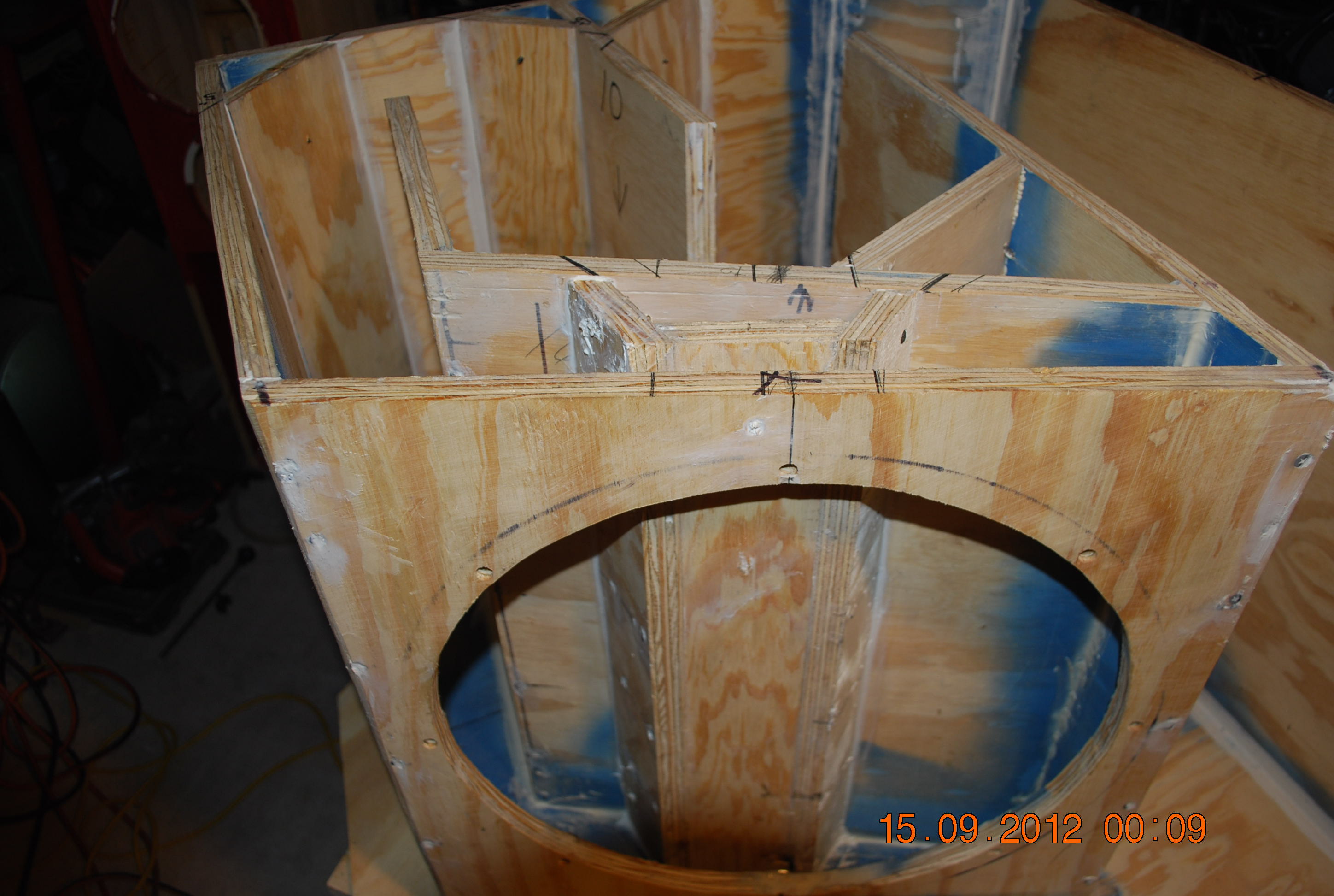

I made some more pics I have to put in one more stiffener and put the side on,

I all done, gosh took this old man 4 days to get one cabinet together,looks like the dems are off 10 to 15 mm in some places ,I'm not going to tell the speaker cause it can't see around the first bend,lol.just kidding
We will see tomorrow, I wonder how long it will take to break that woofer in,any Ideas?
