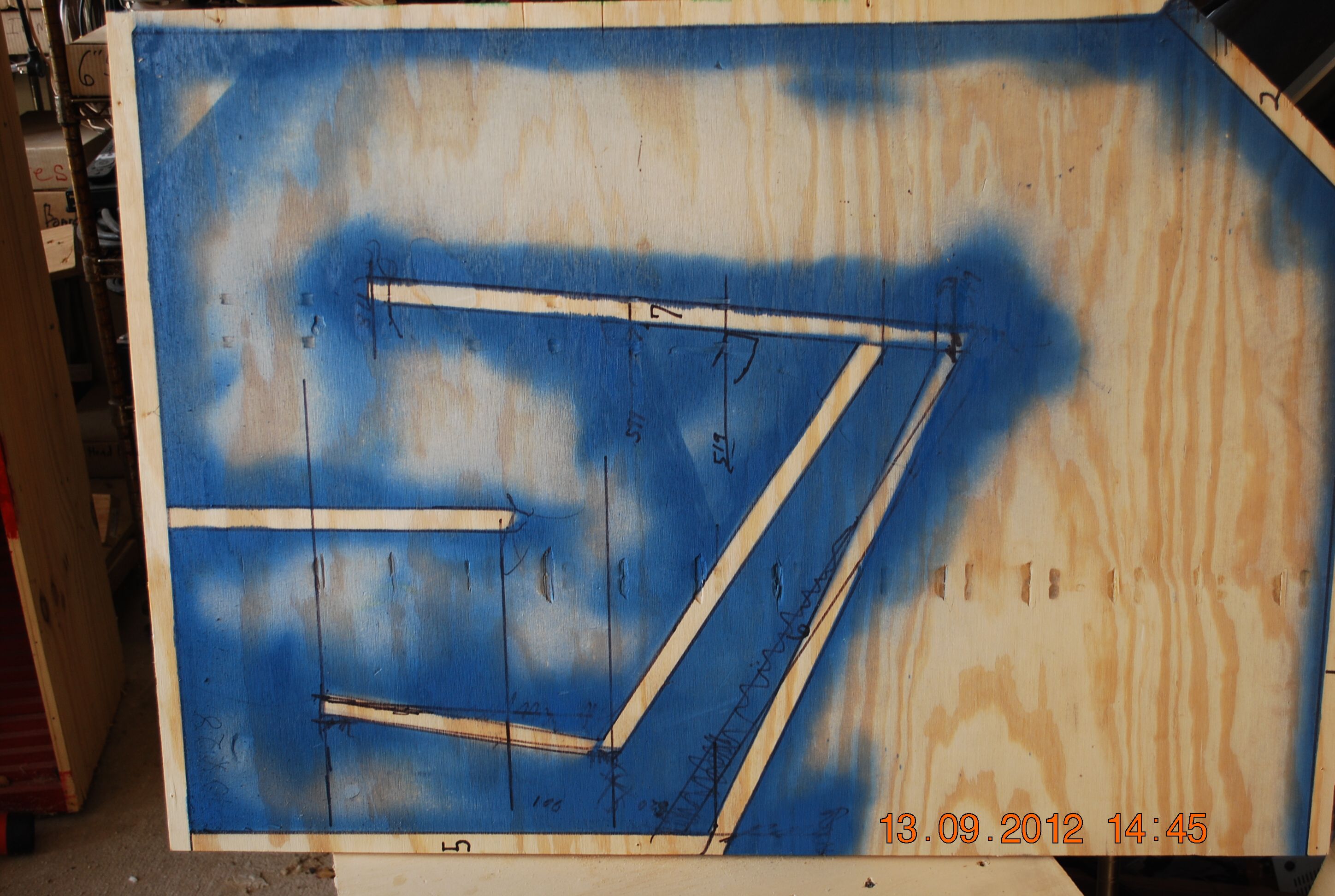

i think its an easy way to mark the pannels for holes and glue.....whats with the blue paint?
Yes I did think of that, but never seal wood before glue (in case something moves)

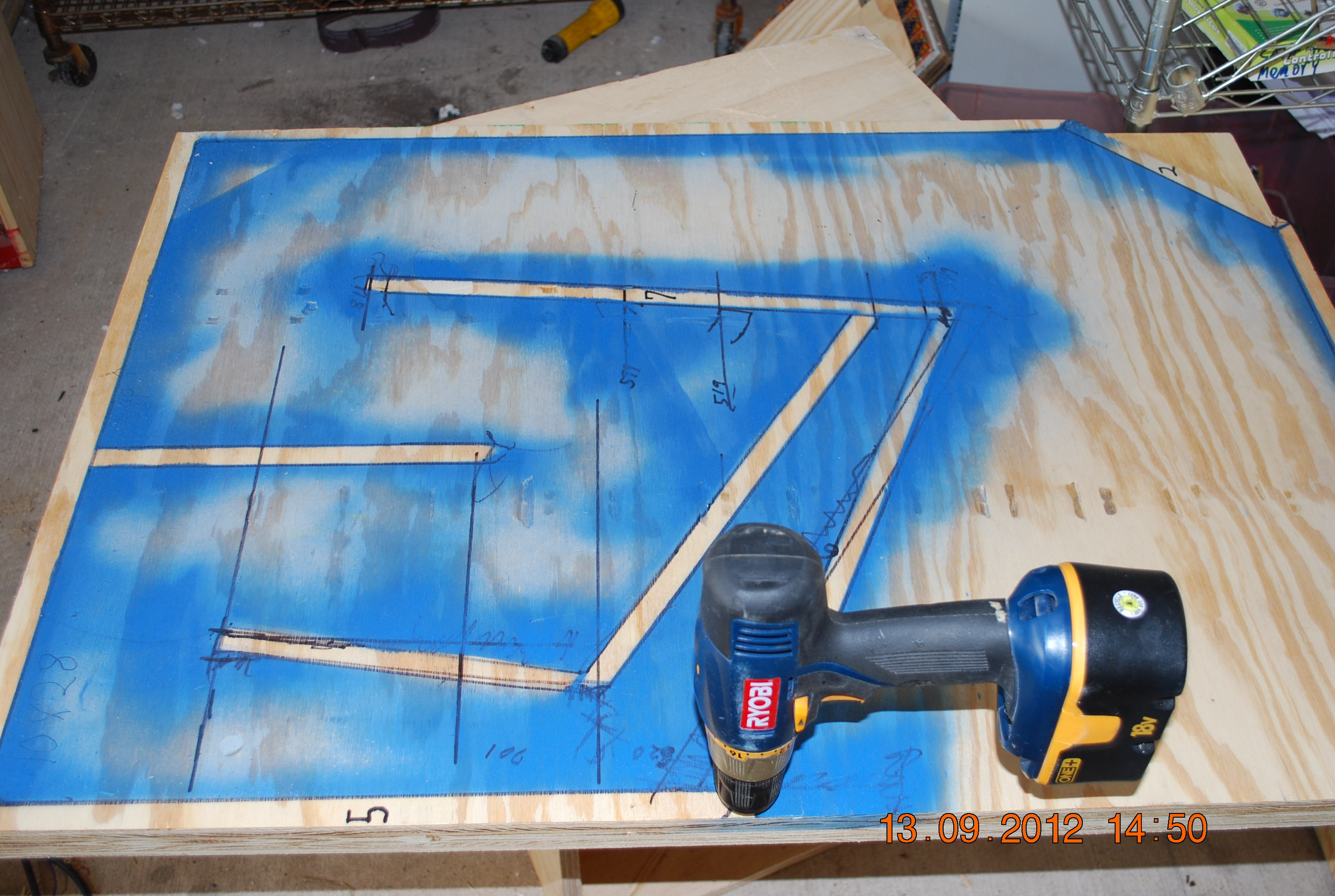

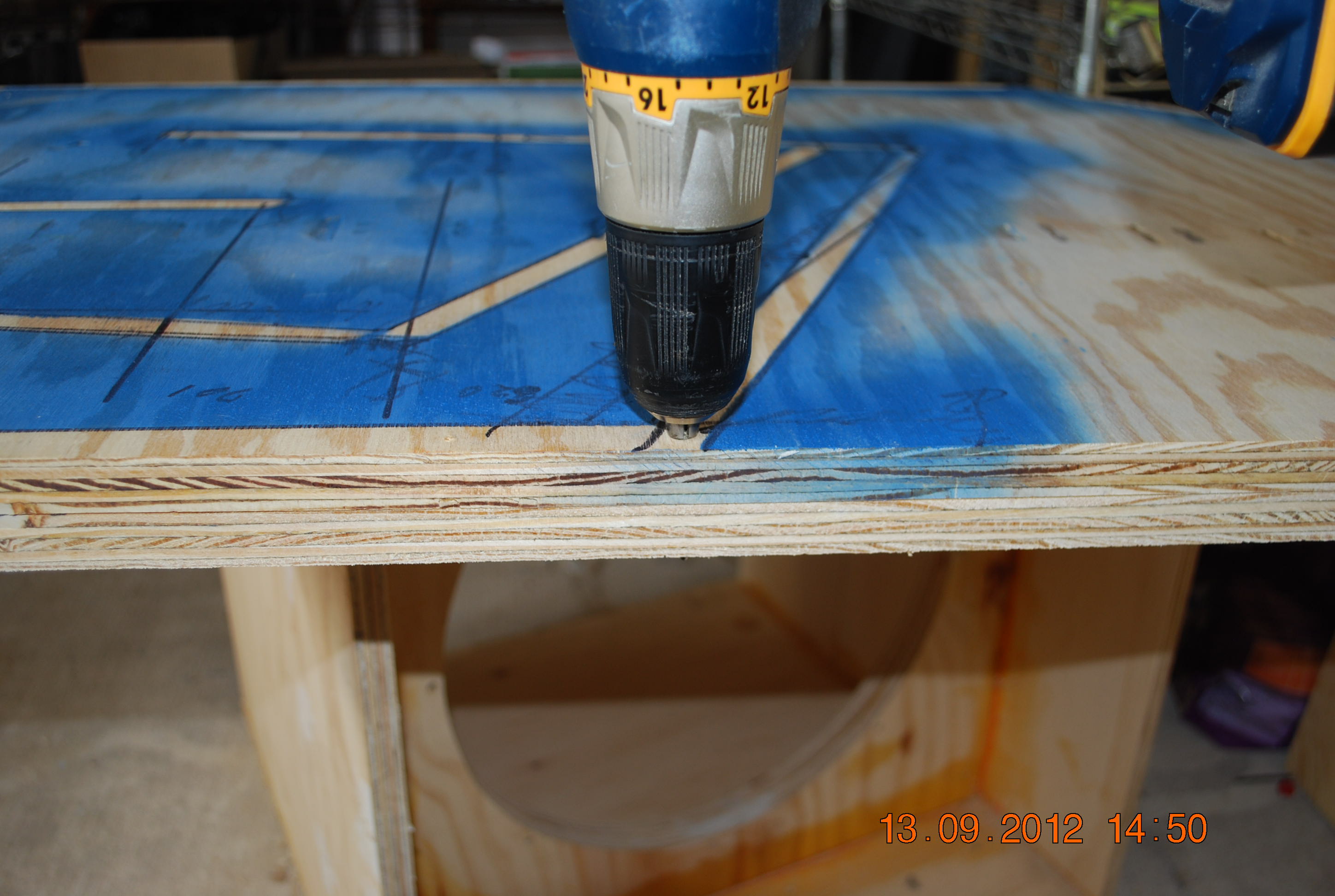

The blue paint is there so when I take it back apart(I make a mockup assembly first minimal screws) and then spray paint the edges,then you can drill 2 sides at once and have them square and in place and make sure the screw hits the middle of the board,I also use a magic marker to show screw lines across the top of angled boards for pre drill/counter sinking,
I found out it will be best to start reassembly from the inside out, my power drill won't fit in the smaller spaces outherwise,

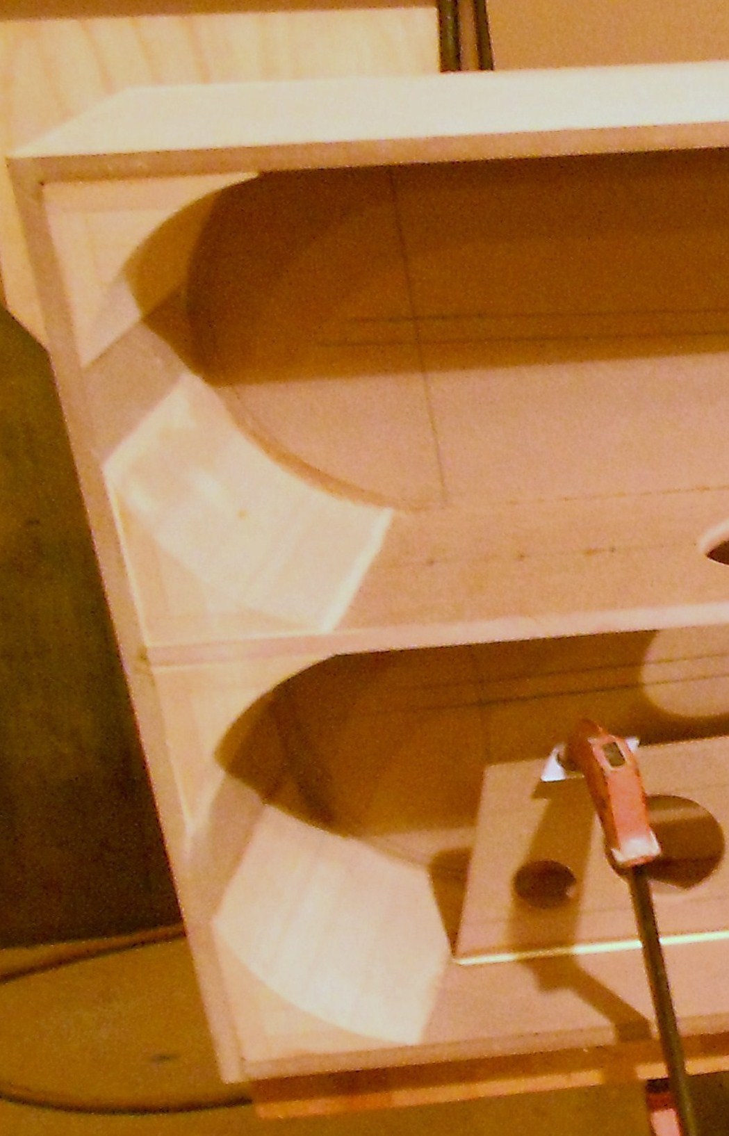

Here's my contribution...
I hope mine live up to all the others that have been put up recently 🙂
I should get some better pics as I build. I got a CM140 SPL meter for my measurements, so I can throw up those once this one is done and I can take it down to the field.
This sub is 1 of 4 🙂 Still have to add cabinet hardware and paint, should be able to do some testing next week

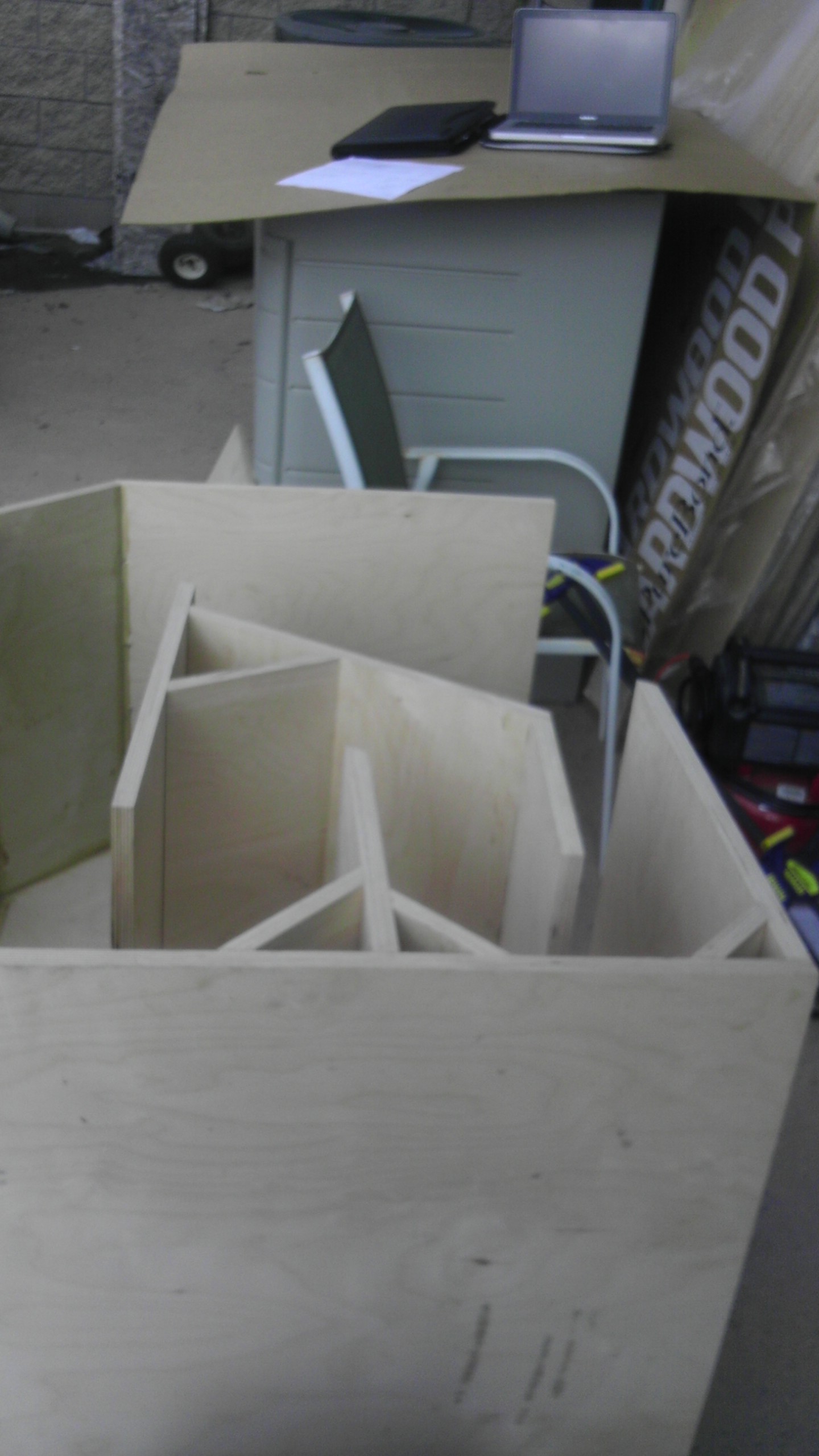

Would someone that has simmed this horn please put 3 more reflectors in and run the sim and post the results,I am almost ready to put the side on and could change it now ,But Xoc1 says he has kept it as is so It's built per the plans,

If you're not in to too big of a hurry at this point (and I would want to finish). I would glue up scrap and make "C" conner braces. Pic
OR at least pick up non-expanding window/door foam and fill the voids (tape all edges).

Hi noSmoking,A question you added reflectors ,I was wondering why? and if it simmed better or just a good Idea
These are not reflectors but corner volume corrections. In other words, the sim is based on these corrections but you can leave them out. Btw have you thought about using braces?
Although you don't seem to be fond on cone correction ;-) it is meant for the same reason as the corner corrections. They are used to bring the actual build closer to the sim. Without the cone-volume-correction the driver looses control over excursion sooner below 38Hz and looses 1 to 2dB in maximum output around 38Hz.

I do plan to put in some stiffeners ,I have not cut them out yet ,that's today's project.
