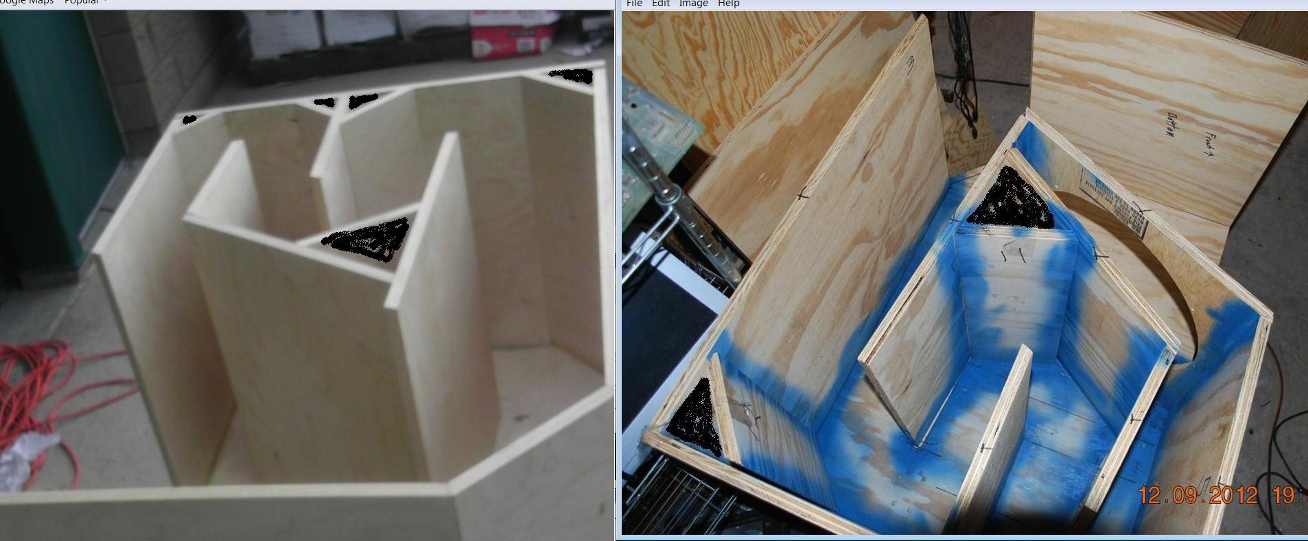

I was thinking this would be a good way to make the box extra solid; and won't add weight. Fill the triangles up with poly foam - one $5 can should do the job.

For Crescendo I suggested something that really follows the structure of the cone. This is probably not necessary as the main goal of cone correction is to correct the position of the pressure zone (there where the horn-path is most narrow) towards the centre of the driver or towards the position as in the sim. For the strongest drivers it doesn't matter so it is best positioned as the sim suggests but for less capable drivers I believe it is best positioned above the centre of the driver.
A more simplistic way to do that is shown in the picture. The "stub" is going from one side to the other, so it expands of the entire width of the cab. As you can see it is just a little out of the centre of the driver (somewhere between 0.5 to 1.5cm). I suggest to use at least two braces in the "stub" cavity. You can also make the whole stub from one solid piece to increase stiffness (but is more heavy of course).

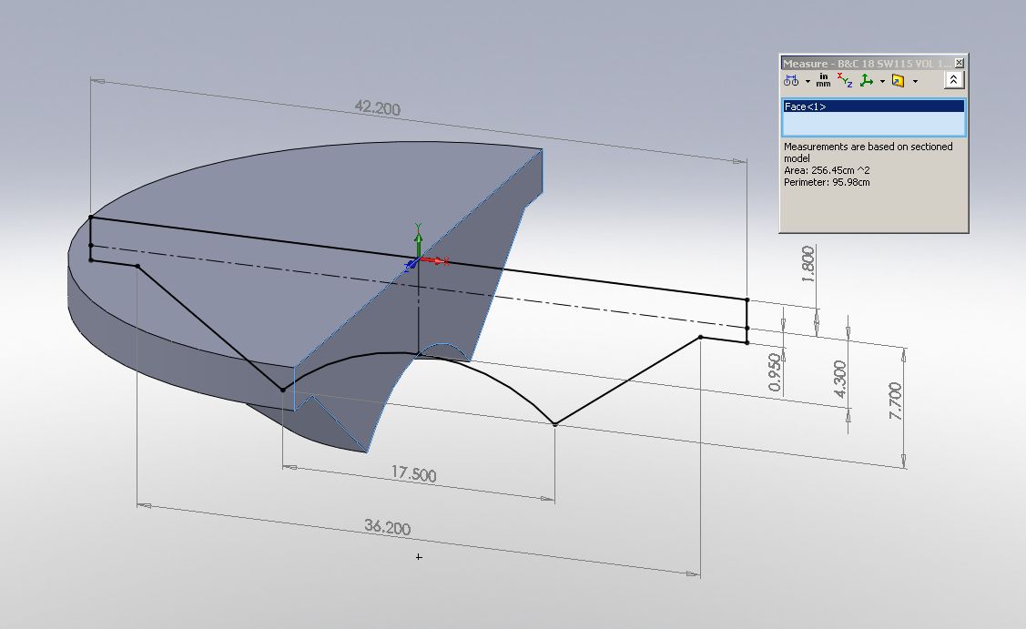

The Tour of Britain Cycle Race comes to our town tomorrow, and a I have a gig in town so I have been busy rebuilding and configuring my PA rig.😱
I was given some dimensions for a B&C SW115 so I used that to model a cross sectional area. I used a 422mm cutout in a 18mm baffle.
I can slice the model at different points and measure the cross section.
I found that 2cm wide slices were adequate.
This is a screengrab of the cone and baffle volume at the speaker mid point.

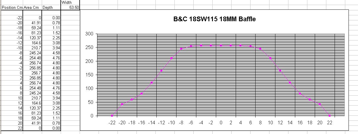

I sliced the model in 2cm increments and put the results into a spreadsheet.
The area is then divided by the internal width of the TH18 cab and an equivalent depth dimension calculated.
The amazing thing is how constant the midddle section of the cone area is.

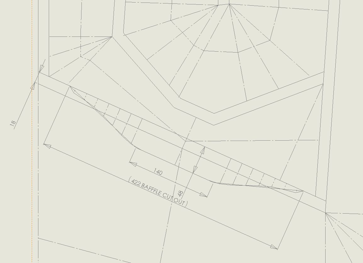

I then used the calculated area dimensions to plot out a cone compensation plotting line to be used in the horn model.
The compensation line starts at the intersection of the internal baffle face and the baffle cut out.
This imaginary line is then used as one side of the throat cross section.
The other side of the horn is shaped to follow this contour and the desired horn throat areas.
I averaged the compensation line and reduced it to 3 sections. This is to make it practical to build in timber.
This process leads me to a throat shape roughly as attached. Which is as far as I have got. I now need a spare day to fettle the rest of the folding, and to concider what else needs to be done.
It is obvious how the cone compensation bend can be used to increase the internal path length of the TH18 -SS15 fold.🙂.
Yes it needs more work and a few more sketch lines, but I see it as a valid way of calculating a TH horn throat in a way that can be understood and applied by the DIY builder😀

Hi Martin,
Nice to see you are back in bizz, hope you are doing well. I only want to point out that when the cone moves into the direction towards the mouth, the cone volume increases further. That means the pressure point still ‘travels’ during excursion. If you make the “V” more sharp and closer to the driver-baffle, you can prevent this ‘travel’. Using Xmax or Xvar depends on the type of driver. Xmax for 'less strong' drivers (Low BL, high Vas) and Xvar for 'strong' drivers (High Bl, low Vas).

As you can see from the posts I just put up, the compensation profile is there - you could use some of the simple techniques of horn design to come up with a throat shape - this can be as basic as using cut up bits of paper to get a horn contour to follow an profile.😉
The large S1 area before the S2 point at the centre of the driver seems to give a bit more lower end - reducing S1 extends the top end extension in a Hornresp sim, but not many have found a practical use for an extended top end response.
DJims Stub Looks OK to me and if its is what Crescendo built then it must work! But the compression at S2 looks quite high with DJims stub. It might not be suitable for everyone - it could depend on a decently robust speaker driver.
