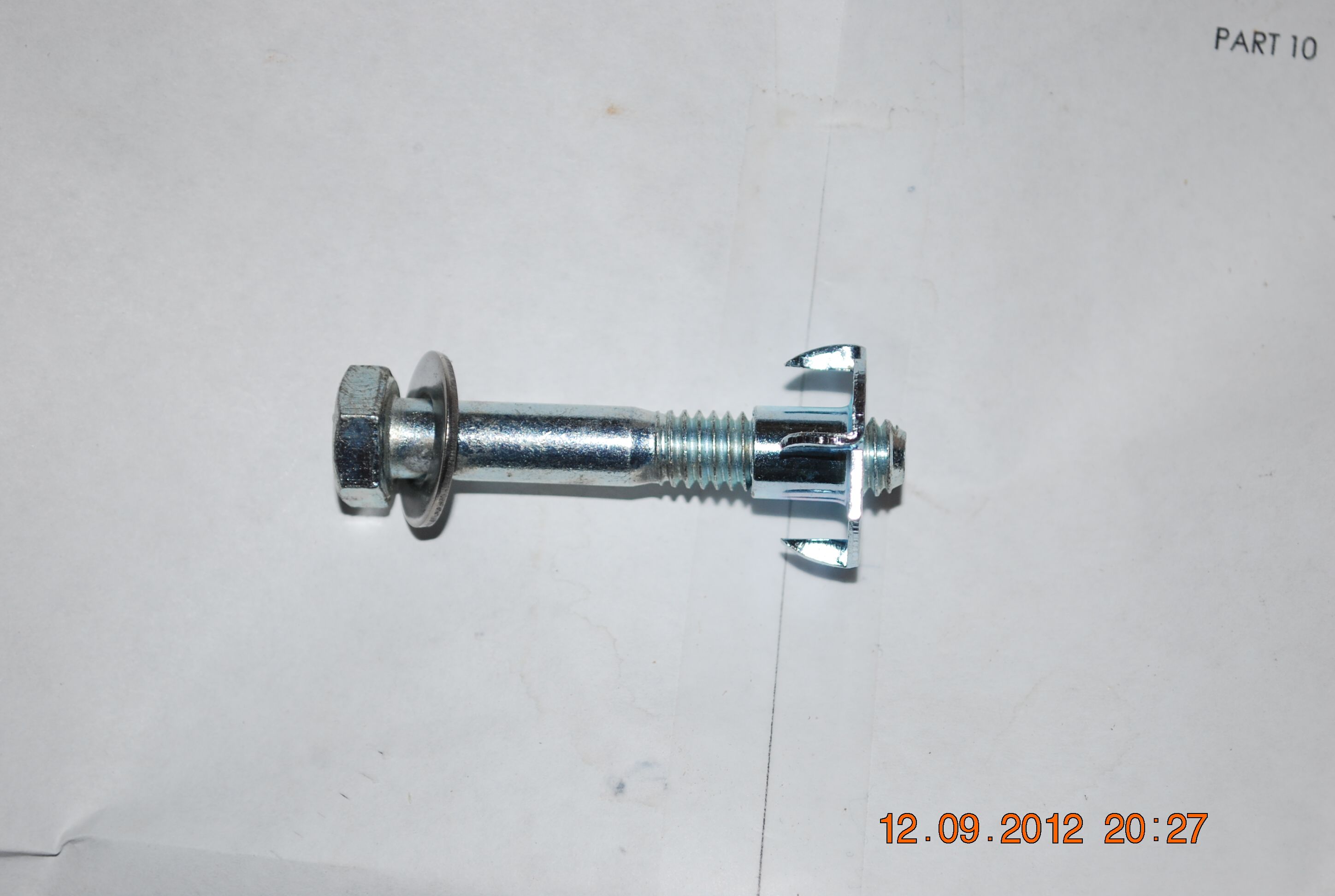

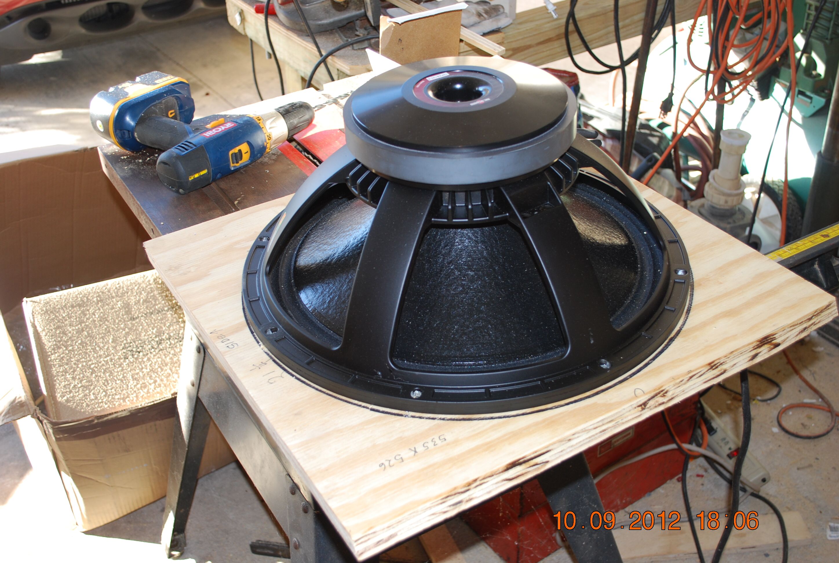

What's the better way to mount these 18" in the wood,I was wondering if they come loose ,your stuck,so I got these at the depo,suggestion are welcomed,Thought about the cleat from the inside and some loctite on the bolt from the speaker side.

I've used those Tnuts for many years. They behave well. If you are worried about anything coming loose try a non permanent thread locker. Loctite blue is removable.
ah good I'll do that ,I have heard people having them come loose so that's good to know!

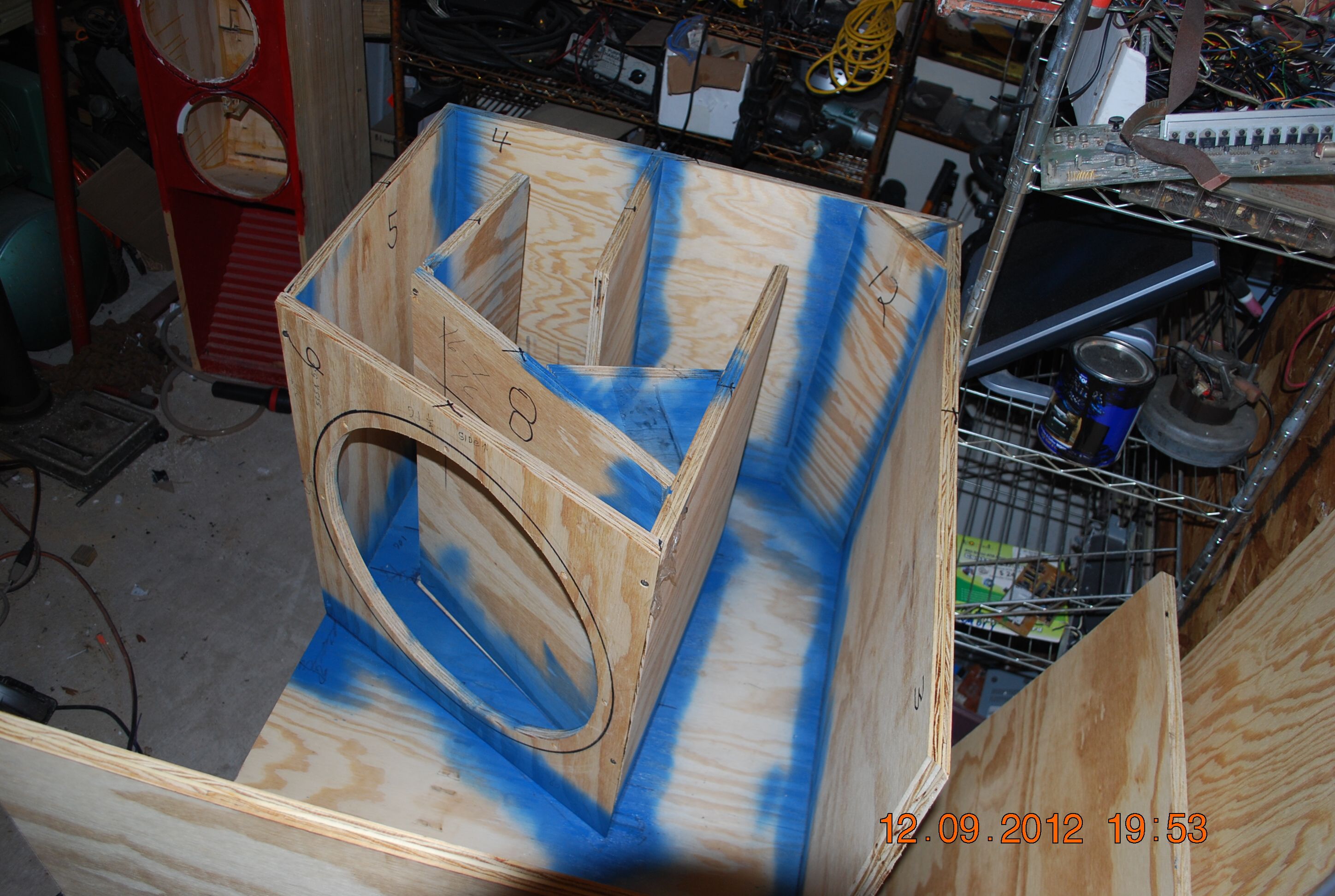

That's a great build NS. Nice work, nice straight cuts, etc. LOVE that woofer and box design. If you build a second, hunt down BB plywood, gesh - that stuff is bullet proof [was cutting some 3/4" BB yesterday]

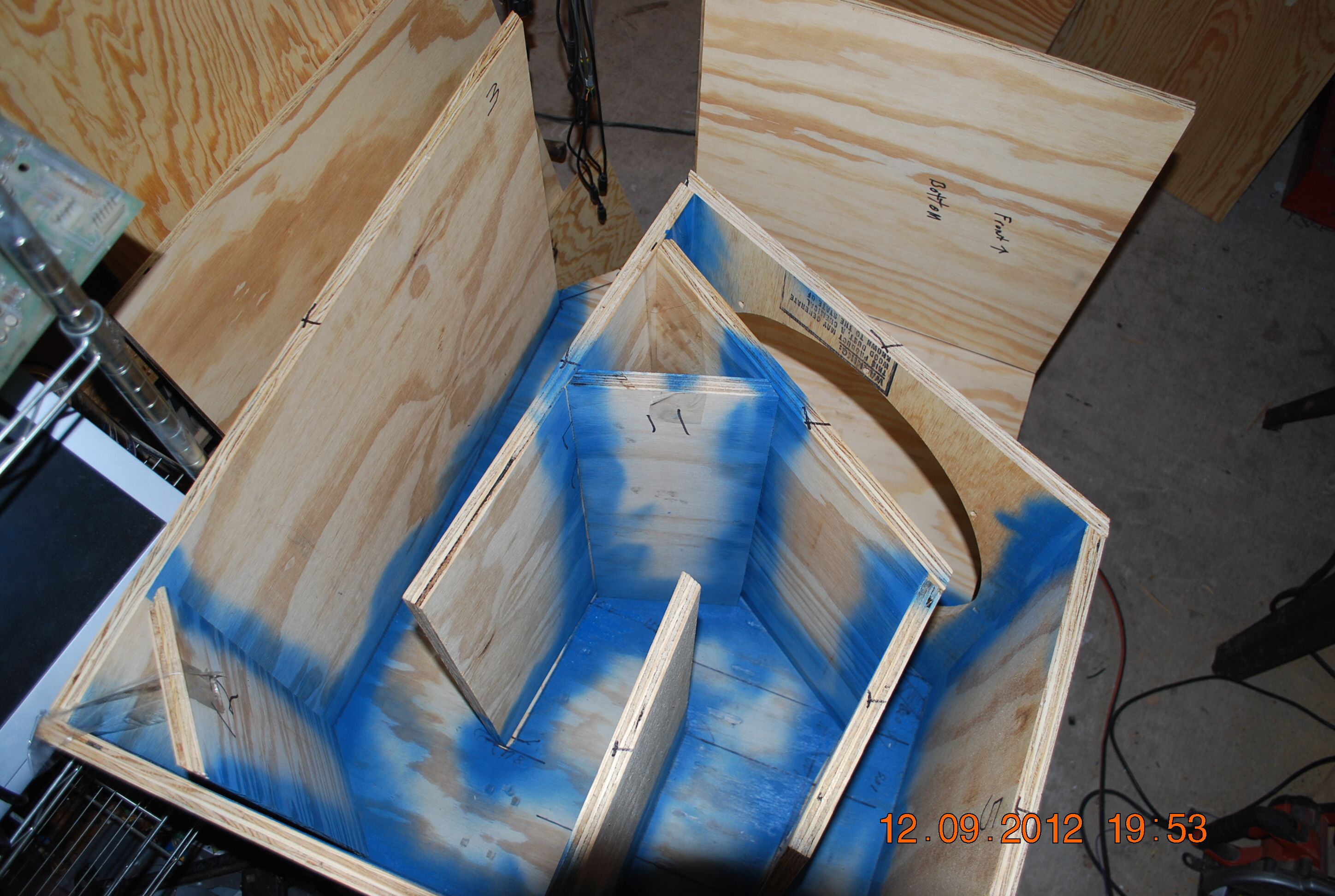

Onward!!!....whats with the blue paint?
