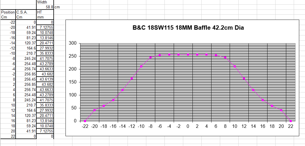

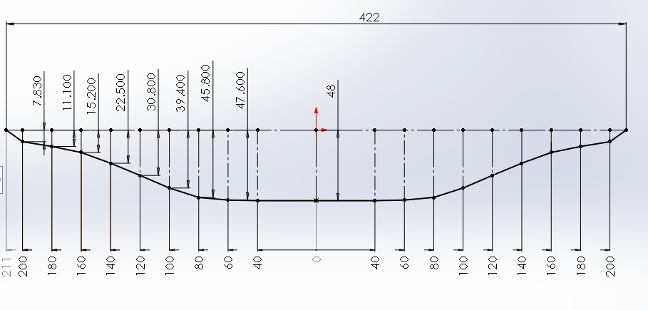

Could not find the previous Posts so looked into my Archive Files.
These examples relate to the B&C 18SW115, and it is a bit complicated to explain.🤓

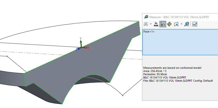

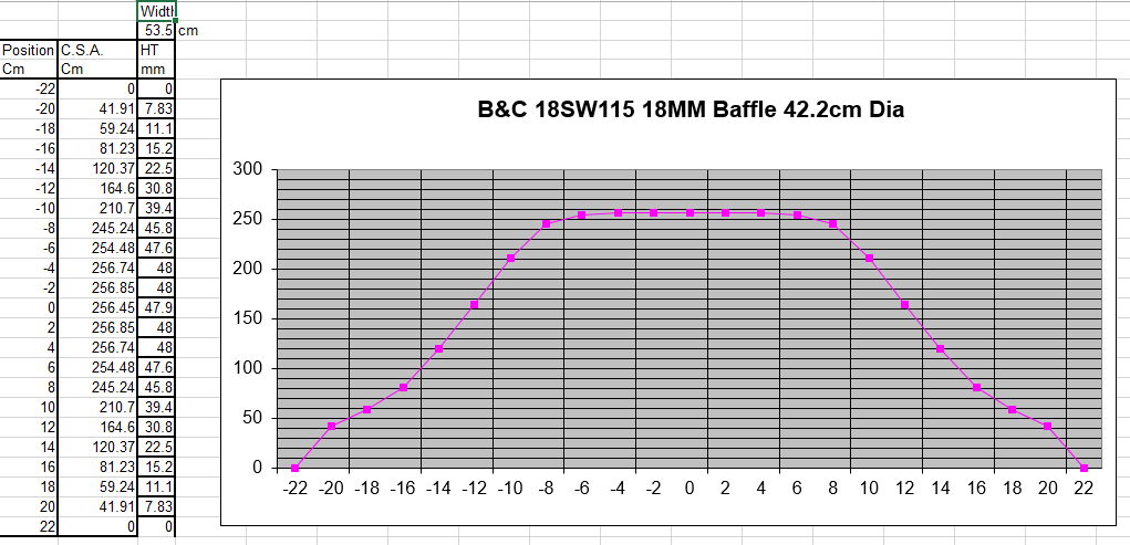

Firstly I modelled the volume of air inside the cone - and the baffle cut out.

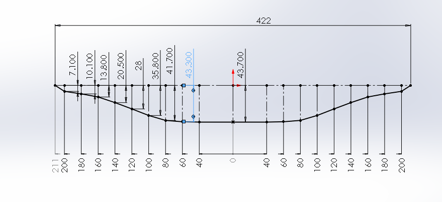

Next I sliced through the model at 2cm intervals and measured the cross sectional area This example is through the centre position.
I plotted the results in a spreadsheet and divided the area by the internal width of the speaker to get a height dimension.

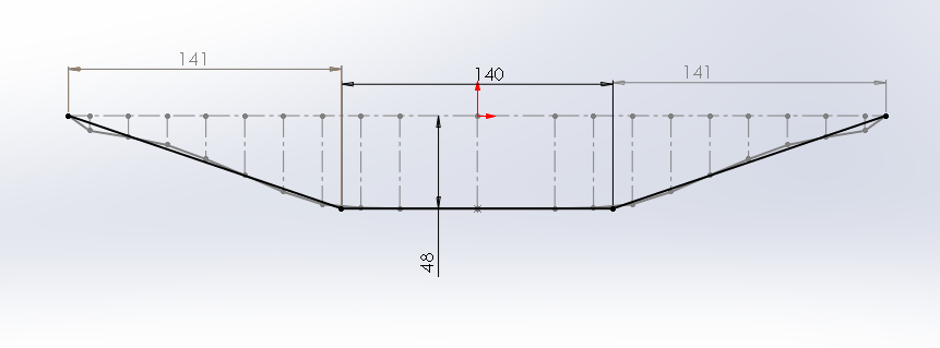

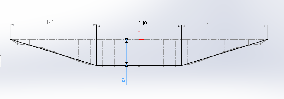

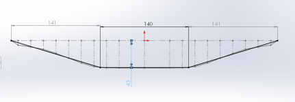

Surprisingly enough the centre of the plot becomes almost a flat line. Plotted the result in CAD.
And added a simplified 3 line equivalent by eye.

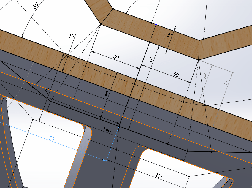

This line then replaces the speaker baflle when setting out the cross sectional area of the Speaker Sim and totally accounts for the volume of the cone and baffle - 'Cone Correction!'
Note the 48mm X 140 correction line & the 86mm that represents S2, so Overall compression at S2 is directly comparable with the compression ratio as reported in Hornresp.
Note I decided to do away with the extra panel / restriction that narrowed down S1 which results in a 'Stub' at S1- But in hornresp this causes a loss of HF extension, and also really puts the sim into Akabak territory.
No I never built a TH18 like this but did build a comparable smaller version that I use.

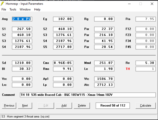

Here is the B&C 18SW115 8ohm - as a reference -Run at Xmax 14mm

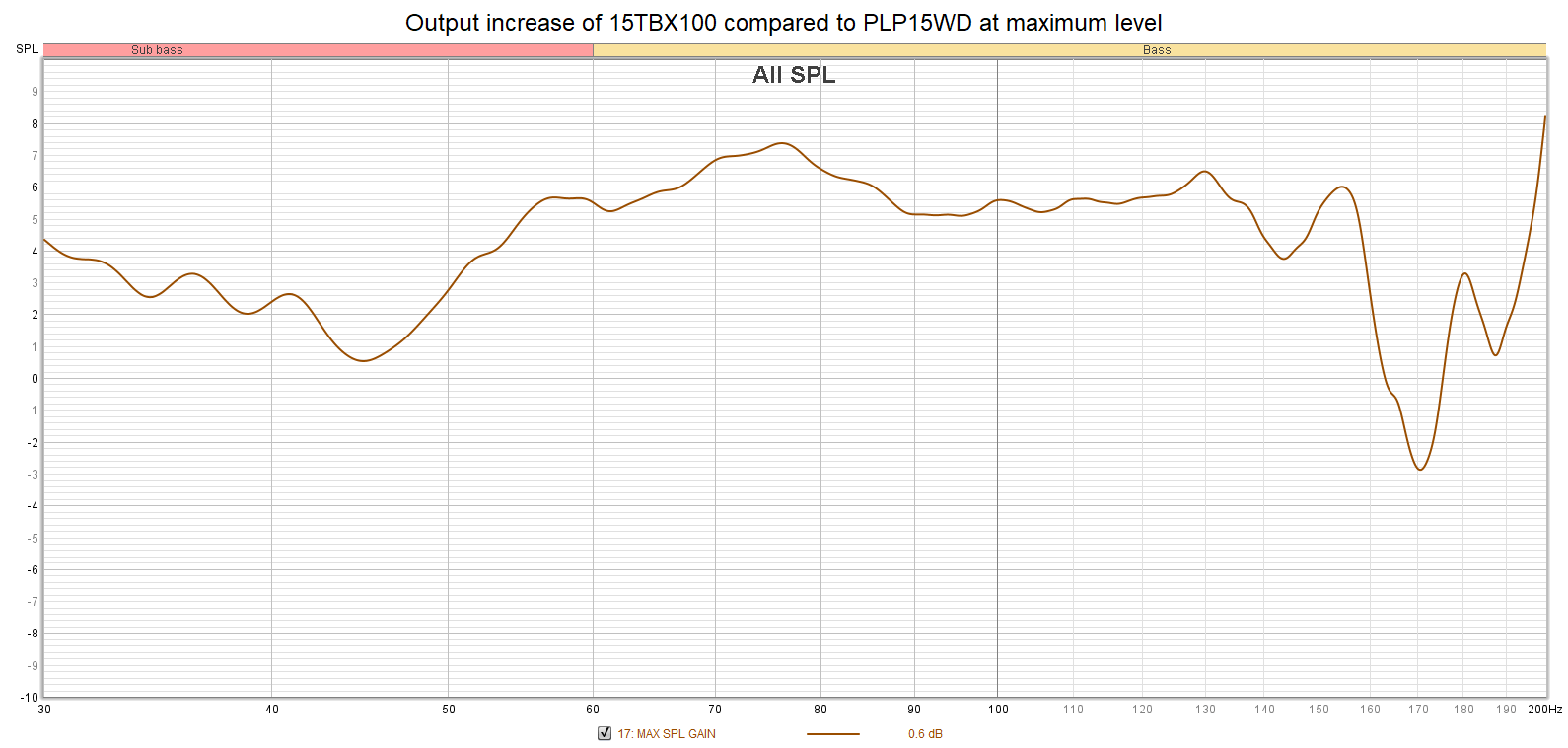

Cheaper ply wont change the acoustic performance but it will reduce durability which can be mitigated to an extent by including things like full length skids and good quality coatings. The roller applied coatings are fine and what I use but you have to frequently touch them up if you want the boxes to stay good looking. Large manufacturers are not using rolled on coatings but something very hard and sprayed on (epoxy?).
A cheaper driver like 18TBX100 will reduce maximum per cab output, its very difficult to say how much by from specs alone. We know that the 18SW115 has greater power handling and excursion and so can generalise that it will give greater output but at which frequencies and by how much requires measurment. As an example this is measured maximum output of the same sub (reflex not TH) with two different driver combinations:
1654355946714-png.1061141
not exactly predictable from T/S parameters. I would always go towards maximum output from a given cab though if transporting them as often adding more subs is not an option.

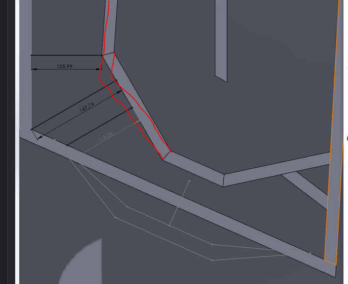

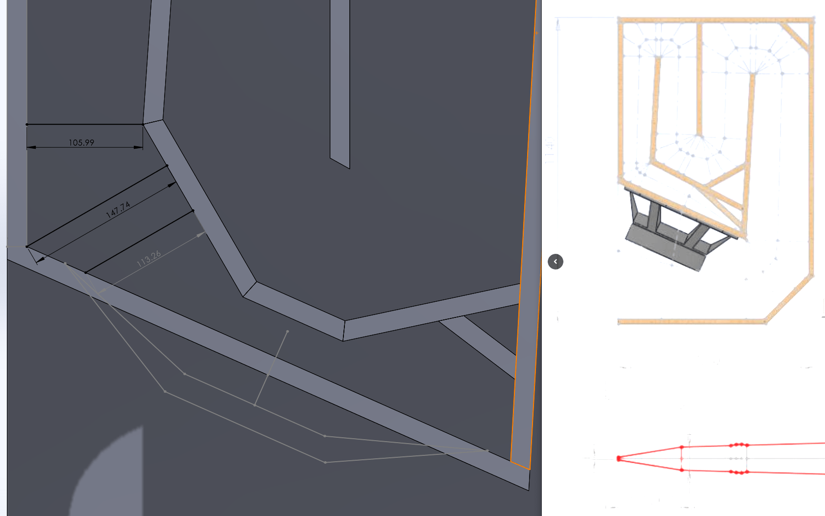

Hey @Xoc1 - we've drawn these up ourselves in solidworks over the last few weeks, and had a question about the first part of the horn path after implementing the throat correction.
Image on the left shows the design after throat correct, right is obviously the original design. Is it correct that the throat opens like this in the throat corrected design? It appears that the horn path expands signifiantly in the early parts of the path, and we're concerned (looking at the old design) that this might not be desireable? Any guidance would be greatly appreciated!
The 113 dimension is perpendicular to the inner baffle when I would expect the measurement to be perpendicular to the horn path centre line. - Which would make it a smaller dimension.
The 147 dimension is right into the corner which will always be oversized!
The 105.9 dim is probably as expected.
Have you created a hornpath sketch using the advanced centreline method as the image of one of my drawings in your screen shot ( Which looks to not be a TH18 drawing), and used that to drive an unfolded sketch?
The unfolded sketch lines are driven by the folded hornpath sketch, (give then an equal to relation), so being parametrically linked will update as you change the speaker layout. That way you can assess any changes you make to the design by rebuilding the speaker model.
The tricky bit is constructing the sketches without adding any auto generated relations that will cause them to become overconstrained.
The overall path is probably not as bad as you think The original design might seem elegant but it assumes a flat pistonic speaker which can be compensated for with VTC and ATC in the simulation. - Or add the cone compensation to the horn path to see how that changes the horn shape.
With this sort of modelling you eventually learn that reducing the width in one area increases the width somwhere else & the overall volume remains the same. Which then leads to a very similar output.
Actual improvements are very hard won and and can take ages to optimise.
The original design had the taper from s1 to s2 - Smaller s1 gives an extended response in the sim but practical experience has shown the effect to be not as pronounced as the theory would suggest.
