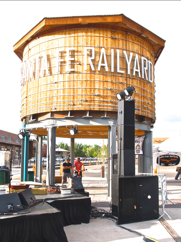

Thanks for this Art - greatly appreciated.
I have quite severe tinnitus myself (from years of standing right next to absolutely trash PA's being pushed exceptionally hard)... And absolutely don't want to expose the audience to the same.
But there still are the constraints of small gigs. I know you have extensive experience in massive shows, and that informs this guidance. But this rig is - at times - going to be used in courtyards and small venues, where hanging the PM90's at +2m from ear level is going to be tough.
That being said - the message is received. Elevate the tops as much as possible above ear height. The PM90's do have the pole mount, so will look to employ that.
Will do some reading about angling the tops when elevated too - look forward to learning about the impact of directivity as we explore rigging the tops as high as we can.
Will look into some sort a modular scaffold too - could be fun.
Big gigs with cabinets up high will need center fill cabinets, small gigs can use those for mains.
This little rig stands over 3 meters tall, using a road case under two lightweight cabinets, ratchet strapped for safety.

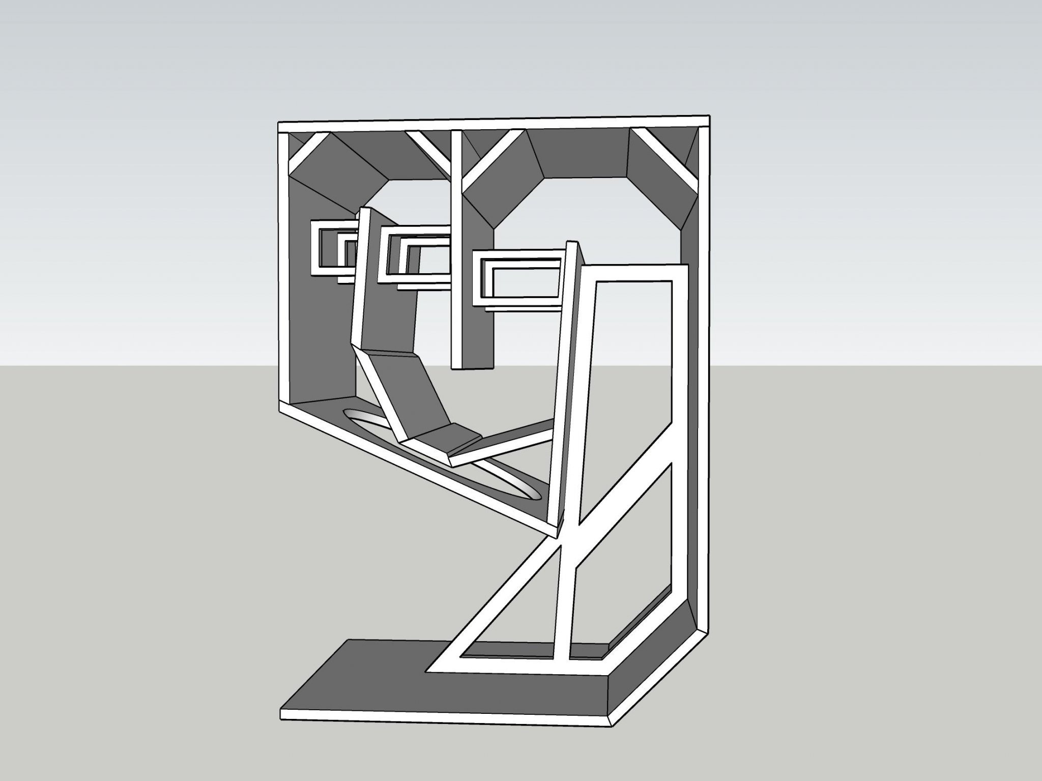

hey everyone. it's amazing to see this thread still going! I managed to build 2 of these several years ago and they've been absolutely amazing. My only problem was the build quality....i let myself down and they've basically come apart from the inside. no idea how but anyway i'm gonna build another 2 but i'd like to incorporate the stub into my build but i haven't managed to find any plans with them included. I've attached my sketchup version but wanted some guidance as to how important the geometry of the stub pieces are and also are the brace parts sufficient? Any help is always appreciated!
