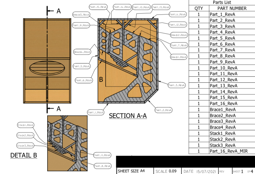

I have acquired what I believe to be the most up-to-date version of the cut-sheet, for the Mark1
I have the Schematic, and I have settled on a driver, based on the most complete cone volume correction methodology and blueprint that I could find.
I have settled to model after Crescendos build, and am opting for a B&C18SW100 4 ohm
I have already purchased 18000 Watts of Class D amplification 3000watt program per channel. and am getting quotes for 6 drivers and precut wood for 6 boxes.

Build Is coming along great, I have been coalescing with a CAD designer to improve the schematic sourced, and add rebates for the interior horn into the side panels, for ease of accurate assembly, but I am wondering, do you have any suggestions for screws?
I am very sure we can get away with some self-tapping wood screws, But I thought some type of tapping screw with a partner insert it can tap into to prevent wood damage may be a superior choice...
Any Suggestions...

Qkallisti,1)Any reasoning behind why you would think that threaded machine screws and counterpart inserts would not be a benefit?
2)We were also thinking about glueing and screwing on one side and having the opposite side, attached via screws, with no glue, and a fit gasket, recessed into the rebate slots for the interior horn panels, to make any servicing easier.
1) For mounting the driver, T-nuts or threaded inserts are a good idea, as those 8 screws are directly supporting the driver weight, and the driver may require replacement.
Using threaded inserts for cabinet construction would require at least double the building time and fastener expense with no benefit over standard wood (or drywall) screws.
2) A properly built sub cabinet will not require any internal service, other than access to the driver, which simply requires removing the grille, if you use one.

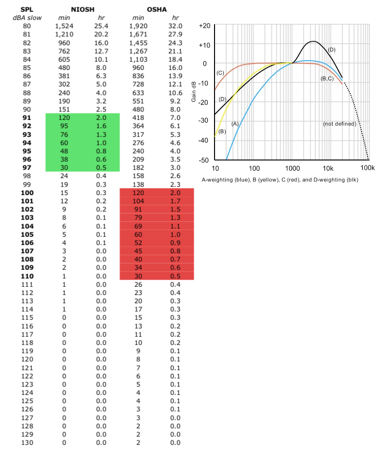

2.5 meters is barely above head level, and the LF portion of the PM90 hits 130+dB at 1 meter at 600Hz, it can cause hearing hearing damage in short order.
If you plan to use the headroom available from a top cabinet or kick bin used above 100 Hz, you and your audience will end up with hearing damage if they are not elevated high enough that inverse distance (-6dB per doubling of distance) reduces SPL to a safe level.
Lifts or scaffolding are a requirement.
NIOSH and OSHA provide guidelines for what is considered "safe" levels, above those levels hearing loss is cumulative. Using the "dBA slow" meter level, you can check out level around your system.
As an example, let's say your music averages -10dB less than peak levels, so reads 120 dB SPL "Slow" when hitting 130dB peak.
Note the "A" weighting scale drops off below 1000Hz, at 200Hz is -10dB, so the 130dB peaks read 110 dBA Slow at one meter.
NIOSH allows only ONE MINUTE exposure at that level, the less stringent OSHA allows a half hour, but that assumes no exposure the rest of the day..
If the cabinet is 2 meters above people's ears, the level drops 6dB for those in front, and exposure time can be doubled.
I have over 60 dB of noise induced hearing loss at 4kHz- if you don't want to end up like me, pay attention to SPL before it's too late.
