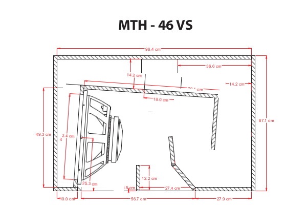

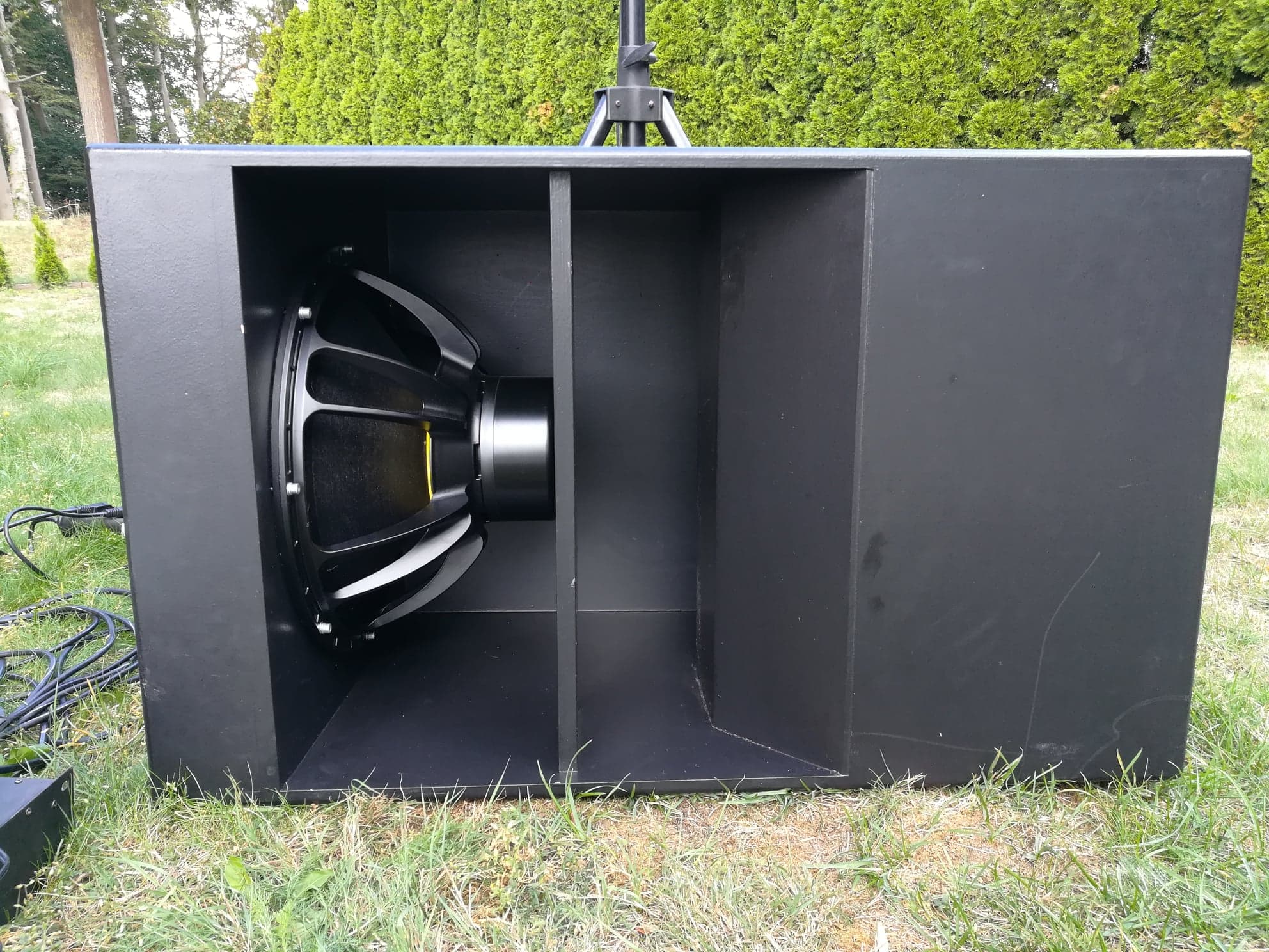

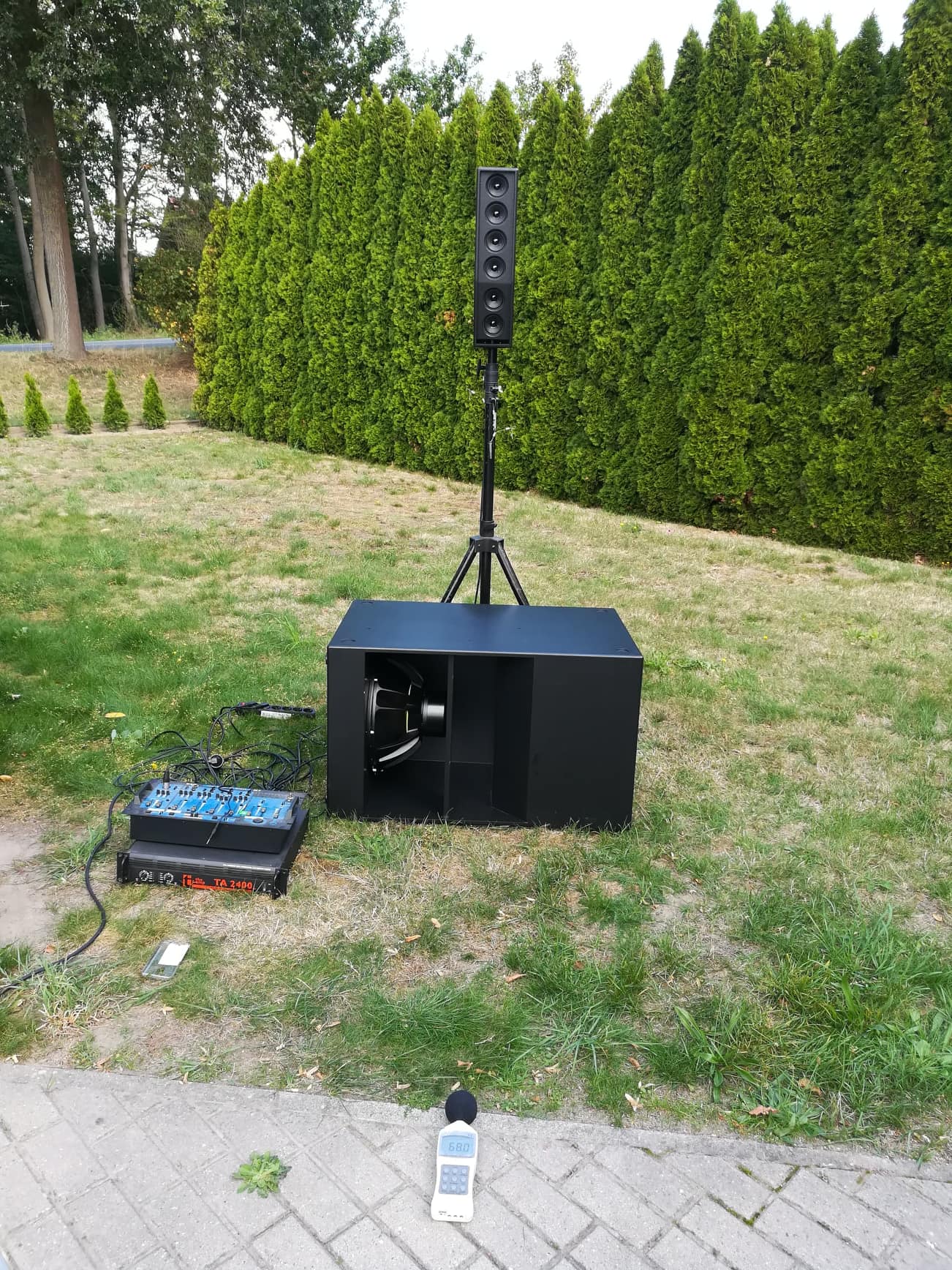

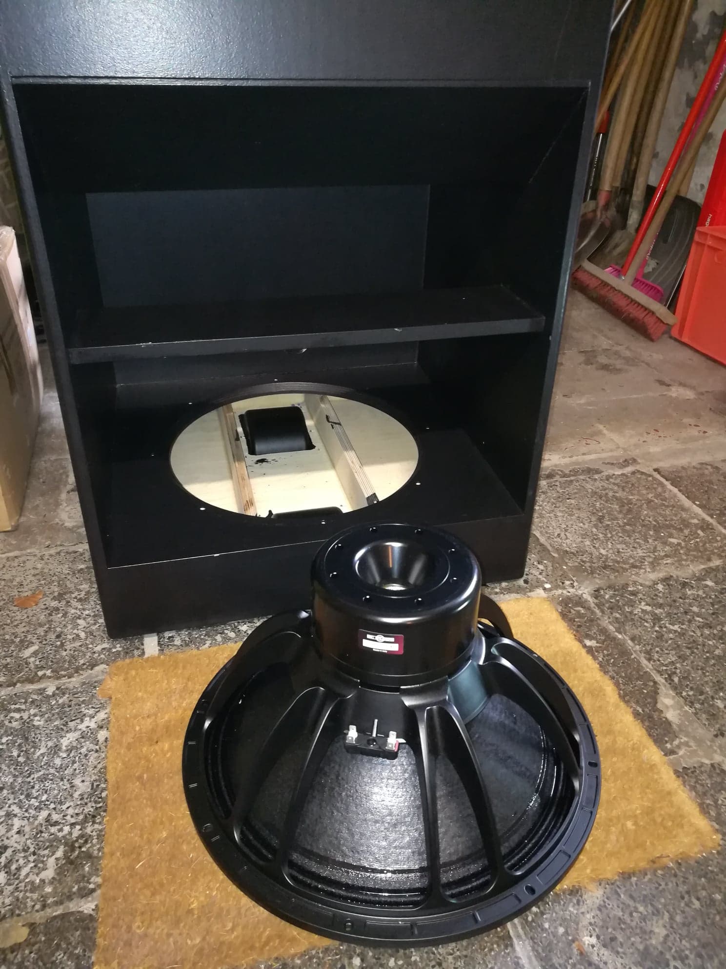

Hey guys,
i tried a new XOC-TH118 / Big Tham 18 design based on the outer dimensions of the MTH 46 VS. These MTH's loaded with the RCF LF18G401 were very punchy, kicky and loud but anything else than deep. So i added some more folds to mod it to a new Big Tham 18. Actual driver now is the B&C 18DS115-4 (a real monster in this cabinet!) driven by Proline 3000 so far. Good and impressive output at all, nice tone, punch and character.

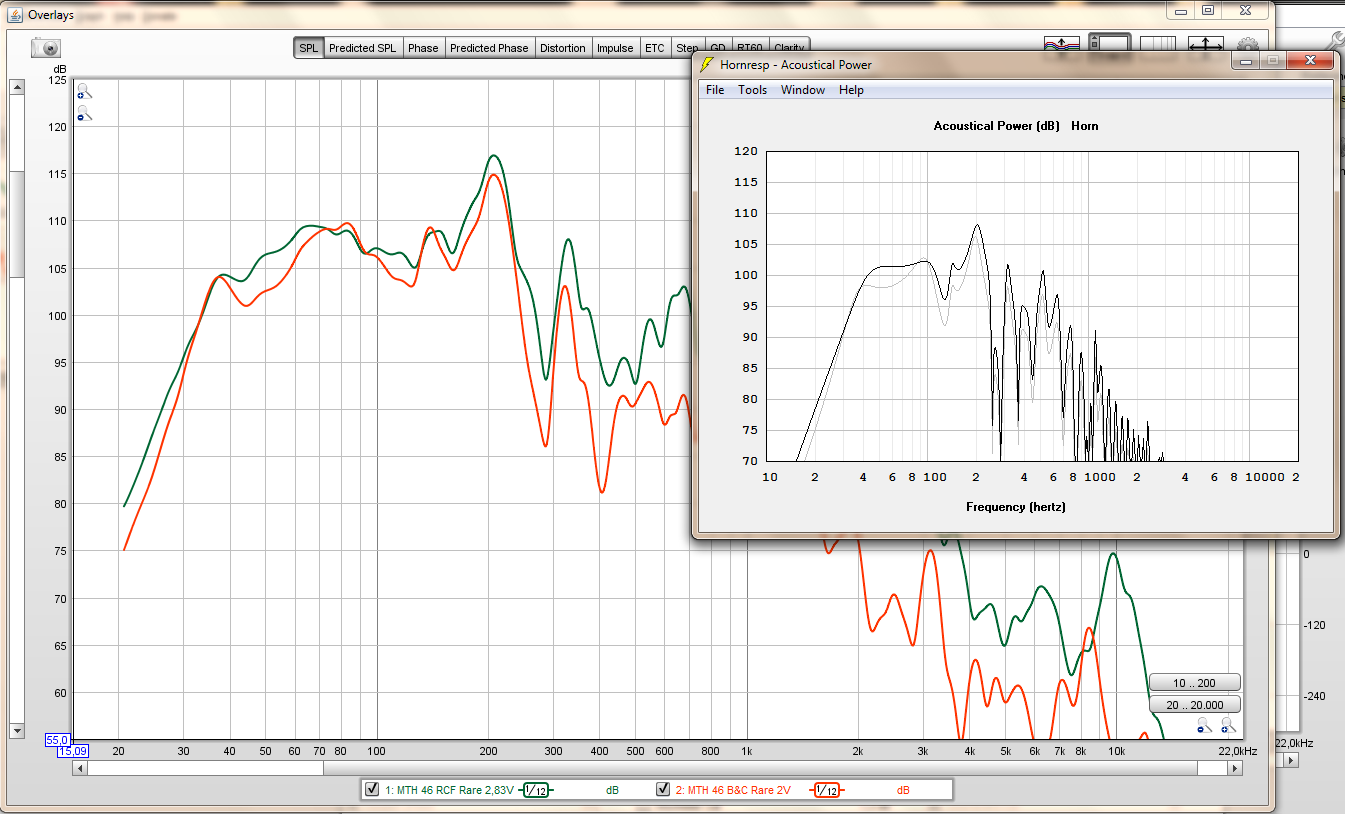

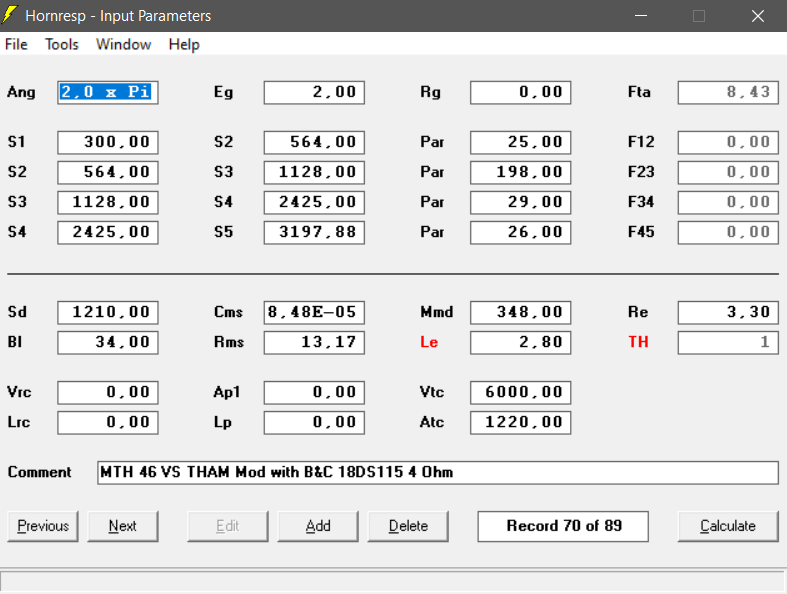

Measurements were taken with the Umik-1 microphone (not that SPL-meter shown at the photo) with normal calibration file. As a comparison LF18G401 (8Ohms) is integrated in this REW screenshot also the Hornresp-models. We see that the predictions are very close to the measurements, nice to see.
Comparison between the two drivers: the G401 is more sensitive in the lower range but does not sound really good in this cabinet. With the DS115-4 things change literally. The stronger motor and way heavier cone do a fantastic job in this cabinet! Two of these are amazing, cannot imagine what 4 or more ot these can do ( or a bigger amp aswell).
