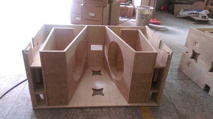

Is this speaker box similar to theTH18 design.
Has two 18 inch speakers
No, no resemblance what so ever.
