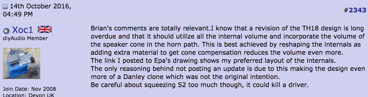

No, you didn't.I still have not located the details of the design/layout of the Xoc TH-18 Mark II. Did I miss it in the thread?
There are "bread crumbs" in post #1003, 1010, 1537 etc.
But #2343 says why you probably won't find updated plans in this thread:
No, you didn't.

This thread is a spin off of the Flat to 30 thread where an amazing mount of development took place in a short time. No doubt that the amount of input I put in then, was due to being in-between jobs at the time, a situation that fortunately I have not been in since!
But that was over 8 years ago - Where are the new killer designs?
Since the thread started
Speaker technology and amplifiers have progressed.
Hornresp has become far more powerful a tool and we know better how to use it.
Design geometry has not progressed very far.
A few people have got to grips with unfolding horn geometry such as Brians amazing spreadsheets. I came up with a good explanation of how to calculate a speaker cone correction and I know it works through practical builds but have yet to see anyone else publicly implement it properly utilising the technique I posted. A request at the time for some cone dimensions to allow detailed analysis resulted in nothing...
The fabled th18 Mk2 design does not really exist, at least not on any of my computers, but I know that it would probably take me a couple of weeks to come up with something that was an improvement on what is already there. But it hangs heavy on my shoulders. We had no idea what the Danley TH118 was like when this design was posted and the published performance ratings for that loudspeaker probably convinced us we were nowhere close!
In the Danley design the V comes right down to the double thickness baffle but that would not suit the majority and would just result in broken drivers for some users. As already discussed I am not really in to creating a complete Danley clone.
All the information is there it just take time & effort to put the pieces together, and maybe a bit of innovative thought to come up with something new to add to the mix.
