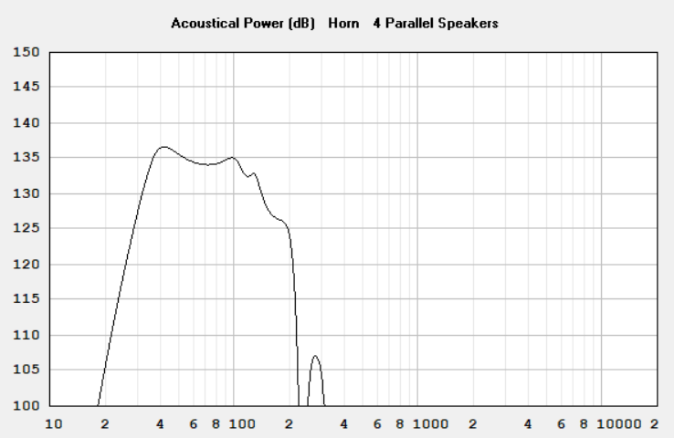

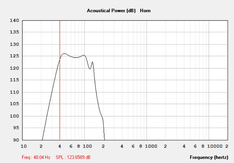

I suspect your max values are too low. Try putting insane high levels for the amp part and real values of the 18S datasheet in the speaker taps - then you should see what the speaker would be capable of (disregarding what the amp could do in real life).as you can see it shows a very weird spl graph when there is more power applied to it and also it indicates insane diaphragm movement, what am I doing wrong?

Hi, can you please help me identify the error with Hornresp
The driver is 18 sound 18lw1400
why you choose Par (parabolic) flare instead of Con (conical)?
Set Slider "pmax" in wizard to a higher level... the way it is now, hornresp thinks, the driver only can take 64 watts, that´s why it´s looking "ugly"

This comes up fairly often, so I'd like to address it.
What's happening here is that Hornresp is setting the frequency response so that the driver is receiving exactly the power input shown (unless Xmax is a problem). When the impedance goes up, the voltage input will also go up in order to make sure the power dissipated stays constant (P=V*V/R). Since speakers are conventionally voltage driven, having a drive voltage that varies with impedance will give an extremely non-linear frequency response, as we see here.
Chris

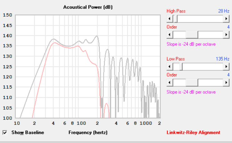

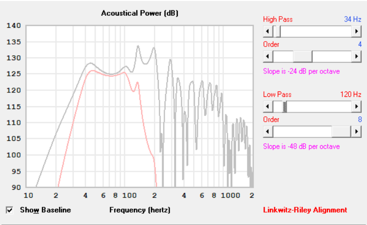

The 18S 18SLW2400 is not that powerful duo to its limited xmax of 9.5mm and not that powerful motor, especially now we have Lossy Inductance method in HR. You could drive it max at max 56v (400w) if used with crossover settings
This is how it looks like with crossover settings:
Settings:
4 cabs more:
