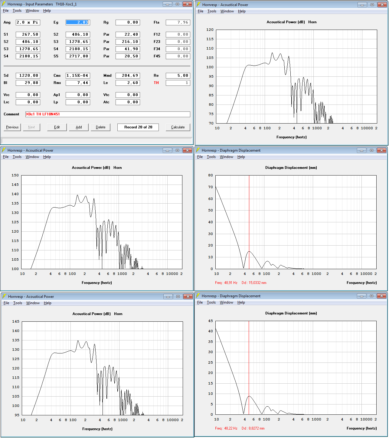

Would this driver work in a TH18 Thanks
Phil
LF18N451
Phil
LF18N451

Looks OK in the Sim Lordsansui has provided.
X max would ideally be bigger but xmech looks generous.
If Hornresp is reporting 520 w into 8 ohm - power will be more into Re and also add in 2db for compression and you are probably looking at 1000w to reach x max.
Some of the RCF drivers seem to sim well in a TH.
I was looking at the RCF LF15X401 15" yesterday looks like a killer driver in the SS15 with a 11.5mm xmax
Guys, I can assure you that the RCF driver you suggested is miles away from what the SW115 drivers are capable of. The xmax at 70% variation of the KMS is about 8 mm and of the BL is at 10 mm. The peak displacement that driver can have without being horrible is 12 mm. The protection value for displacement on the 18sw115 driver is 16.4 mm. Also , the thermal power handling is much lower, even though they specify it almost the same.
