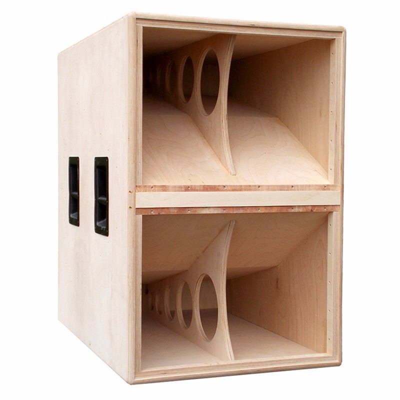

It is a pity the TH18 path* didn't get all the way to a generally accepted as being optimal finalized design. I would go out and buy a pair of 18sw115's tomorrow if the plans were around. I know this is kind of lazy but i just can't justify learning to do the last bit of design my self as I am sure it would take me many many hours to learn and then design.
Reflex will be the most compact option as ever because it is less efficient. Needs more amps and drivers but less truck space.
I do like the fact that a TH design can get away with a lower high pass filter than a comparable reflex design, even if the natural roll off is higher, this seems to give a more natural presentation to my ears.
The difference in volume between a pair of reflex cabinets and a pair of tapped horns used at comparable high power levels is amazing, a pair of reflex cabinets might require compression to try to get reasonable levels where a pair of tapped horns might only need light clip limiting giving higher average levels and much higher transients while still keeping cool.
It is frustrating that so many requests for an updated design are made but none have gone the final mile and posted their own updated version.

Bassreflex is recommended for volume/output ratio for smaller to small systems.
I still get more output with compact bassreflex in volumes under 250l for the box. I envy these guys who can afford to build and move larger TH bins...
Even smaller TH bins should outperform BR boxes of around the same size, using the same driver. Sim programs tend not to take into consideration the impact of vent compression effects (significant with BR boxes and tend to start happening even before the onset of audible chuffing), and thermal compression (the layout of a TH results in better cooling for the driver than your typical BR box). There's also a possibility that the S1-S2 section of a TH can also help to reduce overall distortion, but I haven't explored that fully yet by experimentation (I have noticed it in offset TLs, currently my favourite alignment, that have a similar arrangement).
THs do have the disadvantage of having a smaller usable passband, but this usually isn't an issue for boxes designed for subwoofer duty.
The TH18 design can perhaps do with a bit of tweaking however to bring it up to date. Since its original design, we've learned of semi-inductance, and its impact on output at higher bass frequencies. Hornresp now allows the use of the semi-inductance parameters in the sims, so their impact can be taken into the consideration in the design.

I think he's on about HPF and shoving more drivers in less space, it may have an advantage when the boxes are relatively small. Increased thermal capacity, in exchange for limited extension.
NEO Dan: What´s up with HPF? Yes, I´m also about shoving more drivers in less spece, even if it easily can mean only one driver in comparison...
I have built few tapped horns, and I like the general performance, construction, sound. Yet its power density in "reasonable sizes" was not convincing.
Brian Steele: No, I usually scrap things including boxes, as all becomes less relevant in time. Different drivers, different amps, different circumstances between comparison and measurements. Findings simply do not add up to make a cumulative study full of worthy comparable and presentable data. I also didn´t find any online. It would take some time and money, which I´m already pouring on other findings in audio. Knowledge is expensive...
The observation is, that high displacement volume driver with high motor force gives me better size/performance ratio than what Tapped Horns gives me in small volumes (I.E. The box I can transport alone).
After that finding, I went with 2x very compact B&C 21DS115 bassreflex box.

I´m still working out the bassreflex port size for no HPF usage at home, and for port compression with HPF at 32-34Hz. for PA. Seems 600cm2 is plenty.
For the time being, it is 125l net box each, port tuned at 30Hz.
Outer box dimensions: 580*600*730mm, wheels mostly hidden in the box footprint.
Raw outer volume of the box is 247,5l. Should have good ergonomics and low weight, so one guy can move/load it. The single box volume and performance is the important constraint in this case...
Here is current state of the development. Seems I will keep it like that. Small touchup here and there, and then getting these manufactured by pros...
