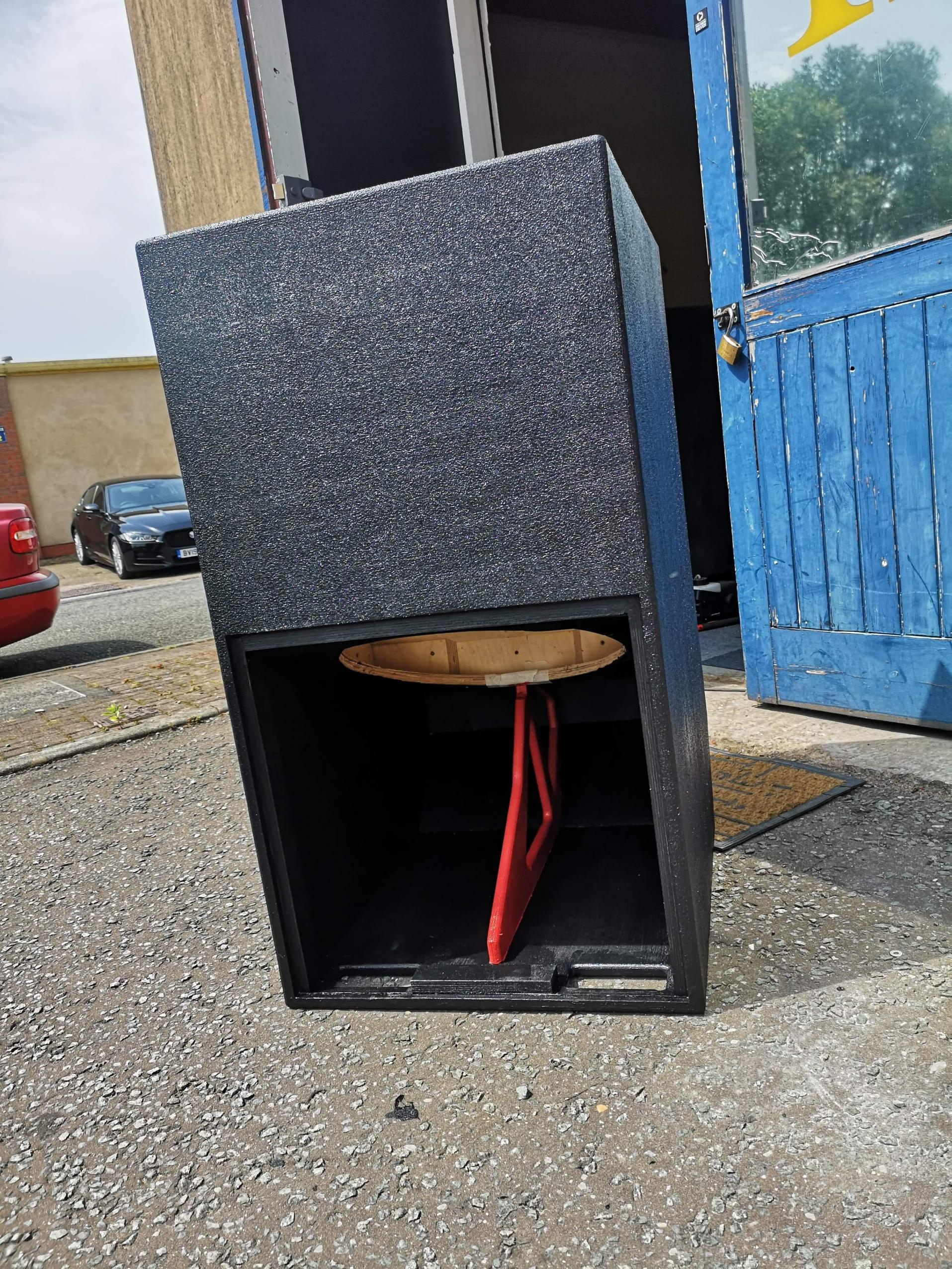

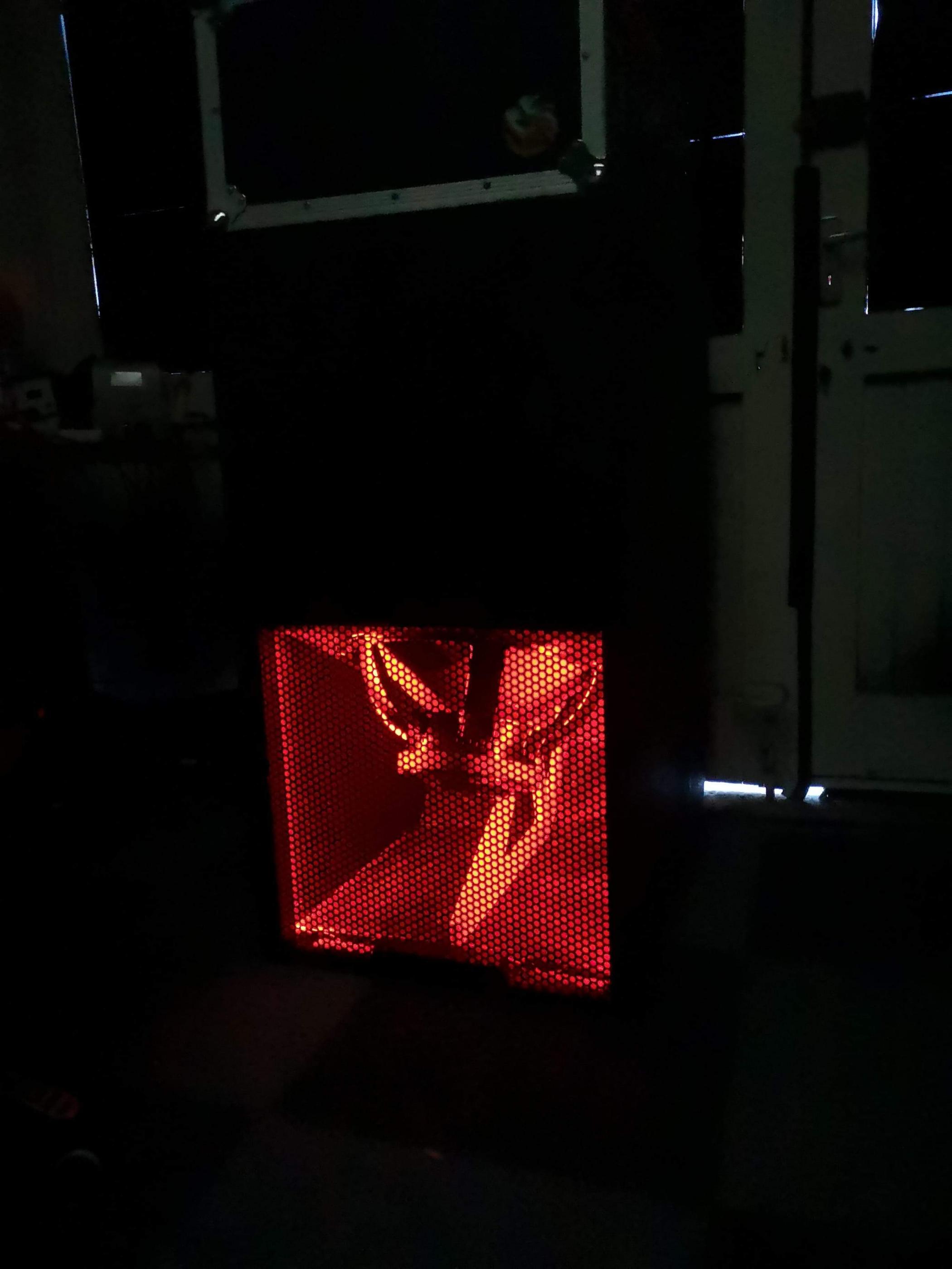

Just had my first box made, not been able to test it as I had it on for about 10 seconds and set 3 car alarms off at my unit. Opppsss.
Can anyone tell me if the polarity needs reversing on the driver as the from the the driver is firing into the cab.
The primary output of the tapped horn is from the internal horn path, so the driver polarity would normally be a "+" signal causing movement of the cone towards the horn throat, away from the exposed magnet structure.J

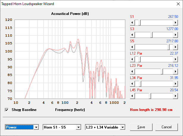

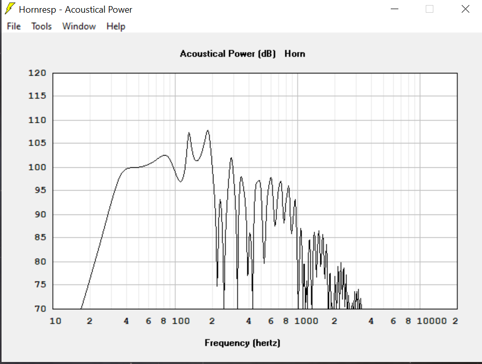

Semi-Inductance 🙂
Hornresp has been updated to allow sims to include the impact of the driver's semi-inductance parameters. This can substantially change the sim'd output of the design. The attached shows the difference between the old model (grey) and the new one with semi-inductance enabled (red) for the TH18 loaded with the B&C 18TBW100 driver.
Semi-Inductance 🙂
Thanks, so I take it the design itself is unchanged including cone correction?
