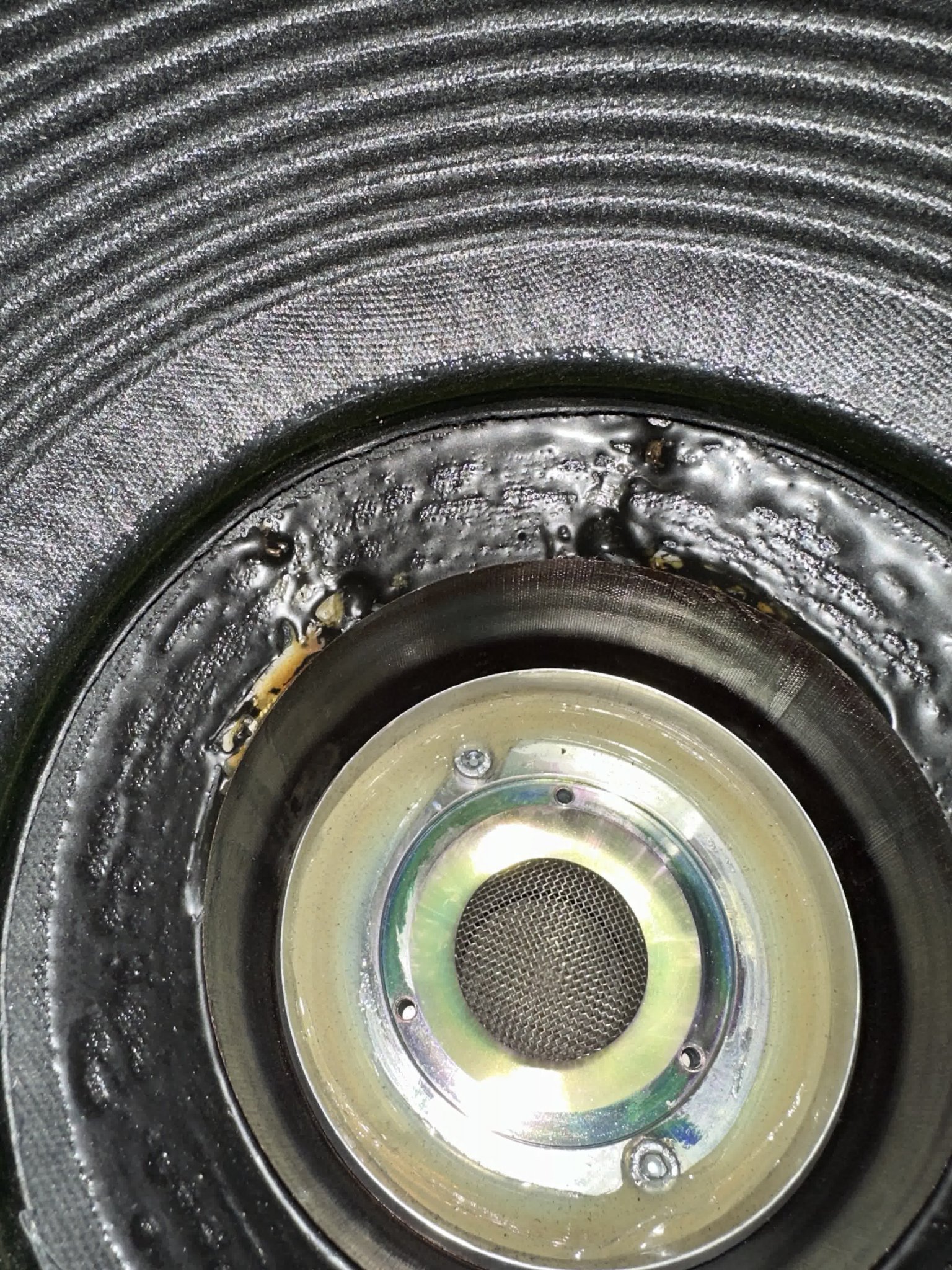

Guys, im not sure why i didn't discover this on my last free air test but it's the drivers! both doing exactly the same....bad batch maybe?
Now, the sound is worse at around 60hz but if i do 30-40hz the sound disappears. This says to me it could be loose tinsel leads on the inside of the dustcap?? on the outside the leads are rock solid and tried to put some foam between the outside tinsel leads and the cone and didn't make a difference. Also, If i put my finger just slightly on the cone while the noise is appearing, it seems to dampen the noise. if i press slightly harder, it goes away. for me this points to something loose rather than a broken motor.
What'd you reckon?

well i've taken the cap off and everything looks absolutely fine! the leads are fully secured and glued in with no movement whatsoever! everything else is rock solid and well built. not sure what else it can be! Will probably speak to BMS tomorrow and see what they suggest.
just waiting for an email back from their tech guy. i do feel like i'm gonna have to change them!

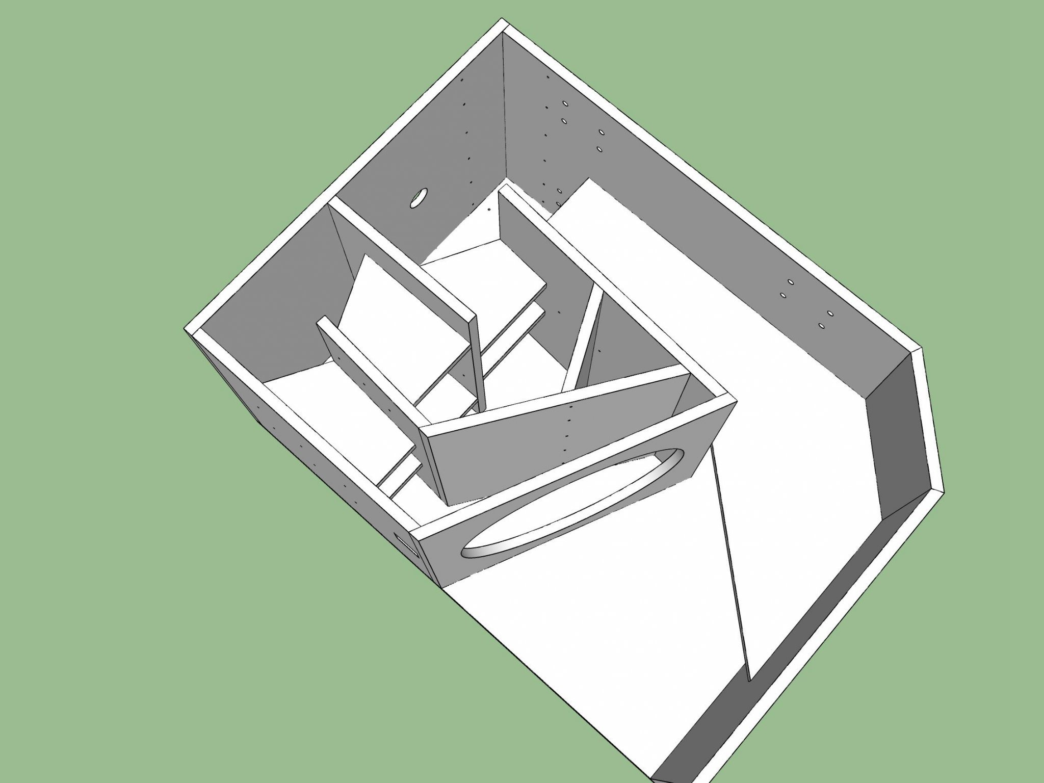

I was wondering the same thing.What is the compression ratio of your design?
You want to be under 3 to 1. Similar to BR and BP ports being no smaller than 33% of Sd.What is the nominal compression ratio where that driver was used?
24" = 8" port.
21" = 7" port.
18" = 6" port.
15" = 5" port.
12" = 4" port.
8" & 10" = 3" port.
6.5" = 2" port.

i wish i can tell you the ratio but i have no idea. all i can say is it's the exact same designs as XOC but using the BMS drivers.

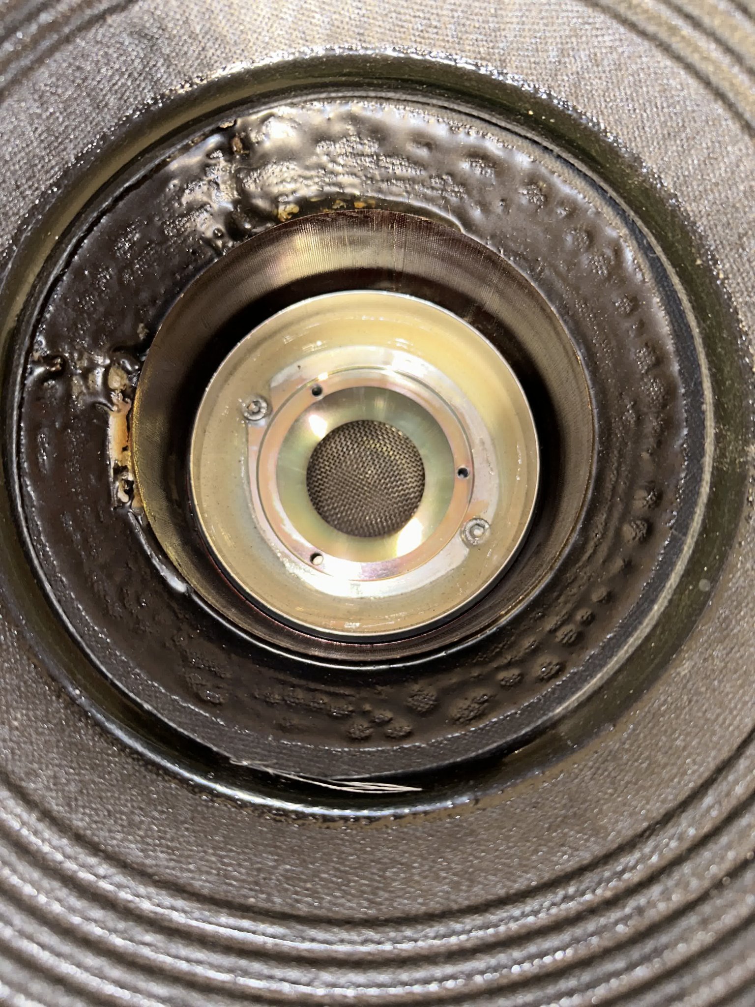

I got the response from BMS this morning. This is what he said.
on a side note, these cabs are not used very often and were not used during covid for almost 2yrs.
I've never got these close the xmax so it seems that this has happened during them just sitting there not doing anything for almost 2yrs! A recone it is then.

"The problem is that the soft parts are deformed.
One reason is a systematic overshoot of the linear excursion of the speaker. 18N862 has a linear stroke of 38mm and a maximum of 60mm, which leads to mechanical destruction of the cone. The permissible excursion is up to 40-42 mm, because if it is more, the spider is stretched irreversibly, and while the cone moves it becomes unstable laterally and the coil starts to hit (rub) in the magnetic system.
Another reason could be the long non working period. The voice-coil is quite heavy, and it could deform the soft parts while the speakers are mounted in the boxes or the soft parts may soften /tear and wear/. The deformation can cause again the rub in the magnetic system."
