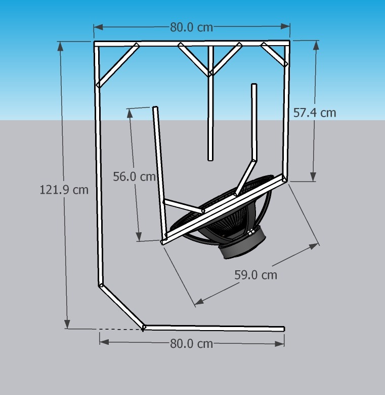

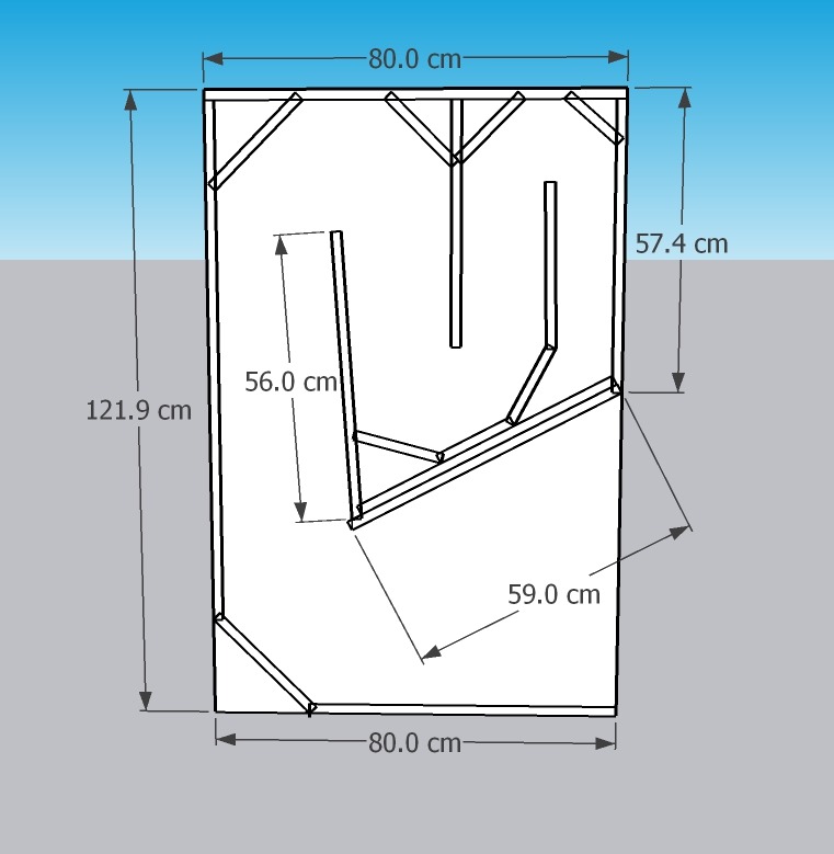

Hi guys, I'm very interested in building some new subs for our sound system. The Th18s look promising but unfortunately there are a hell of a lot of other designs that would be nice to try. In particular, almost everyone else here has classic frontloaded horns but they're just a bit too big for us. How does the TH18 compare? Is there by chance someone in Germany (preferably near Saxony) where you could maybe test a TH18?
Acording to the major consensus on the forum, the corner panels looks nice but only take area from the horn, and that is not a good thing.
Hi Stewin - That looks more based on the Danley TH118. There is a lot of dimensional information missing from the sketch. No driver spec, or even a horn width!
This makes it very difficult to even start to evaluate. The compression on the driver will be quite high and dependent of the geometry of the cone and baffle cut out, so again not enough information to run a simulation.
As such any guess on the performance of the cabinet would be just that - a guess. And with a 21" driver, an expensive one!

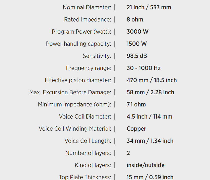

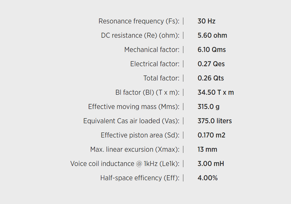

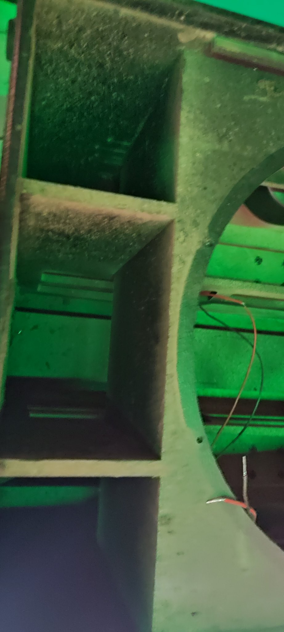

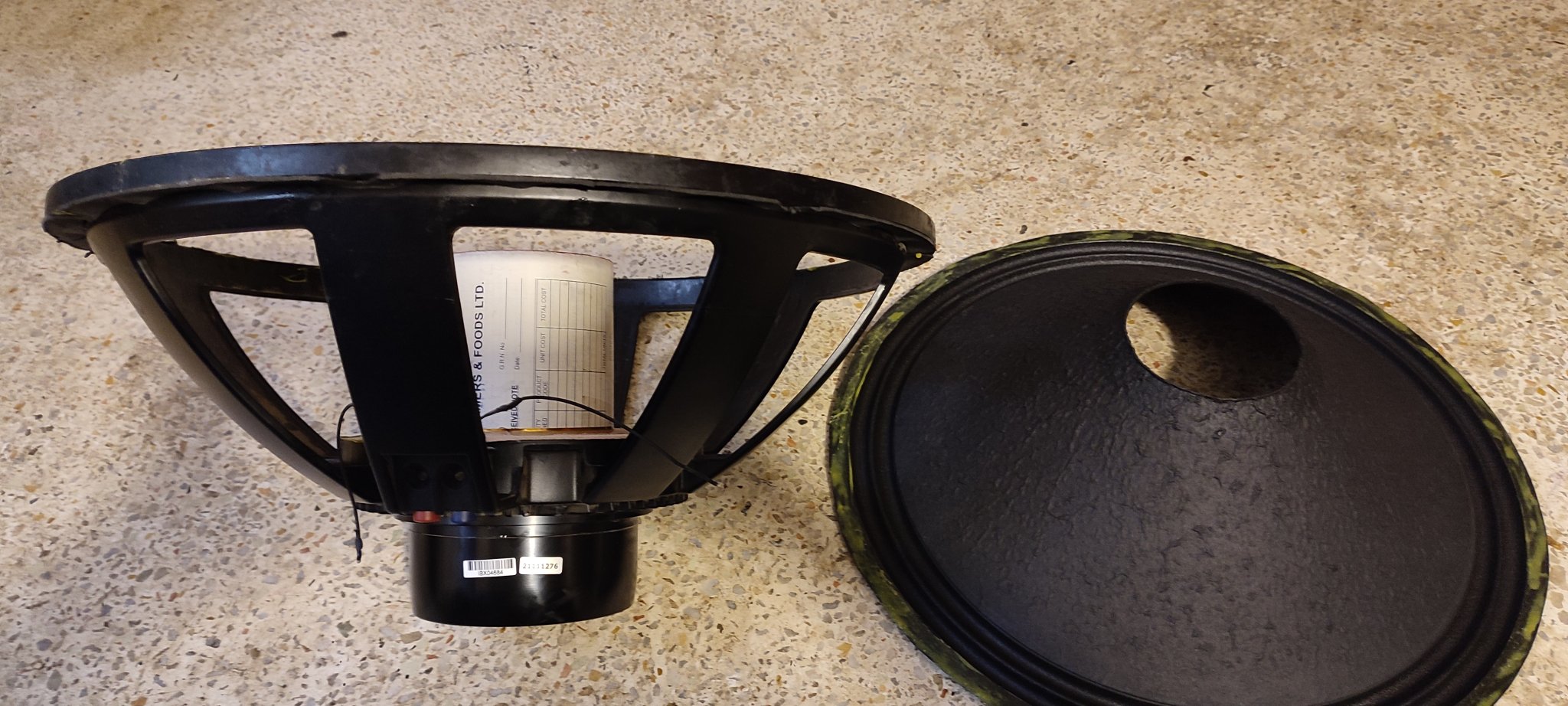

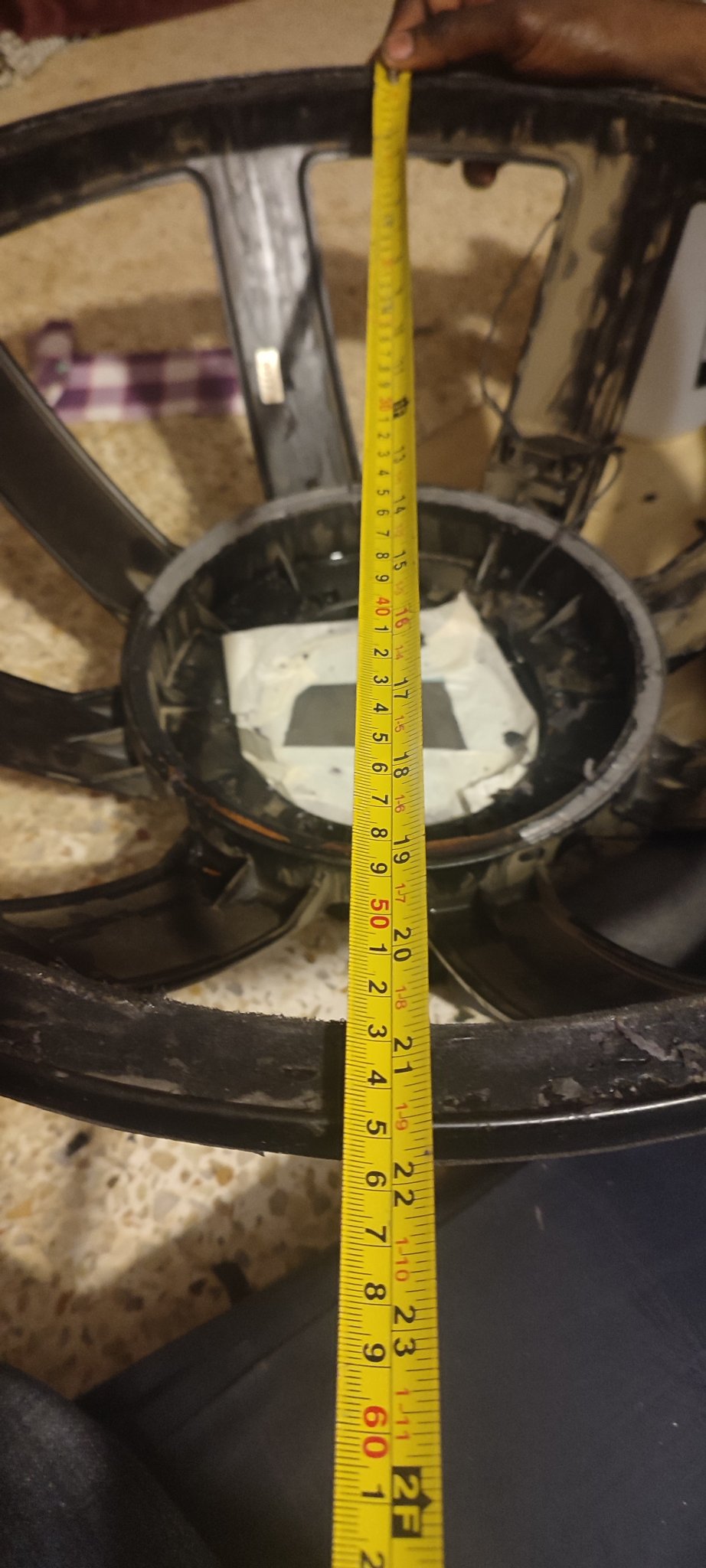

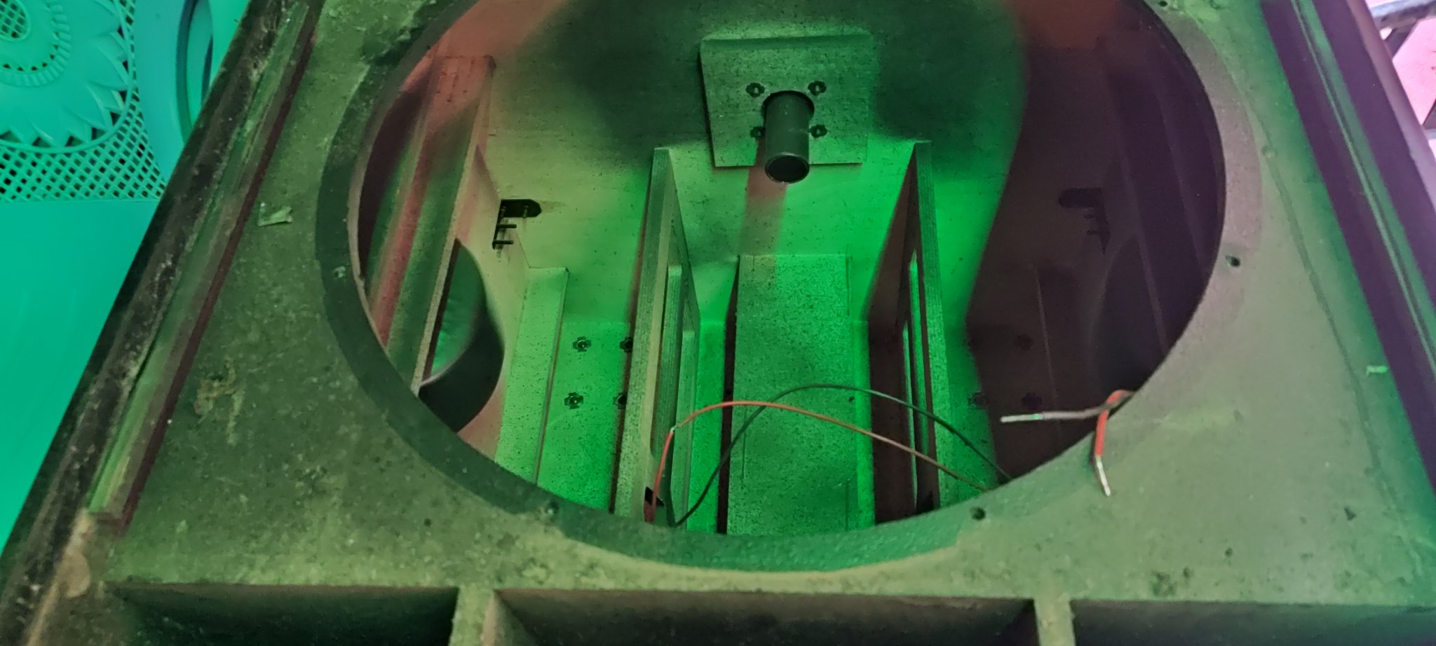

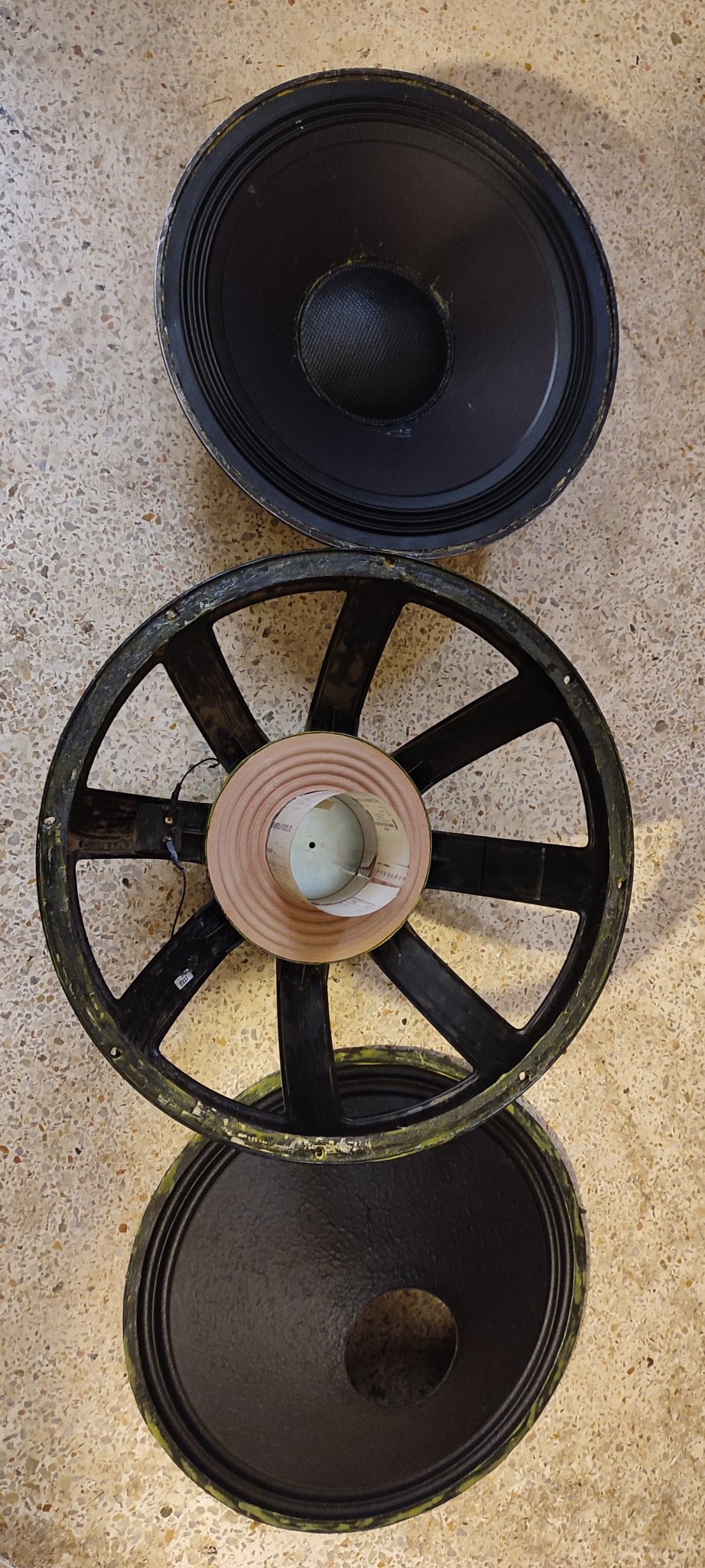

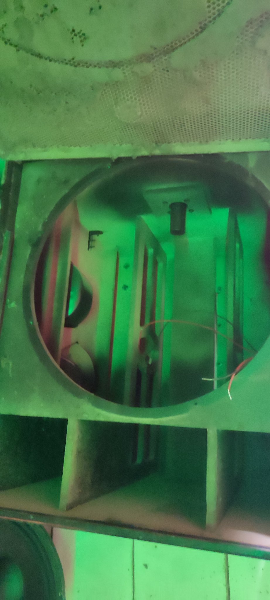

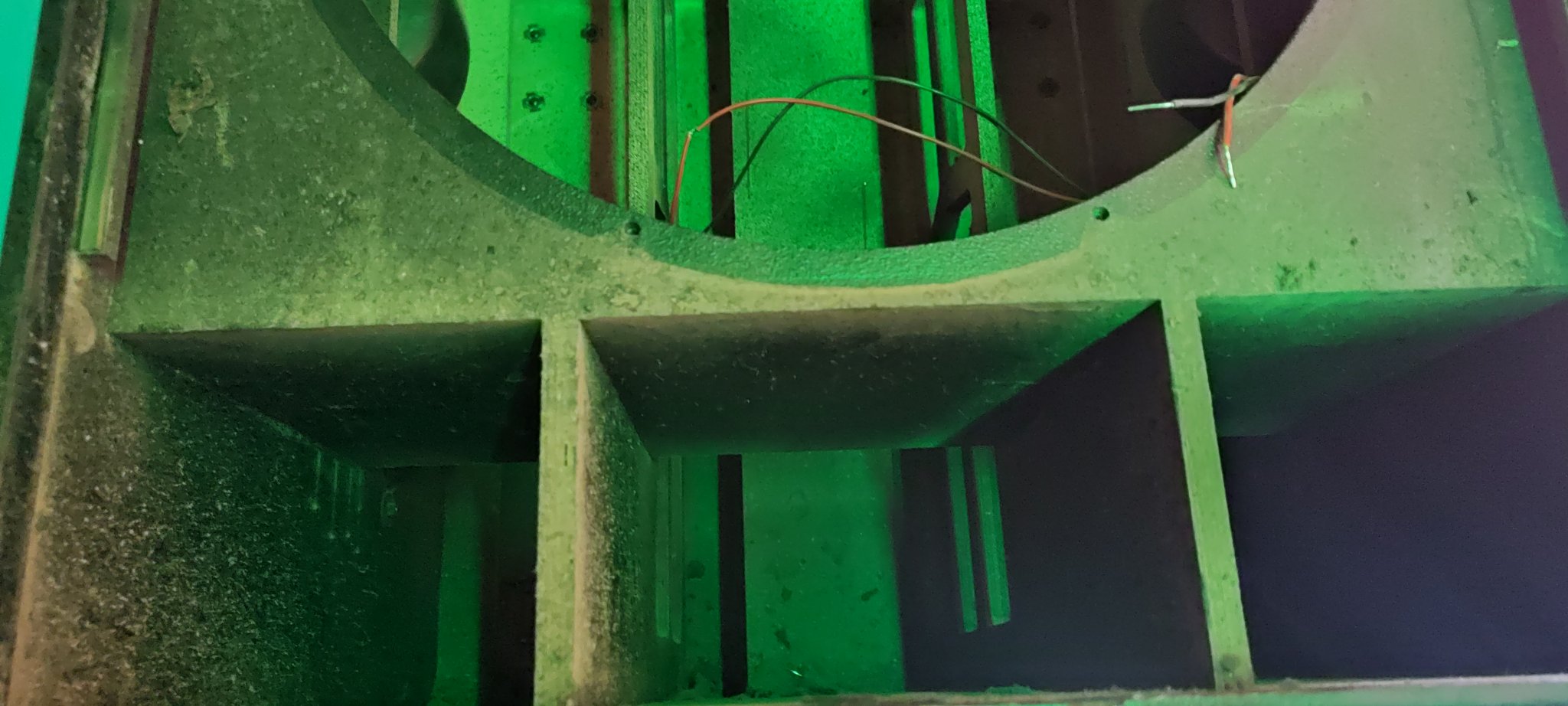

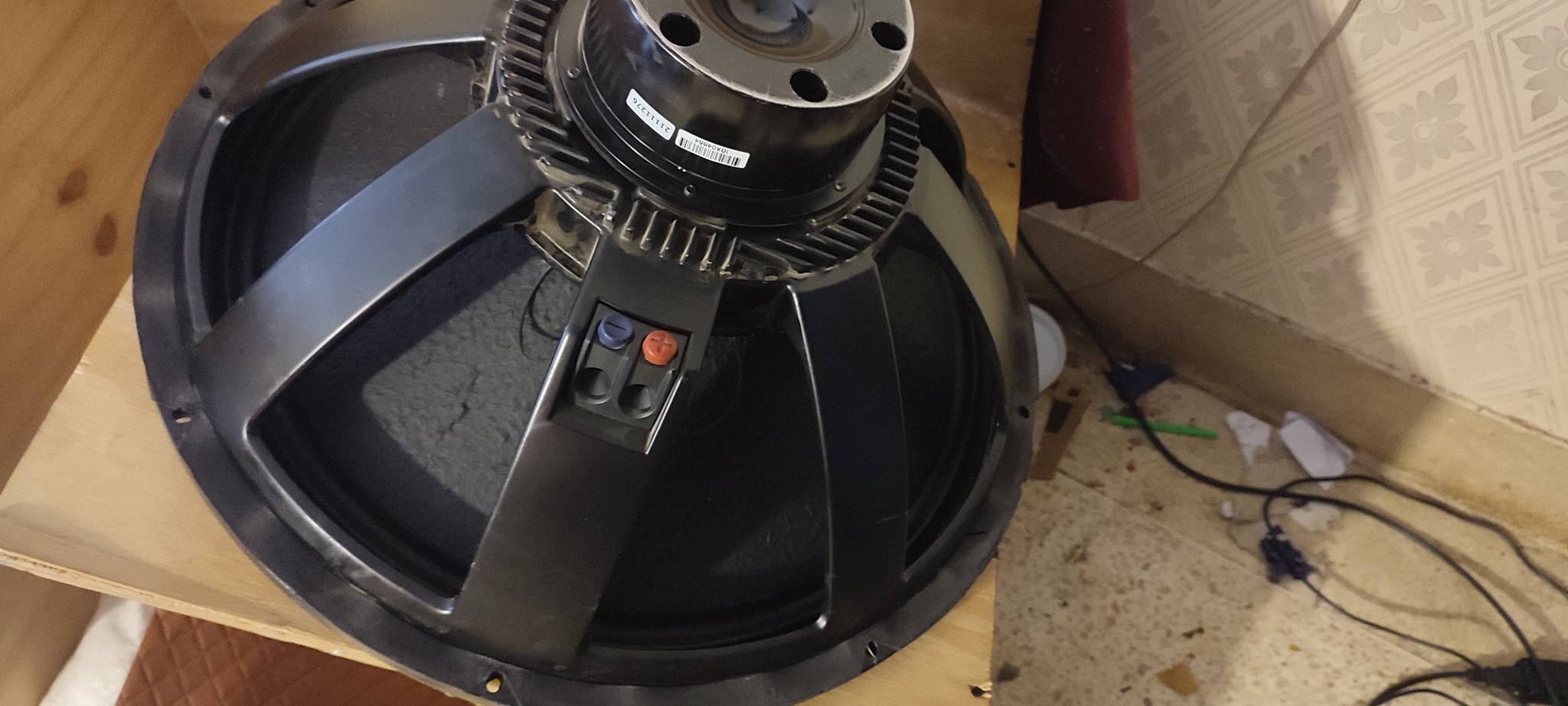

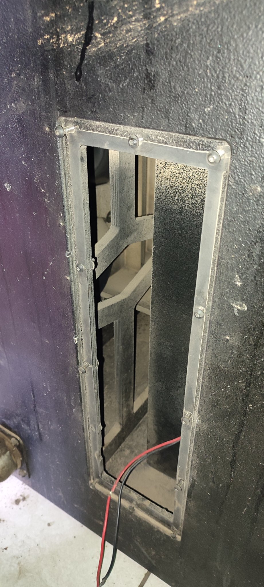

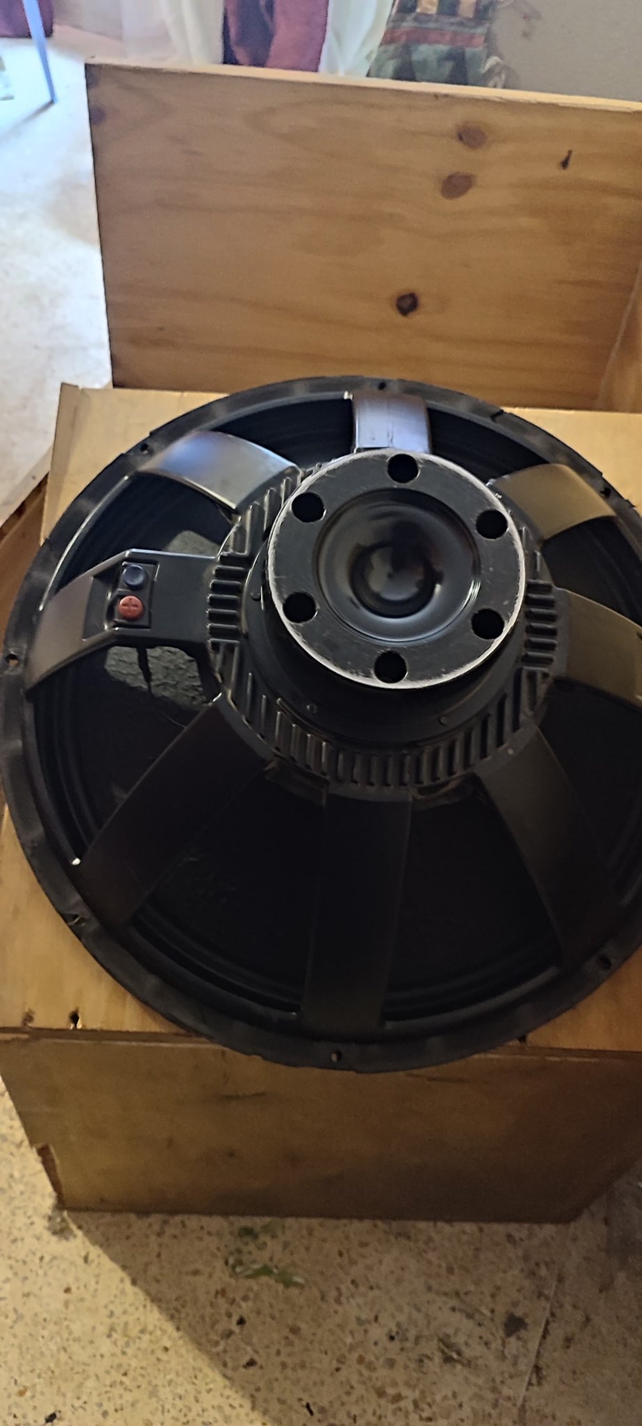

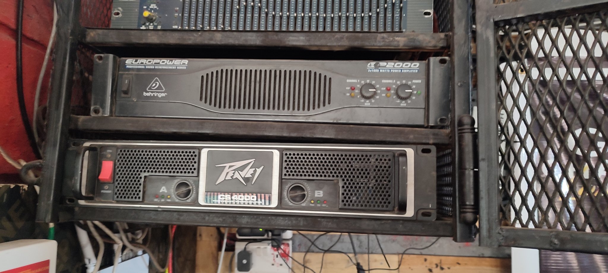

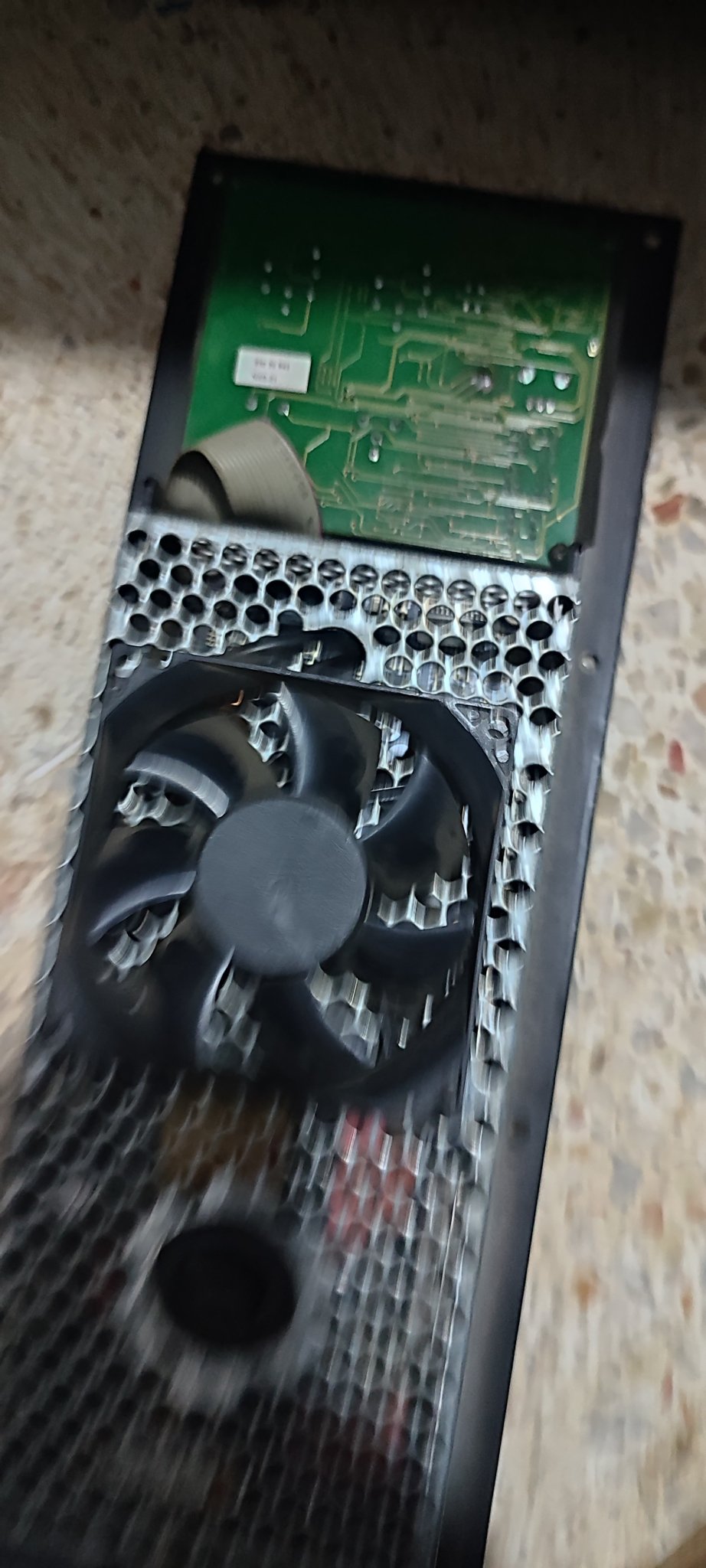

thanks maxolini , bp1fanatic and xoc1 for the replies . the speakers i am using looks similar to rcf neo and it was in a german made cabinet ( it has no label or logo).
it uses a 115mm inside out coil similar to rcf. the box was ported (powered but the powered side was spoilt ) ,i was using europower 2000 as the amp .
it had overshoot and the cone , but it was overdriven with a bigger amp smh.

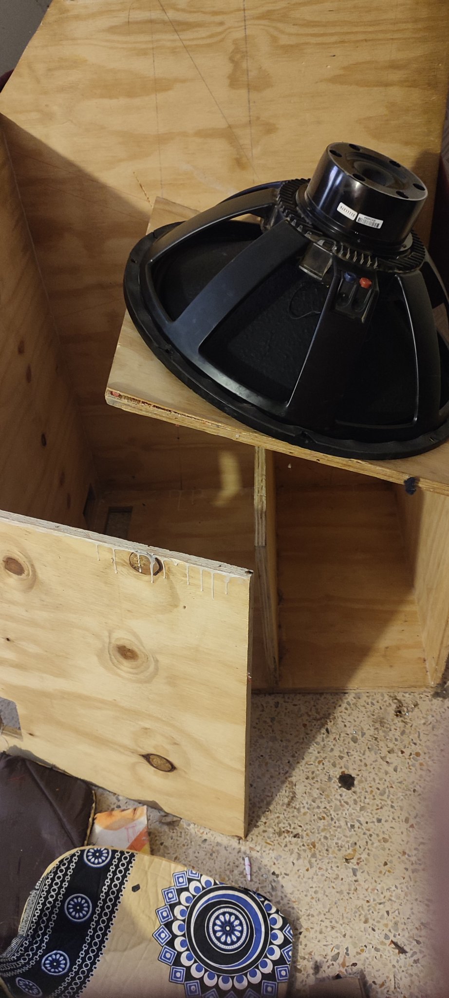

anyways the original box perfomance is impressive , but i wanted the power of the xocs enclosure in a 21" driver

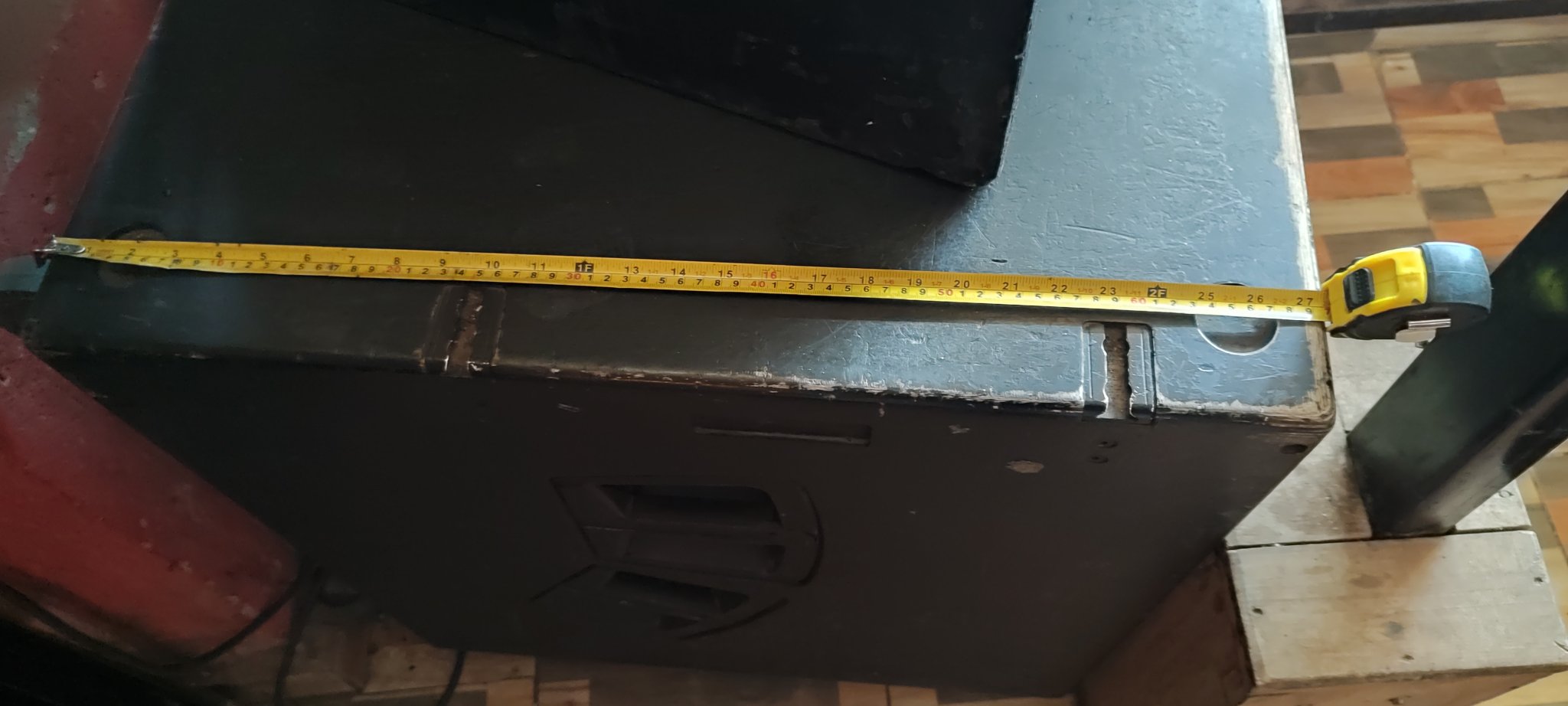

in real time real life the 21" driver in the xoc 18inch box

looks like the driver is the rcf LF21N451in real time real life the 21" driver in the xoc 18inch box😁😁🥰
