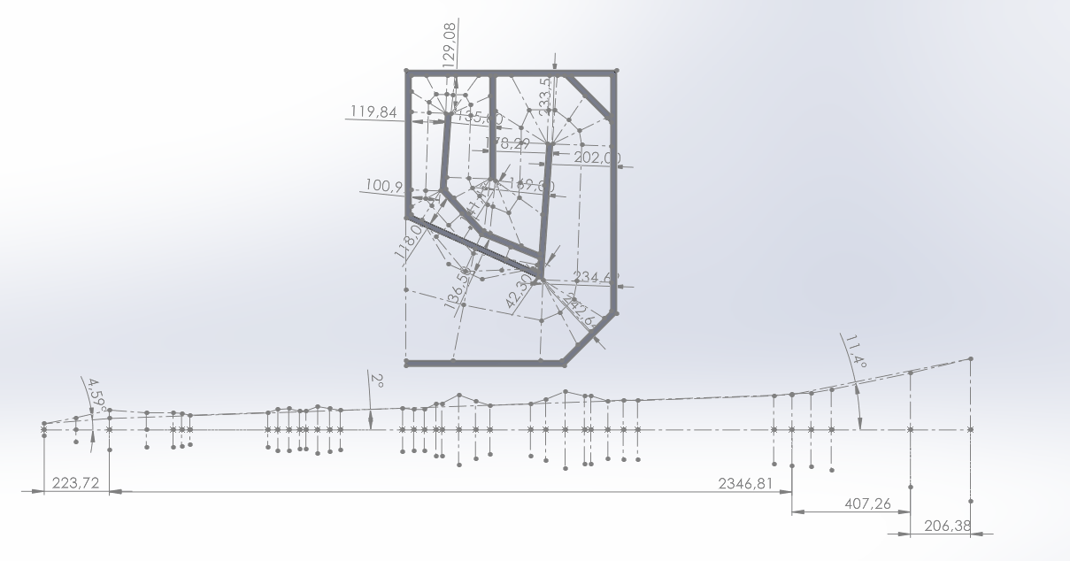

This is how I dealt with the "cone compensation" issue with one of my builds. Unfortunately it didn't make to long term use, but that was due to other reasons that had nothing to do with the design .
As Brian refer, this is a more modern model to better take advance of volume space inside cabin, it makes little hard to glue angled panels.

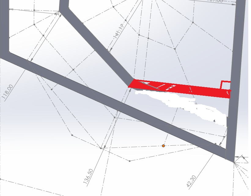

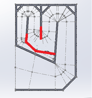

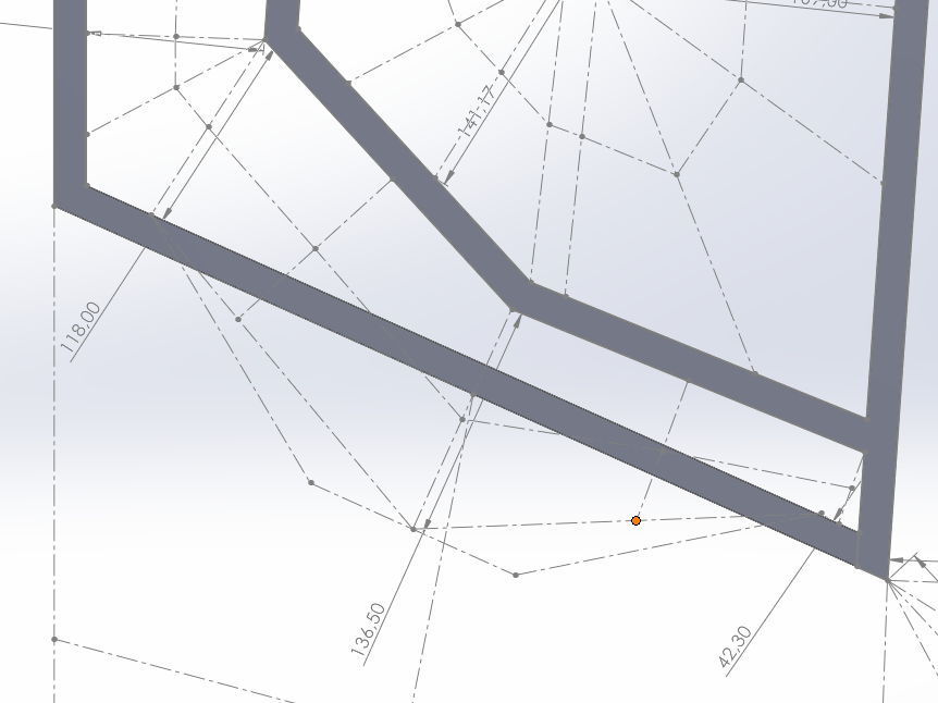

Hello folks,

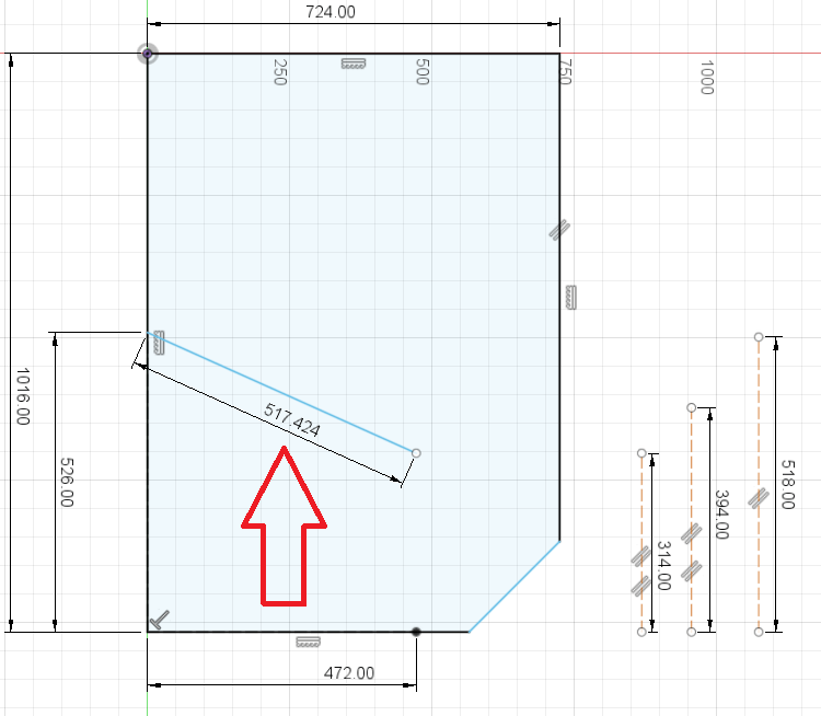

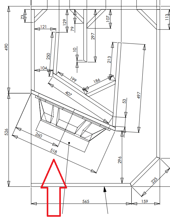

I'm laying out the TH18 side panel in Fusion 360 so I can CNC some side panels, and the measurements in the plan don't always seem to match with reality.
By coincidence, I see that @YoungD has posted just a few days ago with similar concerns about the plans.
For example, when I place this line which will be the bottom face of the speaker baffle, it should be 518mm (as per plan) but in reality, that line measures just over 0.5mm shorter
Does this type of minor discrepancy matter? As long as everything fits, I guess that <1mm differences won't make much of a difference to the frequency response of the cabinet right?
I attached the plan I've used, which appears to be the one which plenty of people used before the discussions about cone correction started.
Thanks!

Thanks, yeah - it's within the margin of error for the people laying out the panel by hand I guess. Too easy to get bogged down in these fractions of a mm with CNC, but I'm doing it for the first time and I want to get it right.

The model is available for download, check the link again in the upper side.
It's a CAD model, so all information is there.

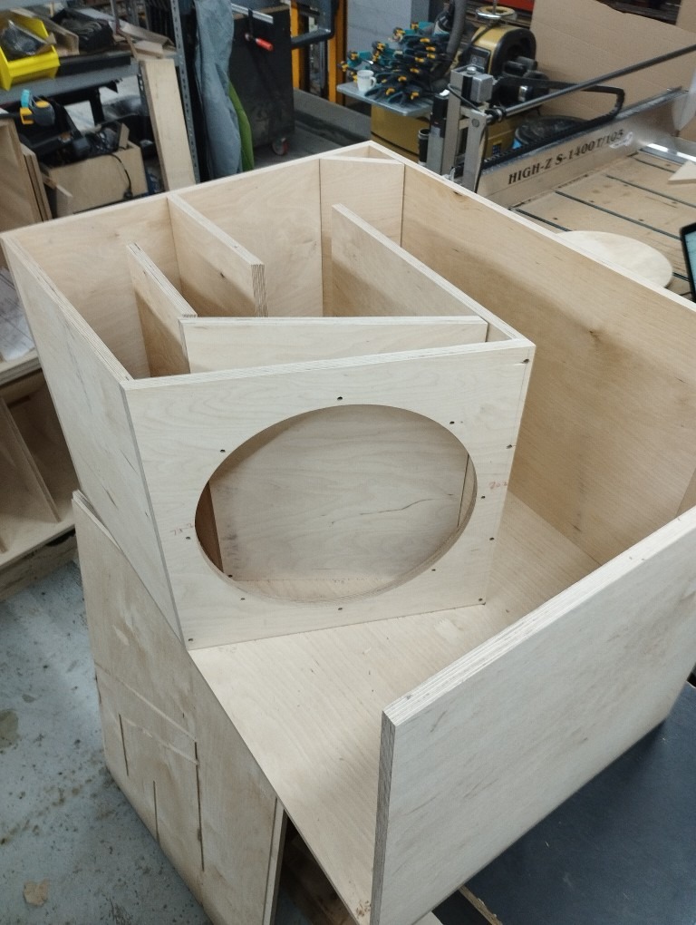

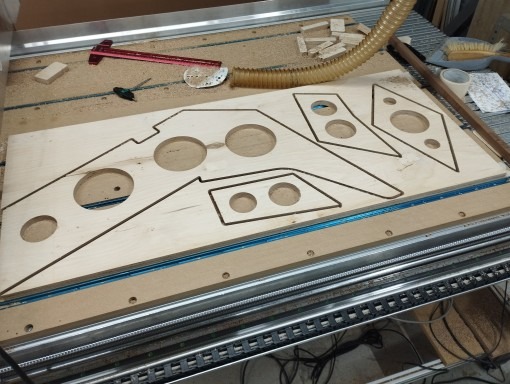

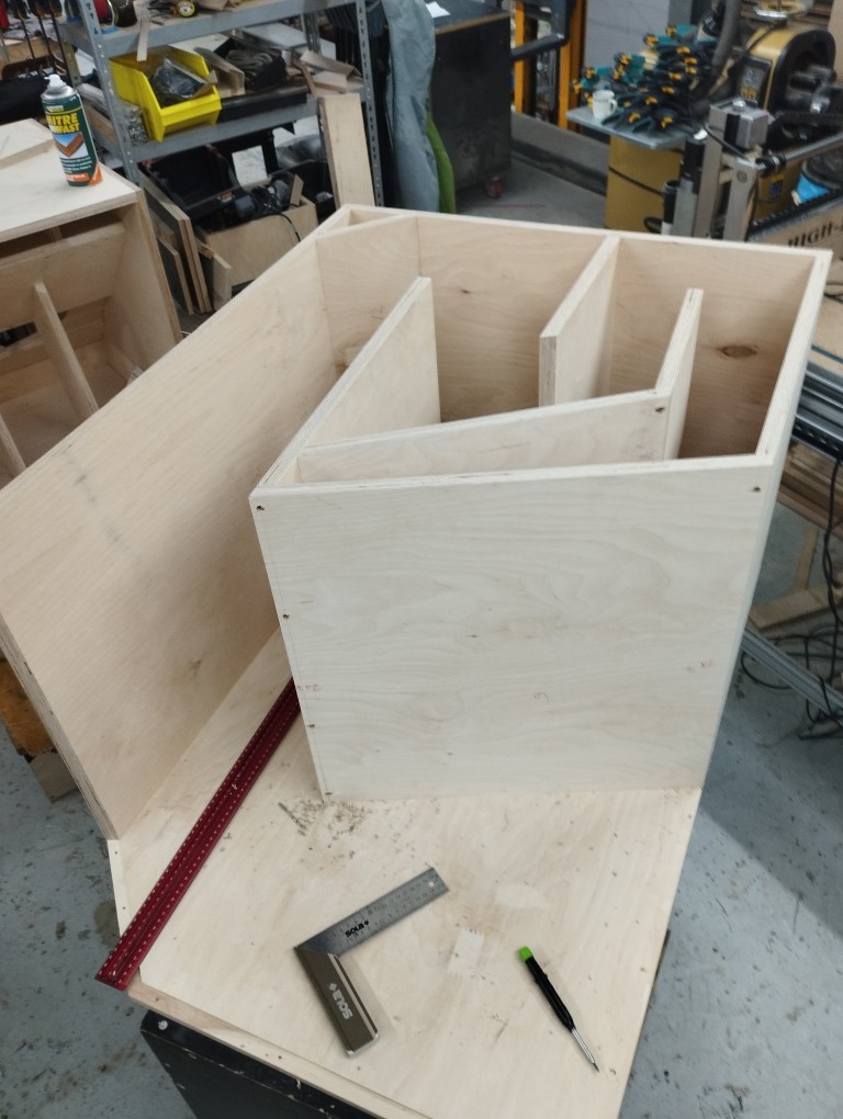

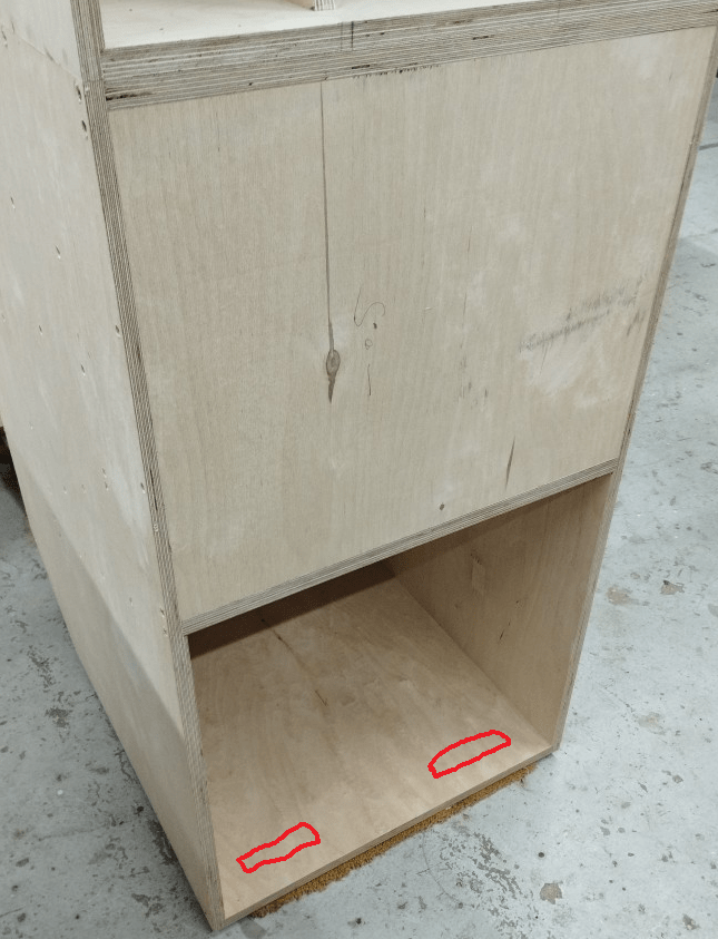

Alright, here we go with a simple build using 18SW115.
Today's progress - side panels CNCed and other panels cut on cabinet #1 of 2
Test fit looks OK.
Tomorrow I need to
Then I should be ready to glue this one together.
A few photos ....

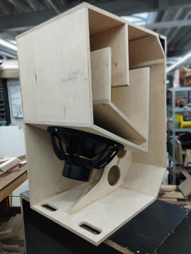

One question...
In addition to the handle holes at the back, can I also put two hand hole cut outs on the bottom panel as indicated here?
It would help a lot with carrying to have one person at each end, but will these hooes affect the performance of the cabinet when the base panel is flat on the floor?
Cheers!

Niceeee build!!! How do you cut the plywood?Alright, here we go with a simple build using 18SW115.

Thank you. I added themThe hole should not have any noticeable impact.
WIll add them afterwards if I feel like they're needed. Lifting it by two people using the handles at the top rear and bottom front actually seems pretty easyConsider putting handles on the sides as well.
Yes, this is an excellent idea.You could always do a test run with the side panel just screwed down with / without reflectors, cone correction etc. to confirm what impact they will have.
I work in a workshop with a big Felder sliding arm table saw so I used that.Niceeee build!!! How do you cut the plywood?

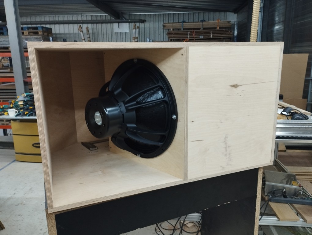

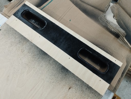

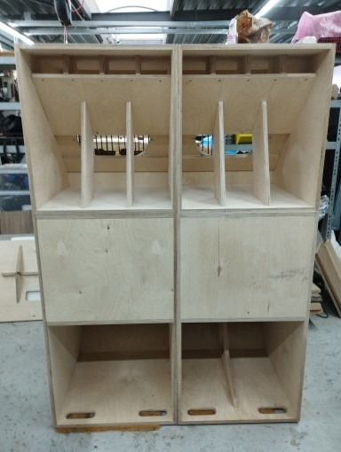

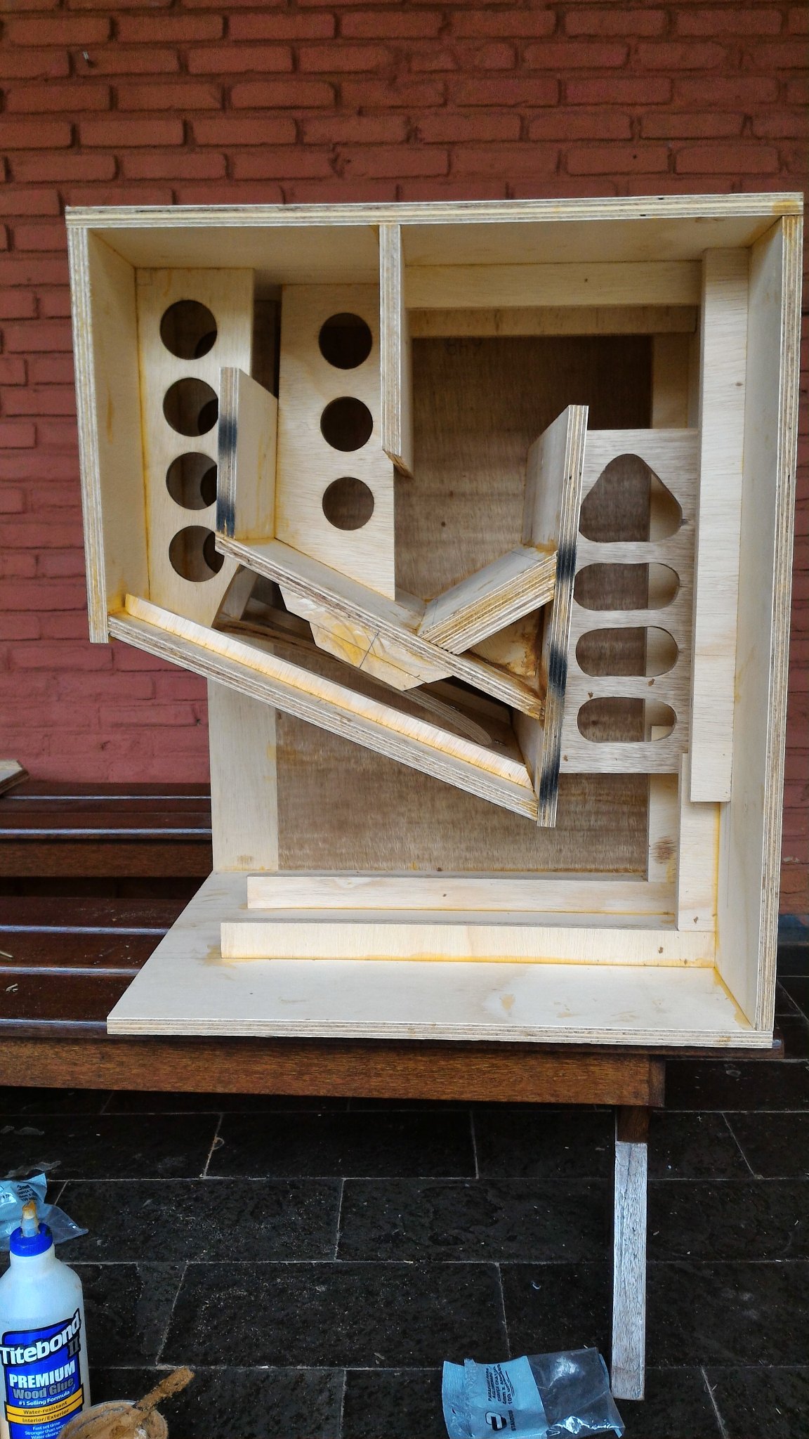

Anyway, some photos.
The 1st TH18 is glued together except for one side panel. Number two will follow later this week, when I've cleared some customer work out of the way.
CNC brace parts
Test fit of the braces

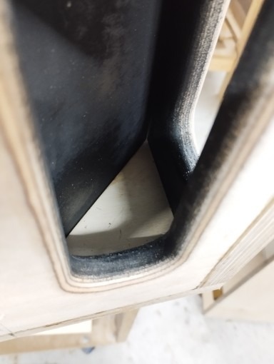

Congratulating myself cos I remembered to paint the inner parts of the back handles before glue up
Kicking myself cos I forgot to paint this little triangle on the side panel before glue up haha.
I should be able to get some spray paint through the hand holes to cover this little patch
All internal panels, sides, top, bottom and braces glued and then left for the night. Then I did test fit of the driver just to see how it looks 🙂
After some gentle persuasion with a rubber mallet to get the second side panel on, and a few screws in, one TH18 is pretty much done.
My stack as it currently stands. 2 x TH18 subs with 18SW115, 2 x Cubo kicks with 15ND930. Everything's about 80% done at this point.
After a lot of reading and research, I think I'm probably going to go for Syntripps for the tops.
More to follow soon!
