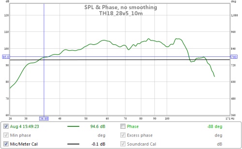

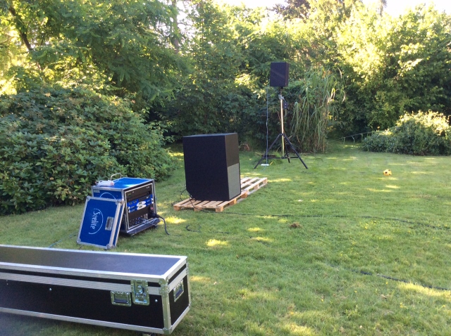

TH18 Measurements
Did some measurements today and wanted to share. Comments are welcome.
I was hoping to get to use my new SPL meter as input to REW but the results were so inconsistent that I went back to DBX M2.
Using REW
Setup was 28.5v measured with voltmeter at 50hz
Distance 10 meters and approx. 70cm from the ground
Highpass 30hz/48db
Lowpass 110hz/48db
