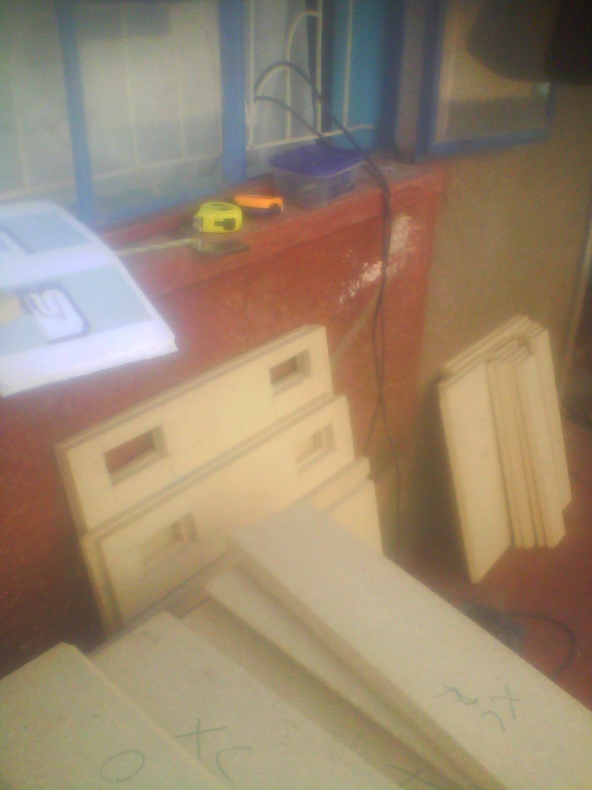

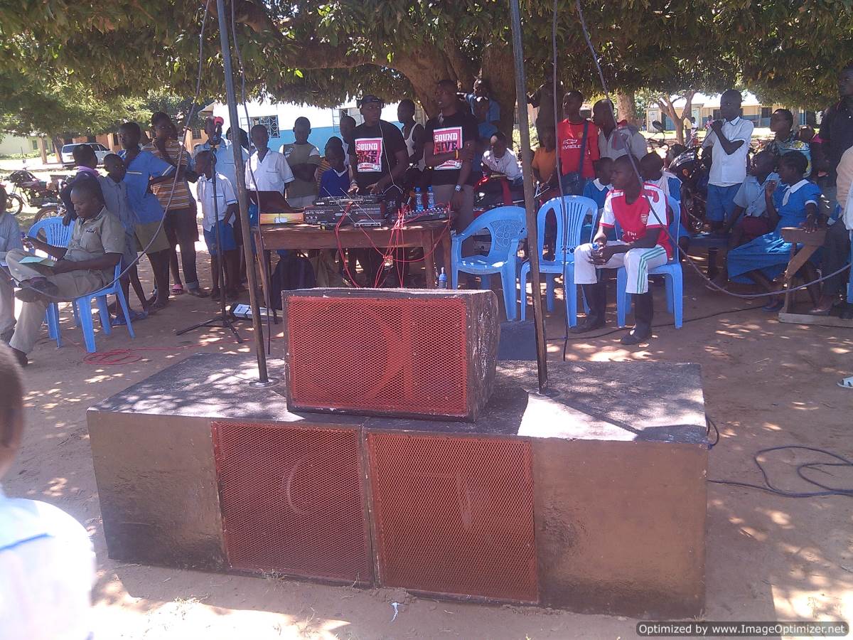

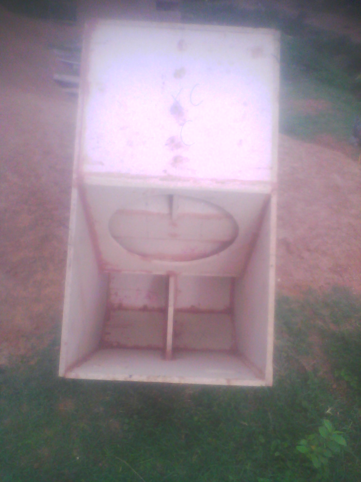

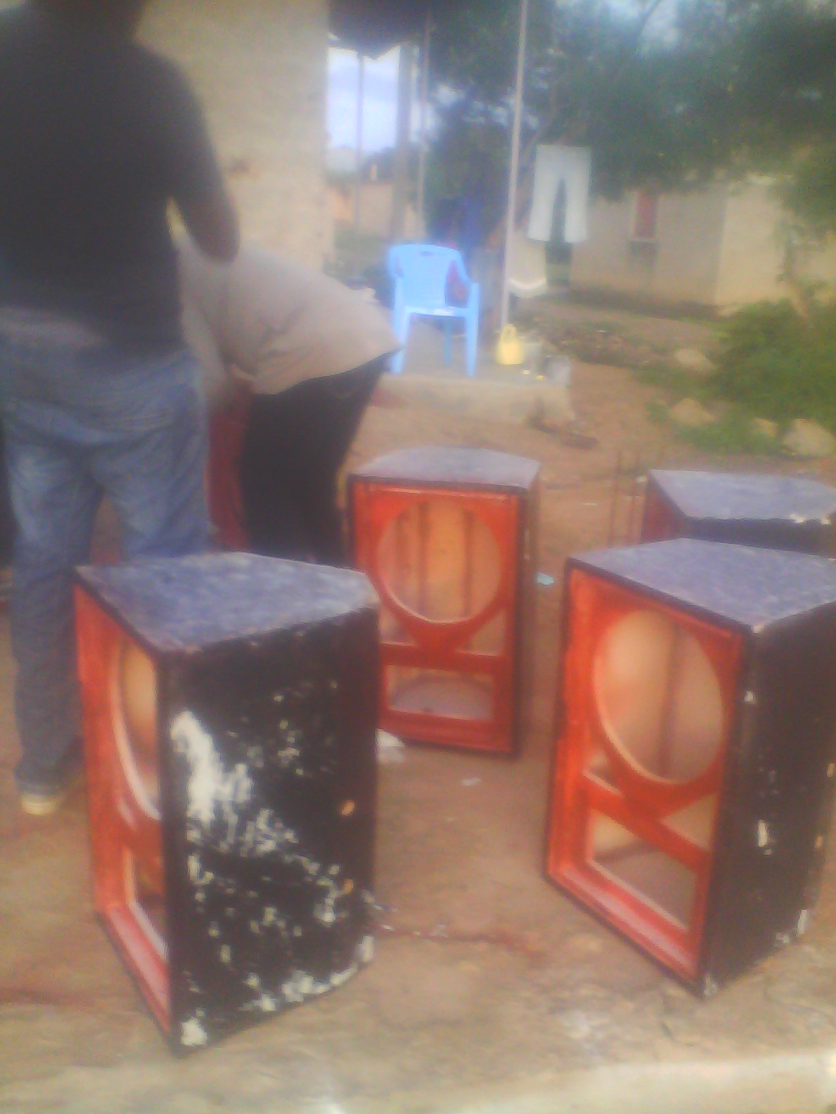

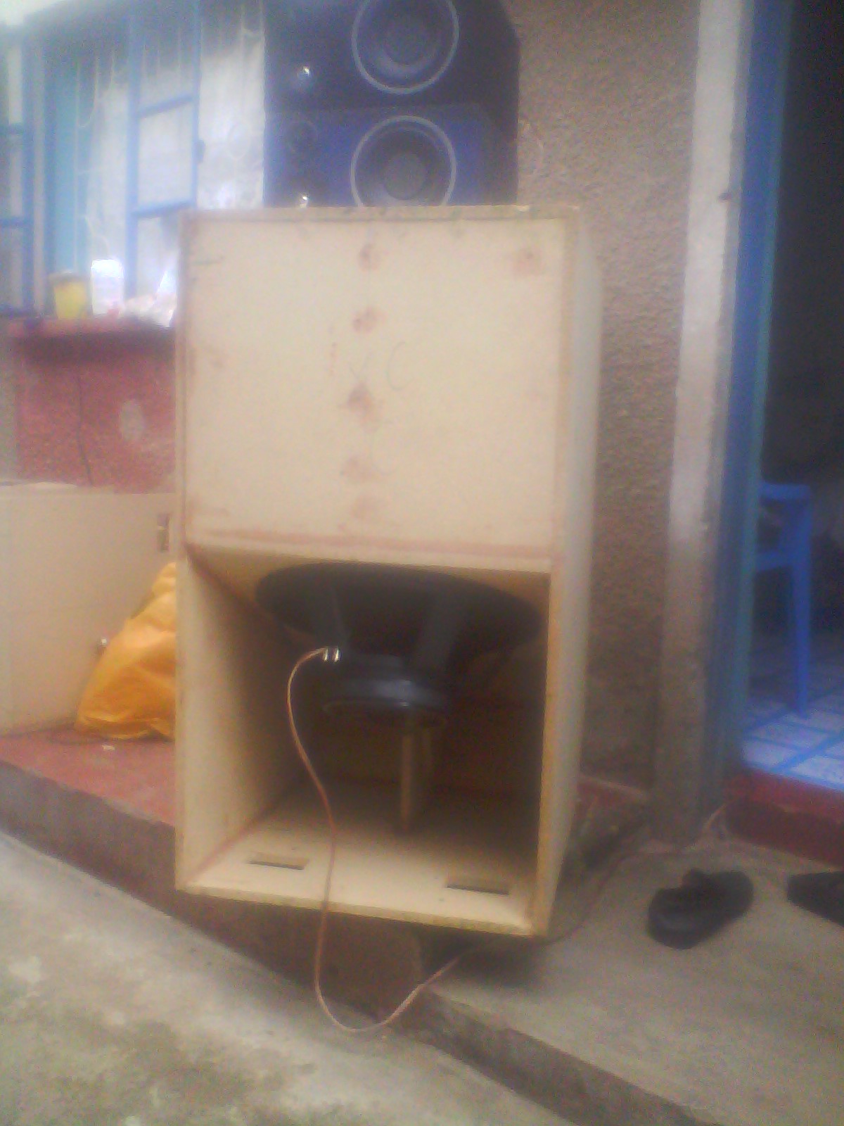

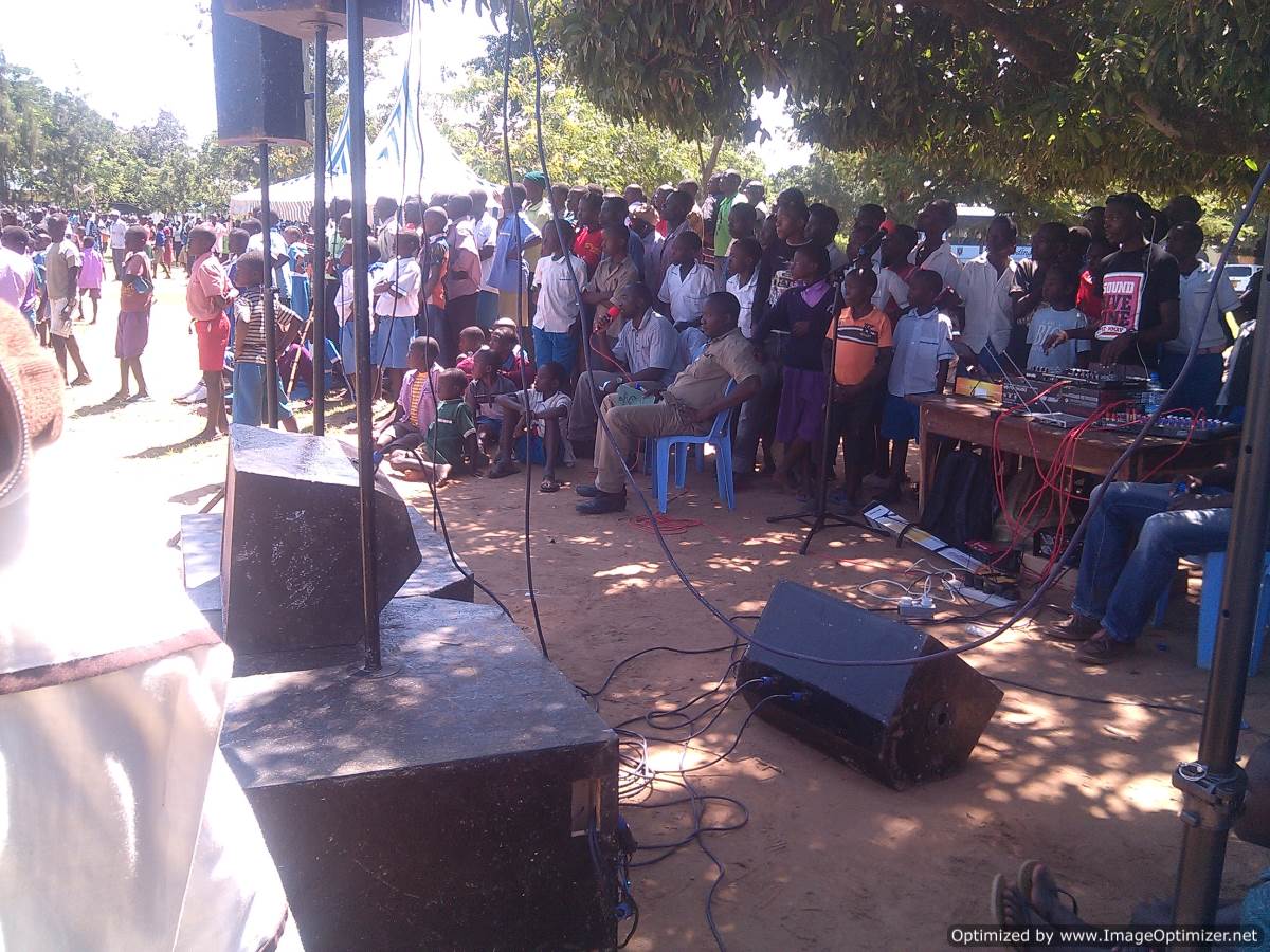

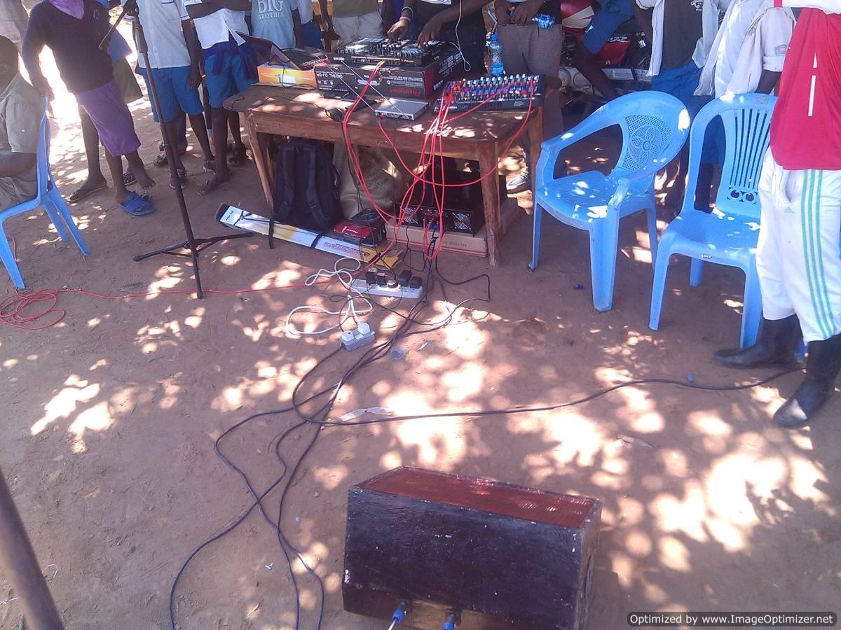

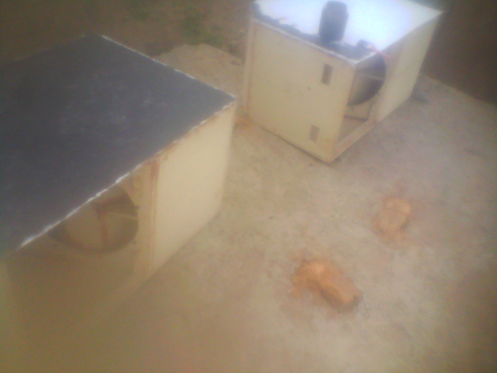

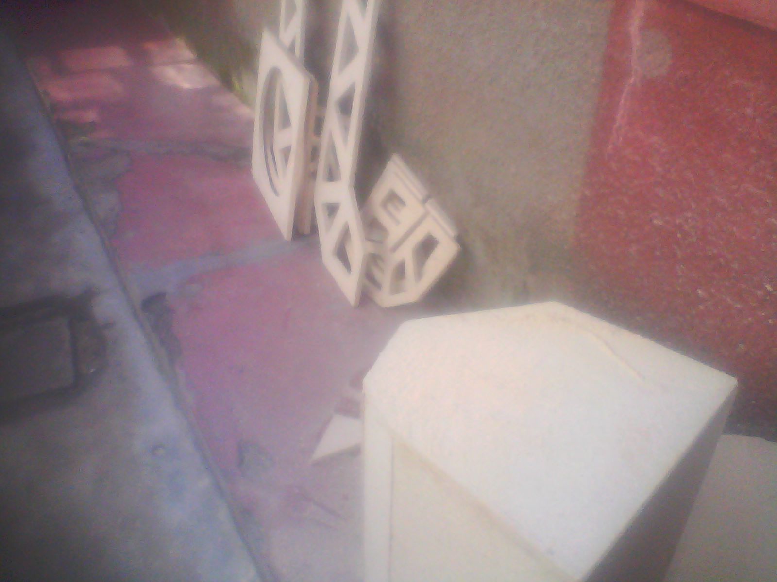

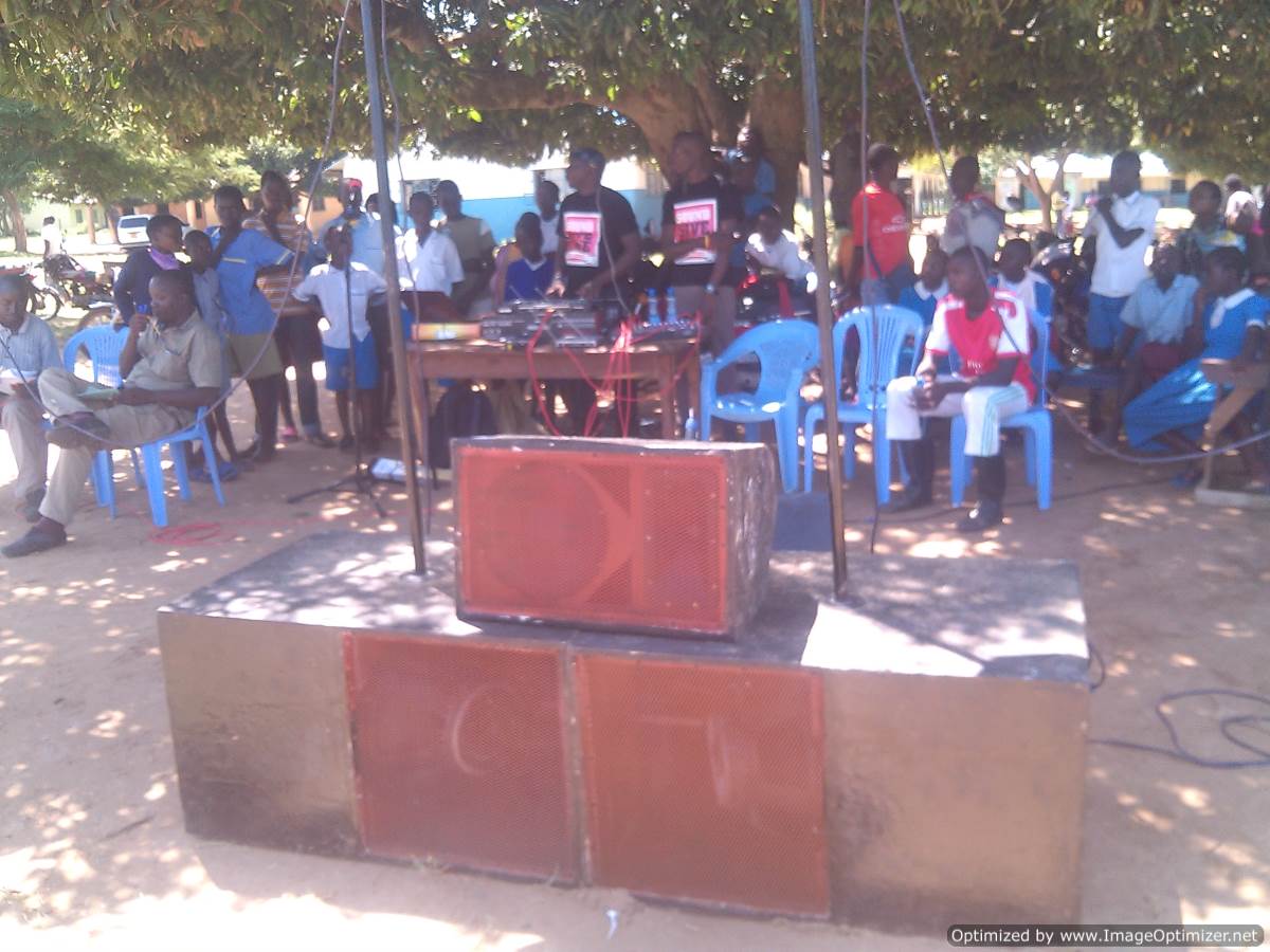

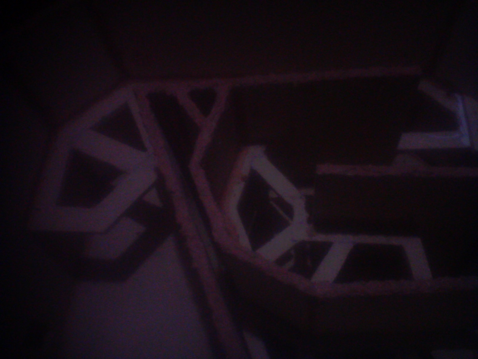

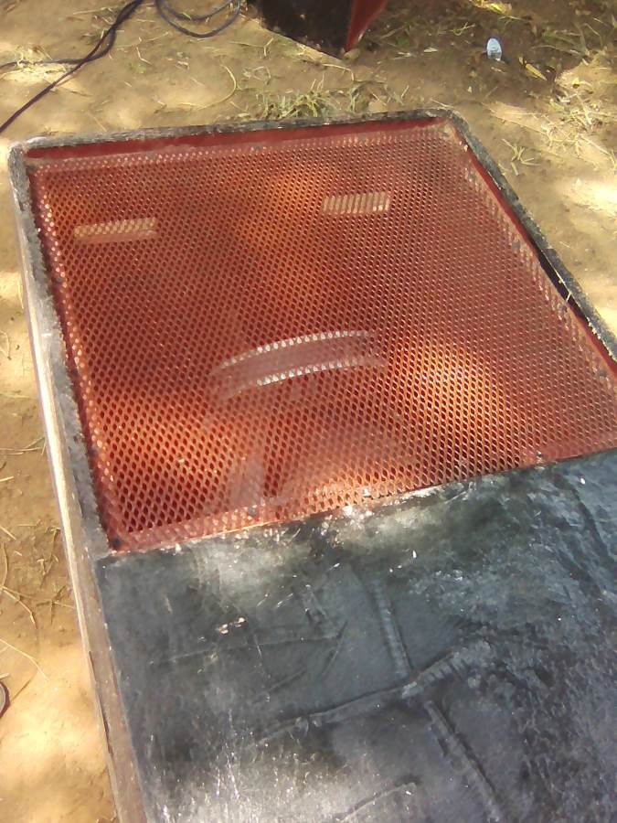

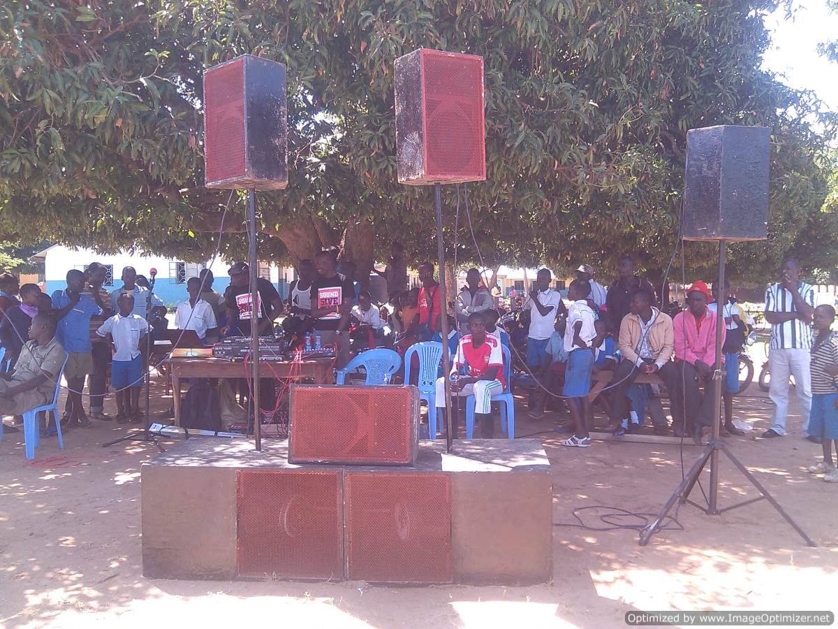

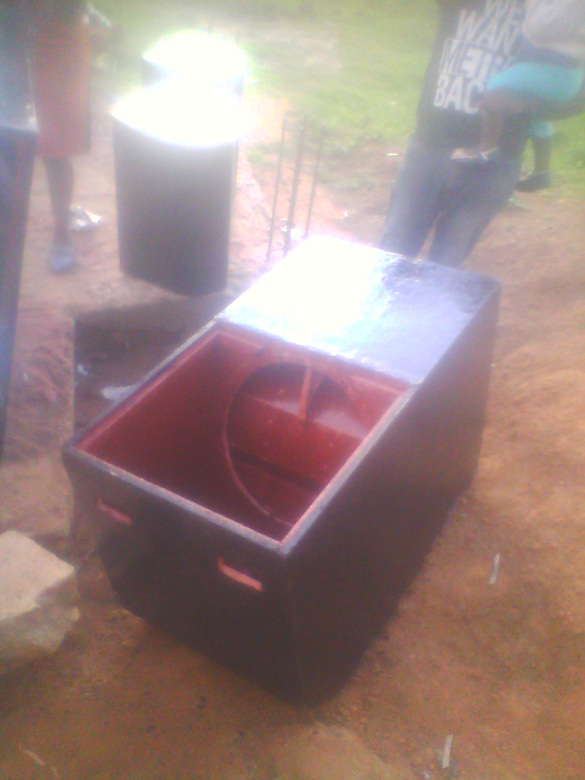

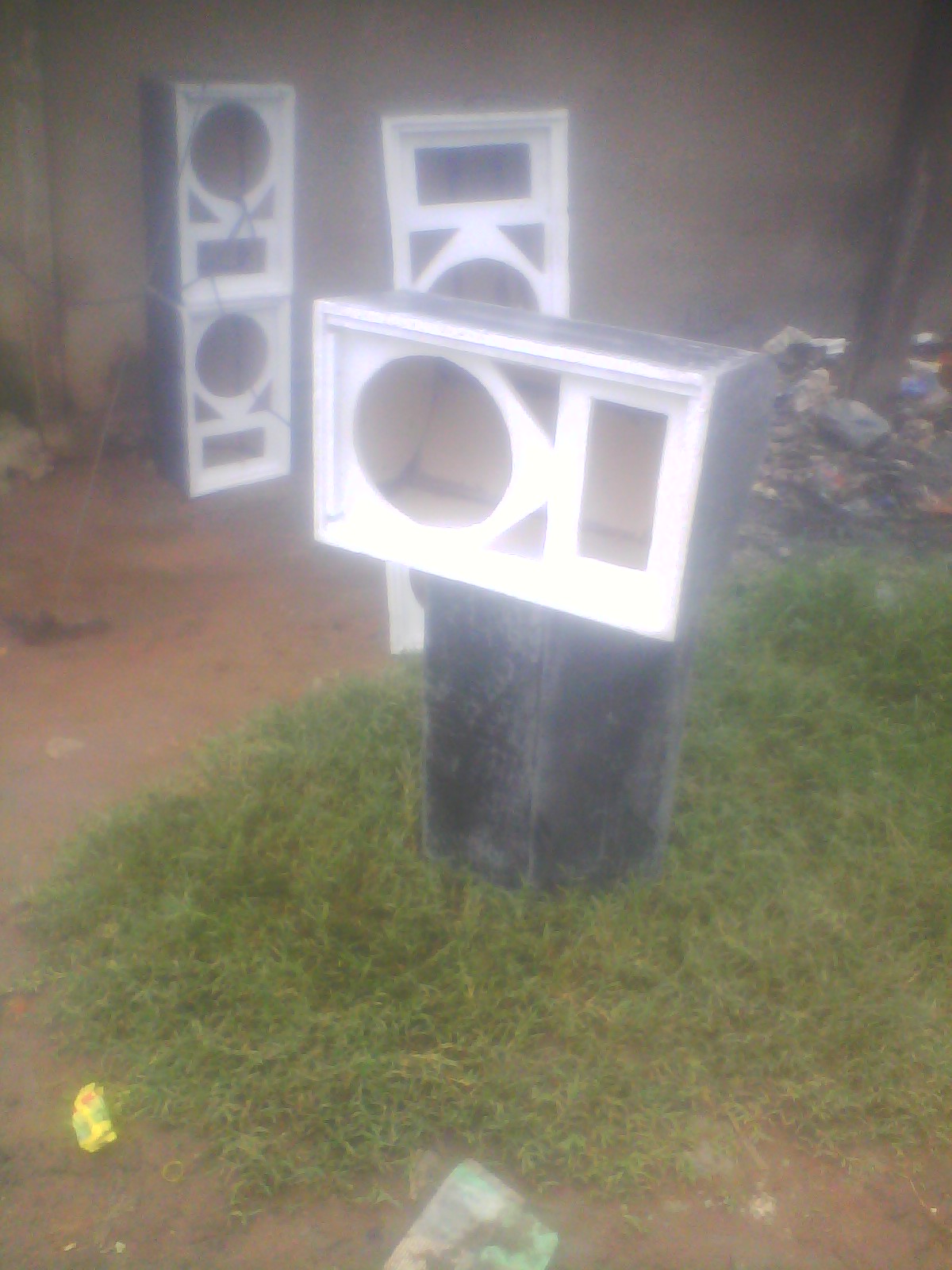

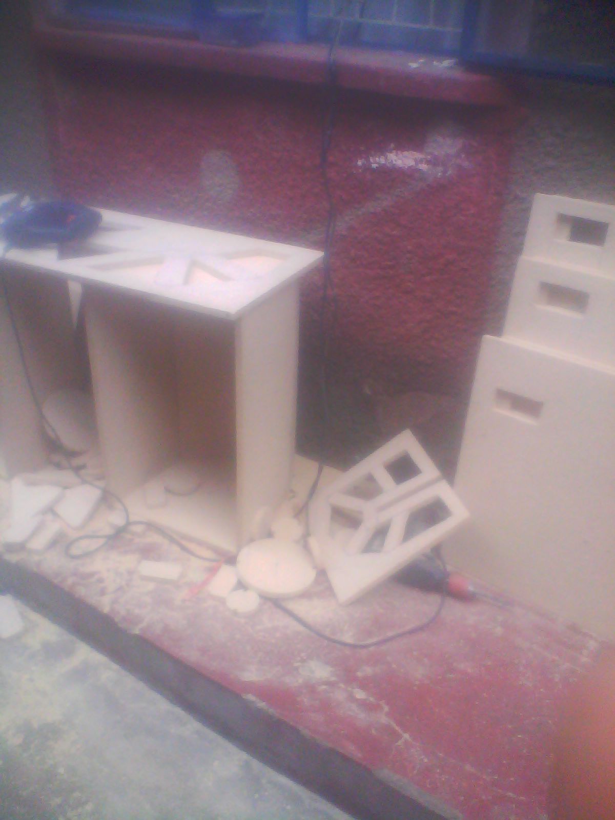

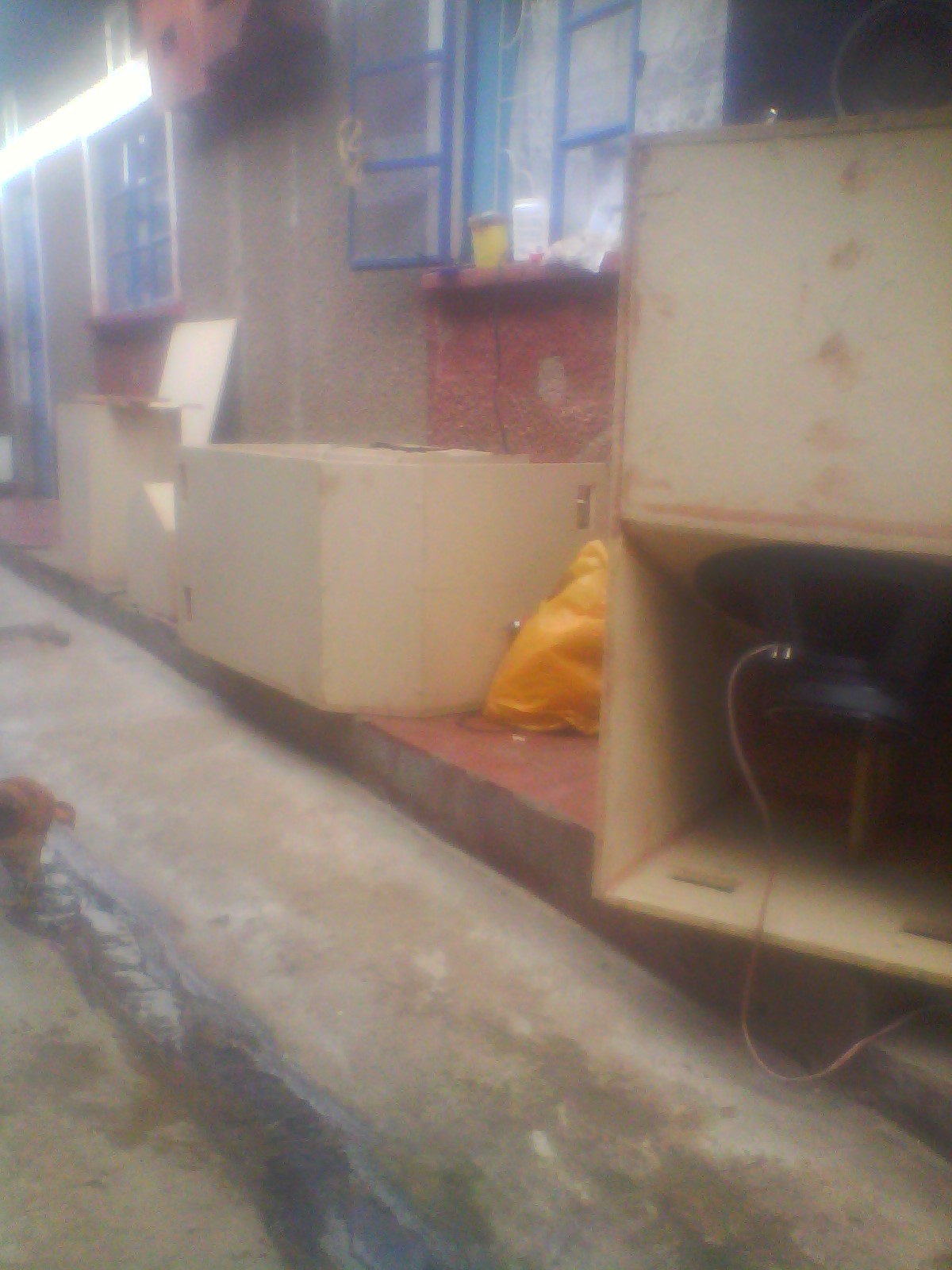

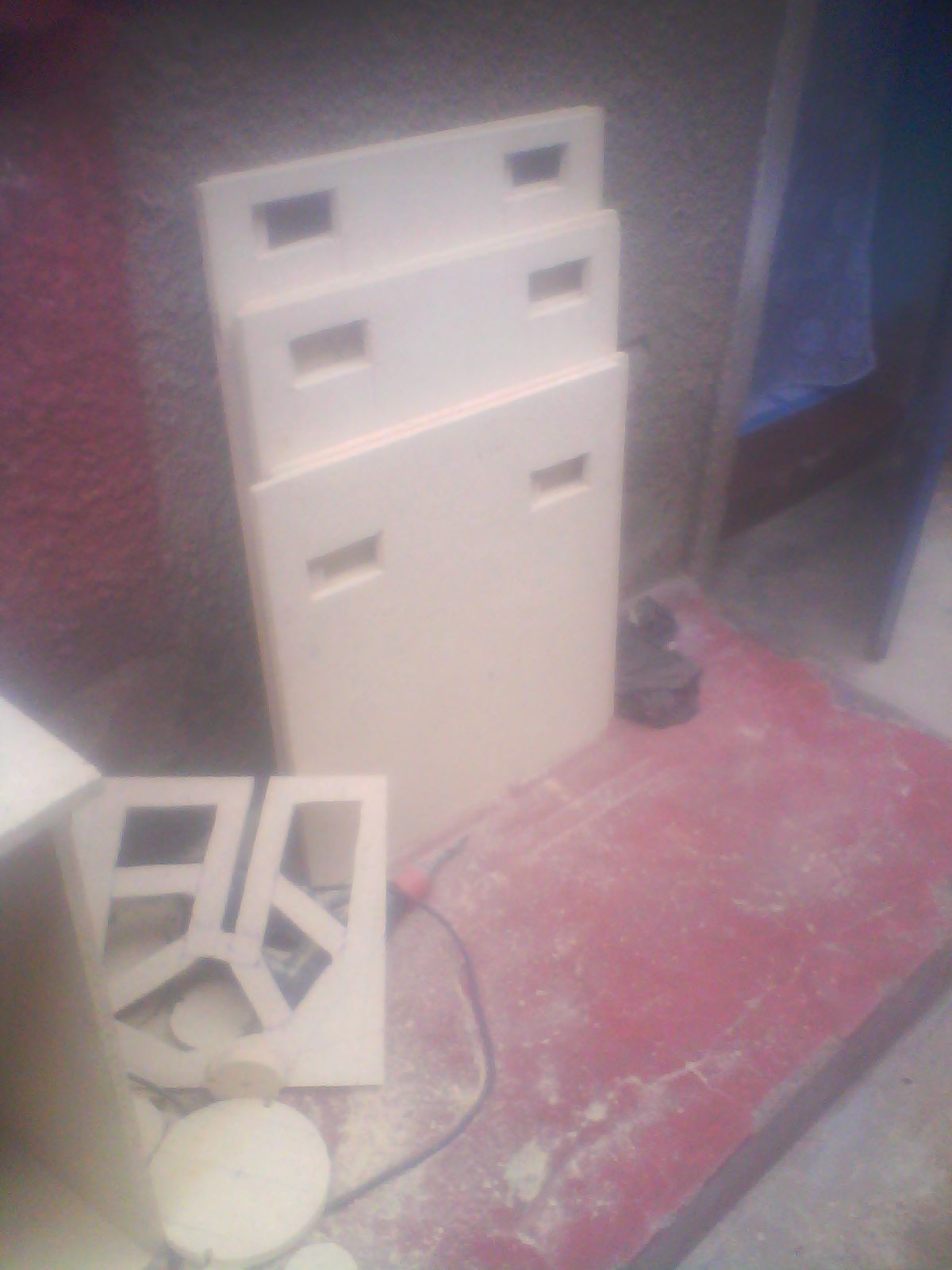

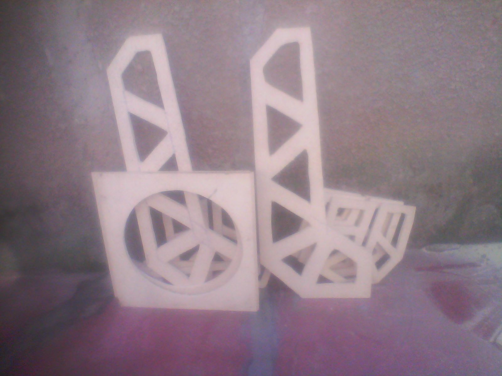

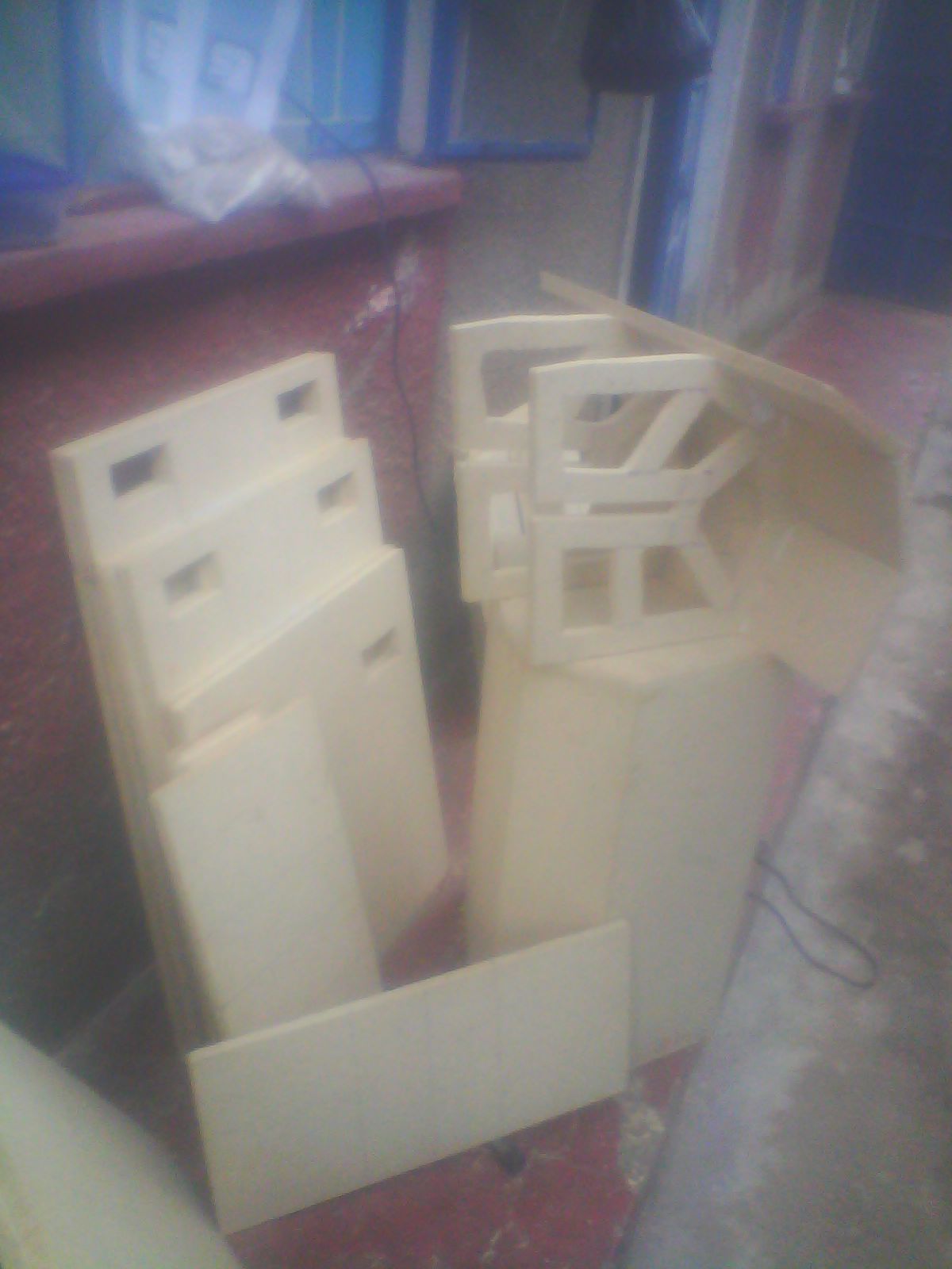

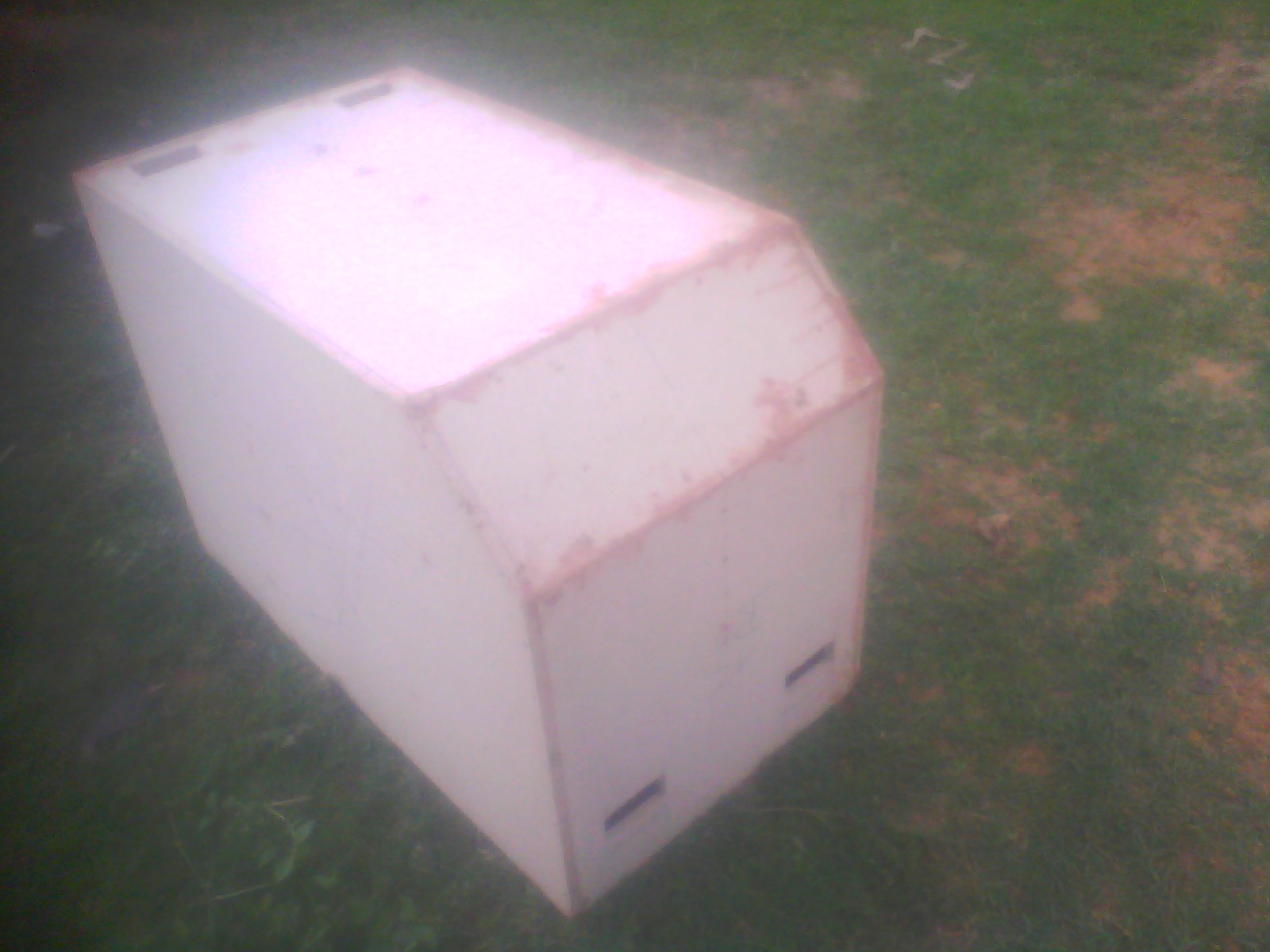

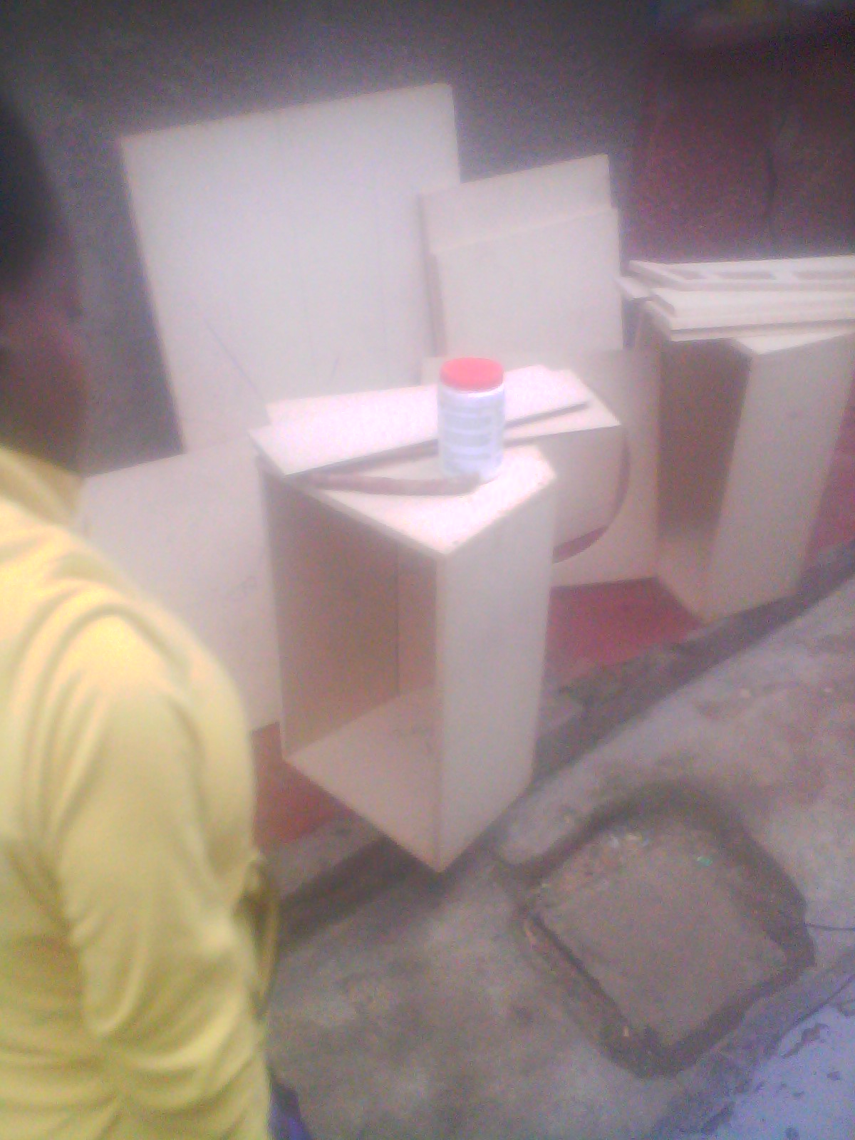

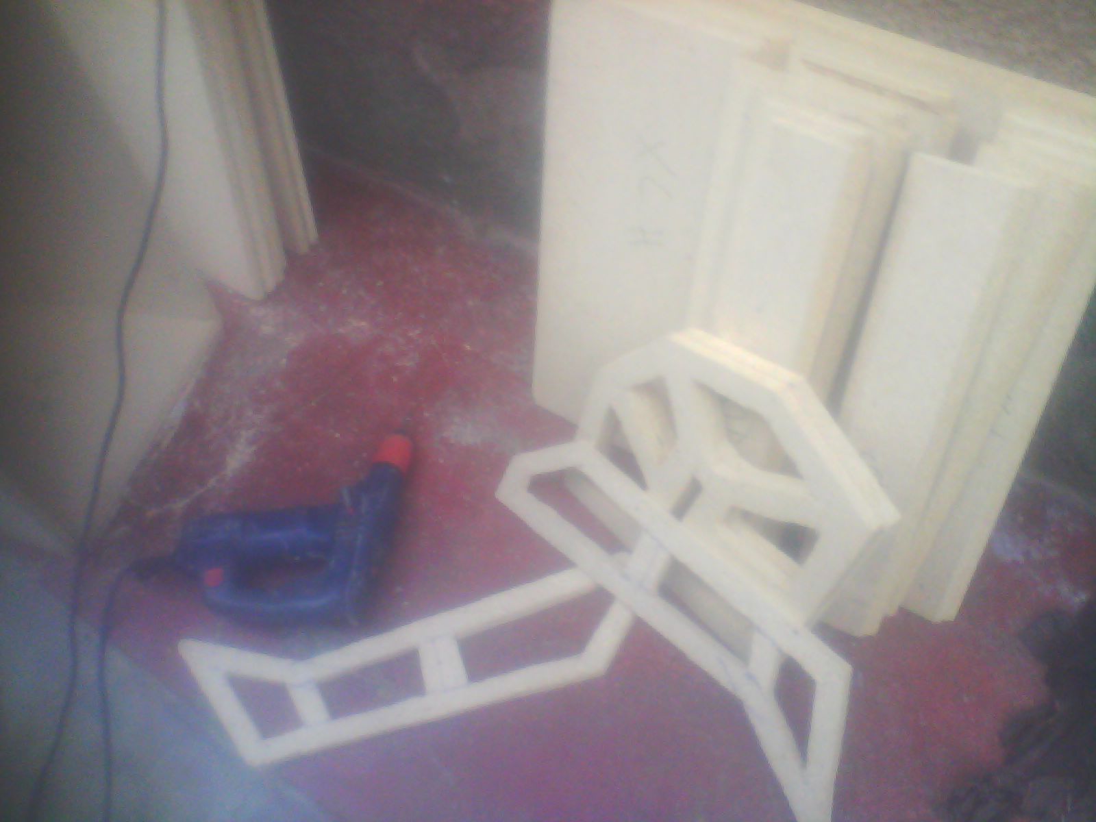

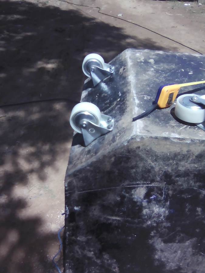

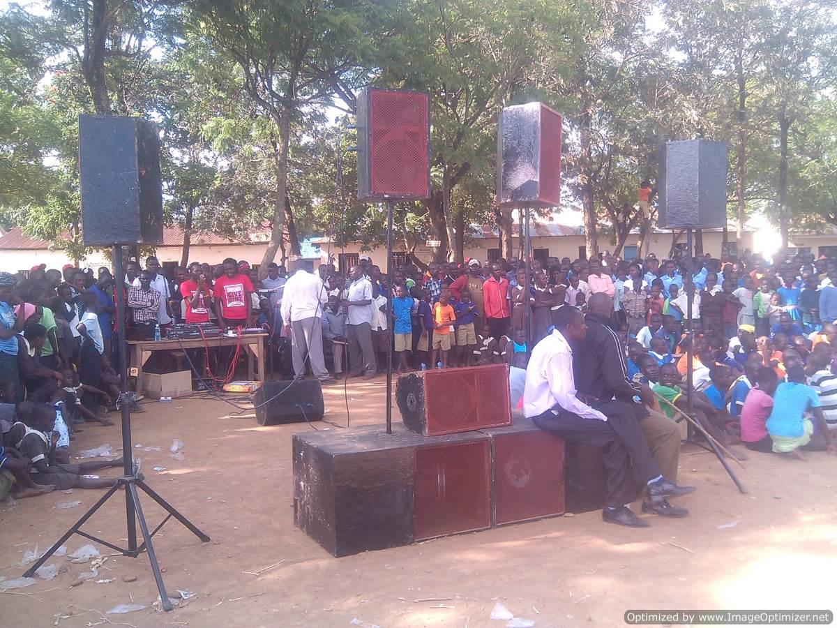

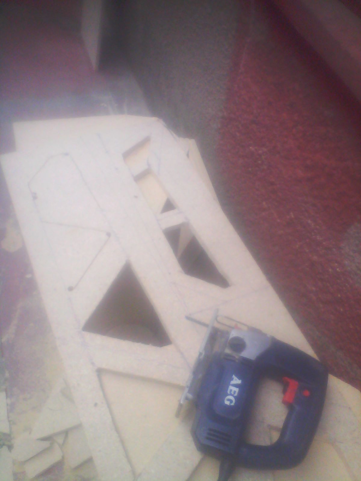

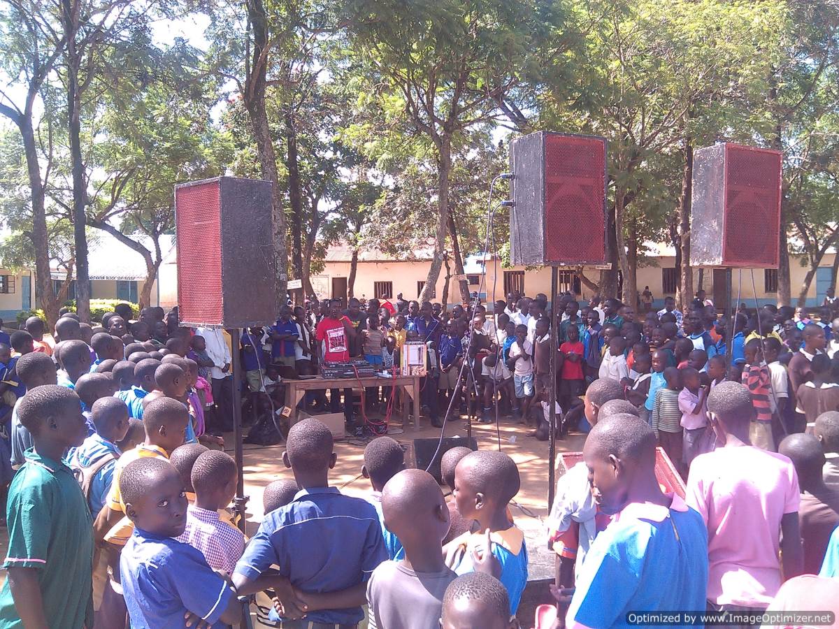

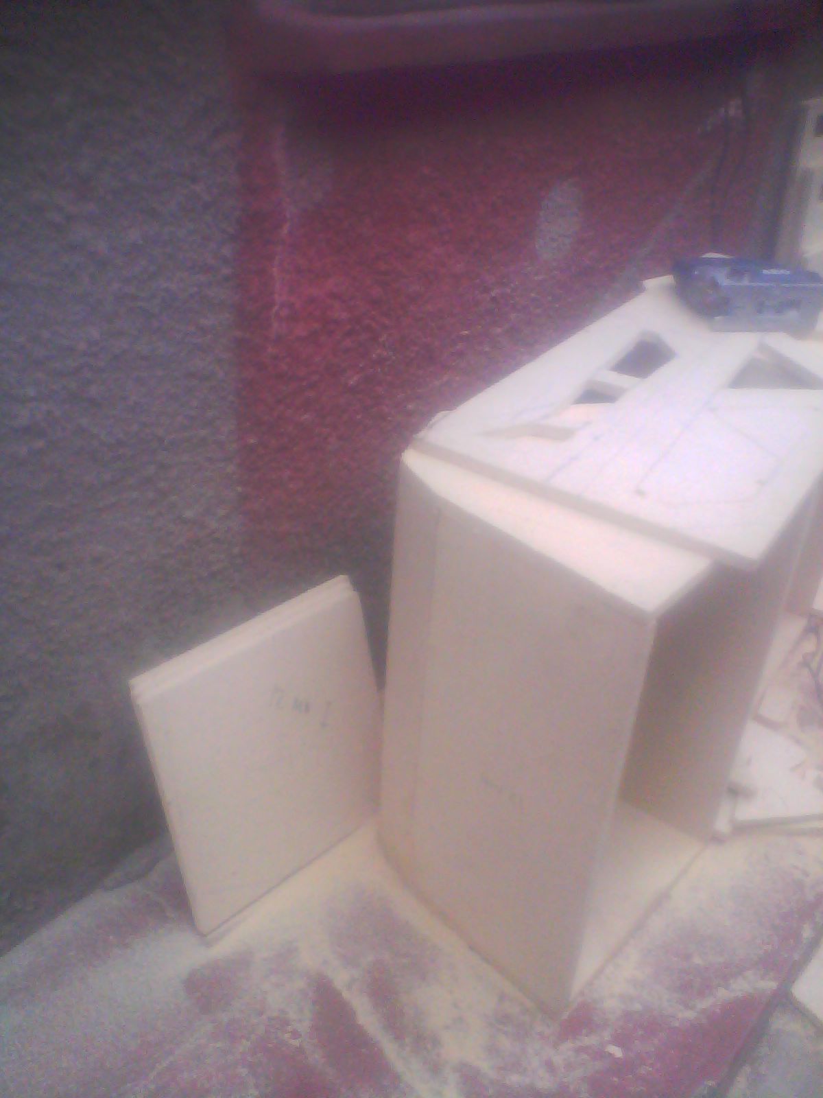

hi all my xs project with monitor mids . have fun all

at play

thanks guys it sounded excellent. I thank GOD for this amazing forum diyaudio and all its wonderful members . also mr gs 1 and xoc1 GOD bless you big time for this cool post. stewin
Hi Stewin, what driver did you use in your TH build?
Do you experience any issues with the bottom panel flexing to the point that the TH starts moving when you turn the bass up? I notice someone else drew attention to this and actually doubled-up on the bottom panel to stop this from happening.
I used new retone driver http://www.diyaudio.com/forums/subwoofers/190635-th-18-flat-35hz-xoc1s-design-168.html I did not have issues with the bottom vibration because I used 800watts . with high wattage I think bracing will be useful.
