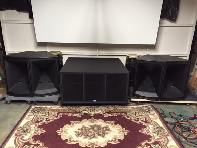

I would love to be able to build some synergy horns similar to the sm80 sh60 and even sh96ho. As much as I want to, buying them over here is pretty insane with exchange and delivery. A pair of sm80's will set me back around $10k.
Where there is a will there is a way. I constantly buy things from home(USA) and have them shipped to my residence.(Adelaide)
The pricing here is ridiculous. I was going to try and be a dealer for DSL and offer everything at the MSRP USD or below in the same number Aud. (So 6kusd would be 6kaud)The dealer here is just charging crazy numbers. So if I want something I will be going back home and then sending some packages my way. And they will only cost me "990 dollars."
Win win
But again those TH18's look awesome. I need to finish up my sub builds so I can move onto mains. 🙂
Win win
LOL.....I wont be a dealer anytime soon. If anything I would have been a wholesaler/distributor. That has come and past. And for now nothing is going to happen. For me I will look at building some simple 2way or 3 way mains with horned bass drivers. Then possibly next year I will look at going back home and purchasing a pair of SH64's or possibly SH96's. I wish you lived closer I would always lend them out. 🙂
