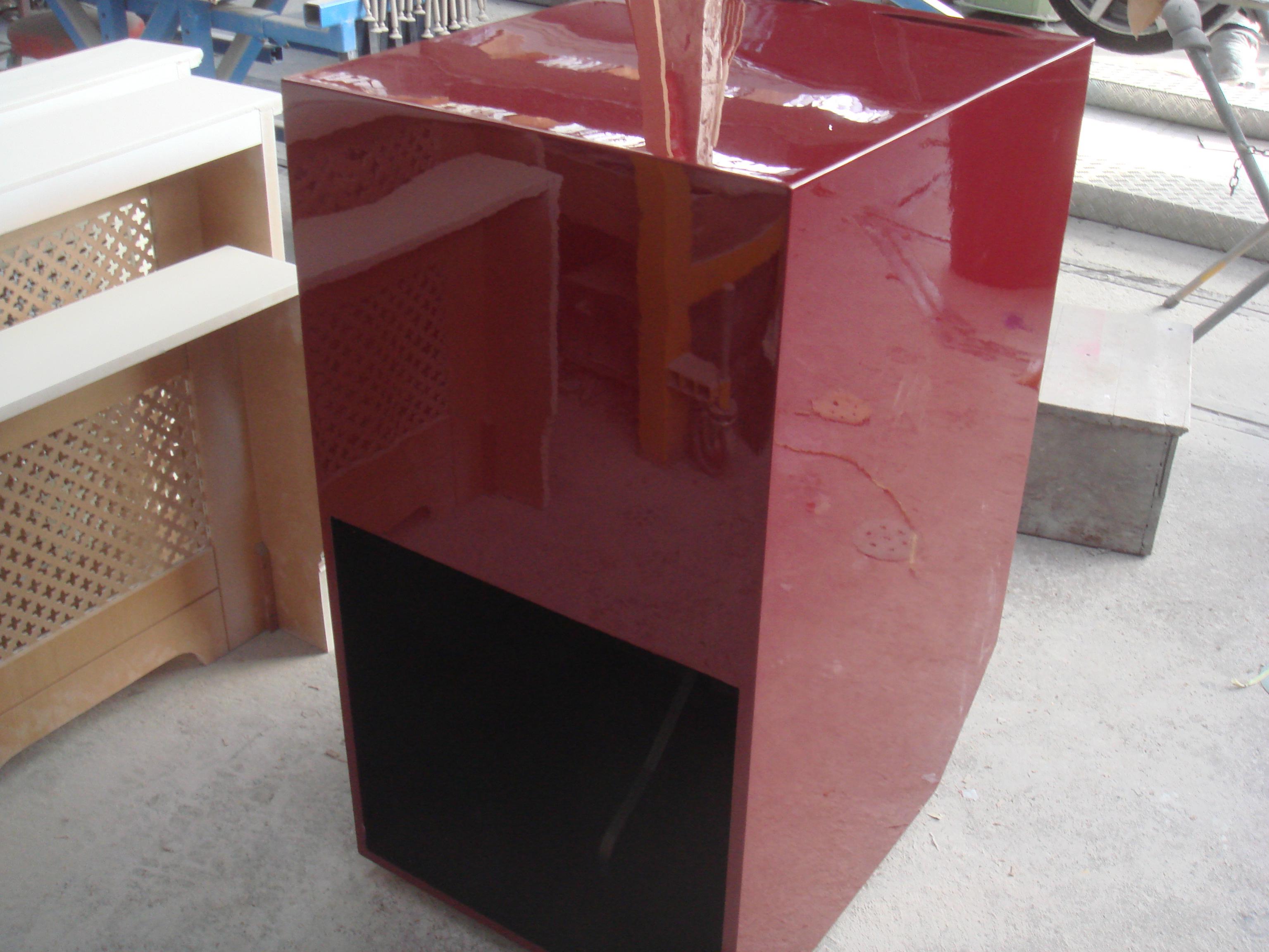

well that's kinda why I put wheels on the back and also will be making a cover for it with a kinda sponge lining.
That thing has a gorgeous car like paint job. Now that you have 4 wheels just add a motor and you have a very loud sports car. 🙂
Yeah my guy done a fantastic job. His name is Kiri this is his website if anyone wants any paint jobs done in London.
Kiri's Spray Shop | Homepage - Bespoke furniture/MDF painting & refinishing in London
Looks like the real deal in finishing.

Well let's hope it sounds as good as it looks. Got a wedding of 400 people in a couple weeks so that'll be the real test. It's powered by a crown 4002, bridged, so plenty of power!
400 people "in the dance" wold be too much powered by a crown xti 4k bridged (assuming 8 ohm), but for wedding level it should be acceptable)
I did 200 people with one 8 ohm 18nlw9601 loaded cab on a bridged xti4k. rocked it.
Beautiful paint job btw.
yes it's 8 ohms and as you say, weddings are quite different to other events so should be ok.

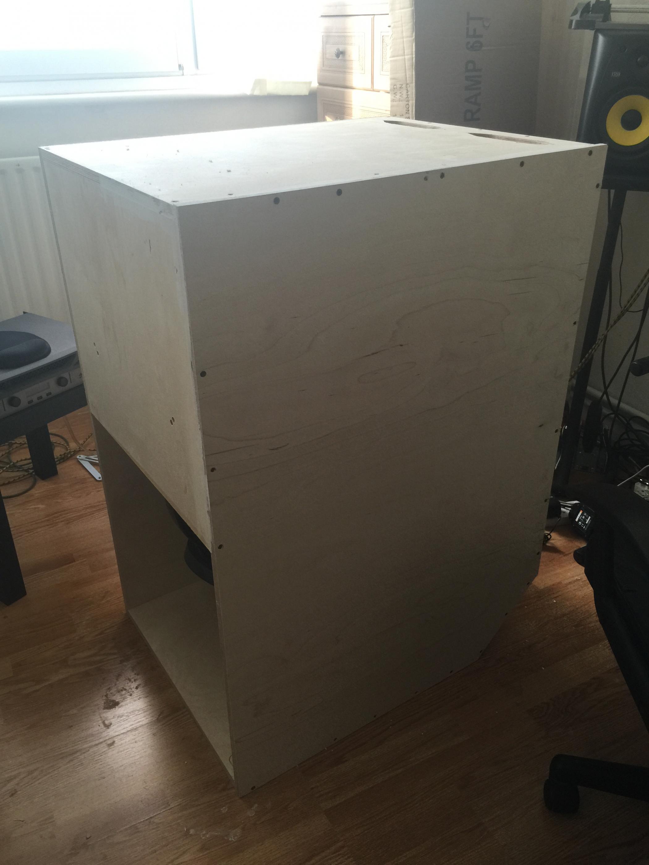

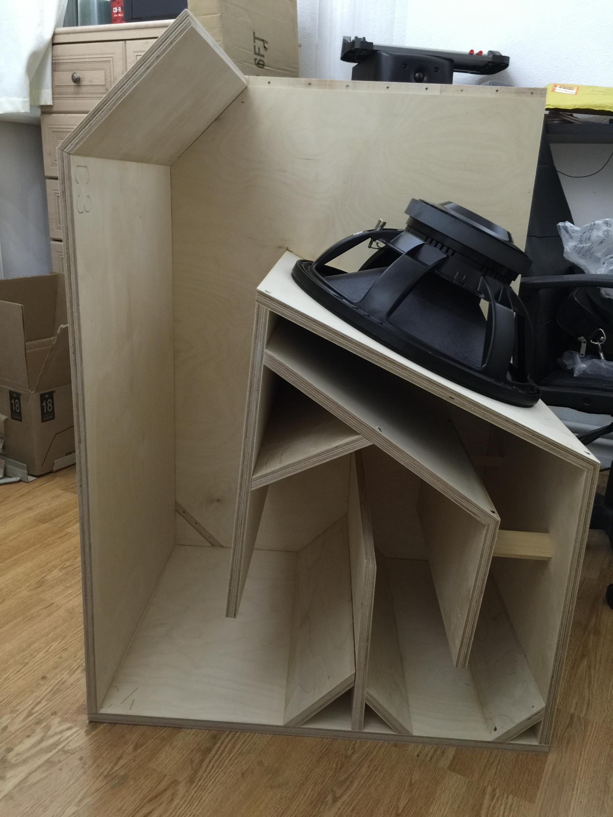

After a year of harassing my friend the cabinet maker my first two TH18's are now getting painted! I thought I would share some pictures of the build progress and then comment on how they sound when they are finished!
I should be finished painting them today, may get all the fittings on and then testing can start tomorrow. The throat is going to be painted orange like the Puregroove Danley's.
Also yes both the construction and wood are not ideal, unfortunately due to some deals gone wrong this is how things have ended up, the next two will be done differently. I have also put top hats in the center triangle section that isn't part of the horn for future 12" topbox's. At the moment they will be used with a pair of srx725.

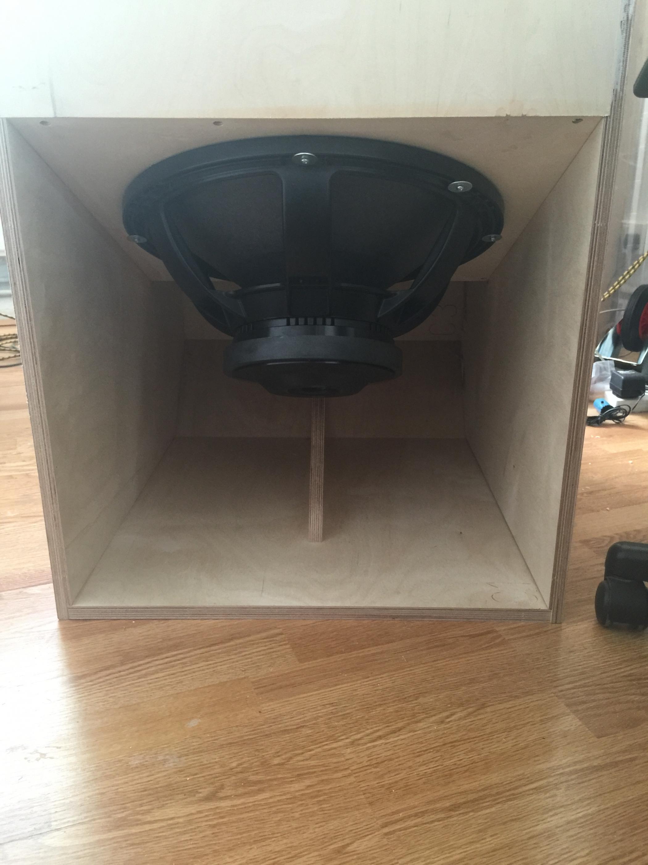

Using the 18-SW115 8ohm driver and a FP14000

Is the top hat a shallow one?
I only ask because I was looking at some nice metal ones and they definitely would have been too deep for that area.
And why are your components "not ideal?"
Everything looks good in the picture.
The wood is not very consistent, many ply or weatherproof. I would have opted for marine ply at the least but it was too late. The top hat is quite deep and can be as deep as you like because that section is not used for the sound path at all as is as deep as the box width. See the center triangle area in pic 1, this is used of course with the subs on their flat side. Also the hole can be seen below on the right side, the metal hat is not fitted in yet.
