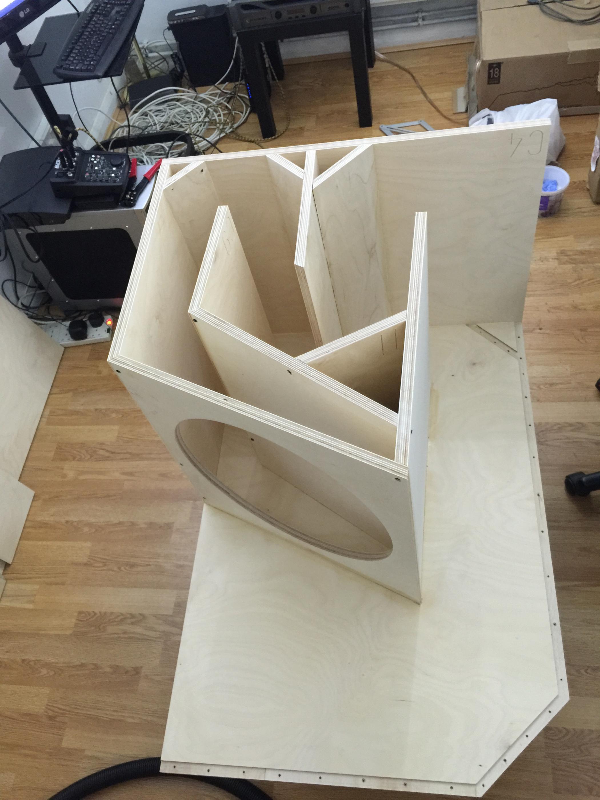

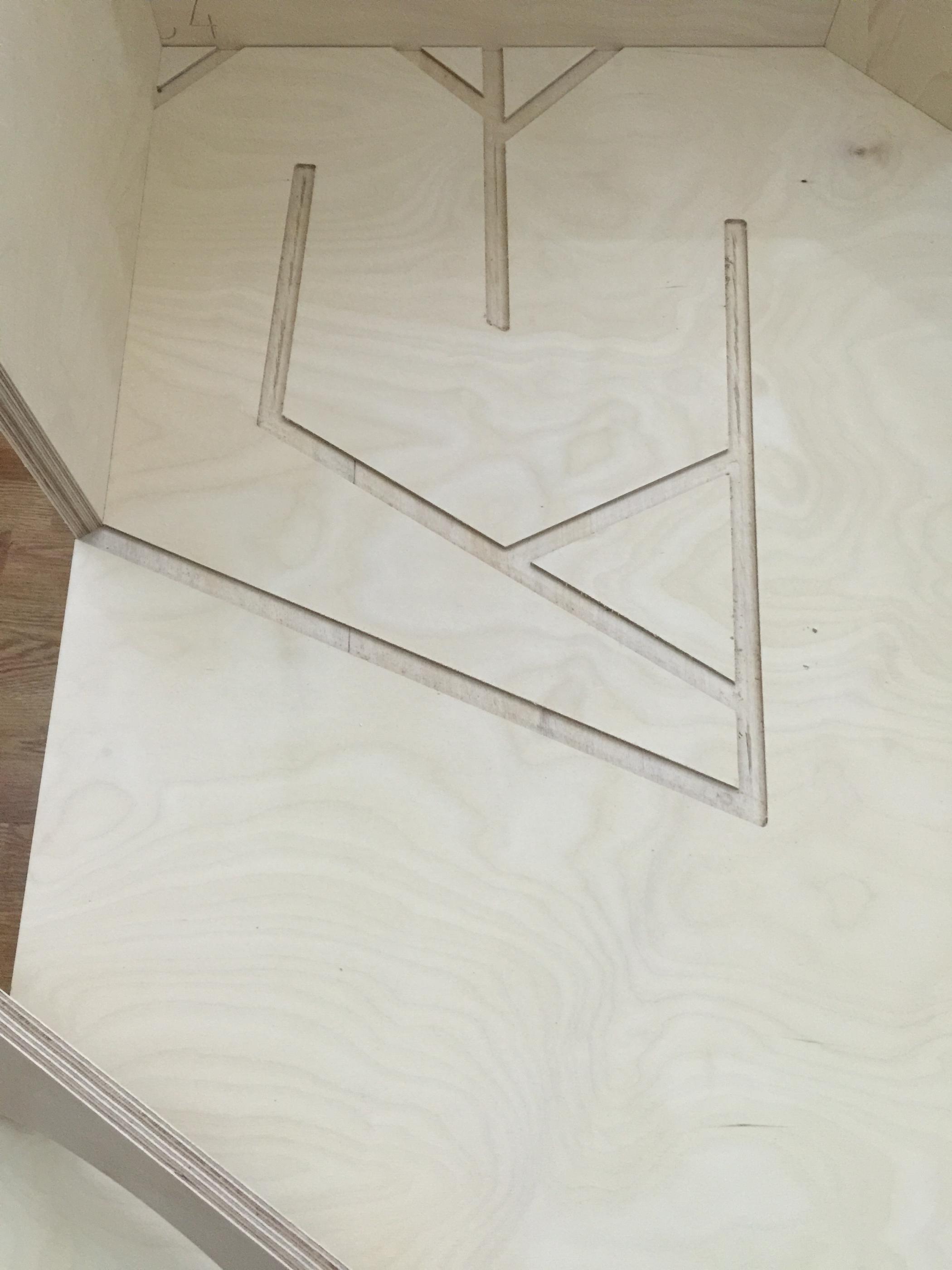

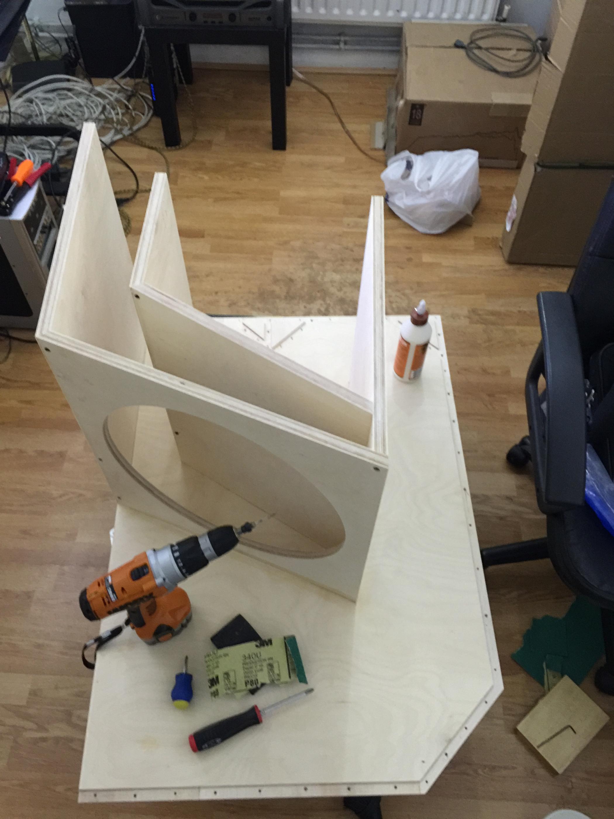

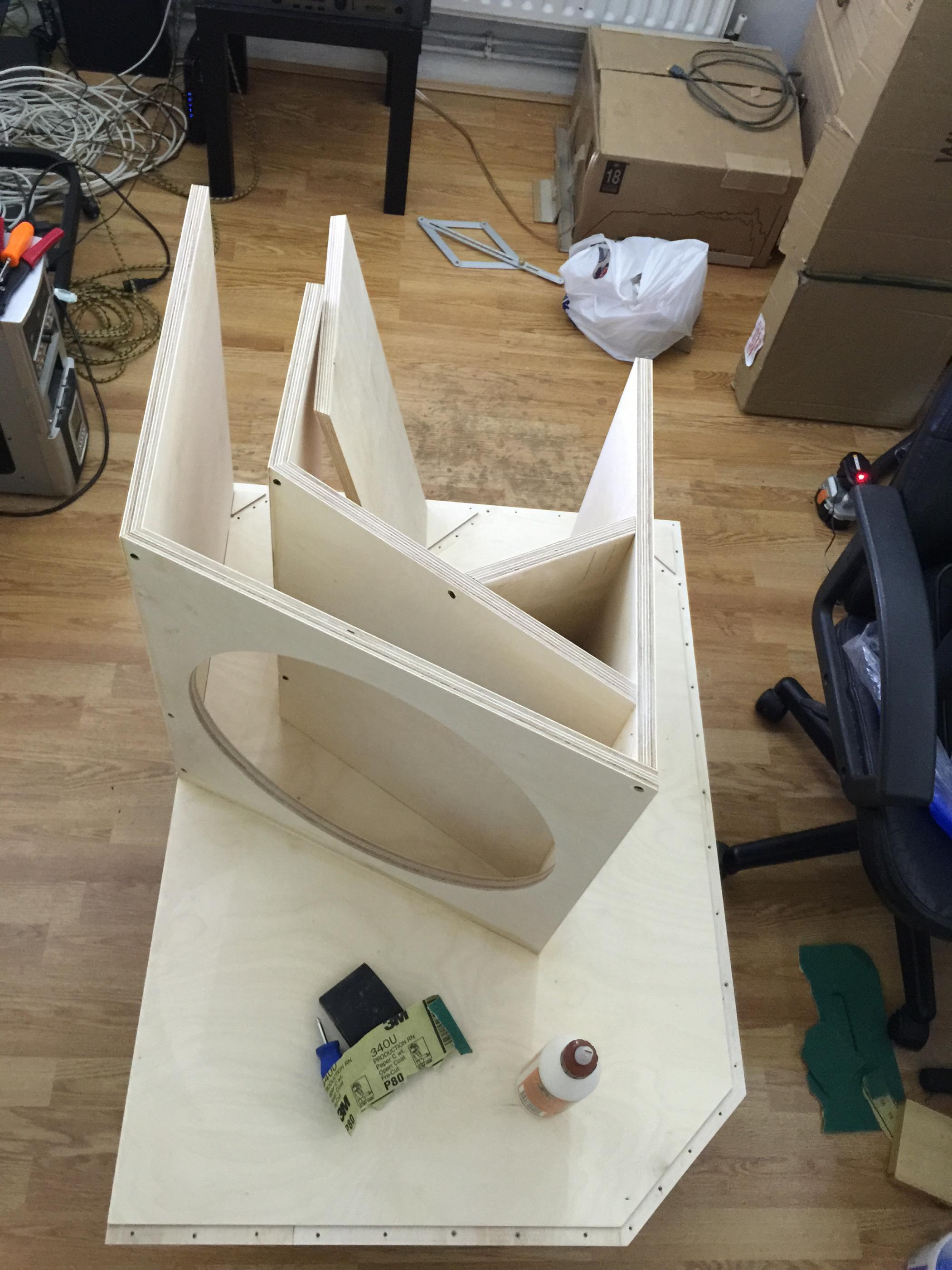

well I'm taking the plunge...I've got the wood cut and also the CNC guys cut grooves on both side parts which made things a million times easier to put this together. once it's together it'll be sanded and ready to for spray shop! looking forward to trying the beast.
CNC grooves is a nice implementation. Very clean! Thanks for sharing.
