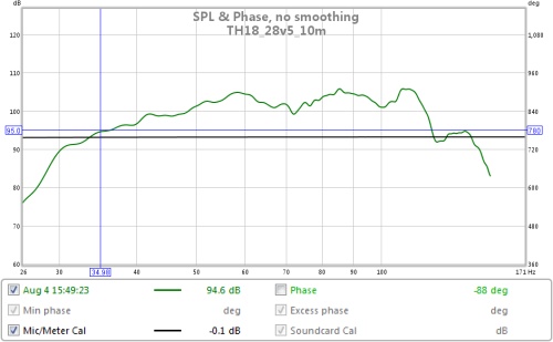

Did some measurements today and wanted to share. Comments are welcome.
I was hoping to get to use my new SPL meter as input to REW but the results were so inconsistent that I went back to DBX M2.
Using REW
Setup was 28.5v measured with voltmeter at 50hz
Distance 10 meters and approx. 70cm from the ground
Highpass 30hz/48db
Lowpass 110hz/48db
Interesting results.
Are you able to do an impedance curve measurement? That will quickly tell how close you got to the sim of the TH18, and if there are any glaring issues with the build. The FR curve looks pretty decent - can you repeat the measurement @ 2.83V, with the mic placed 1M from the subwoofer's mouth?

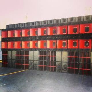

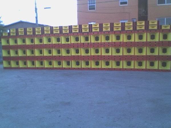

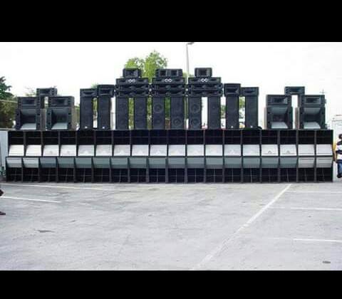

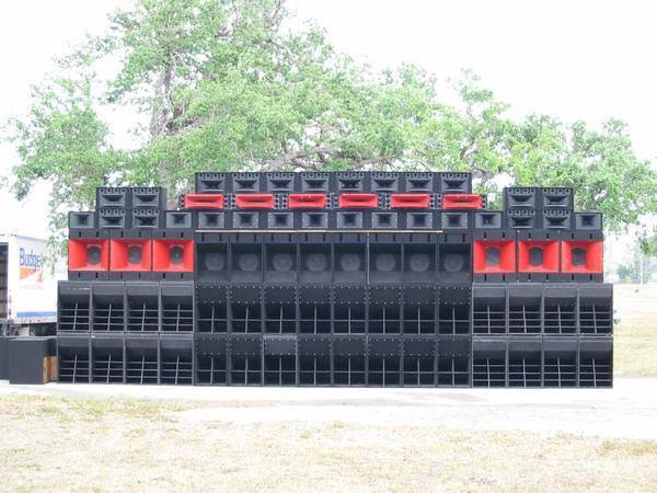

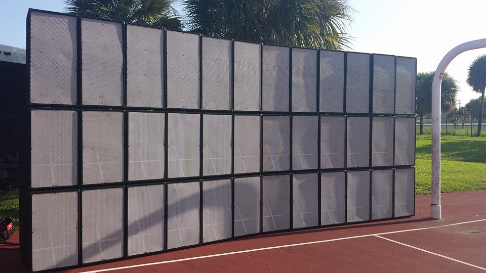

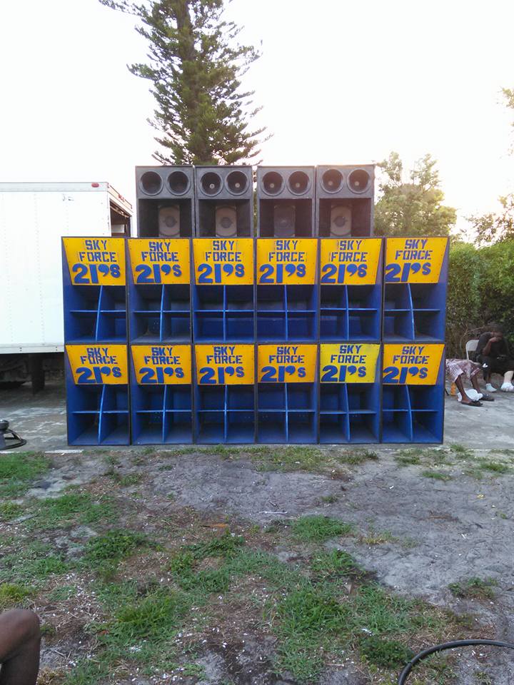

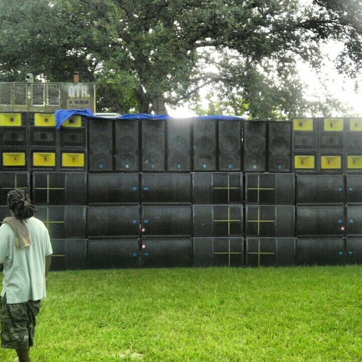

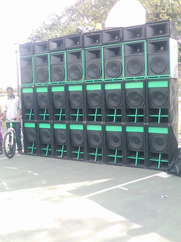

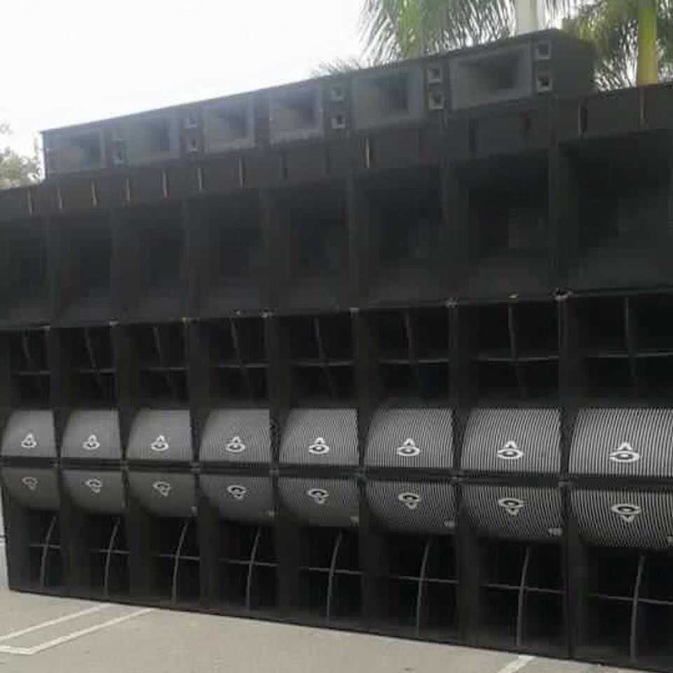

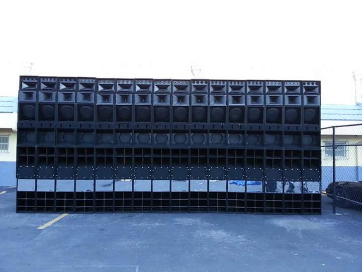

Miami street dj's pics
Here are the pics I promised of local Miami street dj's. You have everything from JBL 4560's to Yorkville LS1208's to 21" Vega style cabs.
That is definitely a bunch of piles of speakers. How does everything sound when stacked horizontally like that?
Most of those guys sound really good! You get some cancelation from how they stack the Vega's... but you can't stand in front of most of them. The guys with the all white are playing 24 hog scoops... they're playing Powersoft K'10's... They sound unbelievable! You definitely can't stand in front of those guys wall. I want something different... that's why I'm looking at the TH 18.
It's the lines of horns that kindof make me wonder how that actually works. Lots of midtops spread out like that. Dub sound systems are kindof the same way with their stacks.
Like isn't that a cancellation nightmare? Or are there just so many comb filters that it ends up starting to flatten out again?
