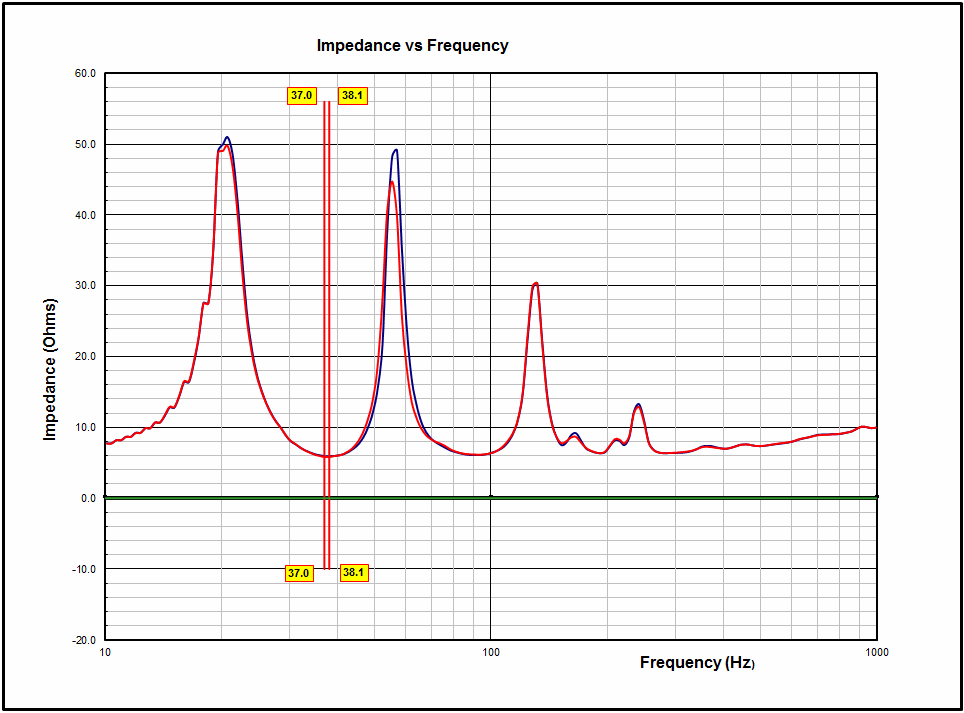

I performed impedance measurements on my POC3 with it raised in the air, on the floor, against a wall and in a corner.

If you agree that changing the loading on one TH as I have done is the equivalent of doubling or quadrupling the number of THs (which is an assumption made many times in simulating these builds in HornResp), and that changes in the impedance curve imply changes in the frequency response, then if my measurements show changes in the impedance curve when I change the loading on a TH, that means that the frequency response will also change when the loading is changed, or when the number of stacked THs is changed.

Exactly, and one can make deductions from those measurements, if you understand what they mean. In this case, if the measured impedance curve of the DUT changes, then the frequency response of the DUT MUST ALSO CHANGE. You can't have one without the other.
So the deduction that can be made from my test is either this means that the frequency response WILL change if multiple THs are stacked, or the assumption that you can change the simulation to reflect the output of multiple THs by changing the loading from 2PI to 1PI or 0.5PI is also incorrect. As this is a common assumption made when using HornResp to model horns in general, what would be the basis to conclude that it is somehow incorrect for THs?
The unanswered question here is if the changes to the impedance curve reflect the magnitude of the changes suggested by the corresponding HornResp sim when the loading is changed. That's something I haven't checked yet.

I'm going to repeat the measurements tomorrow to confirm (SWMBO will be out, so I won't be disturbing anyone with the DAT's sine sweeps), but I think the greatest change took place when I moved the TH from the table (where there was no surface nearby to the TH's mouth) to the floor, and then only minor changes to Fb (and a bit more to the peak in the passband) moving it from the floor to against a side wall.
This is probably correct.
Here's something to look at:
1. Blue - POC3 TH on a table, ~3 feet off the ground
2. Red - POC3 TH on the floor, center of the room
Fb dropped by 3% (based on the raw data, it's not that visible in the graph), and there's a noticeable drop in the impedance peak in the middle of the passband.
