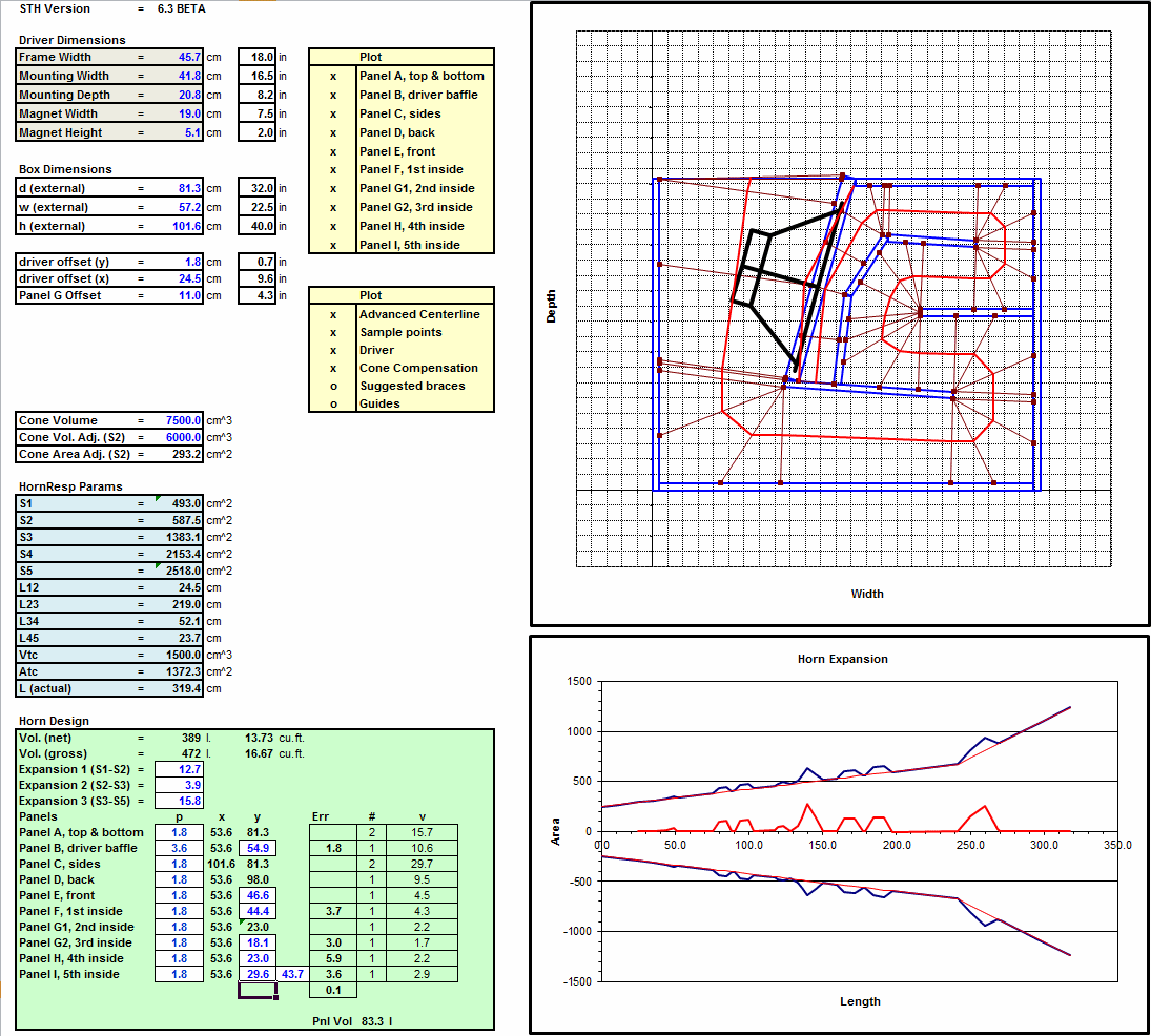

You might want to recheck that sim. You've got S1=S2, and Conical rather than Parabolic expansion.
I used the TH18 sim from here - The Subwoofer DIY Page v1.1 - Projects : DIYAUdio Projects - The TH18
... which in turn I extracted from a post much earlier in this thread.
Hi Brian,
should have taken more time - I quickly took my TH18 sim lying in my folder, entered loong time ago and when andy wrote "version 1", I thought this is the one. I guess this was an earlier version from here:
http://www.diyaudio.com/forums/subwoofers/178029-c-e-x-pa-flat-30-ft30-pa-th-awesomeness.html
Thanx for pointing me to the version which seems to be closer to Andys build.

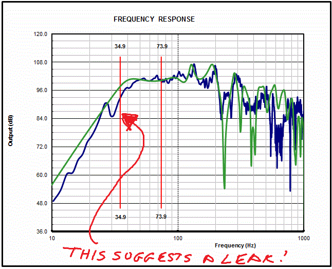

Thank you very much for all the comments and the interpretation of the results of the measurement.
1. It is going to be difficult to find out if there are any leaks. I have made sure the the cut in the baffle is exactly as per B&C tecnical drawing so that the the driver sits on the gasket material and is evenly fastened with bolts washers and nuts. What else can you do in that department?
Could it be due to the added cone correction?

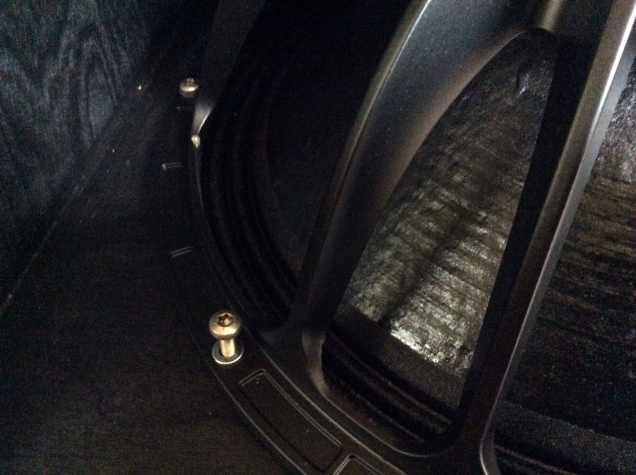

I have a steel grill with 48% airflow and my a/b testing did not show any difference in output. Could that make a difference that I didn't notice?
I also wondered if the grill could have influence at higher output, which my test is not accounting for.
I have internal bracing but no bracing in the mouth except for the grill. Could that make a difference? I have heard people saying that the sub could 'walk' on high power, but I never experienced that.

I'll take this in two parts...
It's not that difficult. You'll need to take the FR test a low lower though, like starting around 10 Hz, 20 Hz minimum. If there's a leak, it will show up as a noticeable "blip" in the FR curve before reaching the passband of the TH. I've included an example FR that shows the impact of a pretty bad leak around the driver.
The B&C cutout spec is in reference to the driver being mounted through the baffle, not on top of it. Yeah, I made the same "mistake" too, LOL. It's not bad if you're capable of cutting out perfect circles and the driver is mounted dead-center. Otherwise I believe that there's only 0.5mm to play with, which provides a good opportunity for the gasket to slightly overlap the baffle, particularly when compressed down on it, and one of the cutouts in the gasket for the screws being exposed and causing a leak. Making the driver cutout a few mm smaller in diameter is a great way to avoid this issue entirely. And it will make no difference to the TH's output otherwise.
No. Cone correction only has adverse effects if there's too much of it. Your build does not seem to suffer from that.
It's possible. The only way to make sure is to repeat the impedance test, this time with the grill off. Any difference in the impedance curve will be reflected in a difference in the frequency response, and it's usually a lot easier to measure the impedance curve .

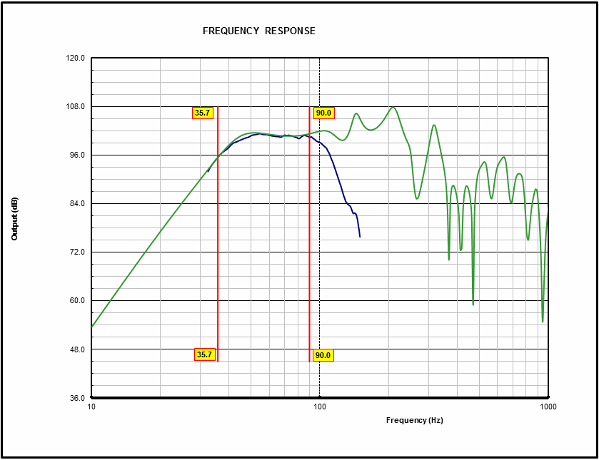

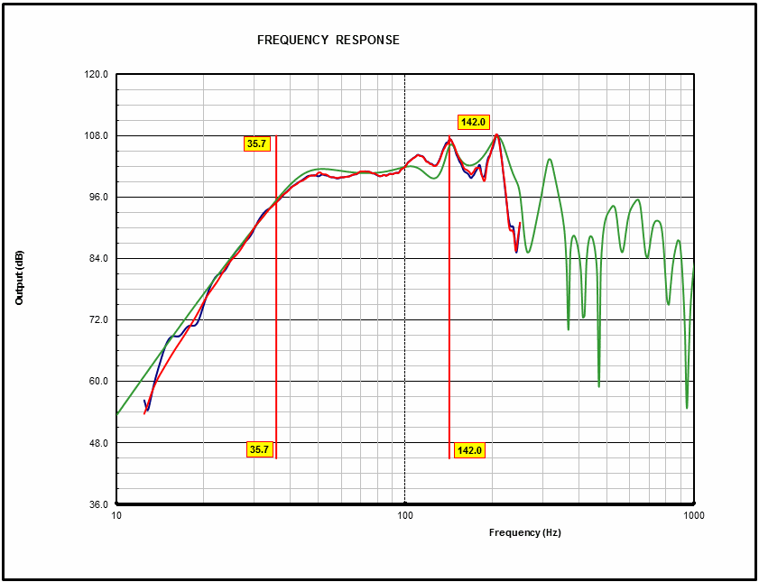

How do the measured results compare to the sim?
Like so:
Not bad..
That dip below 30 Hz looks like an active filter effect.
The smoother passband and the loss around 80 Hz could be due to slightly too much cone compensation, based on the results of some tests I did with POC3.
The layout looks very similar to my POC4.1 (I don't include the corner reflectors, as I don't believe that they're important in a bass-horn, and can in fact push UP Fb). I'm still fine-tuning the layout spreadsheet for it - it's a true 32 Hz horn that has the same front dimensions as the TH18, but its depth is extended from 28" to 32". That extra 3 Hz is expensive....
It's interesting that the passband is mostly below 100 dB though. Is that a 2.83V sim or a 1W sim?

Hmm... that new measurement looks like it was taken under entirely different conditions (maybe the TH was up against a wall or something?). It also looks like there was still some low-pass filtering involved.
See the comparison with the HornResp model attached.

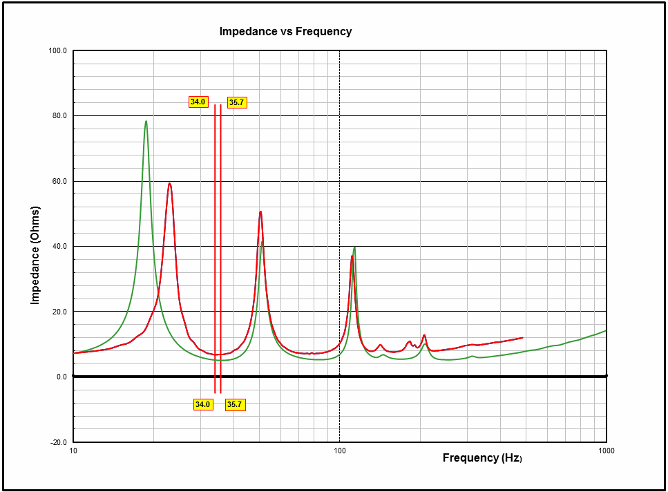

Based on these new measurements, here's what the impedance response looks like (red, blue) compared to the sim (green).
There's virtually no difference in measurement between the grill being on or off, which suggests it basically has no noticeable impact on performance. But we knew that was going to be the result anyway . The lowest impedance did shift a bit, but the changes at this point are so small that they could be considered within the margin of error.
The lowest peak is noticeably higher than the one from the sim, but I've seen this in other impedance measurements as well.
The concerning thing here though is that the minima points are noticeably higher than the sim. Perhaps the driver's actual Re is higher than the published Re? If it's the same (easy to check), then I'd start looking for signs of a poor connection, maybe at the amp or at the speaker terminals.
...and here's how the measured frequency response (from these latest measurements) compares to the sim. I must admit that I was stumped a bit with this one - either there is a general 3dB loss across the passband, or there's a 3dB gain in response just above 100 Hz. I assumed the latter in order to line up the graphs. The results suggest to me that there are no leaks to worry about.
