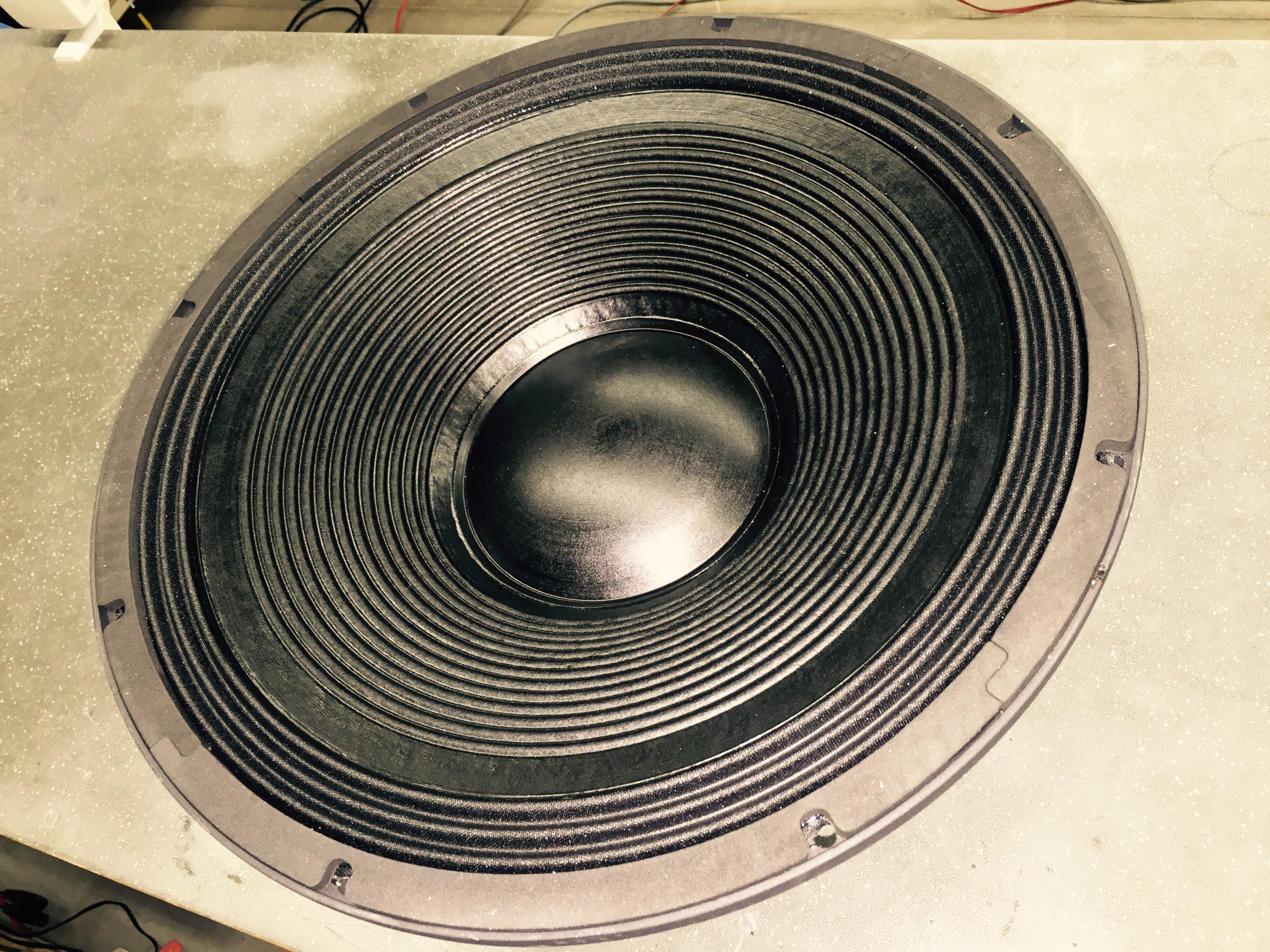

Dayton PA-460
Hi Everyone,
I've read through most of this thread but haven't found anyone using this dayton driver. I think it could be a great value for a lower SPL build, perhaps tube amps.
If someone could simulate this driver that would be really helpful.

I've used and like this driver, but it's not strong enough for this TH. .
What exactly do you mean by not strong enough. The PA380 is very similar sharing the same 80oz magnet and 22+ BL, and don't forget that these are the new version with different specs.
Allow me to rephrase, go right ahead but don't whine to us because you didn't want to listen.
I am trying to learn, but unfortunately I need more information to understand what "not strong enough " means.🙁
I don't have time to run a sim as I have to hit the road soon, but "not strong enough" means the motor isn't powerful. Low Qes and high BL^2/Re are indicators of a powerful motor assembly. The reality is for subwoofer drivers, it costs money to build a good motor and it really does end up being you get what you pay for most of the time.
It really depend on your definition of work. Noise will be made. Hell somebody earlier stuck a Peavey Lowrider in one of these and the results were okay-ish. Those have pretty weak motors compared to the B&C monsters recommended. Really built for reflex loading and not horns. The Lab 15-4s I'm using also have a bit of a weak motor and the results still work for me. But you're still not going to get the true performance the cabinet is capable of outputting. The 460 is even worse than those though, so the results are probably going to be pretty ugly. You'd be better off with a good reflex design. What you'll probably end up getting is a saddle response. A peak at the low end and a peak at the high end with a dip in between. That's generally the result for a driver with not enough motor to be flat through the passband.
The PA465s, on the other hand, does have a decent motor. You'd probably see good results with that. But again, that's twice the price, because motors cost money. You can tell just by looking that them.

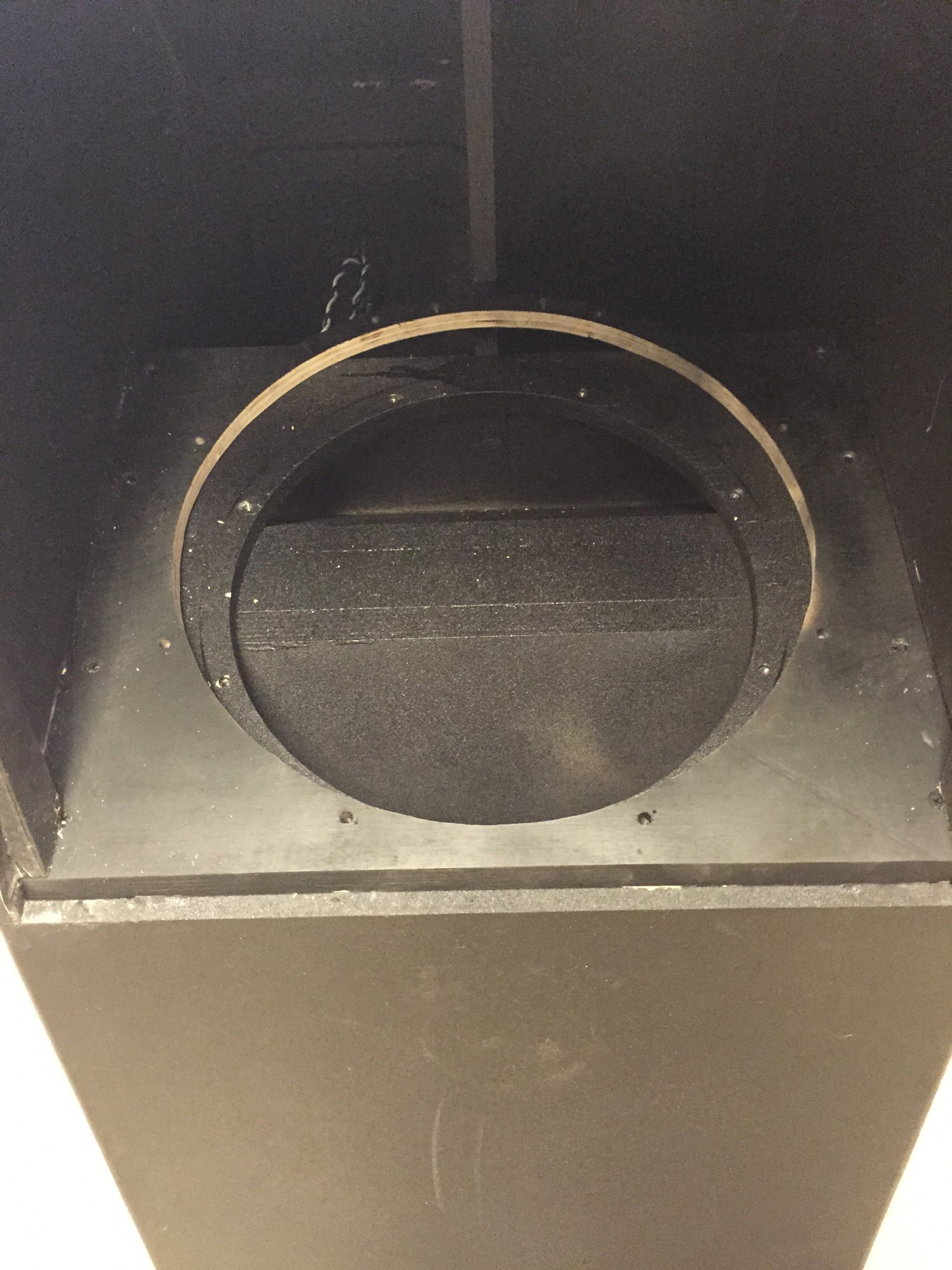

Hi
I hope not to get on somebodys nerves but i found some drivers laying around. As i said i have a good access to Faital. This 18XL1600, this 15XL1400 and 6 pcs of the 15FX560, wich are parked in my BR subs can be used to try a TH. I also got several 18HP1020 but i think this type of speaker is probably not the best for TH. I' m willing to start simulating and sawing. If one of you could give me tip how the drivers are best to use i would be happy.
I'm thinking of a TH or shoult i say 6 pcs of them to replace my BR- woofers. They should go a bit deeper and bring at least 3 dB more spl. But they shuold be max. 50x60x80cm. Thats the frontsize of my BR cabibets and also the footprint of a half euro-palette.
Furthermore with 3 pcs per side i can implement also a cardio stack. Its not importand for me to go down less than 40 Hz because i'm doing smaller live gigs supporting rock'roll band most of the time (let's say about 500 pax)
If i need very low subs i can do this in other ways.

Looks like you're asking for a new design. It might be best to start a new thread for that.
Fitting an 18" driver into a 20" wide TH that occupies about 8.5 cu.ft. gross might be a bit of a challenge, but I think it's doable.
