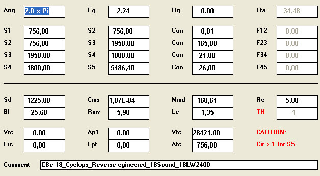

Any hornresp inputs for the sims below?

Did you run the same sim with drivers @ xmax of the designs and also compare with the recommended drivers for both designs.
I didn't do anything! -I just quoted Djim and asked for the hornresp input.
I think people use several different drivers, but to get a fair comparison I think it's fair to use the same drive, one that performs well in both cabs.
The fane 18-1500 sims nice in cyclops, but the RTM "RED I" sims even better, I'll try with some more drivers...

hi maan do you mean that cyclops perfoms better than xocs design?? where are cyclops design??
They're louder, look at previous page 215, they seem to go as deep, which surprises me! This is why I asked for the inputs.
The plans are all over, there's cyclops CB-18, CBe-18 & CBx-18, "x" being the biggest with most low end & CBe the smallest.
Just google & you'll find the plans🙂
However I don't know how hornresp should "see" the advantages of a symmetric horn versus the th-18, so perhaps you should add a bit more expectation to the hornresp sim than with TH-18.

The Hornresp data above shows an internal volume of 373 litres and which is over 21% bigger than a TH18 - Then add the extra weight & panel volume for a symmetric design......

I guess you mean the CBe?
But how can you know? -Do you have the hornresp inputs Djim used? I found some revised hornresp inputs from Djim on here that's supposed to be more realistic, so if he has used those the above is not the case.
Also note the differences on CB/CBe/CBX
