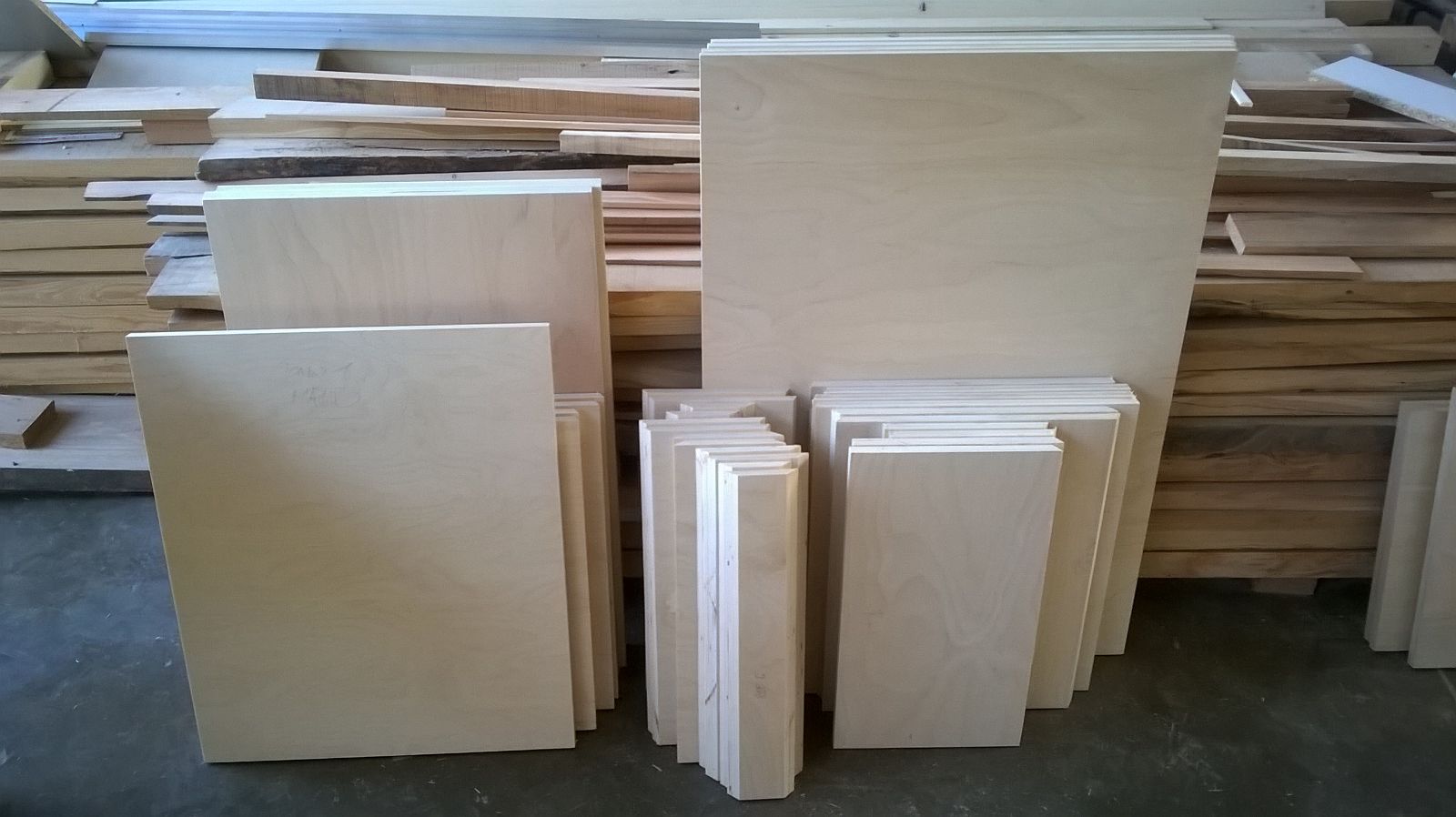

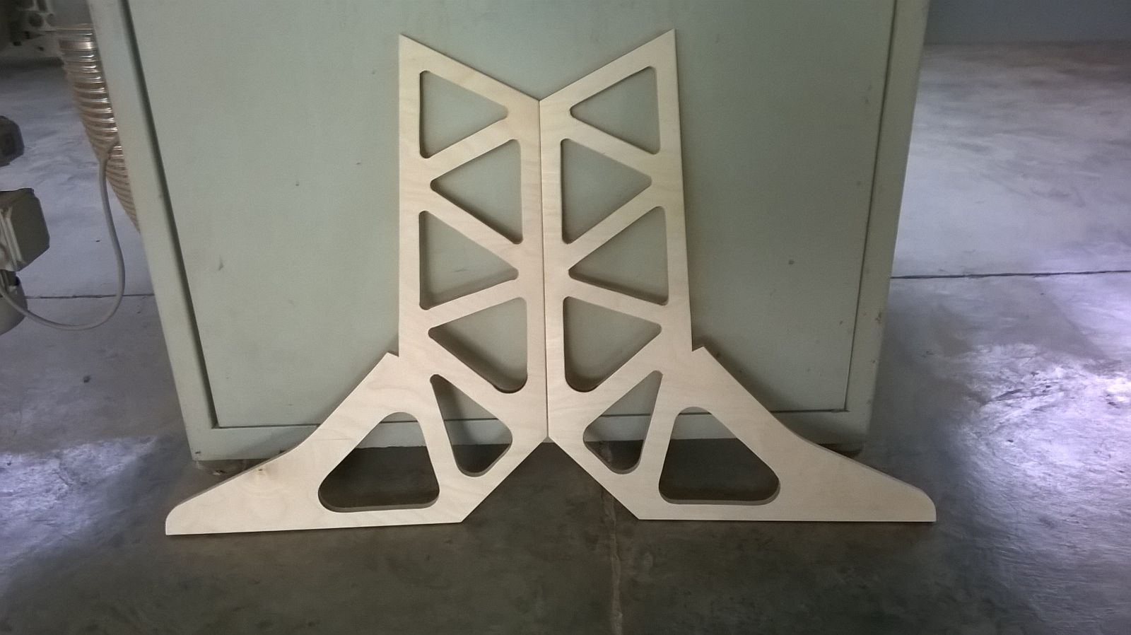

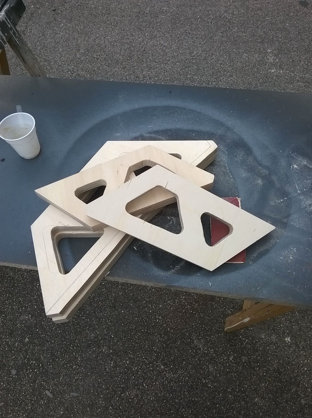

First day in the workshop is gone just making all the cuts fooor two th18, only the braces are left to be cut. A lot of angled cuts, our carpenter friend experience and tools were unvaluable.
Next step... assembling!
I read some suggestion to start from the inside. Should i insert the braces as i build the internals or finish the whole cab and insert bracing later?
Any other suggestion for This stage? Should i first glue everything and screw it at the end or screw every piece as i mount it?
Our first build, lots of options!
Thanks for the help so far!

First of all use expanding PU glue type. Use screws to hold the pieces in place so the glue can do his work. If you have a air tacker gun use that.
With all my builds I do the bracing when the part is added, its easier to build and the glue will not slide off the piece if you put the braces in after. But make sure you test fit the peaces and mark where the brace should go.

By the way bracing done! It took a lot of time but they look sweet.
I think we are going to add an horizontal stick like fenis at Page 197. Those look clean! And grill on the front.
On the hidden inside are we ok with just some protective painting against moisture or do you suggest something specific??
