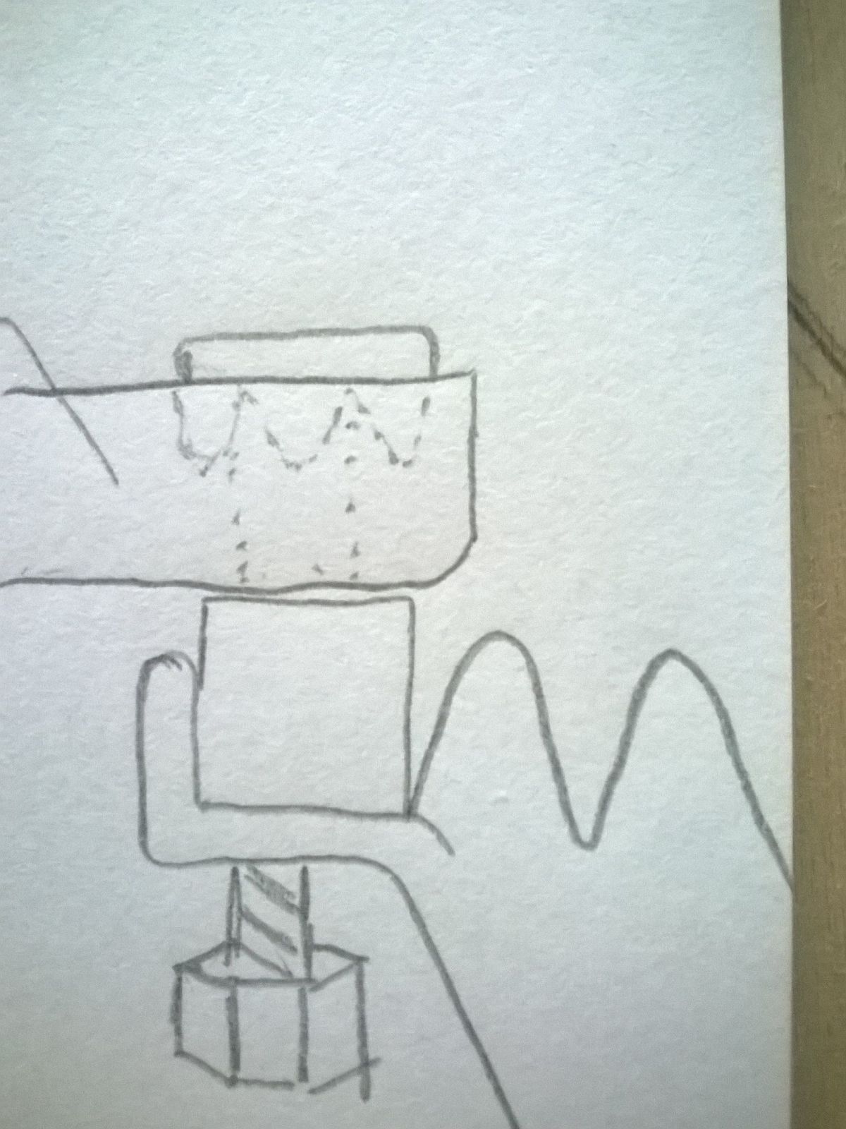

baffle cutout question
Hi
The b&c 18 sw 115 arrived so time to sort out the baffle cutout. There is not a lot of space for the t-nuts left if i cut the right sized 422mm cutout .
What if i cut the cutout a little bit smaller like 412 mm and cover 0, 5 mm of the woofer suspension? Would it get damaged?
Would this alter horn path, spl or extension?
We could sand it like in the picture attached if nevessary.
Or should i stop worrying and mount the t nuts close to the Edge of the cutout?

I'd just chamfer/round the edge with a slightly smaller hole. Won't make a difference sonically

I would keep the 422, and just trim one edge of the T-nut with metal shears. Put the trimmed flat towards the cutout, and it looks nice. I had to do this with many builds.

FWIW, I believe you can make the diameter of the cutout about 2~4mm smaller without any sonic impact. Maybe even as small as the diameter of the first "peak" in the cloth surround as illustrated in your diagram. I'd better that the cone would have to reach way beyond Xmech in order for the surround to hit the baffle.
IMO, the published cutout dimensions for the driver are usually based on the requirement for the driver being mounted *through* the baffle, not on top of it. And consider that one minor leak around the driver can significantly reduce the low frequency capability of your TH.

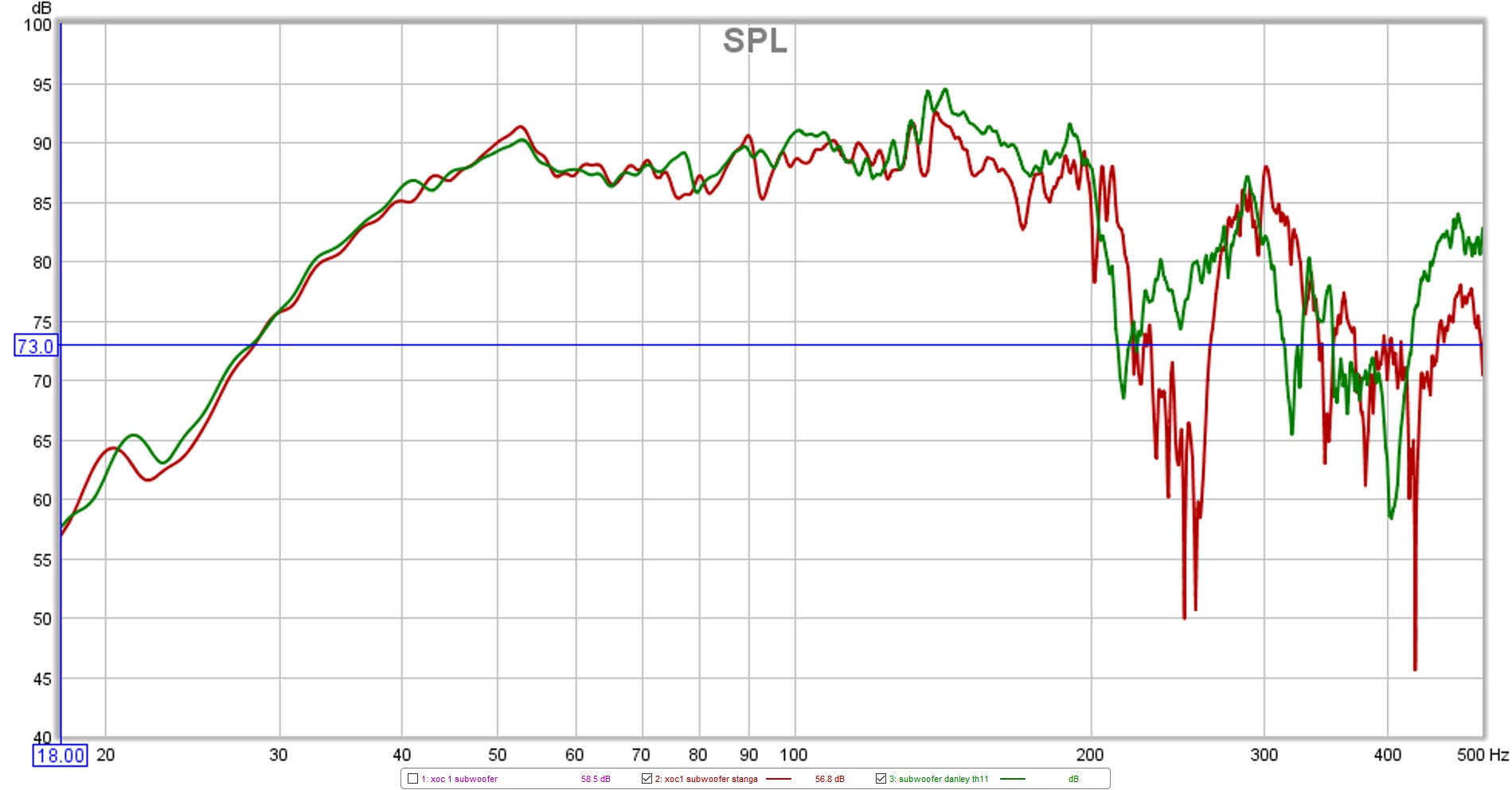

Everyone stop and examine post
http://www.diyaudio.com/forums/subwoofers/190635-th-18-flat-35hz-xoc1s-design-221.html#post4698461
Xic vs th118. Idnoors. Same mic and placement
Yeah, I am a lil bit intriqued that no one said anything about those measurements 🙂 I for one was very pleased about that. And I managed to make some Hi power tests and there is a small difference in cone control. I hope I will soon make some Impedance measurements.
Sometimes silence is not a bad thing.
It does indeed look like a great measurement.

The reflectios are fro two air vents exactly in the same position from each sub. Also they are on the wall bracket 3 meters from the ground and behind them is an entire wall made from glass and the ceilling is with untreated drywall. So the rolloff is steeper
Making more sense when looking at the ripples.

Do you have a one watt one meter pink noise measurement?
You should be proud of your work!
Great results.
I can't calibrate the mic to see the sensitivity because i have gain control on the sound card input but with no scale to know where is 0 gain. But soon I will buy better equipment. What I can tell is that I cannot hear any difference between the output of the 2 but the measurements sais Danley go 1 dB more on a bridged K8. But also the K8 is more stable on 4 ohms than 8
