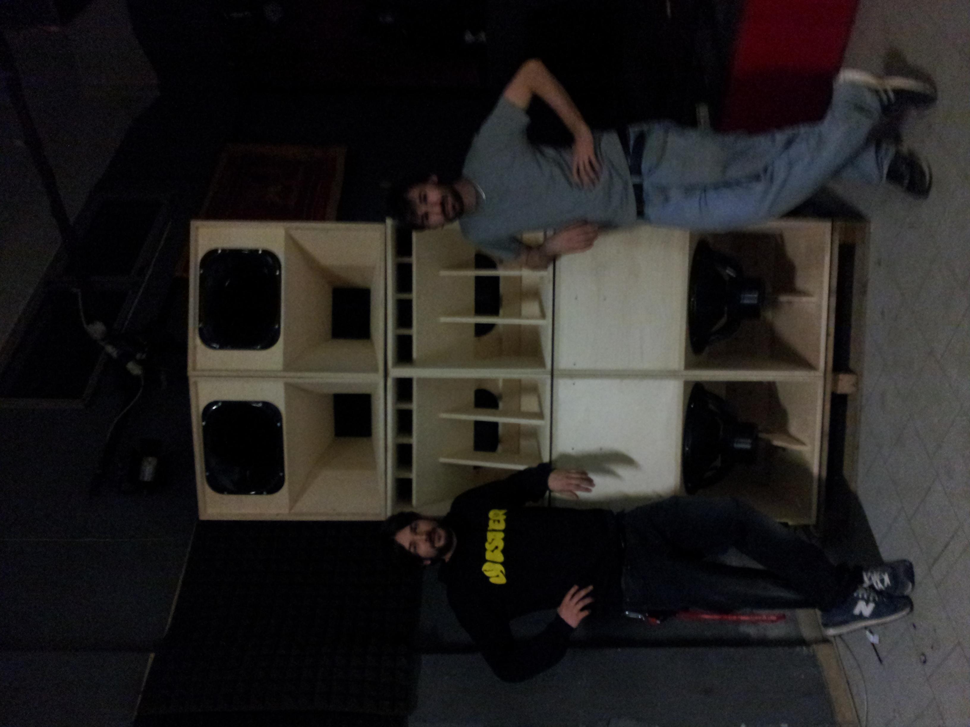

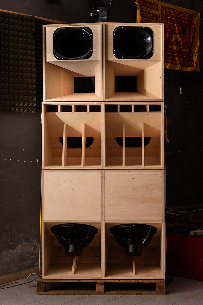

our two th18s are ready, and saturday we tested the system before doing the paint job.
As usual we had very little time before the dance to set up the system properly so we used crossover points based on the forum suggestions and set relative levels and equalized by hear... i bought a measurement microphone and got smaart to sort things out but still didn't find the time to do it properly in the open.
When i get some measurements i'll share them.
So the system consists of a couple each of xoc1 th18 loaded with 4 ohm b&c 18sw115, cubo kicks with 18sound 15d930 and mt121 with 18sound 12mb700 and nd1460 1.4" CD on xt1464 horns.
we run a couple of rental lab.gruppen fp10000q (8 channel total , 2100 w @4 ohm to each th18 and 1300 watt @ 8 ohm to each other driver) through a dcx2496, LR24 crossovers at 90 - 172 - 1.2, sub high passed at 28hz lr24.
I was really pissed off not having the time to measure and set up things, but after some fiddling with the eq, mainly to get rid of some boxiness at 250hz, tame the cd horn mids and bring some hf back it sounded sweeeet! no eq on th18...
Reggae music from roots to rub a dub to modern dancehall was played, and the bass was lush and full with good mids and treble, only the kicks didn't convince me fully, i suspect there's some phase aligning issues to be solved, but given how roughly we set things up and our little experience it sounded very satisfactory on the whole. The dispersion of the mid highs was also really good with no evident gaps on the dance floor, and good hf attenuation under the stack due to mt121 height. Very happy of the 18sound horns!
A friend who runs superscoops on a reggae sound system was surprised by the sound of the th18 , it was very clean and round, although we never really pushed them. Everybody liked the sound and noticed the improvement, but coming from a little active setup in the venue it's no wonder...
A girl came and said to me "I don't like reggae but with this system it rocks"😀
and no ringing ears the day after...
We received a lot of positive comments and appraisals, so thanks to martin and everibody round here.

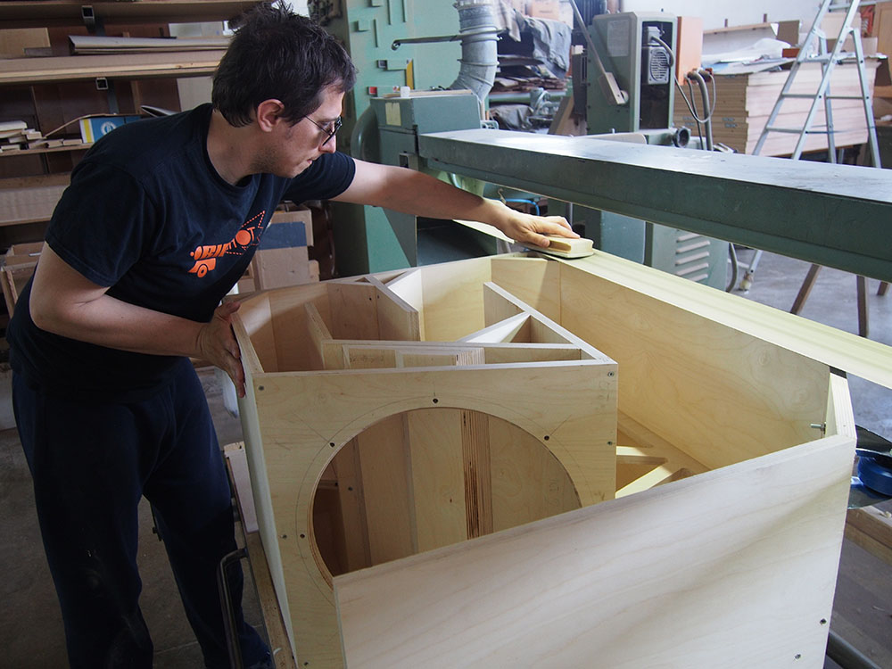

here are some pics, in the last one you will see Francesco at work, our carpenter friend who made this turn out so beautiful.

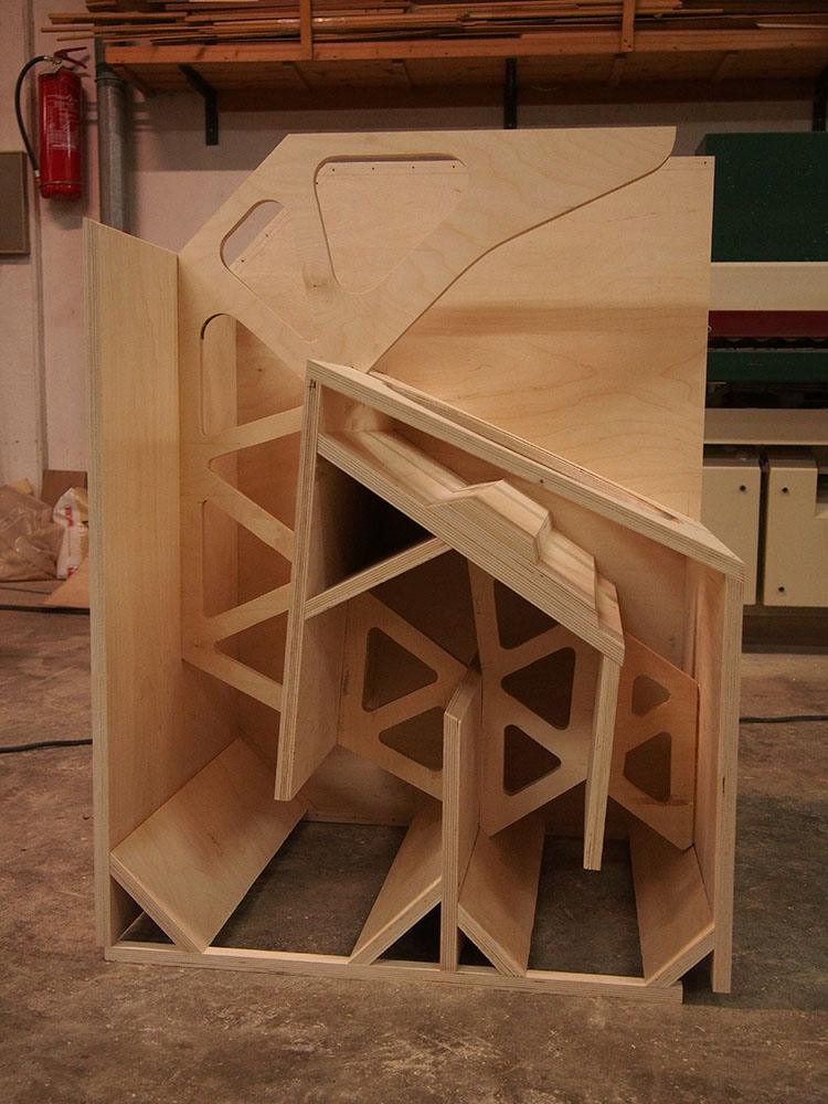

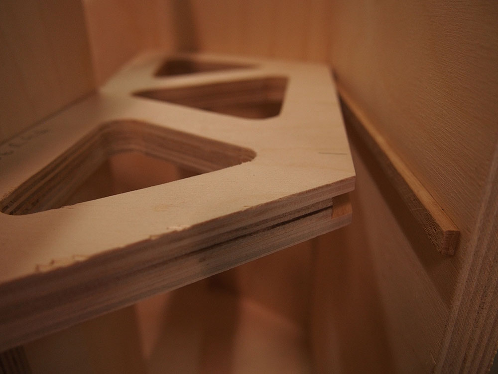

We simed Xoc1 TH's loaded with Oberton 18Xb1500 drivers. Hornresp sims seems te be good so we build four of them. Instead of testing we used them directly this weekend for a classic early hardcore party (89/94 area) . It was running on two amps capable of 1200w per channel through a DCX2496. Filter setup BW48db HP @ 35hz and BW24db LP @ 104hz.
We had to delay the subs a bit to the mains. since the where side by side in front of stage a meter in front of the left and right stack. Later in the morning around 03:00 we slightly upped the HP filter to 44hz to make it whole sound a little bit more clean and also to give the drivers a little bit more cooling. Since it was hammering the eardrums from 22:00 till 06:20 in the morning.
We like the Xoc1 th18 a lot, and I love hornsubs for the reason they keep my amps cool and the amp lights green.
You can see the build pics in my gallery.
