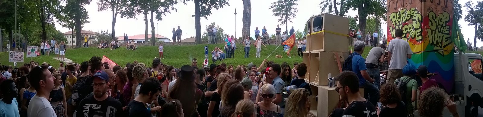

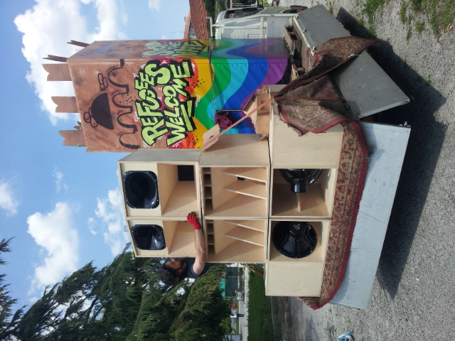

yes we built cubo kicks (with 18sound 15 d930 as suggested) and mt 121 (almost ROG original with double flare, not the simpler single flared TDA mt121 that were posted in the last pages) to go with b&c 18 sw115 th18s.
This sounds very good but mt 121 are big and heavy and the horns not so easy to build, and are cabs with a not so wide dispersion, medium long throw and lot of spl.
We play bass heavy reggae, but they are outrunning my th18s fed with 2 kw continuos each and i feel i'm gonna double the subs before adding another mt.
we wanted it that way, to cover outside events and have a lot of headroom and keep distortion down, but if you are committed to medium small events and are not looking forward to make it a bigger system i would look at smaller and lighter alternatives that would give plenty spl.
mt121 is 60 degrees dispersion average, so in many venues works better in couples to cover 90 degrees, this is something to consider, if you are going to stay with only two tops maybe 90x40 degrees would be more useful?
i like narrow dispersion to control reflections but outside it gets quite directional.
and here comes the kick... shouldn't this be king of tekno? most reports say th18s doesn't sound as sweet above 90-100 so you need a kick or a top to go down at least to 120. mt121 stops ay 170 180...
I suggest you look at ported designs to get low keeping it small, try to keep it at a size and wheigt you can pole mount it and bring the hf above heads. use neo drivers if possible. look at chris661 system thread in PA forum.
Or look at various 2x12 2x10 . 2x15 lots of kick but to big?
if that's not loud enough you may want to go four way and add a kick, take a look at the cubo kick we built, there's also a 12 inch version that goes to 250 hz. that with a 12 or ten inch reflex and a 1 cd on a 90 horn, and the cubo kick works well even in singles.
we have taken some measurements and set crossovers and delays - that were similar to the 5,8 ms at 80hz calculated here🙂. having it in phase with the kick is a joy, we still didn't add any eq to the subs, they sound sweet. we hi pass at 28 hz bw24 for low power and used 35 hz w24 for protection at hi power. gonna lower that to 32 bw 24 with some time and confidence
we took it in the city for a ride 😀
pressure at chest height was insane with subs at that height, even meters away.
sound was always round, physical an well defined, musical.
we hit them with full 2.1 kw continuous 4 k peak, tickling the 150volt peak limiter of the lab fp10000q (two of them, each one with one sub at 4 ohm, and one 15, one 12 one 1.4 at 8 ohm) and it sounded lush, i was amazed how much pressure only two subs were generating.
the rest of the system was running with ample headroom.
once again thanks to this wonderful community!
